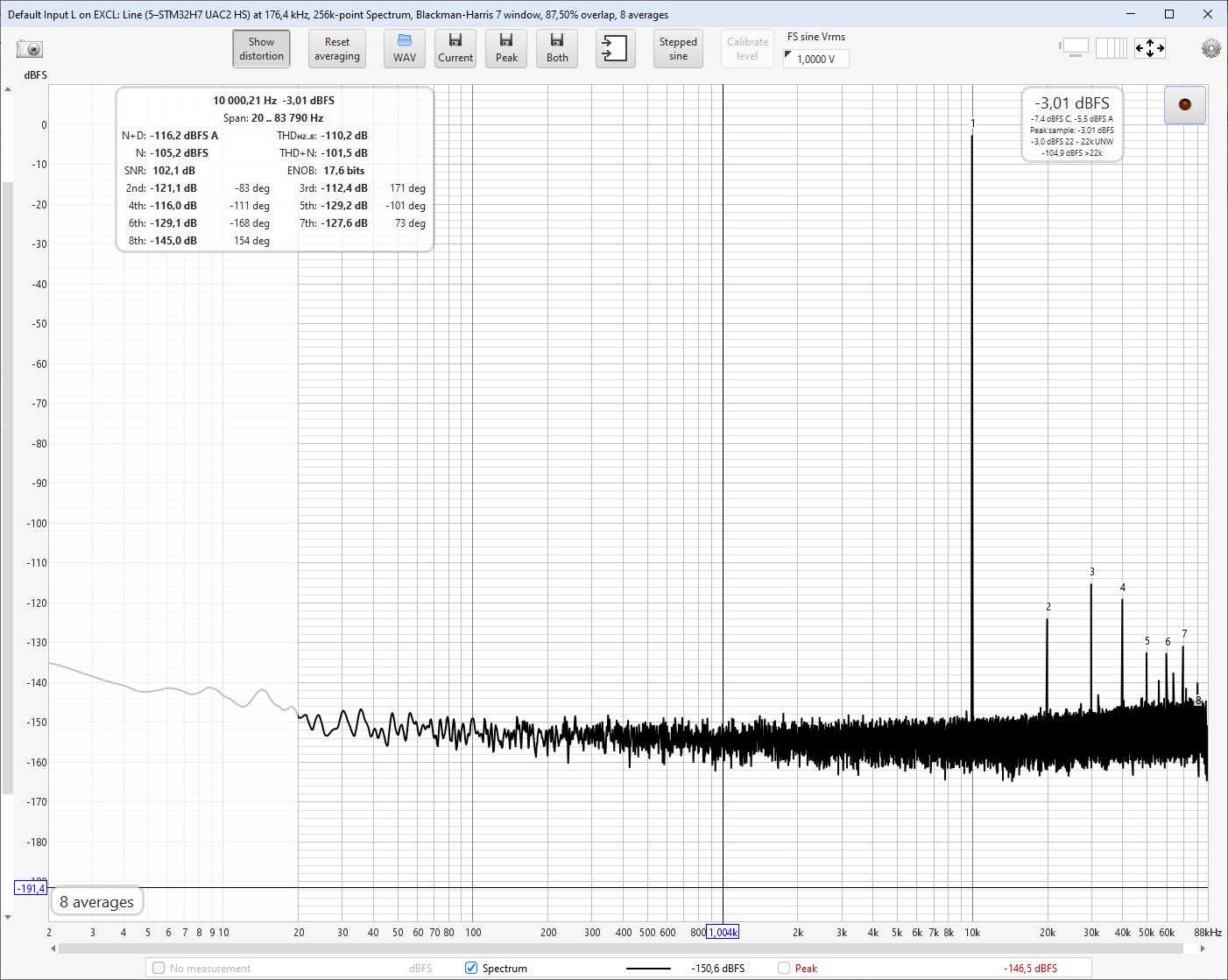

The graph that Bohrok showed mentioned in the top -4.97 dBFS and -1.97dBFs peak, which is correct when adding to signals of equal amplitude.If bohrok2610 had measured at a 2 dB lower level, the third-order intermodulation products would have been 6 dB lower and the distance to the wanted tone 4 dB larger.
That in fact he offered two signals of -6.02 dB instead of -7.99 dB, means nothing but a calibration error.
To correct this, the whole graph should be shifted upwards by 1.97dB.
But for the IMD2 and IMD3, this makes no difference since all ratios remain exactly the same.

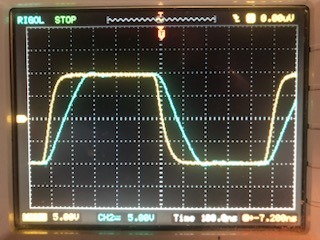

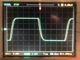

I asked because I am currently working on a high speed I/V converter for a "conventional" DAC. The results appear promising using a critically tuned AD811. The response below shows the input/output response for a +/- 10volt (+/- 5mA into 2K Ohm feedback) 1MHz square wave (2MHz sampling)
(100nSec/div scale). The propagation delay is about 20nSec if the scale is expanded. At the rate of rise shown a 300pF load capacitor will begin current limiting at +/- 100mA of an AD811. The second image shows well controlled current limiting with only a 1nF capacitance load.
The image is non-inverted in that the network passes through 2 inverter stages, an open loop AD844 (adding about 5nSec delay) feeding the inverting terminal of the AD811. (note that the rise and fall times are limited by my function generator)

Actually I measured the lowest distortion (THD) when I (according to you) sabotaged the common mode loop (see post #2080). That is with stock opamp (OPA1678) in second stage.I still notice that the distortion only goes from quite low to very low when something is changed in the second stage: either the biasing conditions or the op-amps.
