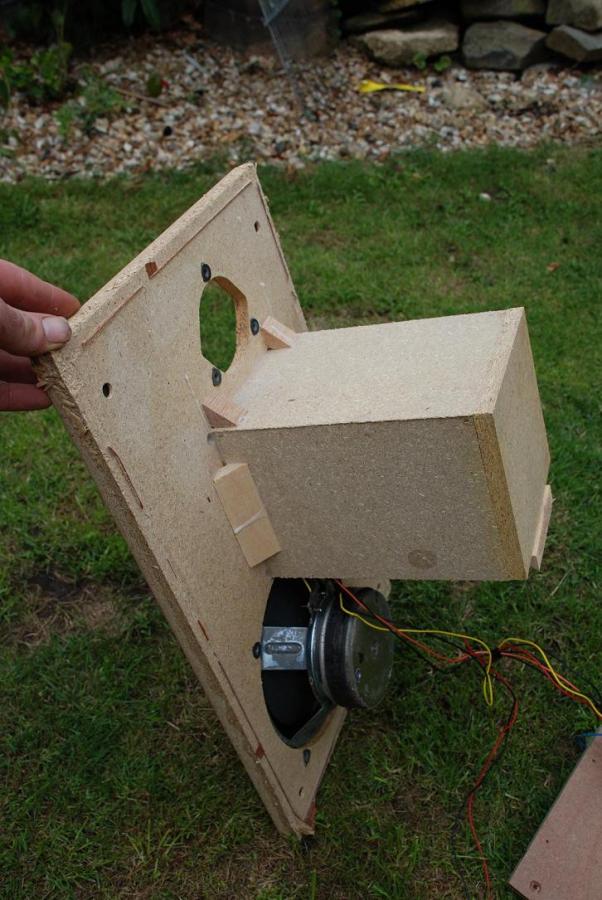

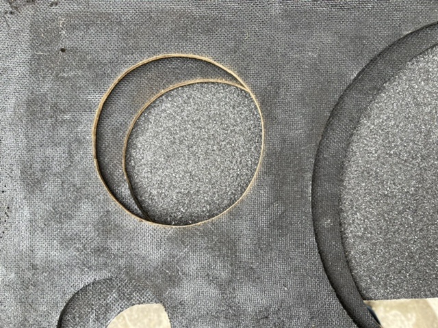

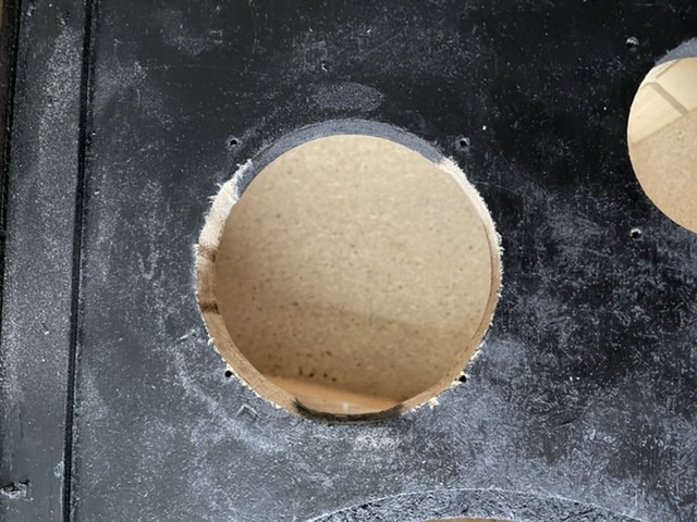

Apologies for the long silence. It’s been very busy this end since the summer holidays started!

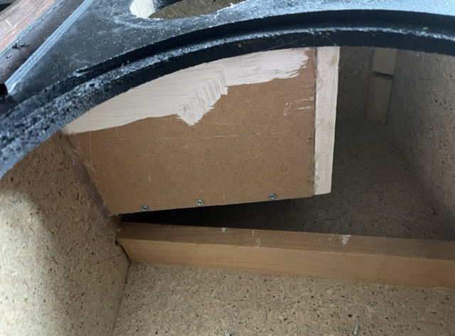

I have started ordering components for the crossover. Until they get here, I have been building the mid housing and increasing the cut out size in the baffles and grilles.

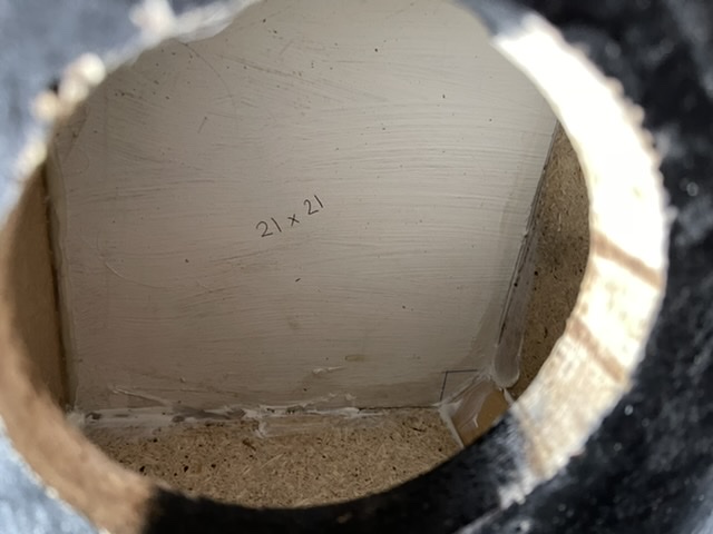

The mid housings are cut from MDF I had in the shed and are cut with my trusty old jigsaw cutter. They aren’t as straight as B&Q cuts so I’ve sealed them with copious amounts of hot glue and liquid nails the latter of which was applied by [nitrile gloved] hand to ensure a good seal. I’m quite confident they’re air tight and fit for purpose. The final volume ended up being about 6L. Due to the size of the enclosures, they were assembled once inside the cabinets (including screws) which was lots of fun 😛
I have also gutted the original crossover on the small plywood boards and replaced the posts in preparation for the new crossovers.

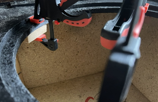

Finally, it occurred to me that the way the bass drivers are secured is no longer suitable. The nuts/bolts are basically inverse, with a Phillips M bolt facing inwards and a nut on the outside. This requires a hand with stubby screwdriver inserted through the mid cutout (or tweeter if you have insanely small hands) to hold/tighten which is no longer possible with the mid enclosure. To solve this, I have changed the way the bass drivers are secured by fixing a small piece of MDF behind the baffle so that a screw may secure the bass driver from the front.
Increasing the mid cutout:
Increasing the grille cutout:
The mid enclosure:
View from cutout:

MDF fixed with liquid nails behind the baffle so that bass can be secured from front:
The mid enclosure:
View from cutout:

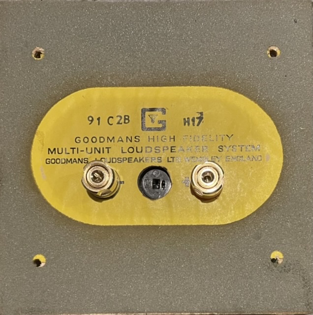

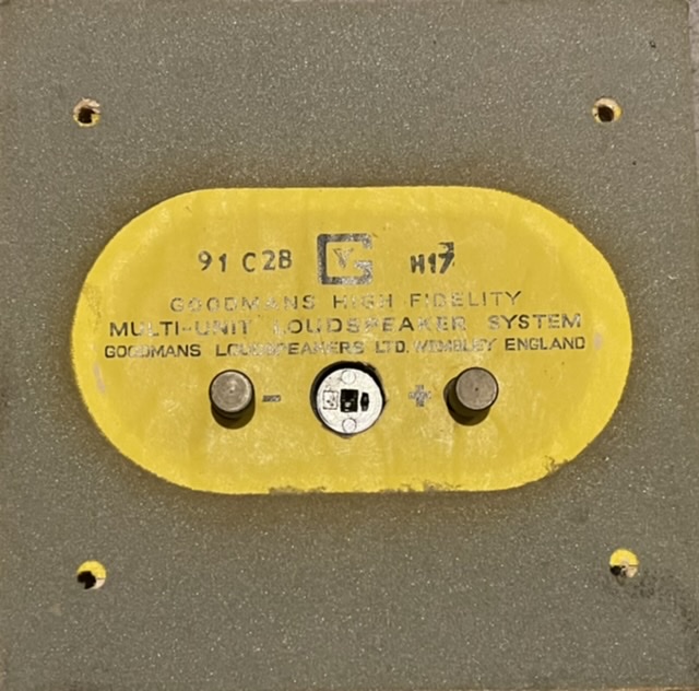

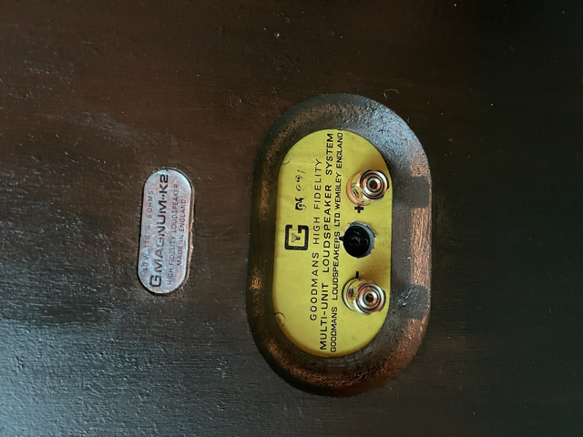

Here’s the posts and original yellow board against the newly stained dark walnut back:
I’ll keep and reconnect the DIN socket just because it adds character 😎
The original back was a chocolate mousse brown, pretty ugly in my opinion. The veneer was something like oak or similar. It was scratched, dented and peeling in the corners.. instead of spending hours repairing veneer (which I know nothing about) I decided a lot of wood filler and stain would be a better idea. Thanks to some garage door left overs from a neighbour, the cabinet will go dark walnut which will look much better with the grille fabric.

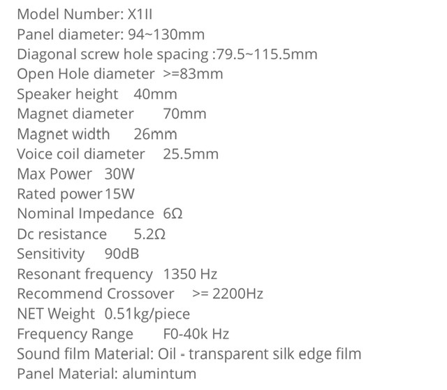

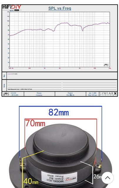

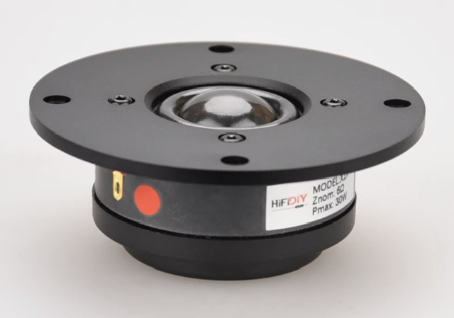

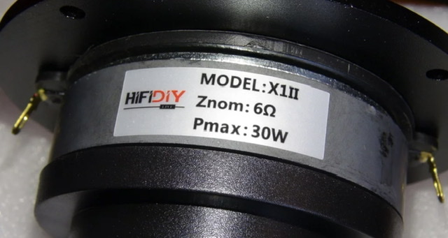

Ok, more information on them. Good news and bad.
Bad news is they are these: HIFIDIY LIVE X1II 4 inch 4.5 Tweeter Speaker Unit aluminum panel transparent Silk membrane 6OHM30W Treble Loudspeaker 94~120mm|Speaker Accessories| - AliExpress so nothing mainstream. I should have guessed really, the guy who offered them is the one who got me into AliExpress.
With that said, here is some info from the listing:
They’re being offered for £15. So the question is, are they junk or worth a shot? They were purchased to replace two damaged tweeters in some Yamaha speakers but they were the wrong size. Apparently the correct size was ordered and they sound better than the originals.
Good news is: the reviews seem fairly good and they seem to be 6ohm, 90db, 30W max and one guy says their range is pretty good:
I don’t have actual resistance measurements yet as they’re in a loft. Waiting to actually see them.
I can’t find any Monacor, Visaton etc tweeters that are anywhere near £7.50 each. Thinking it might be worth taking a risk.
I’ve said yes to the tweets, if they’re junk I’ll pass em on. I get a lot on freecycle and I give a lot back. What goes around comes around.
