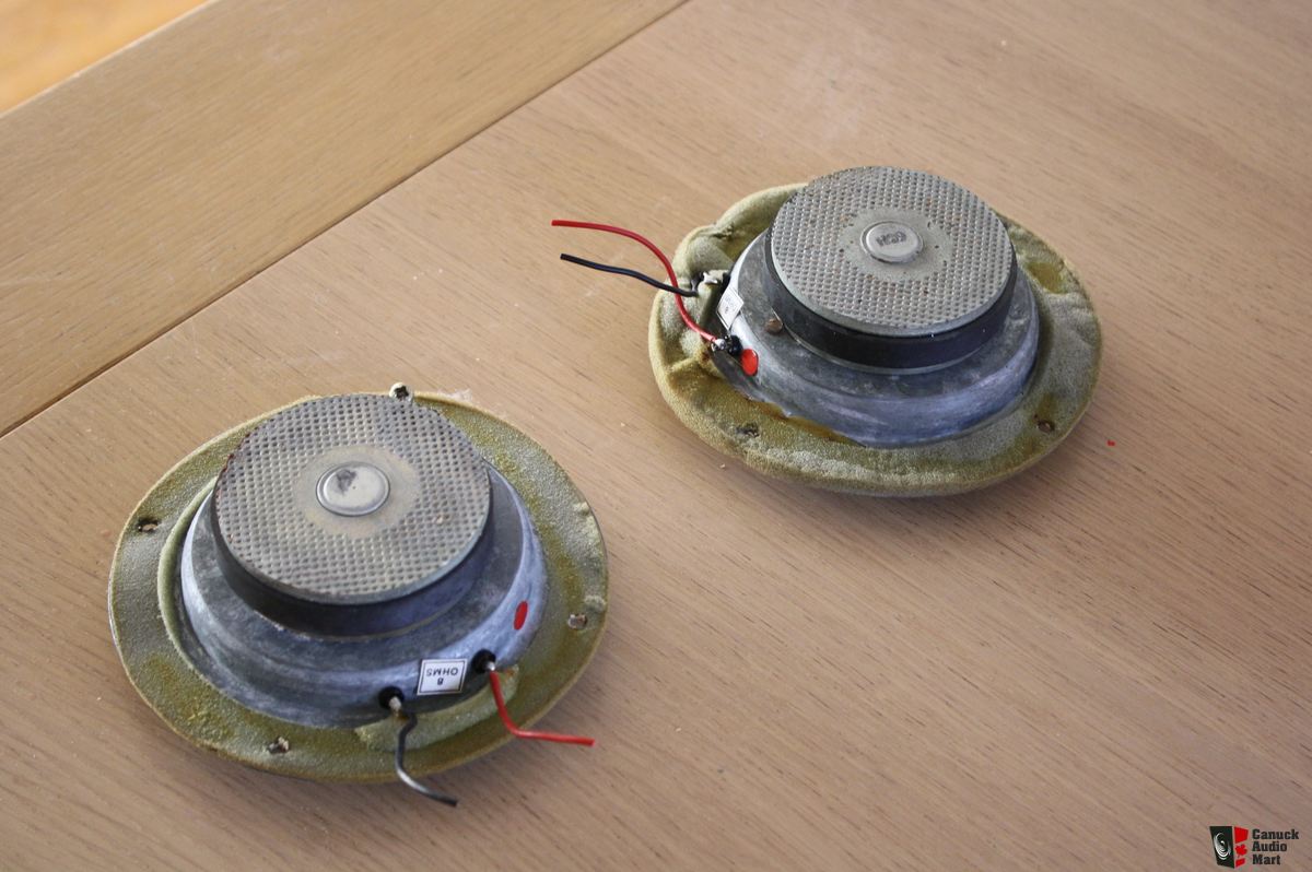

Going back to the images of your mid range drivers. The first one has white stuff, PVA? showing between the cone and the central dome/dust cap assembly.
If you look at the second midrange image there does appear to be a gap without any white stuff at the join between dome and the cone.
Do you know if that driver makes sound, or is only the coil and dustcap moving with the cone staying still?
If the Xover frequency is around 1200 hz they wont move much anyway with sensible levels so it may be difficult to discern what is actually moving, the coil and dustcap or the coil dustcap and cone?
You could double check all wiring against the original picture. At the same time looking for corroded or dry joints on the Xover and speaker terminals.
In desperation you could try swapping the midrange wiring to see if that actually makes it far worse or improves the situation. It has been known for drivers to be wrongly connected at the factory and we have all done it at some time when building speakers.

The mids have a closed back (see attachment) and a nominal 8 ohm impedance.Does the original midrange have its own rear enclosure to seal it from the bass unit and help define its midrange roll on.
Galu thanks for the Images.
So any replacement will need its own 1-2 litre enclosure. large yoghurt pot or suitable cardboard tube or PVC pipe, closed at the rear.

@raymondj might be easier to do this in metric: the cutout is 10cm, with the back of the mids being about 9cm, the actual cone is approx 7-8cm, difficult to gauge exactly because there’s quite a substantial border. You’re right, there’s very little movement from the cone at various levels. I could always take a jigsaw to the cutout to avoid being limited by size on the mids and tweets. Listening levels anywhere from 40-80db depends on how many neighbours are home. They came with a Sony TA-FE370 which I believe is 70w/channel. I’m not worried about purist sound, I may as well go for accuracy.
