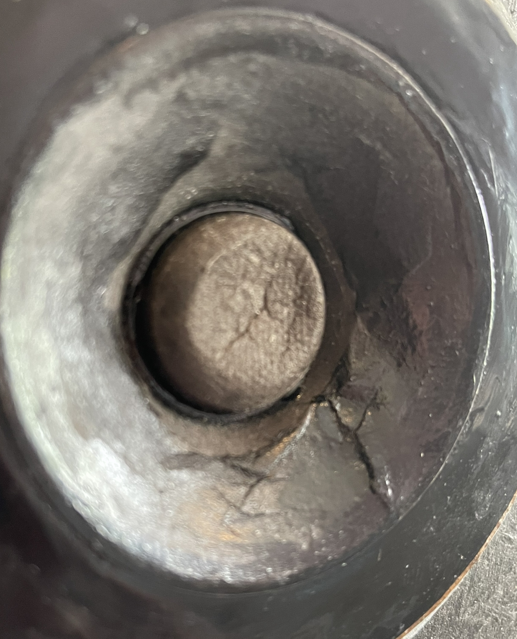

Overall cosmetic condition is poor, and I have been advised the crossover would probably benefit from a recap. The mids have been damaged then repaired with PVA and lack brightness - or are they just like that anyway?

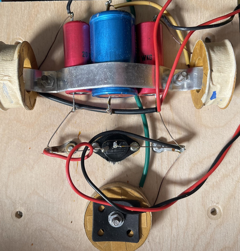

1. What capacitors do I need to replace these with? Someone has said Alcaps? I can solder but I need to guidance on what to buy - doesn’t look like I can see the numbers written on these without desolating.. does anyone happen to know what these caps are? Here is a pic of it: https://i.postimg.cc/qqD778F7/94643-B11-A49-D-4-BCD-AE58-B791-D40-C0-EF9.jpg

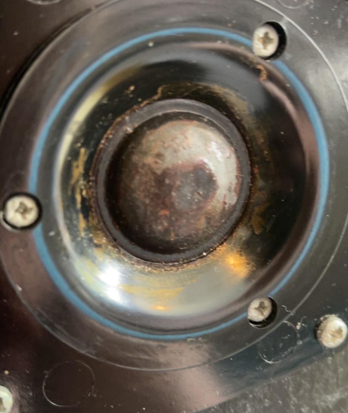

3. Same for tweeters, worth replacing? Suggestions? Pros/cons? I have heard the original tweeters are probably more worth saving than the mids, but I’m open to any and all advice. They certainly sound crystal clear to me, but if I’m dipping into non-purist with the mids, I’m open to suggestions for the tweeters too.
If I am to replace the mids and tweeters, it has to be something that will come through those woofers. It might just be that they are damaged, but they are definitely drowned by those woofers as they stand.

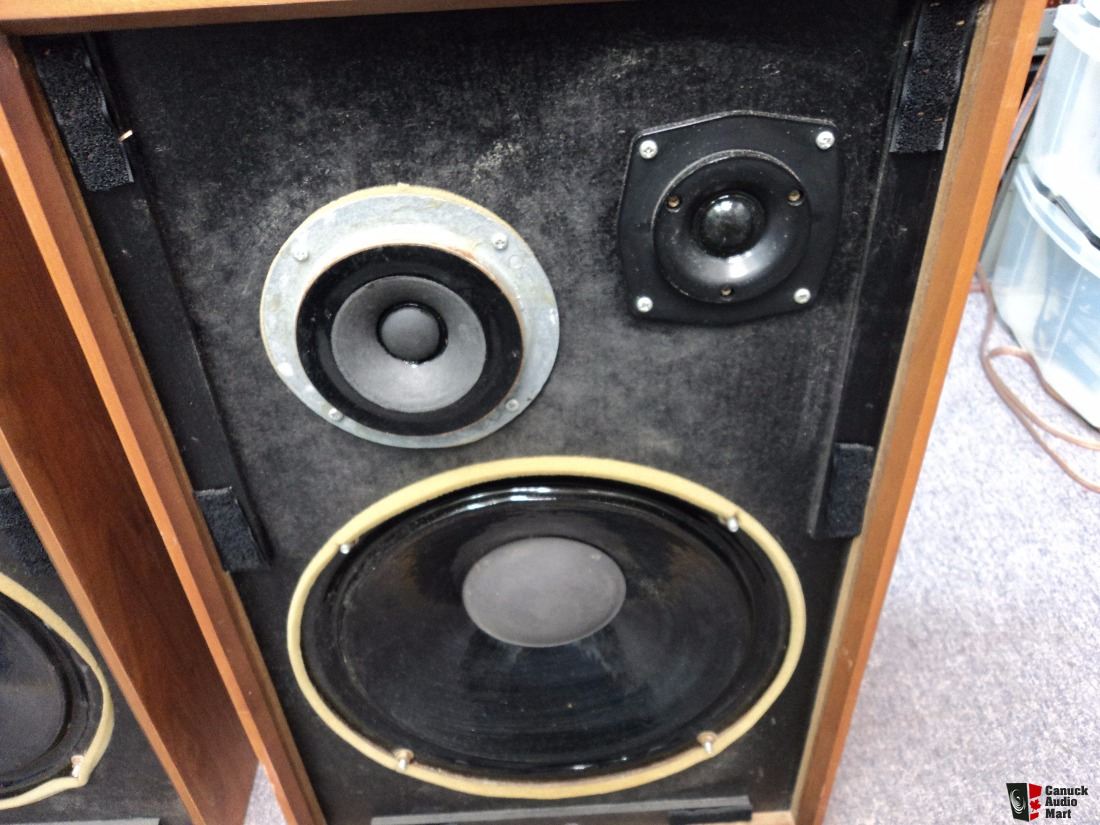

I've attached your crossover photo here for ease of reference, as well as an image of the loudspeakers for those unfamiliar with the model and drivers.

And here's some, probably unhelpful, specs of the Magnum K2:
Impedance: 4 - 8 ohm
Max. RMS power: 50W
Frequency Range: 30 - 22,000Hz
Retail Price: £46.20 (in 1971)
Sensitivity: 2W produces 96dB in the average domestic listening room.

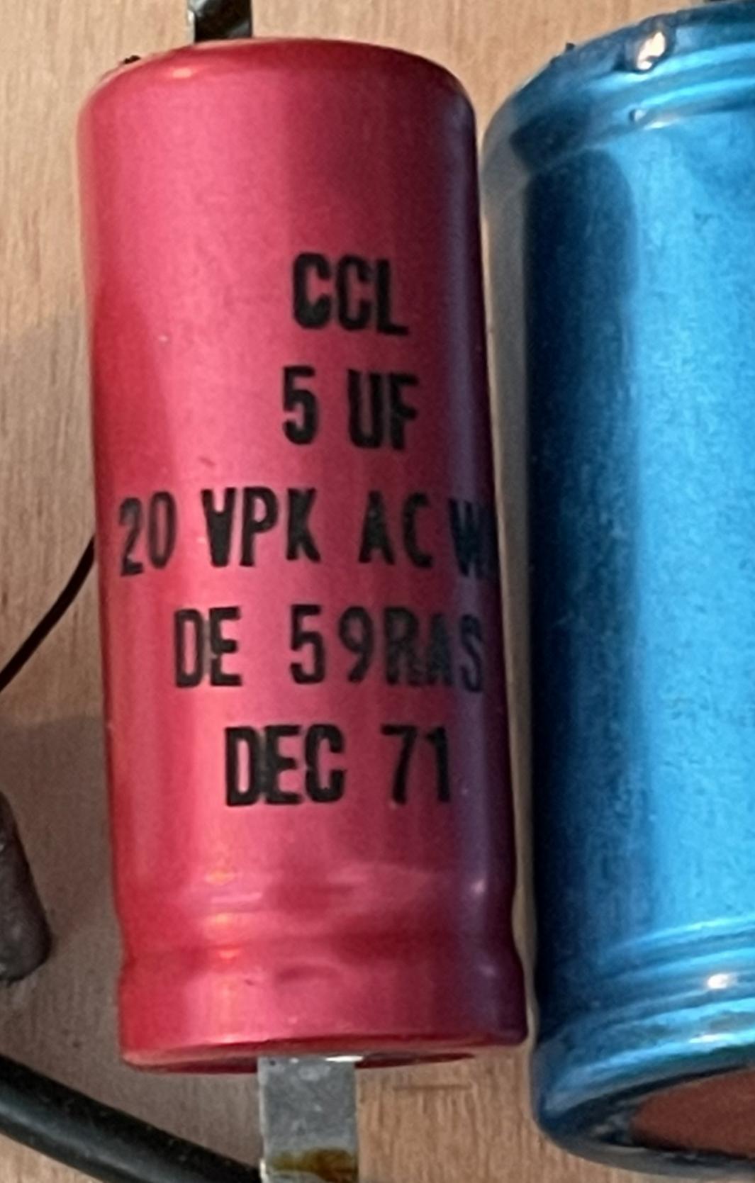

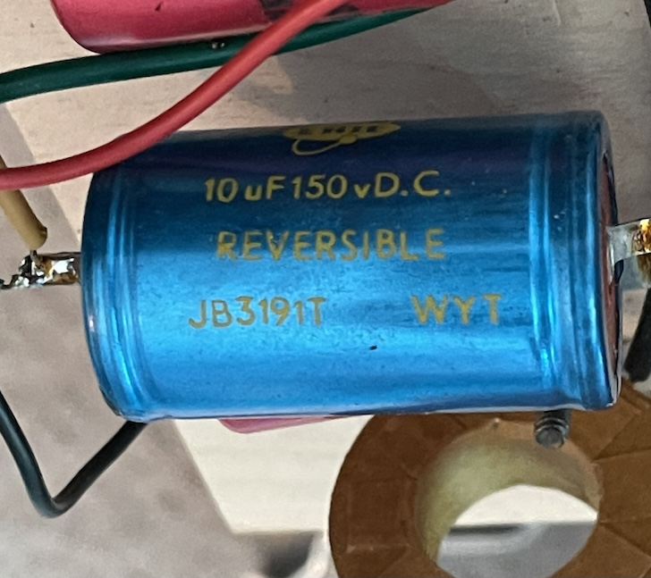

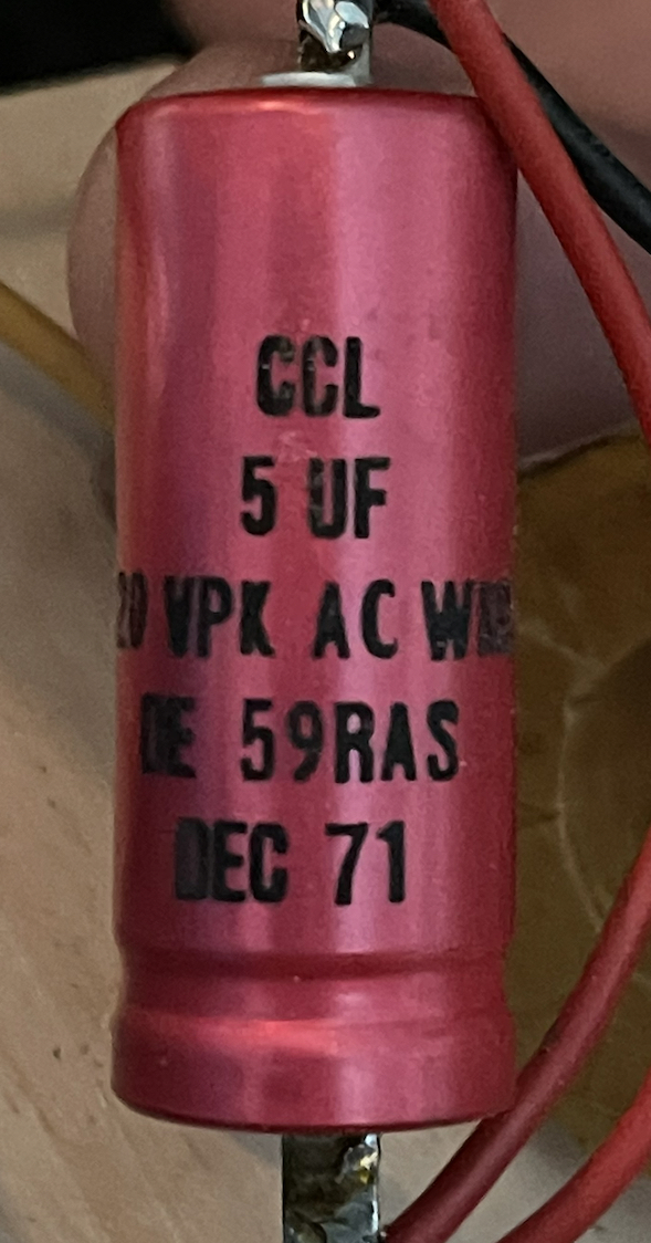

I have undone the clamp as you suggest and gently turned them to see what is printed on them. See attached photos. The 2 red ones appear to be the same. So they are 10uF and 5uF so I will need these: 10 fd ECap100 Electrolytic Capacitor and for the 5’s I guess the closest thing is 4.7 here: 4 7 fd ECap70 Electrolytic Capacitor not sure if this is acceptable or do I need a 5? How Will dropping it to a 4.7 change the sound produced?
One thing I am unsure about is what the 3 “doughnut shaped” parts are? They look to be some kind of coil, one for each driver. Do these also need replacing? One of the things I wanted to do was increase the internal wiring. Something thicker and copper, but looks like I’ll have to solder to each of these coils too.

4.7 uF is just fine and will make no audible difference (other than being fresher than the old 5uF!).
The coils do not need replacing as they do not deteriorate over time like electrolytic capacitors.
There's no need to go overboard with the thickness of the internal wiring.

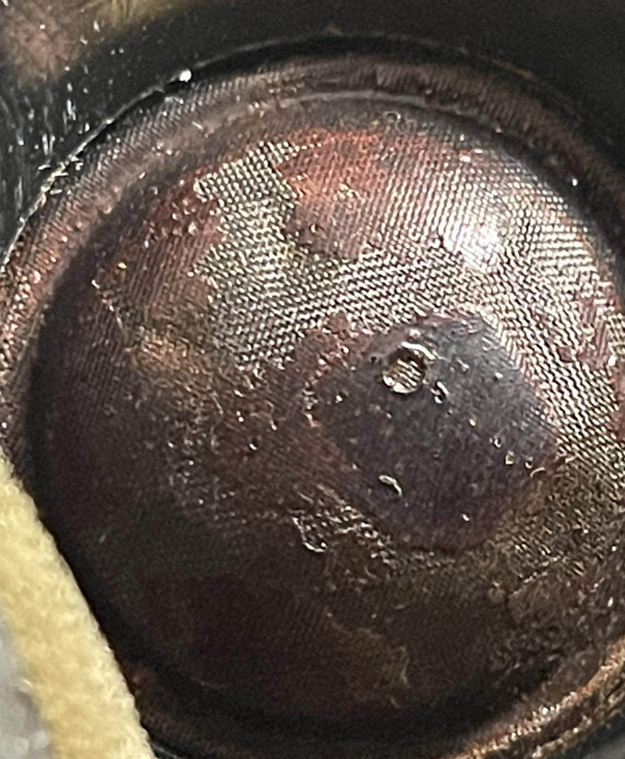

One mid looks like it had a tear. The other was probably detaching around the edges. Here’s some pics, and the tweeters too.

The drivers are certainly not in pristine condition! ;)
The mended tear is unlikely to have made the mid sound dull.
If the surround on the other mid is not completely detached, it is an easy job to glue down the detached sections.
I would advise you to change the caps then take it from there.

Thanks for the warning lohk, I will check the mids and I am happy to recap the crossover.. I assumed the mids would be duff, hence wanting to replace. I am trying to keep things out of landfill primarily and I do this as a hobby but I’m always grateful for forewarnings. ;)
Does anyone know what the coating on the tweeters is? Can this be purchased / reapplied?
Galu
2018-04-17 6:50 pm
The coating will be proprietary and probably best left as is. If the tweeters sound as "crystal clear" as you say, I would not interfere with them.
However, if you are brave enough to experiment, Anita's Tacky PVA Glue would be non-destructive to the original coating/impregnation of the dome.
