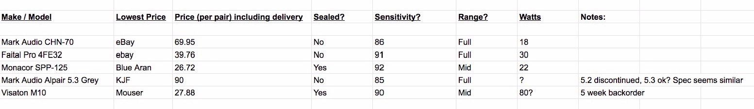

Wow. Thank you all so much for the replies and suggestions for drivers and enclosures and the general advice and pointers.
I have put the information into a spreadsheet and attached it. I have left out the GRS units because the UK price seems to high.
I have a couple of questions:
1. What are the pros/cons of a dedicated mid over full range? Is a full range unit preferred?
2. The MA Alpairs have a lower sensitivity than say the Faitals.. am I not aiming for a higher sensitivity or was this only for mids and not applicable to full range?
No XO with the FR, you get teh seemlessness of a good FR (if you choose a good one). The tweeter above a mid might do top better.
The Faital Pro (at least the 3”) have an optimistic sensitivity rating. You want the woofer typically to be 3-4 dB more sensitive than the woofer (and use an XO point base don the BS(-3))

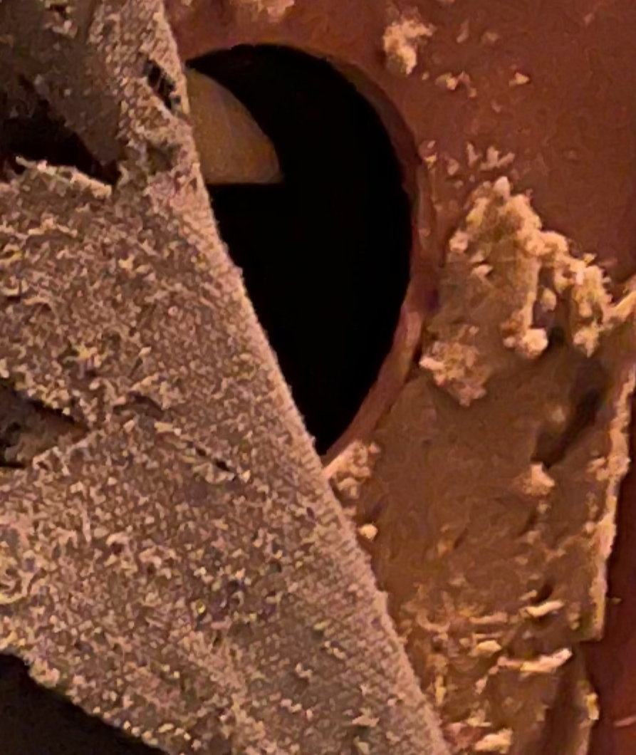

The original construction of these grilles appears to be ~6mm composite wood board with cutouts for the drivers, onto which a layer of grey foam was glued to cover it and then cut out so only the mesh was in the way of the drivers. See attached image.
I’ve been given some really nice vintage style grille cloth but it’s got quite a large weave and my plan was to have the foam cover the cut outs in the board to give less transparency to the cloth.
I was just wondering if you had any ideas for cheap acoustically transparent foam? 🙂

You don't need acoustic foam with most grilles since it is often hardboard and foam with cutouts and a covering cloth. Affixed with velcro or studs. Presumably something like bicycle tube rubber cement to secure. Dunno.

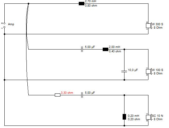

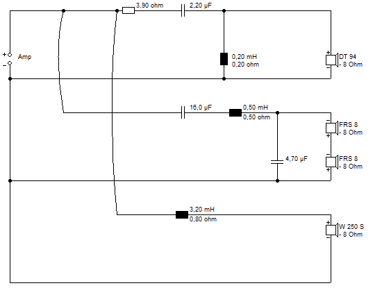

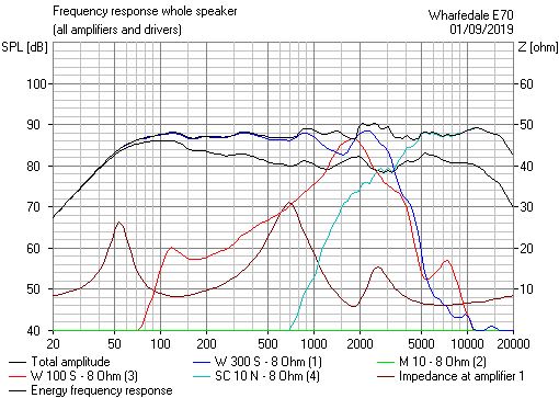

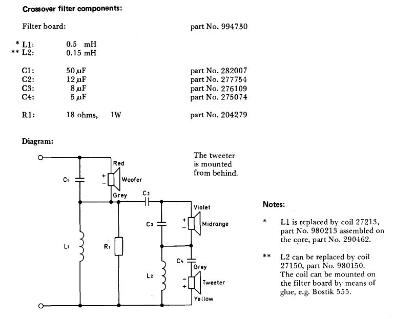

I had a complete disaster modelling the Visaton M10, and the Monacor closed back looks as awkward. I am guessing the crossover resembles the two affixed images with a more regular midbass. You might investigate.
Apropos nothing , here's a few similar projects for ideas.
SEAS 503:
SEAS Kit 503
Wharfedale E70:
503490d1441979582-inductor-series-restistance-effect-qts-2-identical-drivers-series-wharfedale-70-jpg
503491d1441979582-inductor-series-restistance-effect-qts-2-identical-drivers-series-wharfedale-e70-crossover-2-png
Tandberg HiFi15:
496146d1438223984-crossover-elimination-tandberg-hifi-15-jpg
496147d1438225310-crossover-elimination-tandberg-hifi-15-crossover-png
No, the Tandberg circuit didn't help either with closed back. Maybe the old closed backs were flatter.

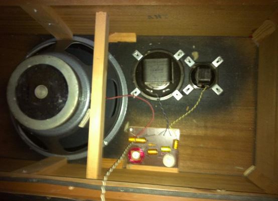

What you could do is entirely revamp it with new drivers and a more sophisticated crossover. Just using the cabinet really.

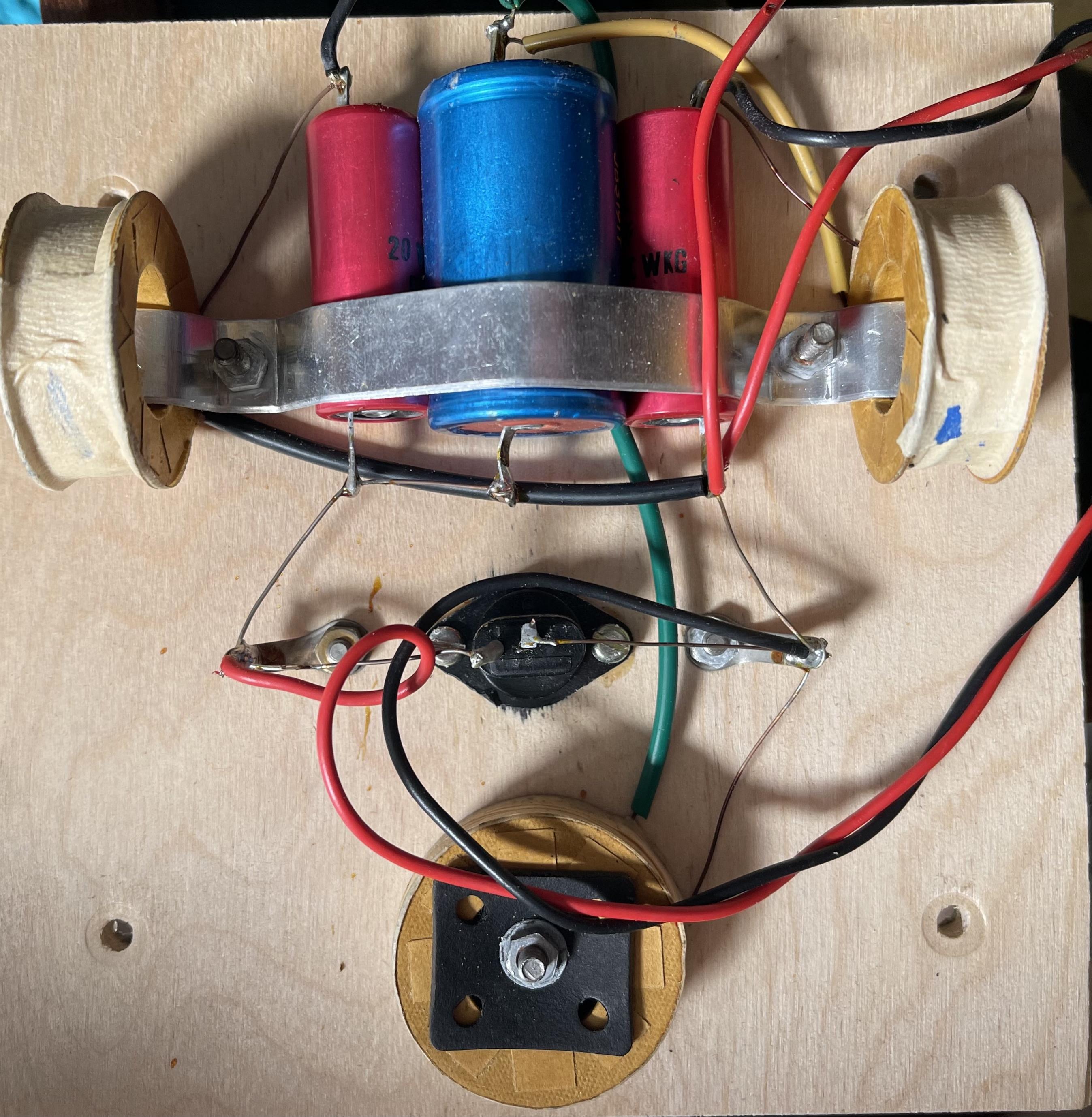

The crossover appears to consist of just 3 caps and 3 coils, the image you attached has a resistor? I don’t see that on the boards I have. There is an image of it earlier in this thread, but I have attached again. The cap values are 5uF, 5uF and 10uF but it looks like one of them is in series so values could be 5uF, 10uF and 15uF. If remaking the crossover is preferable, I can definitely do that.
I noticed there were 3 capacitors and three coils and no resistors. Rearrange those 6 into a well known crossover. 😀
