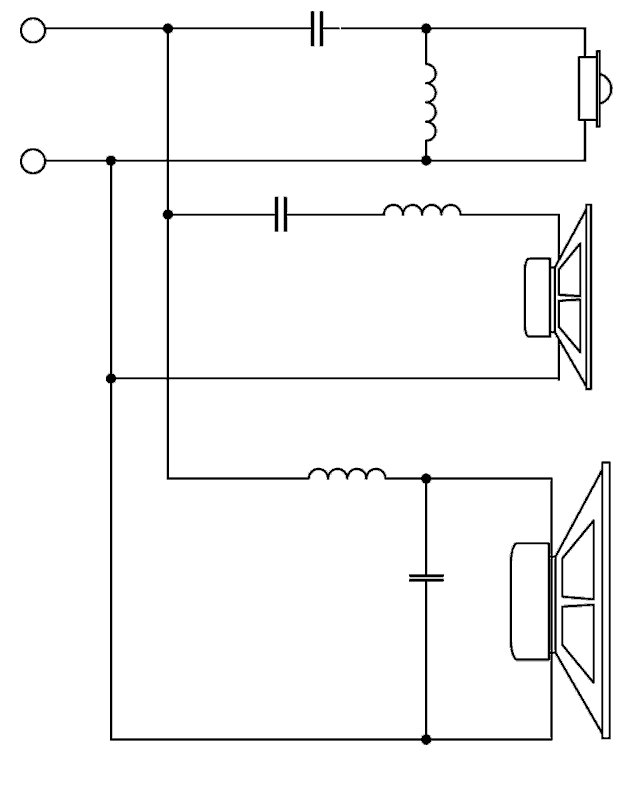

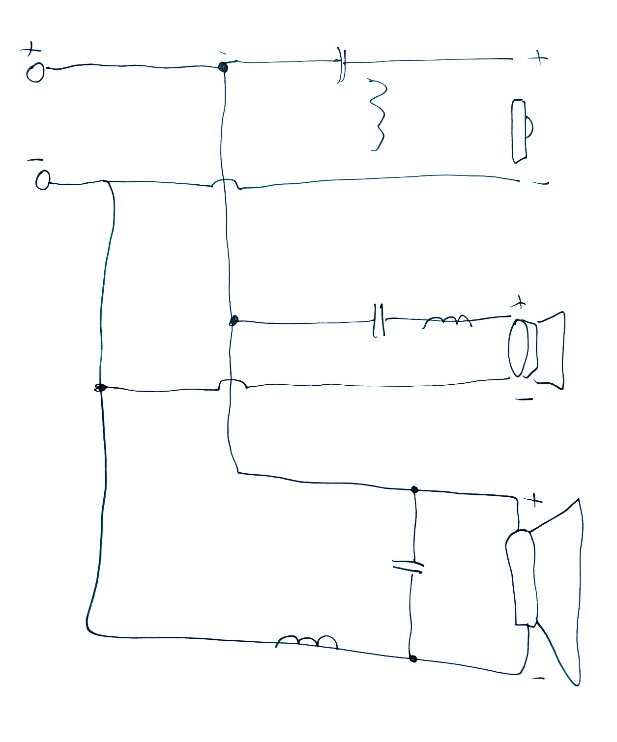

I noticed there were 3 capacitors and three coils and no resistors. Rearrange those 6 into a well known crossover. =
Probably lookslike this:

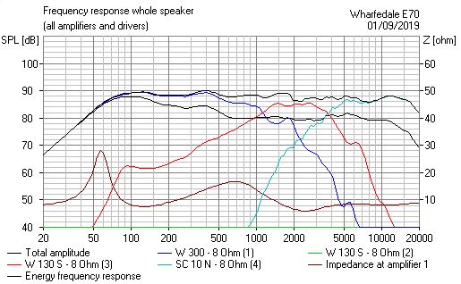

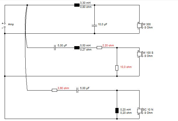

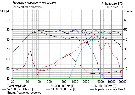

I ran Dave's ideas up the flagpole with a 4" midbass in 2L and otherwise similar drivers.
Not a million miles away from a SEAS 503:
SEAS Kit 503
But here the mid is more of a narrowband filler driver.
I was guessing where the 2X 5uF and 10uF go. I couldn't get the optimiser in Boxsim to work with the Visaton fullrangers due to incomplete files, and didn't want to spend time doing it manually. But no reason to think they wouldn't work, though some issue with high Qts, being designed for open baffle or enclosure-less ceiling mounting. Need biggish enclosures in other words.

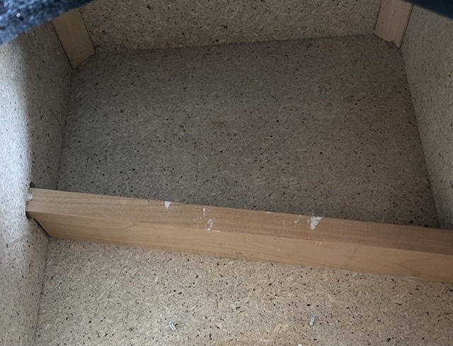

To make chipboard enclosures requires some accuracy cutting for airtightness on the sidepieces. I bought a sheet from B&Q and they machined 8 squares around 20cm and 2 bigger backs to fit. Around 7L. You get a certain number of cuts for free from B&Q.

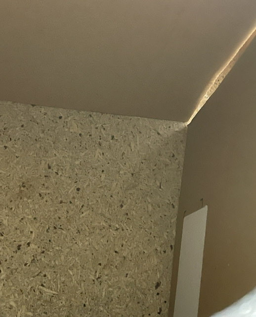

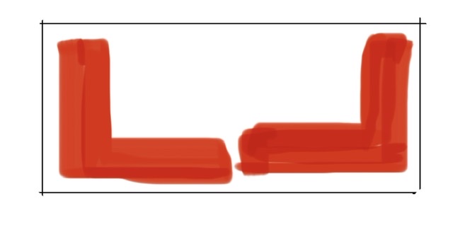

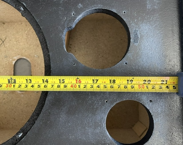

Well, assuming that the enclosure size quoted on these drivers is a minimum requirement, I can get about 9.6L of sealed space the for the midrange and just cut the hole to fit.

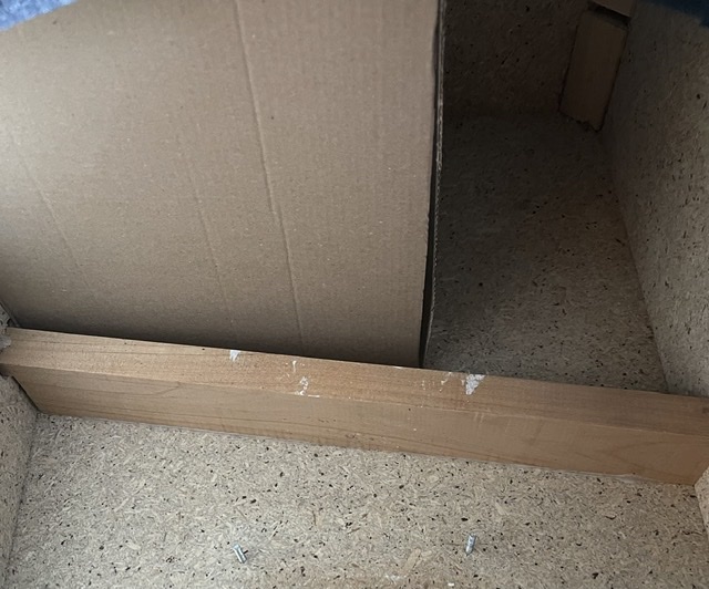

I’ve just used cardboard to see what kind of sizes we get and 2 cuts of MDF measuring about 20cm x 20cm x 24cm = 9600cm3 = 9.6L
Before:
After:
View from mid cut out:
I could easily do this with chipboard or MDF from the shed. Liquid nails / PVA / Silicone to seal and fix in place. Would have to drill a hole somewhere to pass wire through obviously then seal it up, but not a problem. The foam was placed into the cabinet in 2 right angles. So if you lay the cabinet on it’s back, the side view is this this:
Obviously the piece below the tweet and mid would have to be removed. Not sure how that would affect the sound from the bass driver, am hoping it should still be ok. Can cut some and place in the area behind tweeter and into the new mid enclosure though.
Does this open the way for more suitable drivers?
This is a tricky problem based on incomplete knowledge. I would certainly draw up the schematic of the crossover complete with exact values and polarities. But I have a goodish multimeter that can measure coils and capacitors and the DC resistance of drivers:

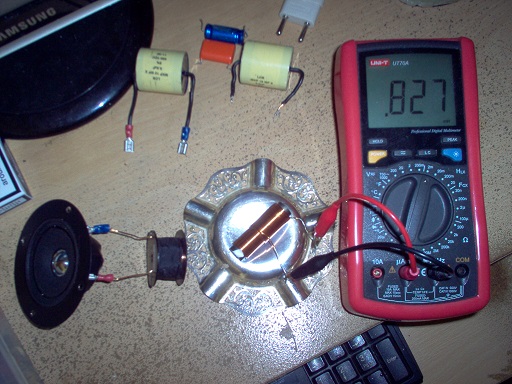

That looks like a standard meter. Good for DC resistance. You should touch the test leads probes together for calibration, because they have a finite resistance. Then subtract that voltage from what you get with the test resistance for accuracy.
Seems to have a signal generator, which might have uses with a second simple meter. You'd wire a known (say) 1mH coil in series with the test coil and insert a test tone around 1kHz. The AC voltages should then divide as the ratio of the coils.
My meter (£70 at the time, cheaper now) has a H (Henry) and F (Farad) scale. It uses a 1kHz test tone to estimate inductance H, but I always calibrate it with a known inductance because it is erratic on different scales.

Ok, here are the DC readings from the bass drivers to start:
Probes measured 0.08
1. 6.60 - 0.08 = 6.52
2. 6.55 - 0.08 = 6.47
If it would be advantageous to get such readings, I’m always up for extra tools…

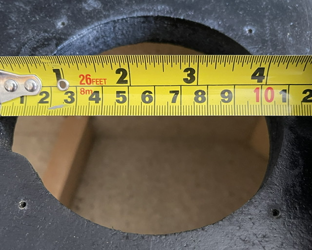

Faitals are here. Readings are:
1. 3.22 - 0.08 = 3.14
2. 3.23 - 0.08 = 3.15

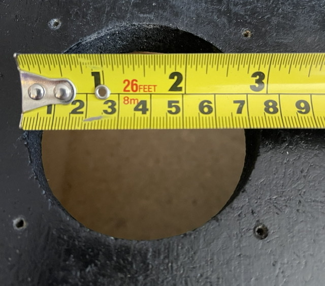

Looks like I’ll only have to increase the mid cut out ever so slightly. They almost fit!
FaitalPRO | LF Loudspeakers | 5FE120 (8Ω)
That was quick! But David, you've ordered the 4 ohm version:
It's doable, especially as we should have level to spare, but limits our options a bit here.
It's always hard to keep impedance high in a three way.
Ok, so maybe the simplest thing to do would be to decrease the cutout size.
Seems like lining the cutout with self stick closed cell foam tape would be the easiest.

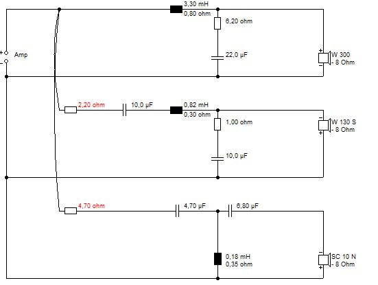

The drivers I used were a 91db Bass, a 86dB mid and a 90dB tweeter. But it's a very standard circuit with a bit of level adjust available with the red resistors.
The Visaton W130S has a peak at 1.4kHz that shouldn't be evident with the Faital. The tweeter crossover is Celestion's old standard 3.5kHz filter. Works well with most 6 ohm tweeters.
All that is needed is to adjust two resistors for loudness. If it is a 93dB woofer, 2.2R or 3.3 on the mid and 2.2R on the tweeter might be about right for a slight downward domestic slope.
I would use NP electrolytics in the bass and mid sections. Cheapish Metal Film on the tweeter. The 1R on the mid shunt could probably go with NPE types. Aircoils as much as possible, but ferrites often used on the bass. Resistor on the bass should be 10W ceramic type. Maybe even two 12 or 15R in parallel for 20W. The rest could be 5W types IMO. But 10W will do no harm on the mid.

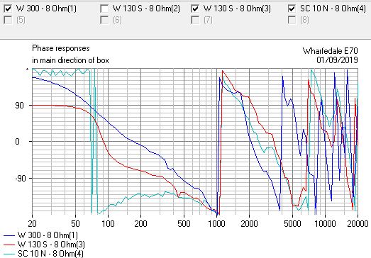

I think 5L will work nicely. These things are not exact, especially as the mid crossover has no shunt inductance to take the bass down here. The box calculation breaks down with mid circuits. But looks good enough at 100Hz on the mid to me. A bit of stuffing with BAF is always good. That's the stuff like pillow filling.
I modelled it in 5L. Celestion used about 4L on a 5" mid.

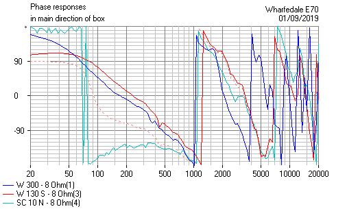

The actual theory says you aim at this for studio monitor flatness:
Box size can be a trade off, bigger loses power handling.

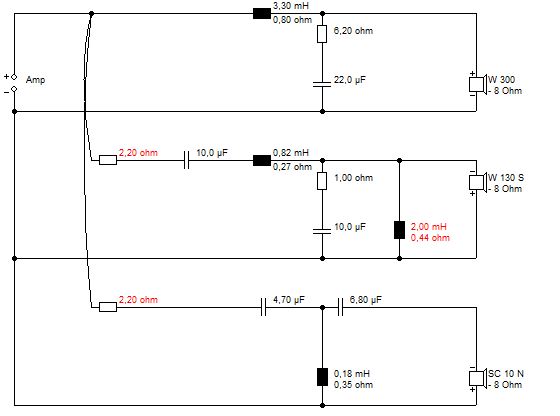

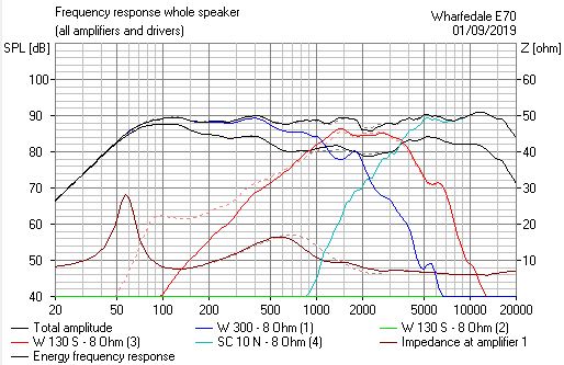

I tried to stick to the original Goodmans circuit, partly to keep it simple, but this afternoon had a look at a 2mH shunt coil on the mid circuit.
You can see this gets much closer to the Steen Duelund theory above. Even phase is better. It's a simple add on. The dotted lines are more the original circuit.
You can see that the mid bass response and enclosure size is now largely irrelevant. This is what I would call a proper job. Troels would do it like this...
