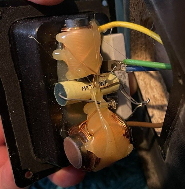

I’ve also found reference to acrylic varnish being used in such applications.
Steve! What is suitable? Can I get away with acrylic or polyurethane? The only reason I’m asking is because I can get some of that tomorrow instead of Thursday next week! 🙂

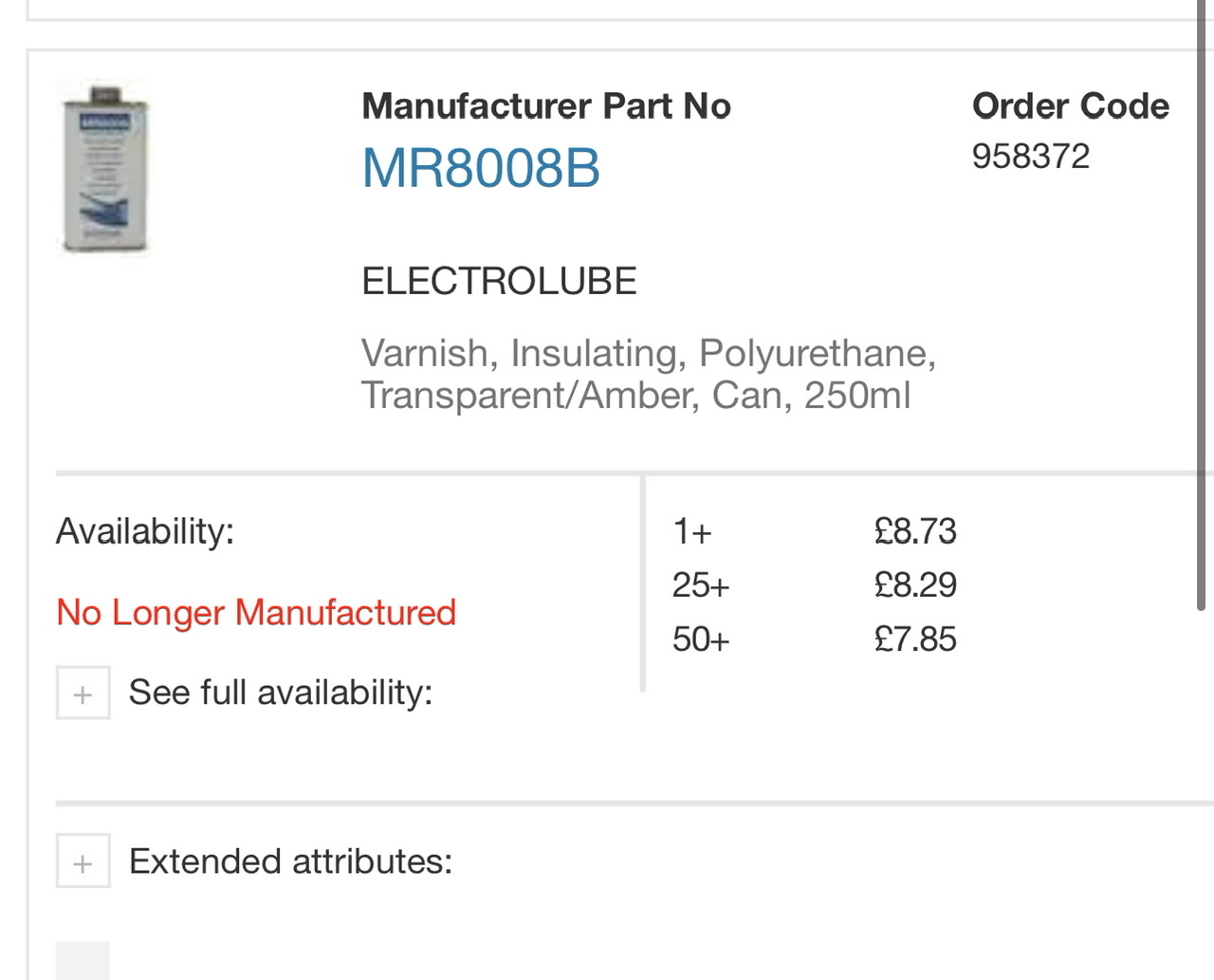

Well, I’ve searched and searched and I cannot find anything that specifically says it’s transformer varnish, electrical resin or similar that I can have here this weekend. 🙁 these kind of varnishes seem to be electrically insulating as well as heat resistant. In the case of my coils, they are already insulated with polyester so I really only need it to be heat resistant and not catch fire (and hold well, of course).
Based on the Electrolube product from CPC above, I highly suspect that the link on eBay is just polyurethane… the seller has put a pic of a small bottle which is either a stock image or if it is the genuine bottle you get, shows that they’re decanting a larger vessel into small 100ml containers.
I’m going to take a risk on this one and order a polyurethane acrylic solution. I have found several posts across various forums including this one: Winding your own inductors — MAC/DIY where the user “Wolf” tells someone to dip the coil in polyurethane.
What kind of temps are coils expected to reach? 70C? Acrylic begins to break down at about 75C and Polyurethane at about 93C. If it gets hotter than that, I’m not sure if it should be in a wooden box with a load of foam and pillow stuffing… I mean, there’s going to be a giant piece of foam covering the whole crossover…. Or am I being stupid?
Edit: looks like acrylic doesn’t actually melt until about 160C.
So unless these coils are going to reach the 90s…..

No, I didn’t miss it but that varnish is:
1. For high voltage applications
2. Won’t get here for almost a week
3. Seems very expensive when it’s main USP won’t actually be of use
I have searched for another source for that same varnish that I can get sooner but I cannot find any. It seems like being insulating up to 70KV is a bit overkill for a wire that is already insulated and won’t have that kind of voltage. Unless I’m missing the point, all I need is a varnish that can withstand the temperatures a coil will reach. A varnish that can withstand 70,000 volts when I don’t need it to and waiting a week for it seems unnecessary when it looks like polyurethane and/or acrylic will do the same job and I can get half a litre for the same price and use it on the cabinets afterwards as well. Since neither of us have used a product like this on coils before, it would be helpful if someone who has could clarify what types of varnish are actually suitable.

I think we are getting a bit carried away here. Steve pointed out that using insulating tape was a bad idea, so we just want an alternative way of securing your scatter wound coil to the cylindrical ferrite bar.
Maybe just use plastic ties at either end of the bar and stop worrying.
@Galu Well, I’ve never been one to shy away from doing something again if the first attempt wasn’t good enough. I chalk such things down to experience and enjoy the learning. Maybe they should be a bit tidier than they are… tbh, I don’t like the look of those coils in the tannoys. I know they’re professionally developed and assembled, but I don’t like the idea of just dumping hot glue on something.
I’ve got a varnish arriving today that is a polyurethane and acrylic mix. My plan is to semi-varnish (the ends) as I go to avoid them cascading and the upper layers collapsing. I’ll have the heat gun on standby and two of us should be able to wind, apply and quickly set a row at a time. At the end I can apply a nice thick coat to keep the whole thing in place. I don’t see how this would be any different than dipping the entire thing in varnish at the end.

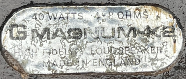

While we wait for some input about the suitability of the lacquer for the coils, I was thinking about the sticker on the back:
I’ve kept it there because it’s part of the charm, but I should probably label it correctly now it’s been modified.
What would be a sensible thing to label it with now? 8ohms? How many watts? Not really sure how the relationship between the drivers works and how to determine the new maximum wattage and ohm value?
You measured the DC resistance of the bass driver as 6.5 ohm. Adding on one third of that figure, as is the rule of thumb, suggests a nominal impedance of around 8 ohm.
The power handling of the bass driver will not have changed.
Even your mid's DCR of 5.4 ohm indicates it has a highish nominal impedance of around 7 ohm.
And then, at certain frequencies. the impedance can drop below the nominal value.
Consequently, I would leave the label exactly as it is 4 - 8 ohm/40W.

I’m ready to rebuild these coils but I think I might put that on hold and work on the grilles instead. Varnishing coils with any sort of varnish I imagine is a fairly 1 way road so don’t want to start if it’s a no go.
When you rebuild your ferrite rod coils, why not cut a couple of squares of plywood, or what have you, drill holes in the middle of them to match the diameter of the ferrite rod, then glue them onto the rod to provide supporting end 'cheeks' which will retain your coil windings?
A sort of homemade bobbin I mean, and no need for varnish. Simply drill a small hole in each wooden cheek through which to pass and help secure each end of the insulated copper wire.
