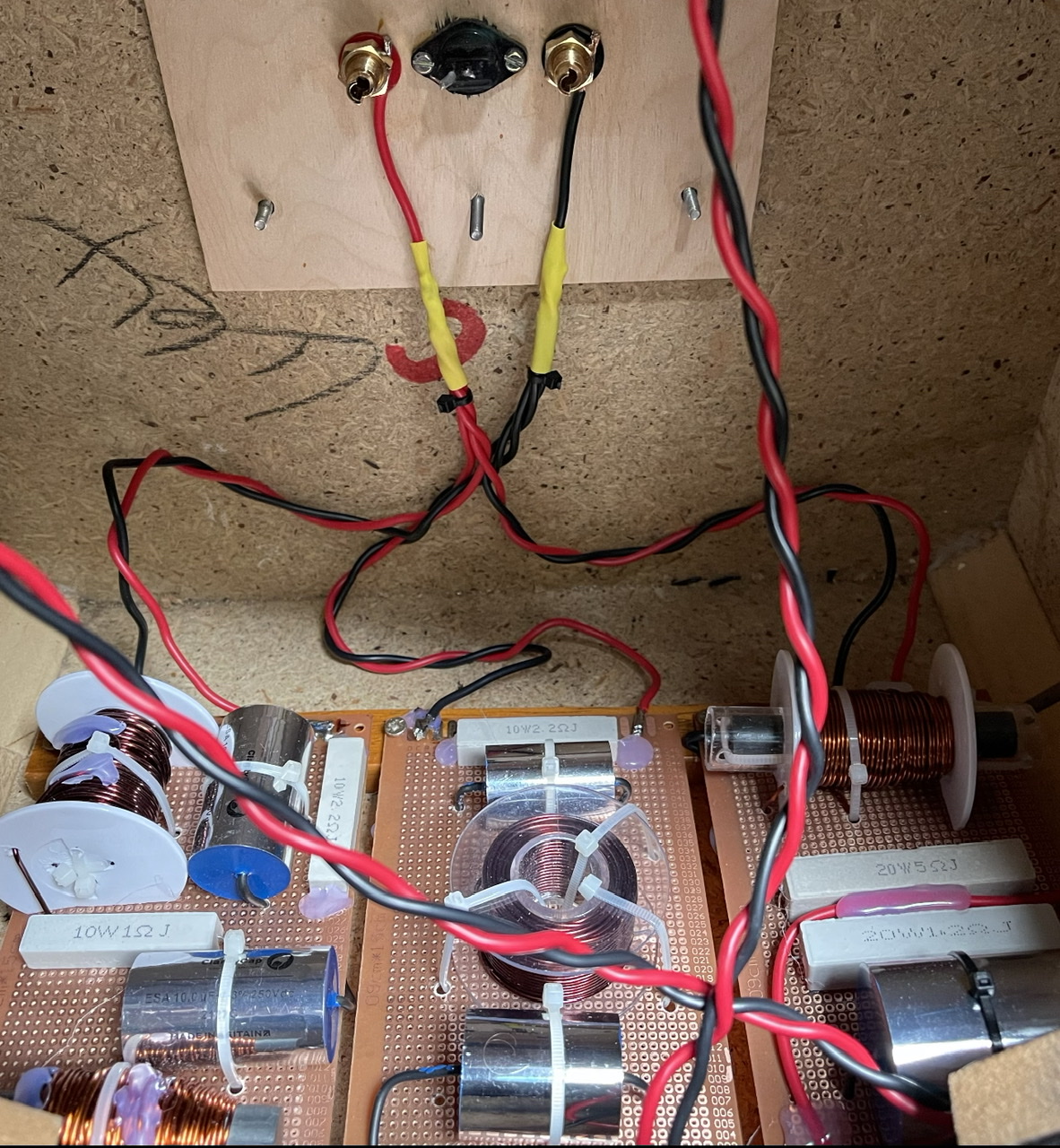

My first thought was that I’d made a mistake in the crossover.
I checked the component values: caps and inductors (using LCR meter), resistors too. I also checked for errors in the circuit. I rechecked, then the Mrs checked too. We’re both confident the crossover is as the diagram is. 2mm wire was used between the crossover boards and drivers (overkill I know but it was in the shed), soldering is shiny, flux was used, no dry or dull joints. Not the absolute tidiest arrangement but I’m confident nothing is loose, shorting etc. We also looked at the position of inductors and other components to each other: inductors are spread out and at right angles.

The usual reason for a lack of bass and a vague midrange is that the bass drivers are wired out of phase with each other.
It couldn't be as simple as that, could it?
Your work on the actual crossover boards is very neat and no doubt accurate, but you may just have the wires to one of the woofers the wrong way round.
It's worth checking!

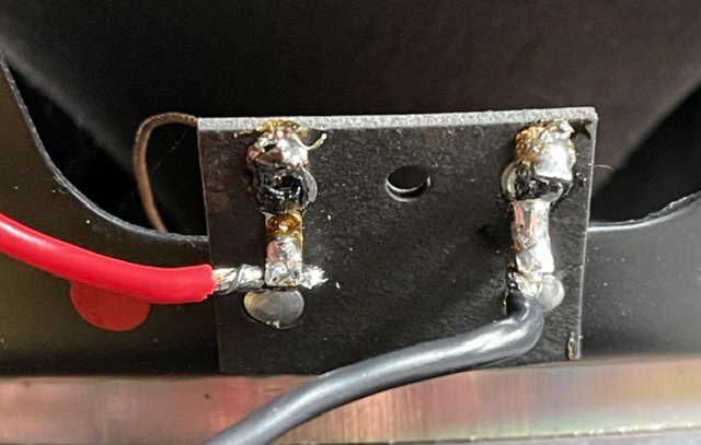

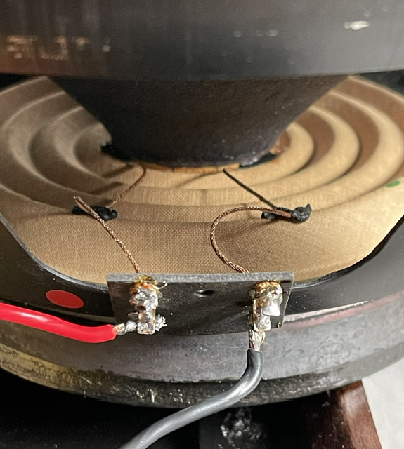

Now about the possible incorrect polarity of the bass drivers, I tested at first as you suggested Steve and it didn’t seem to cancel out. Sat side on to them with them so close though, it seemed a bit better but obviously cannot leave them like that!
So I removed both bass drivers and this is what I see:
Both drivers are the same, the red dot on the same side indicating positive. I double checked while I was there and the drivers positive red wire goes to the correct point on the board.
Unless it’s possible that they are labelled incorrectly? The factory red wire was definitely that side. The red dot couldn’t be the wrong side on both? I don’t know anyone else with a pair of these to check. Surely that doesn’t happen?
I'm just going to contribute to your knowledge base here.The red dot couldn’t be the wrong side on both?
Only if the red dot had been incorrectly stuck on the opposite terminal of one of the drivers compared to the other would there be a chance of reverse phase connection
Looking at your top photo of your woofer, I can trace its 'internal' wiring from the woofer terminals all the way back the voice coil at the centre. There should be no problem if the 'internal' wiring of the other woofer looks the same.
Done. Both drivers move outwards when the red wire was connected to positive. A very clear outward movement.
