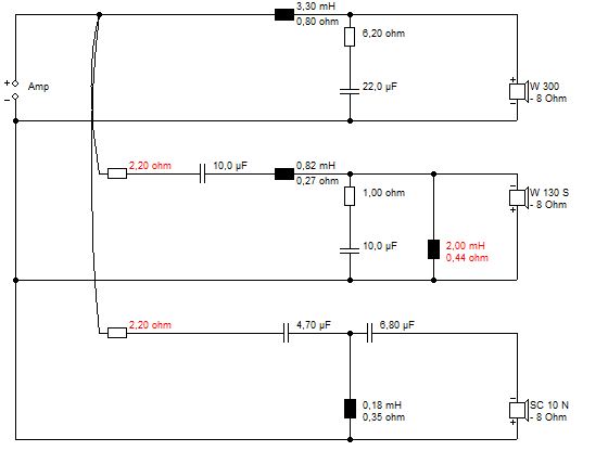

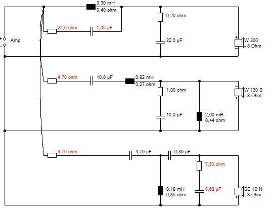

Er, yeah did I mention I wasn’t electronically minded? It would be 2 x 1.64mH inductors 😱
With that said, you’d have to weigh up the increased space required.. it would probably be easier to just use much larger gauge wire and build just one, although I found the difference between just handling the 1.25mm and 1.0mm to be quite noticeable! I’m not sure I’d want to use 1.4mm (for example) to do the same again!
How do aircoil only setups work? How else would you achieve it? Are running in parallel or using larger wire are the only options?
A 1.64 mH coil would have a greater resistance than a 0.82 mH one wound with the same wire diameter, so paralleling would not result in the reduced resistance you expected. It would be more or less back to where it started.
Stick to single inductors wound with the appropriate wire diameter to obtain the desired resistance.
That’s some sound advice. No pun intended. 😀

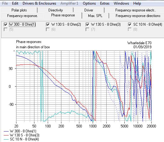

Would the 9V battery check be useful on the mids? Would a mid out of phase cause the same issues? Just trying to eliminate as much as possible here.
Broadly speaking, doubling the number of turns on a coil increases inductance fourfold.
Adding a ferrite core increases inductance fourfold. Er, that's about it! 😀

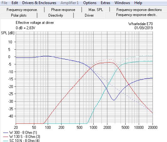

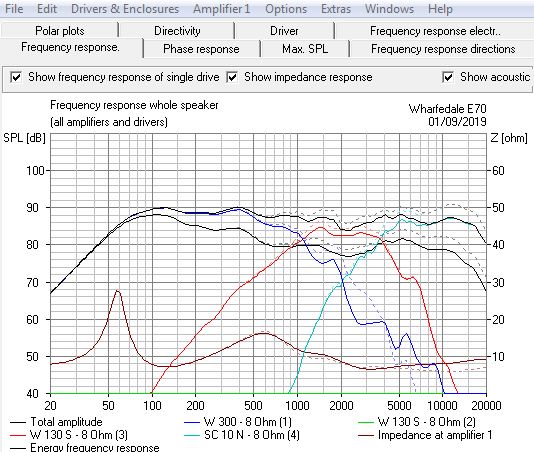

Where we are now on approx. 50L of 12" bass closed box, 5" mid in 5L and 1" soft dome tweeter:
Allegedly no bass. I don't believe it. 😕
Put the speakers up off the floor near the wall and the bass should be OK in my opinion. OK it's closed box bass which is less in your face than reflex. Maybe the mid and tweeter are too loud? We can fix this. Modelling below. Any little glitches are more driver related than crossover related. I am not responsible for THAT! 😀
An almost exemplary Electrical response! 😎

One mid out of phase with the other would produce a vague stereo image, not a depressed bass level.
I wouldn't attempt a battery test.
P.S. I see that Steve agrees with me that the overall sound balance may be achieved by further attenuation of the mid and tweeter.
Yes, it's complicated! 😱Broadly speaking, doubling the number of turns on a coil increases inductance fourfold.
The inductance is proportional to the square of the number of turns.
If the length of wire is multiplied by √2 (and this multiplies the number of turns by √2) then the inductance is multiplied by √2 squared = 2, while the resistance is only multiplied by √2.
(√2 = 1.414 for calculation purposes)
Ok an update:
Room size: 5m x 5m
Position: further most left and right about 30cm from the forward wall
Height: 40cm up
The bass is improved but I still have to crank the bass dial up when in most places in the room - especially when front centre or standing in front of one cabinet.
The only time it is improved is when a standing directly in between the cabinets. When standing in between the cabinets, the bass full and rich with much less of the bass dial (but not no bass dial). This is starting to look more like a limitation of the drivers, and maybe we just positioned ourselves advantageously when we tested them before starting modifications. Not really sure when I would be standing in between them apart from to dust the coving. Would this likely have been solved by replacing the bass driver as you originally suggested Steve?

Your sealed box speakers may benefit from being closer to the rear wall, but you should attempt to position them as far as possible from the side walls.Position: further most left and right about 30cm from the forward wall
Try to place them 2 to 3 m apart, symmetrically in relation to the listening position.
Due to room acoustics, it is normal for the bass level to vary according to position in the room.
Here's a good source of information: Loudspeaker Placement Part 2: Fix The Bass And Define Your Sonic Space by David Smith, President And Chief Engineer For Snell Acoustics
In most rooms you will hear dramatic differences as you change position. The bass will always be stronger in the corners and generally weaker in the center of the room. If you want to hear more bass you can always sit in the corner or against a wall. At the same time moving the speaker into a corner or against the wall will increase the bass even if you are sitting in the middle of the room. But our primary objective is to have smooth bass, rather than just strong bass.
So here is your first tuning hint: move your loudspeakers (or your listening position) to modify the bass for maximum bottom end smoothness.

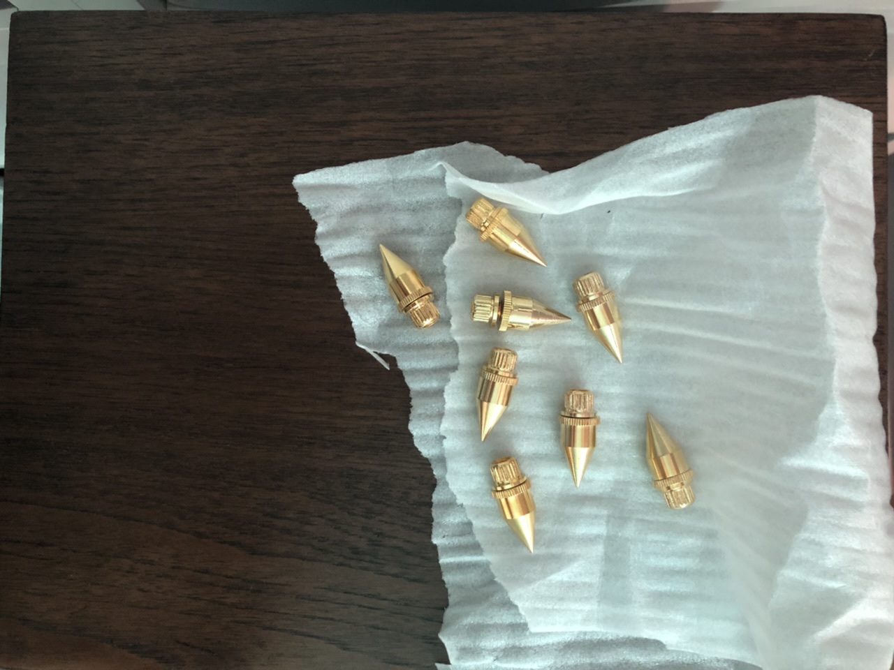

Spikes are overrated, IMO. I just use 4 rubber feet to protect the woodwork. Cheapest lace I know is Poundland's "Skid Protectors" for furniture at a, er. Pound! 😀
B&Q charge £5 for four, which tests my credulity! 😕

I usually design for a bit of easy adjustment to the overall sound, but assume generic sorts of drivers.
The tweeter filter is pure Celestion Ditton 44:
Some influence from Troels Gravesen too:
SEAS-3-Way-Classic

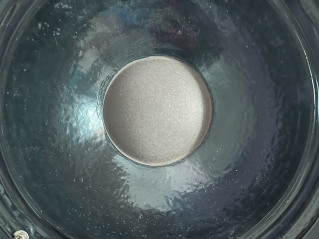

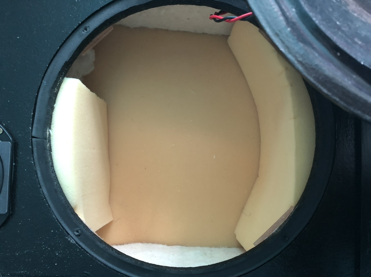

Quick question about this:
The centre of this cone is just a dust cap, right? Can it be very carefully and lightly coated in PVA to turn it black? Or is that a really bad idea? It’s just aesthetics but I have a totally black front apart from the grey of the centre of the bass cones and some of the screws which I will eventually change. Any ideas on blacking those out would be appreciated.

I wasn’t sure about that foam, heat wise. Yes it was in direct contact with the original goodmans crossover, but that was a different animal. I have placed some of the foam directly over the new crossover, but not touching the coils. To make sure it was suitable I put a small chunk on a paving slab and heated it with a heat gun in one hand and with an IR thermometer in the other hand checked the temperature of the surface. It got to just over 200C before scorching. So I am happy.

The centre of the woofer cone is a dust cap If it is porous and intended to 'breathe' it would be a bad idea to seal it. If it is solid, I would give it a light spray with acrylic matt black paint from an aerosol can, after masking off the cone of course.
I'm not sure that placing the foam so close to the woofer cone is a good idea as it may overdamp the woofer and reduce its Q, making the bass less prominant. Some experimentation may be required here.

The centre of the woofer cone is definitely paper. I’ll leave it well alone. I wouldn’t want to get this far then break the woofer because of appearance!
I’ll test and experiment with the woofer foam. There was quite a considerable amount in the cabinet before. Not all of it has gone back in due to the position of the mid enclosure. So far I haven’t noticed any negatives but I’ll do as you suggest and give it a good caning over the next few days one with and one without to check.
