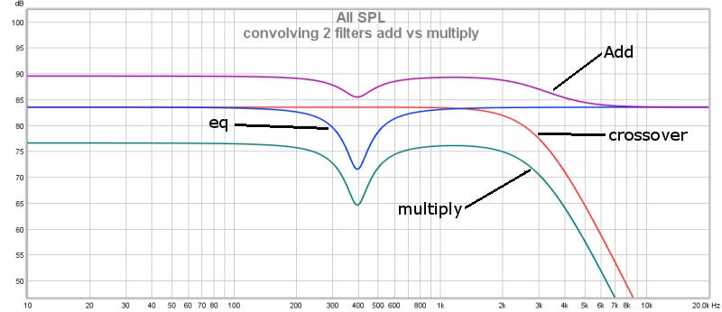

You need to multiply the responses that are to be convolved, not add them.
thanks. Multiplying seems to give the correct response.
when multiplying, does the decibel level stay the same or is there an increase?
I think I answered my own question and its that the decibel level stays the same.
It really depends on if the filters whose IRs you are convolving have any gain or not.I think I answered my own question and its that the decibel level stays the same.
I use rew v5, 19 beta 4.
Tried with A*B under All SPL, Trace Arithmetic, generate.
The result was clearly wrong.
The A+B gives credible results
That seems logic. Just don't understand that sum gives such credible impulse responses?
The math is inarguable, though. But I think that one can construct an example that shows the differences quite well. Convolving filter IRs gives the IR of a filter equivalent to the two original filters cascaded. Summing them in REW is equivalent to the two filters in parallel. Suppose those two filters are notch filters. Neither notched frequency will get through the "A*B" while both notched frrequencies will get through the "A+B"
copy that. I guess it was a knee jerk reaction because if you do a multiply in REW it adds about 83 dbs !!! 🙂

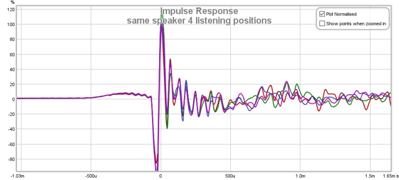

It might be a good idea to make multiple measurements around a sweet spot and sum them to an average. There's a couple of methods that were discussed in this thread a few pages ago. That would give you phase information without a strong room bias. The averaging of those measurements will lower or rather average the room addition's effect on phase.
Every bump created by a reflection in the IR is where phase response also changes.
If the MMM gives you a good tonal balance, and that single point measurement does not, there's a good chance the influence of the room is the difference between the two. So to get the best picture of phase why not try a similar method.
The discussion started here:
http://www.diyaudio.com/forums/multi-way/221434-rephase-loudspeaker-phase-linearization-eq-fir-filtering-tool-141.html#post4920173

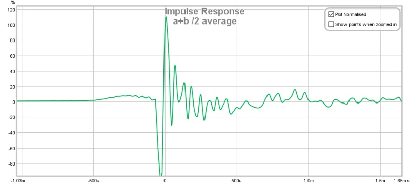

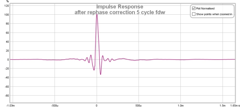

here is an update on this. first thanks for suggesting it. I actually like it a lot and I like the sound quality. I am doing 4 measurements and you can definitely see some areas that are persistent among all areas that are effectively removed after fixing.
I am currently using 5 cycle fdw.
after creating the averages, final impulse response
after rephase correction
