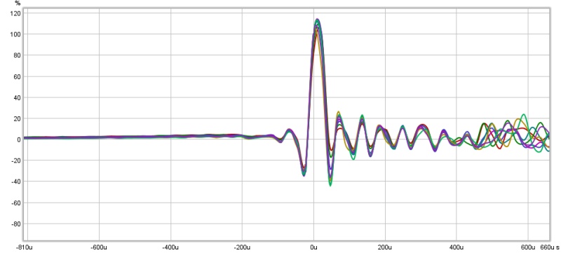

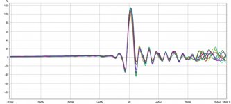

Could you show the impulse response in the 4 original measuring points with the common correction filter?
I also wonder how many degrees the correction is making the response better and not worse?

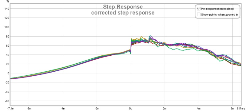

is this what you are looking for? this is the filter applied and then measured at 8 random positions(left to right) on the listening couch
why would you think the correction could make it worse?
This method using multiple points averages out the response of the room that's specific for each measurement. Not a bad way to go at all. This way you're not fixing something that's quite specific for that single point in space.

To me it looks like a windowed measurement. Short window of 0.5 ms.
After 0.4 ms it looks like the waveforms are random.
As if the filter tried to correct white noise after 0.5 ms
I guess you have mostly corrected magnitude and phase response between tweeter and mid?

That's the point here. Don't fix random reflections. Fix speaker FR and phase. Compare it to an unfixed response at several points similar to these measurements to see this really works. 🙂

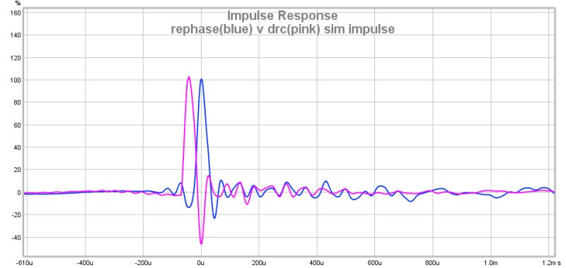

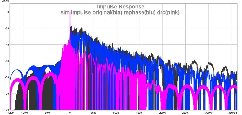

ok, so I do have have absorbers in the room and will add more but I still have an interest in using dsp to reduce the influence of the room.
rephase does a great job fixing the speaker response and the sound is fantastic. it seems DRC (obviously) does a better job of removing the room, but not so great a job at fixing the speaker response
long time frame it seems drc wins(these are very aggressive settings that Ive not listened to)
speaker response rephase wins(ive listened to this and it sounds great)
