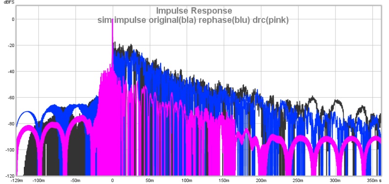

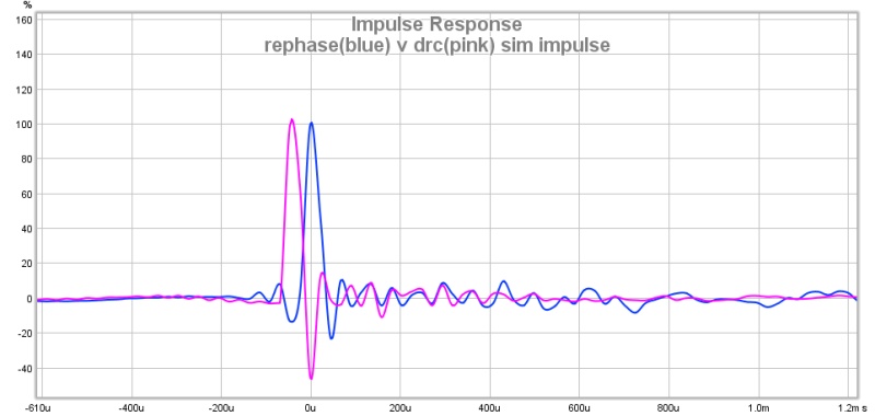

ok, so I do have have absorbers in the room and will add more but I still have an interest in using dsp to reduce the influence of the room.
rephase does a great job fixing the speaker response and the sound is fantastic. it seems DRC (obviously) does a better job of removing the room, but not so great a job at fixing the speaker response
long time frame it seems drc wins(these are very aggressive settings that Ive not listened to)
speaker response rephase wins(ive listened to this and it sounds great)
