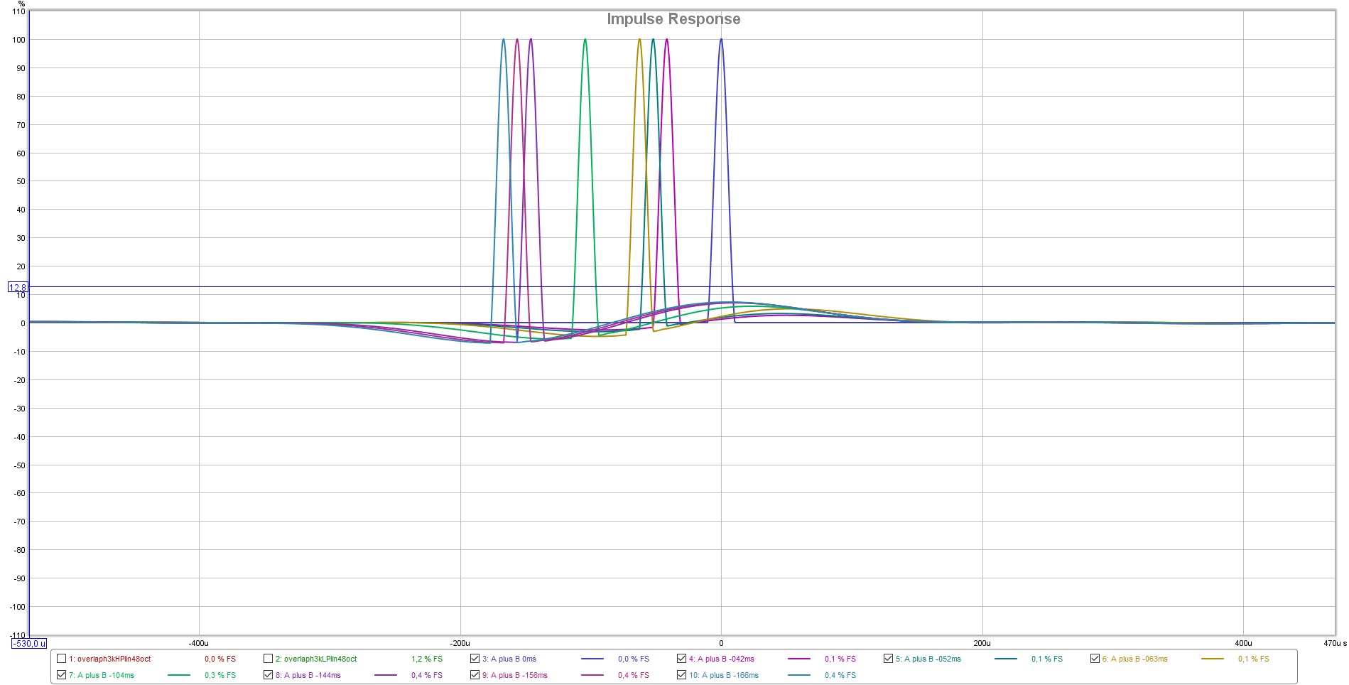

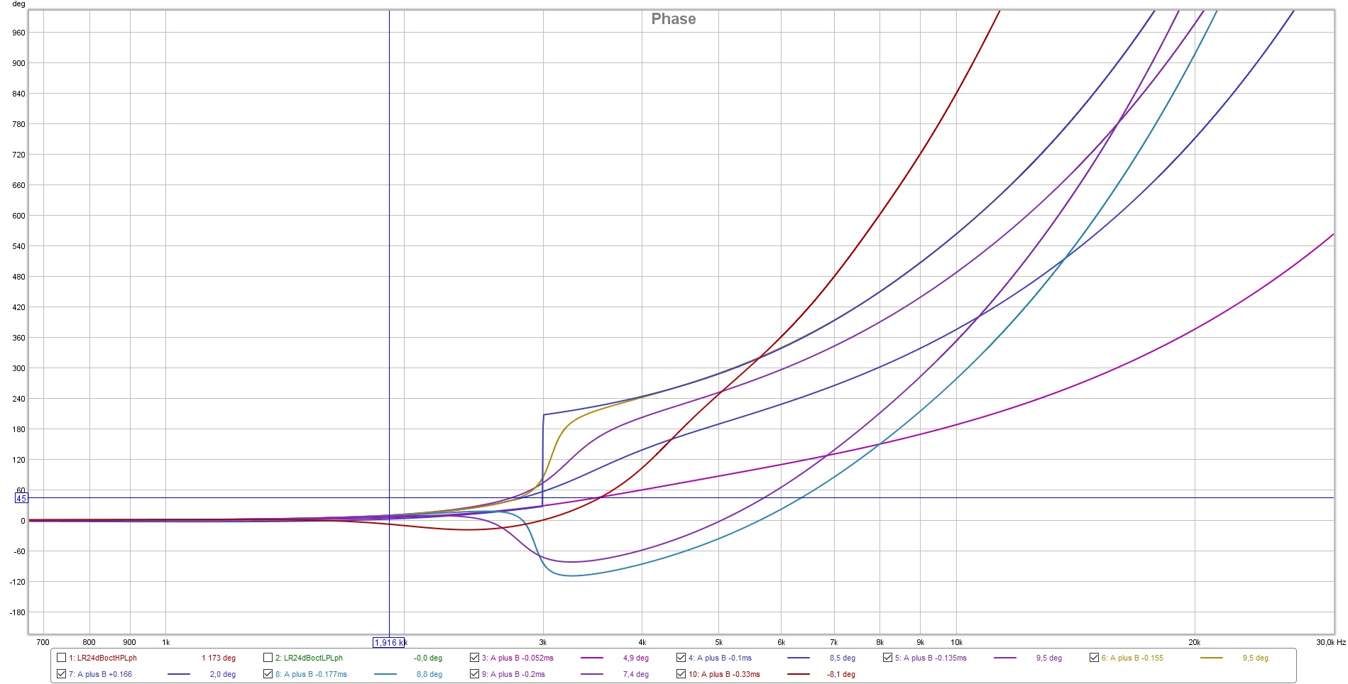

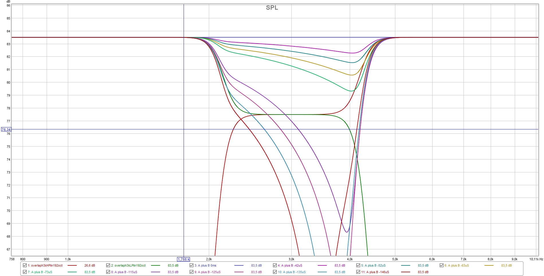

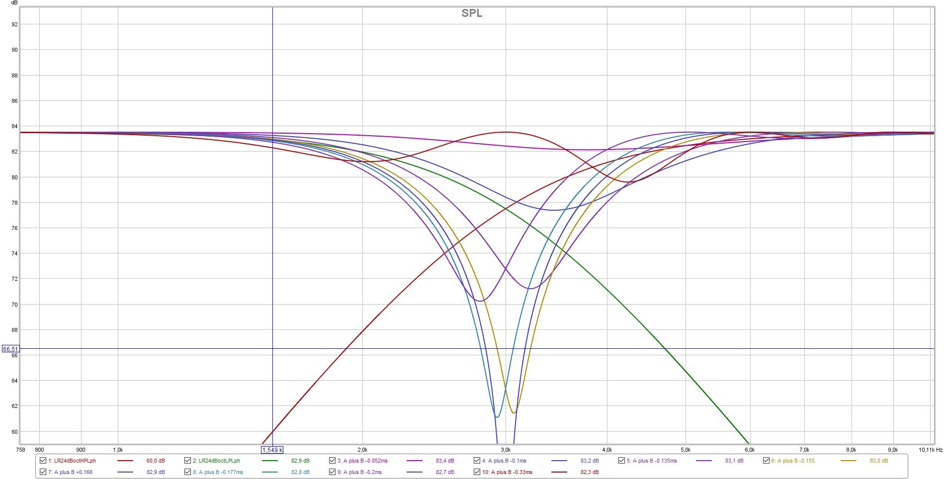

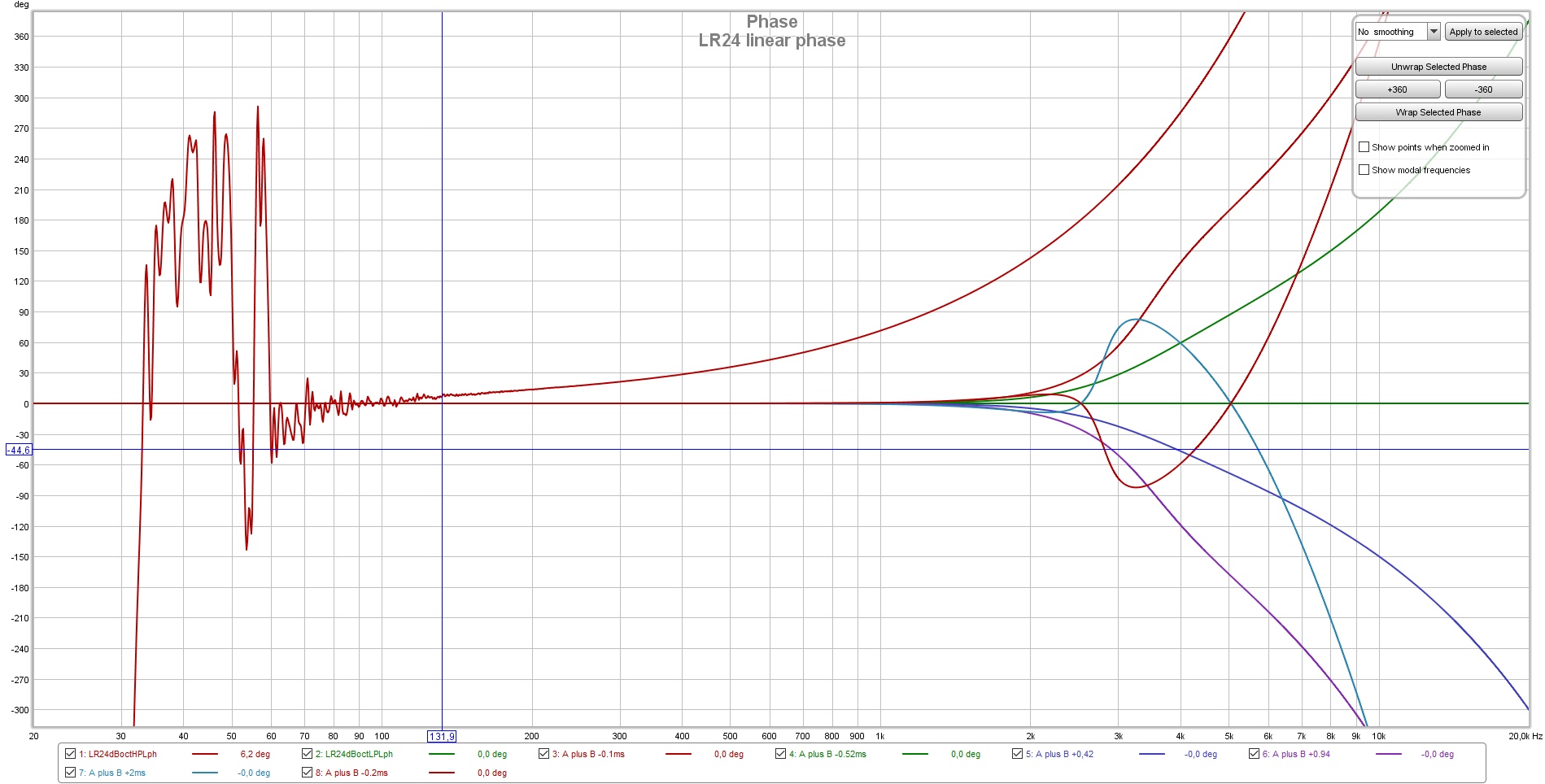

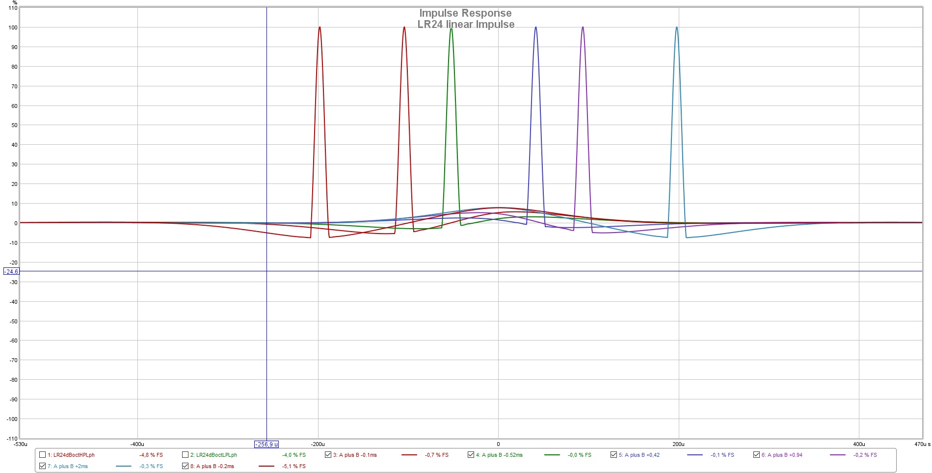

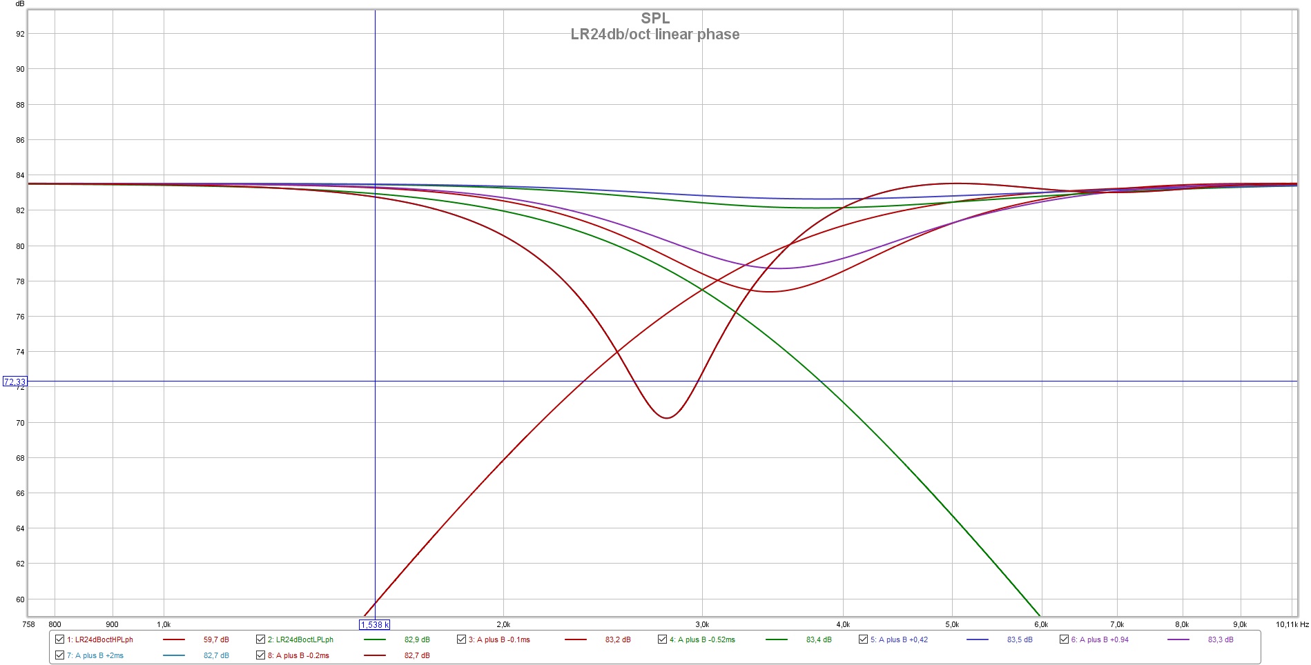

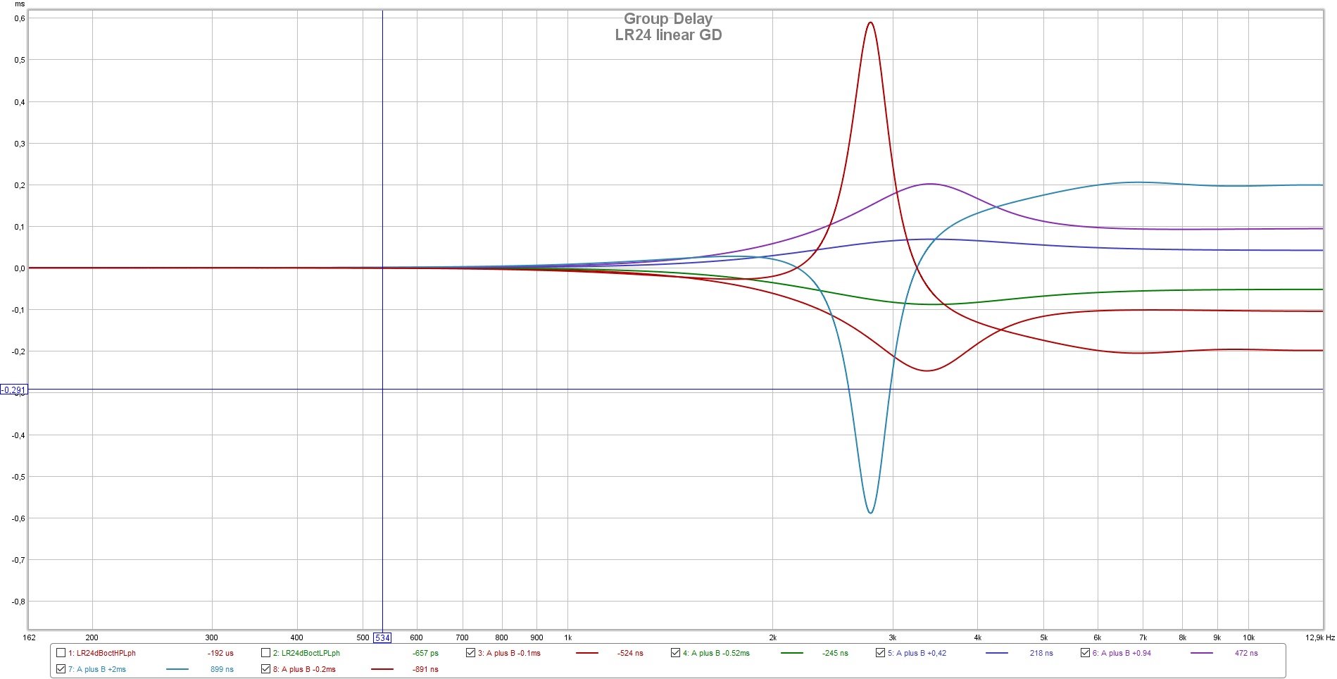

Just tried to shift the HP section of a LP/HP 3k LR linear phase filters.
Don't think it is artifacts🙂
But shifting up to +/- 0.2 ms really shake up the responces.
Even 0.05 ms, that is 1.5 cm dampens 1 dB.
Think the pictures are pretty self explanatory

Sure, 0.2ms is huge at 3k. I mean, 3k period is 0.33 ms, so @ .2ms you have 216 degrees of phase misalignment. Don't even need pictures, it's gonna suck !🙂

I really like to keep it intuitive....so I say ok, 0.05 ms divided by 2ms (period of 500Hz) X 360 deg = phase rotation = 9 deg
Then I compare degree rotation to phase wheel summation to know what to expect.... ....https://engineering.purdue.edu/ece40020/LectureNotes/Chapter_2.pdf

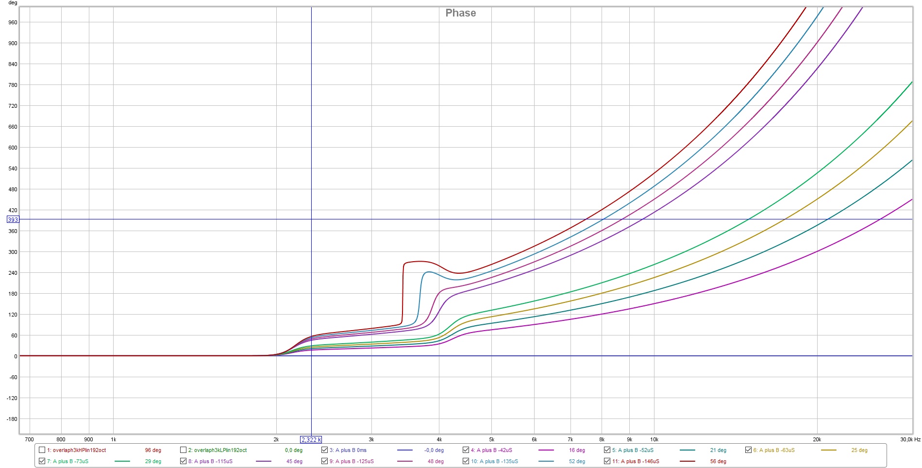

Enclose pictures what happens when going through the suckuot of inverted phase. -180degrees
Adjusted 1 and 1 sample, that is about 0,011ms or 4 mm distance.
Think I have been to sloppy on placing my tweeter when setting up quick prototypes.

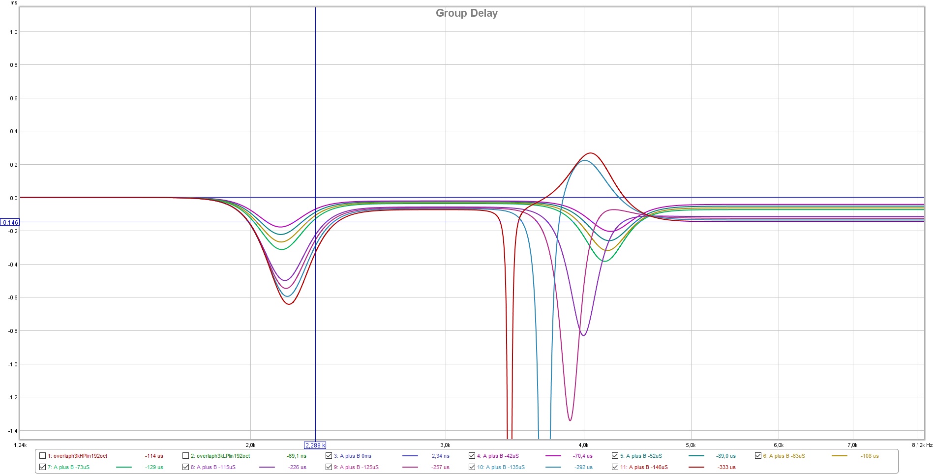

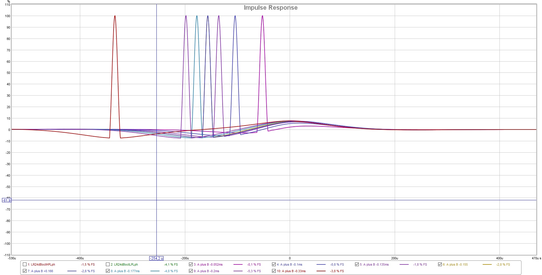

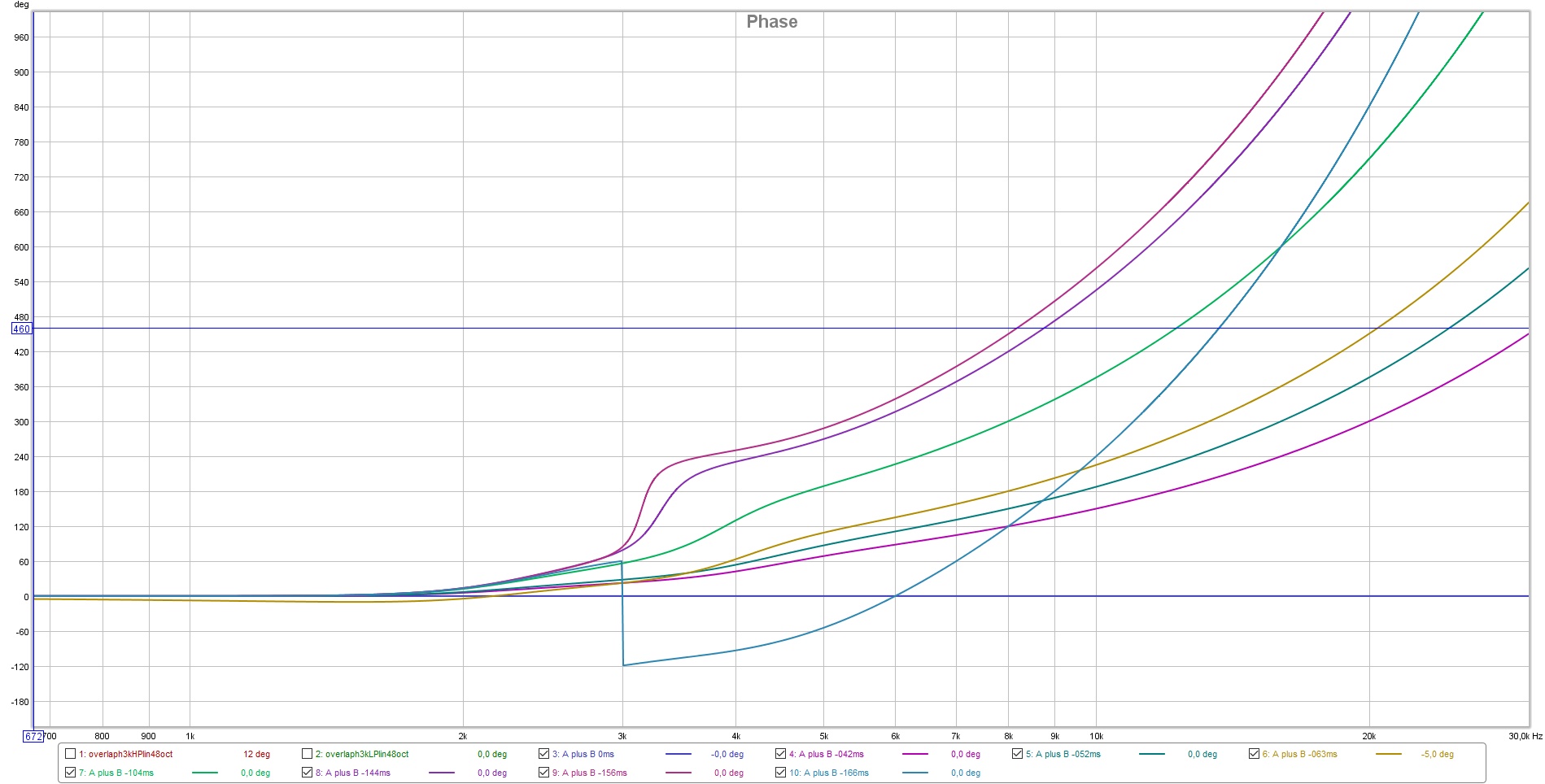

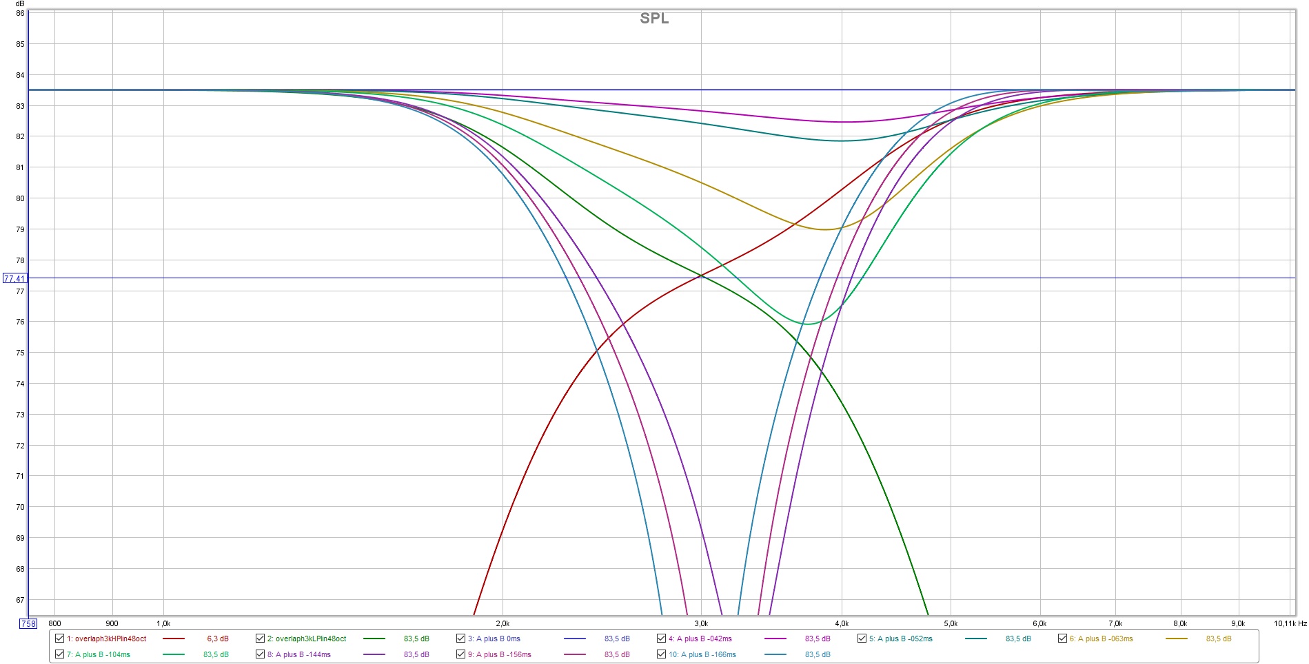

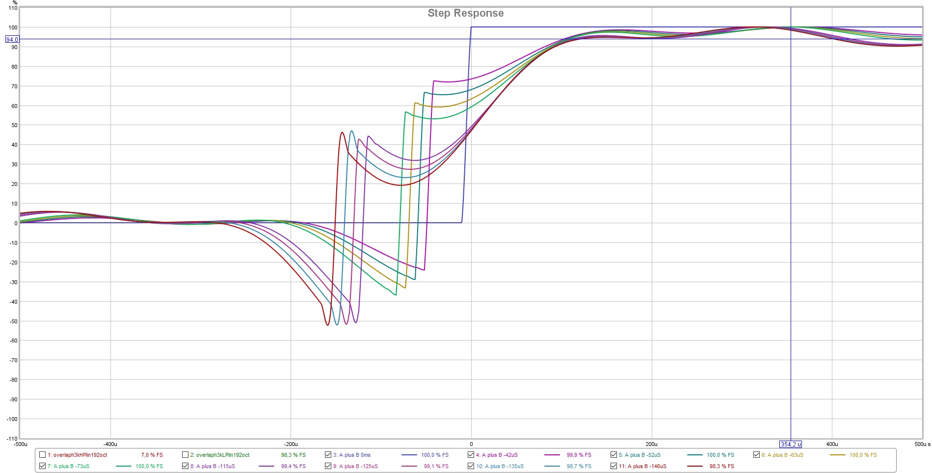

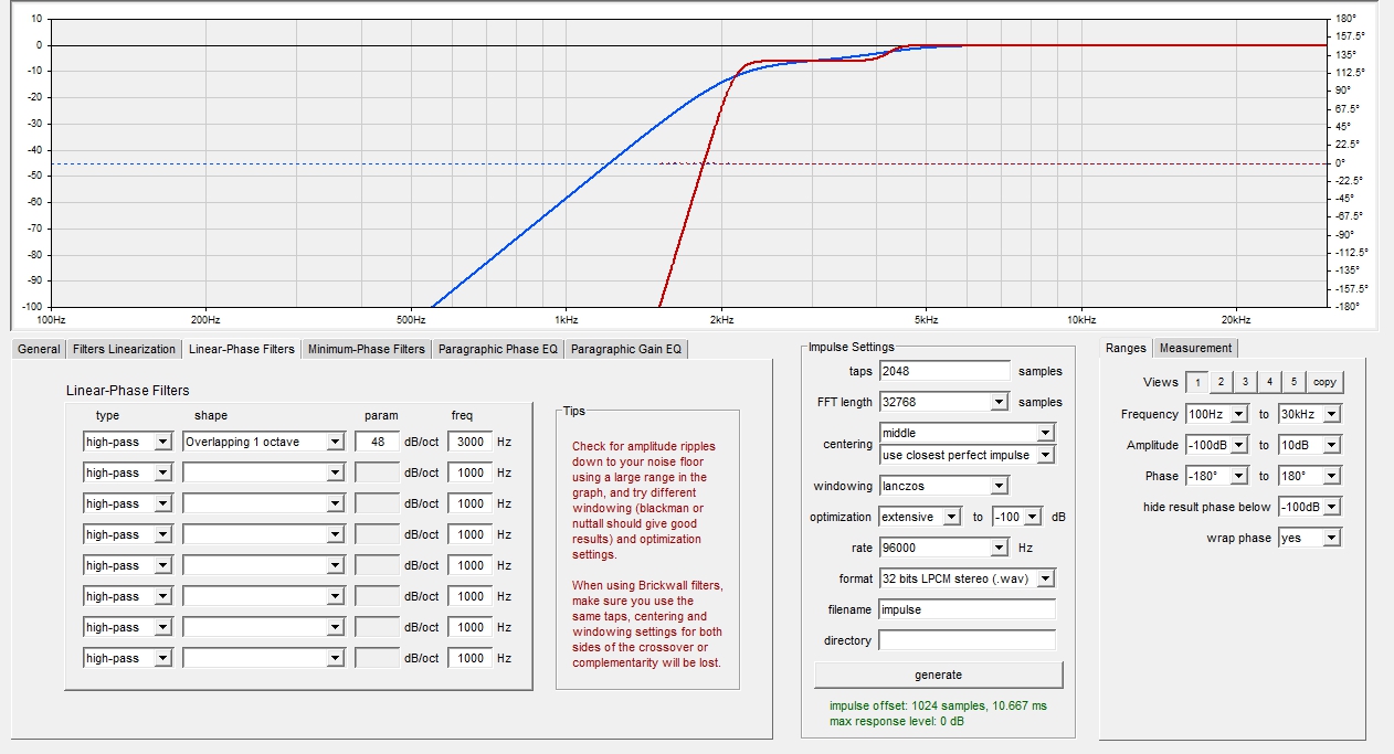

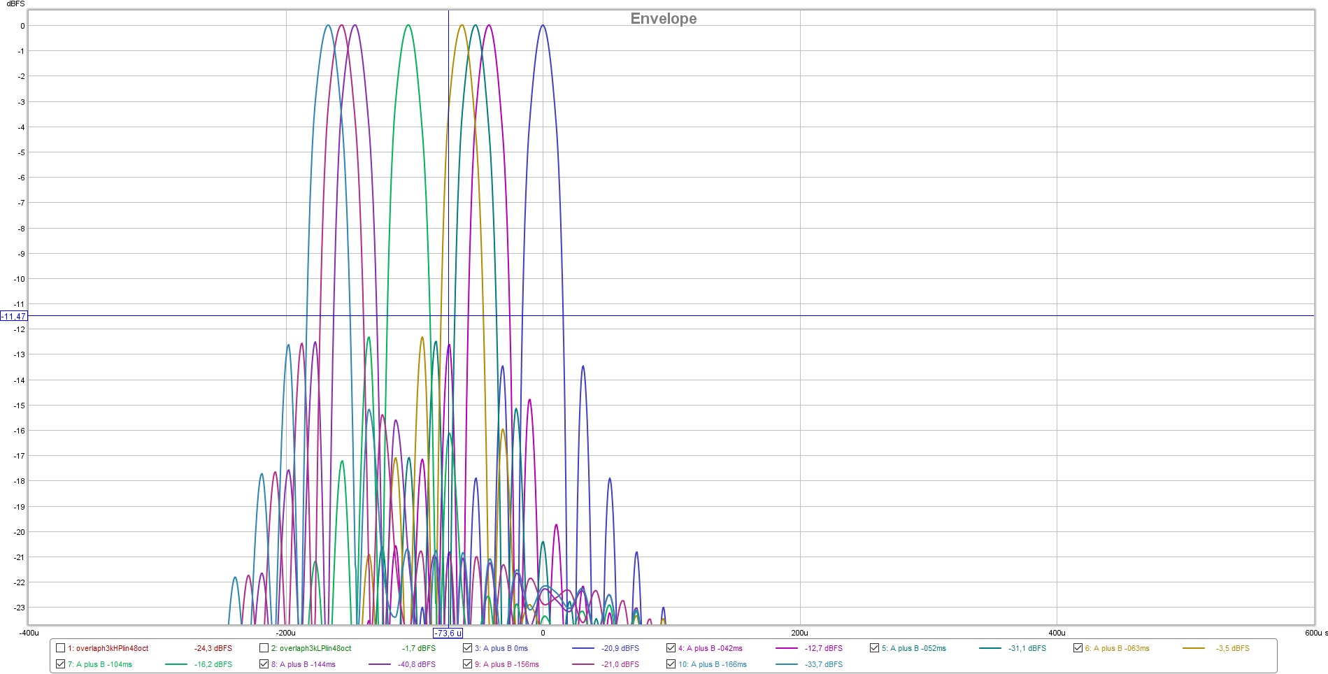

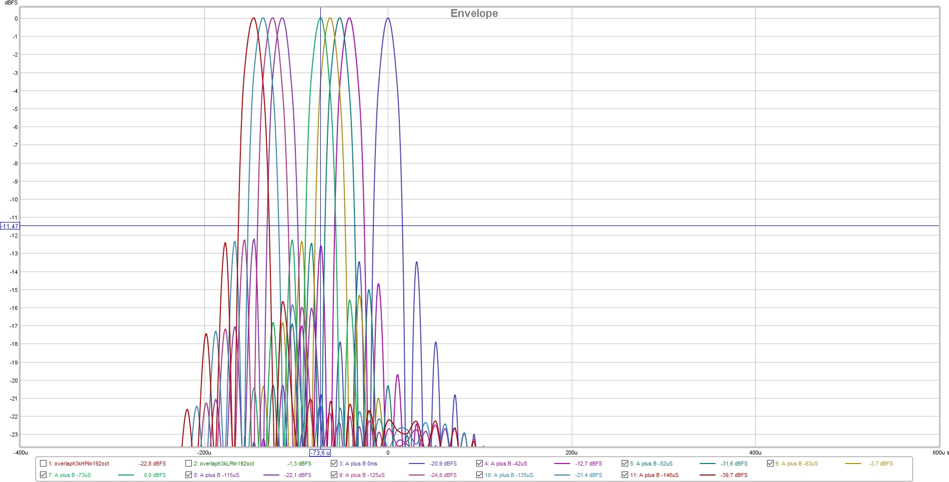

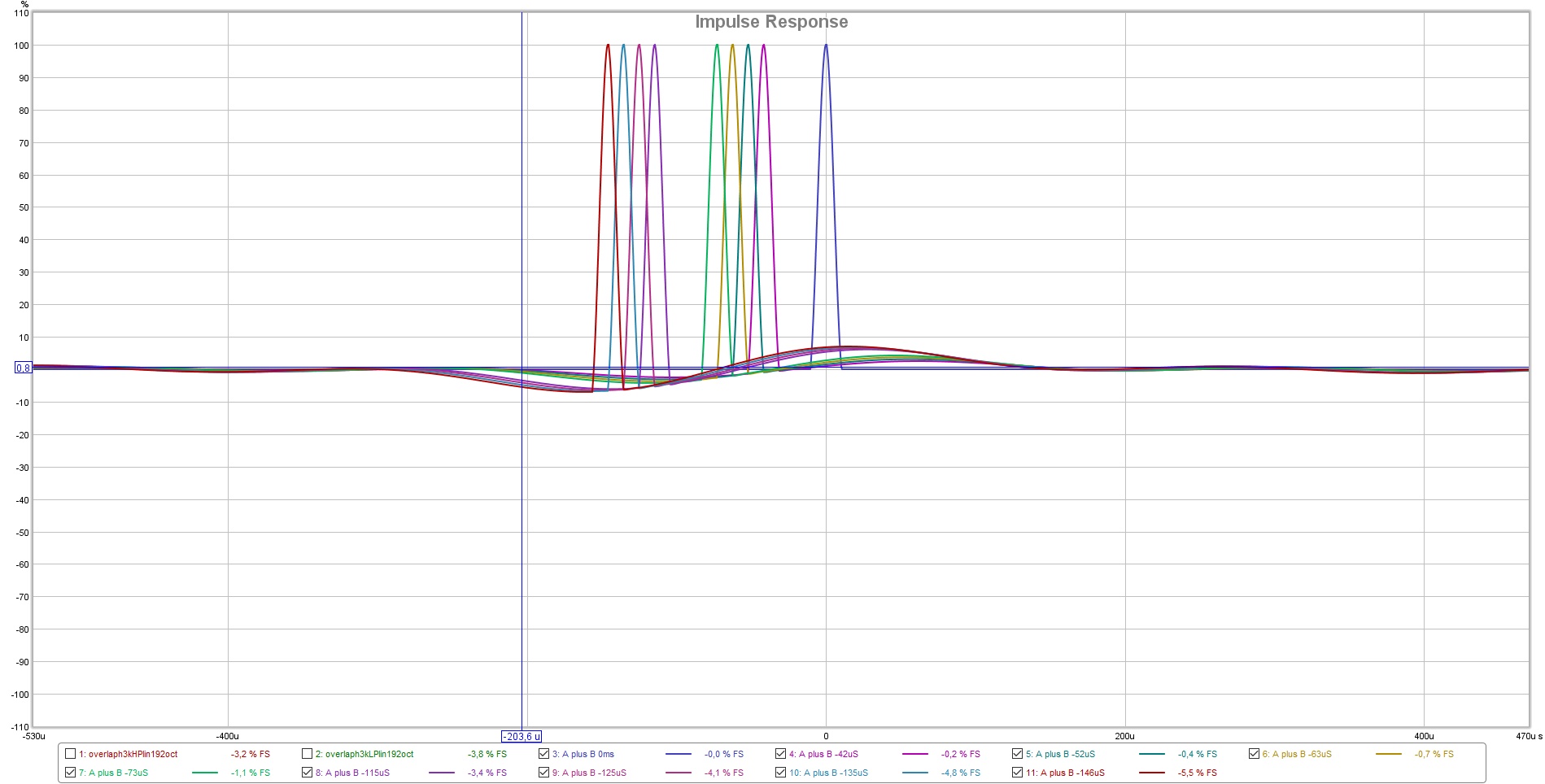

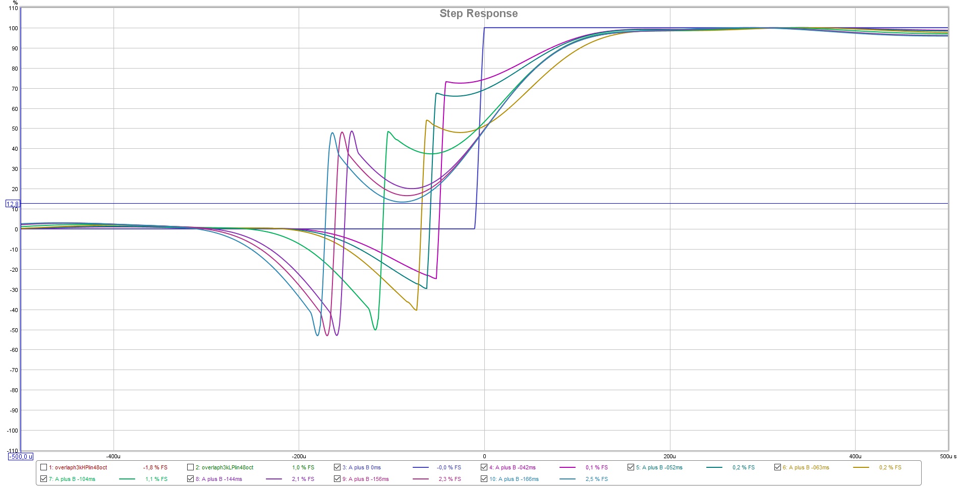

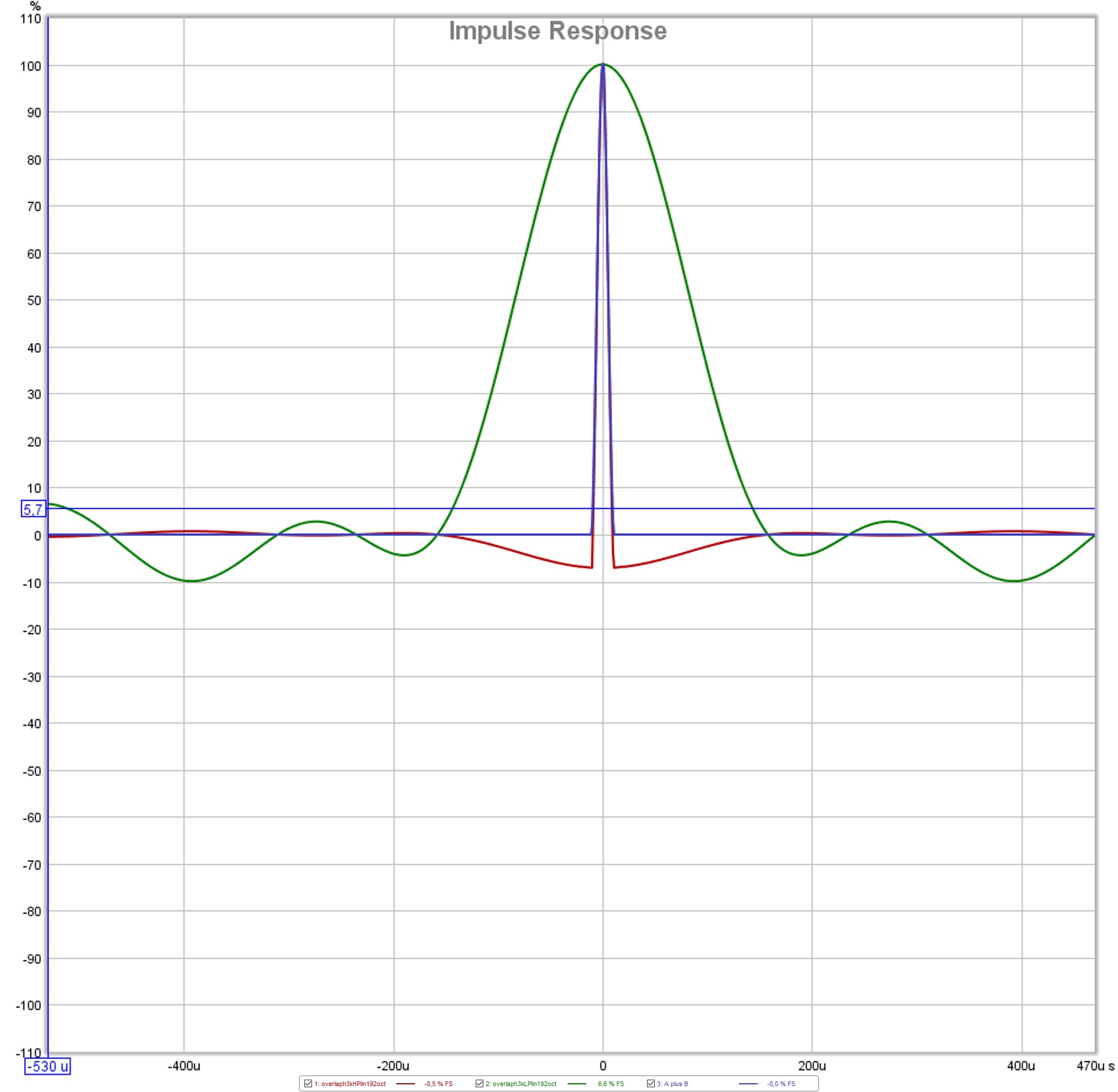

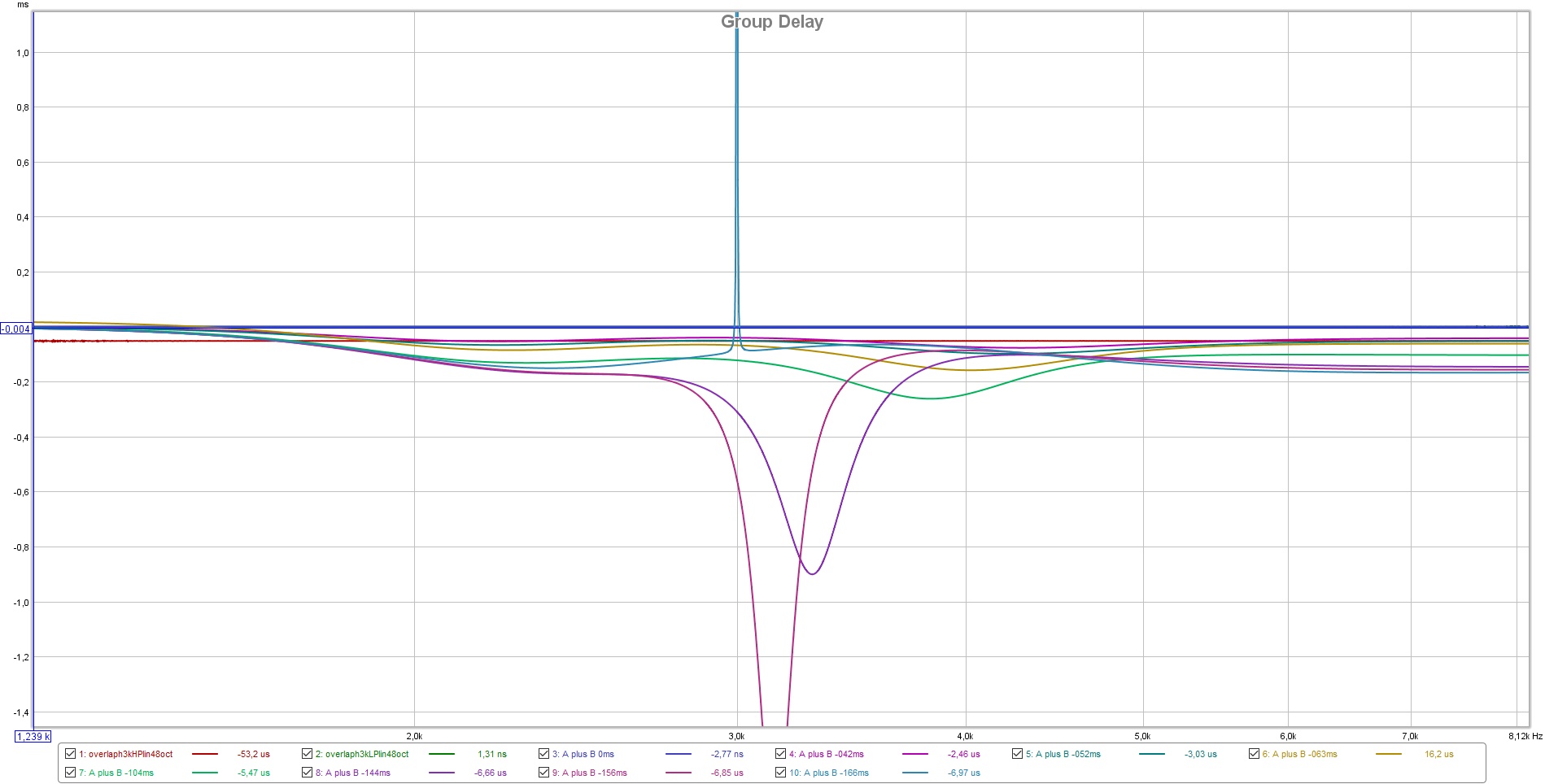

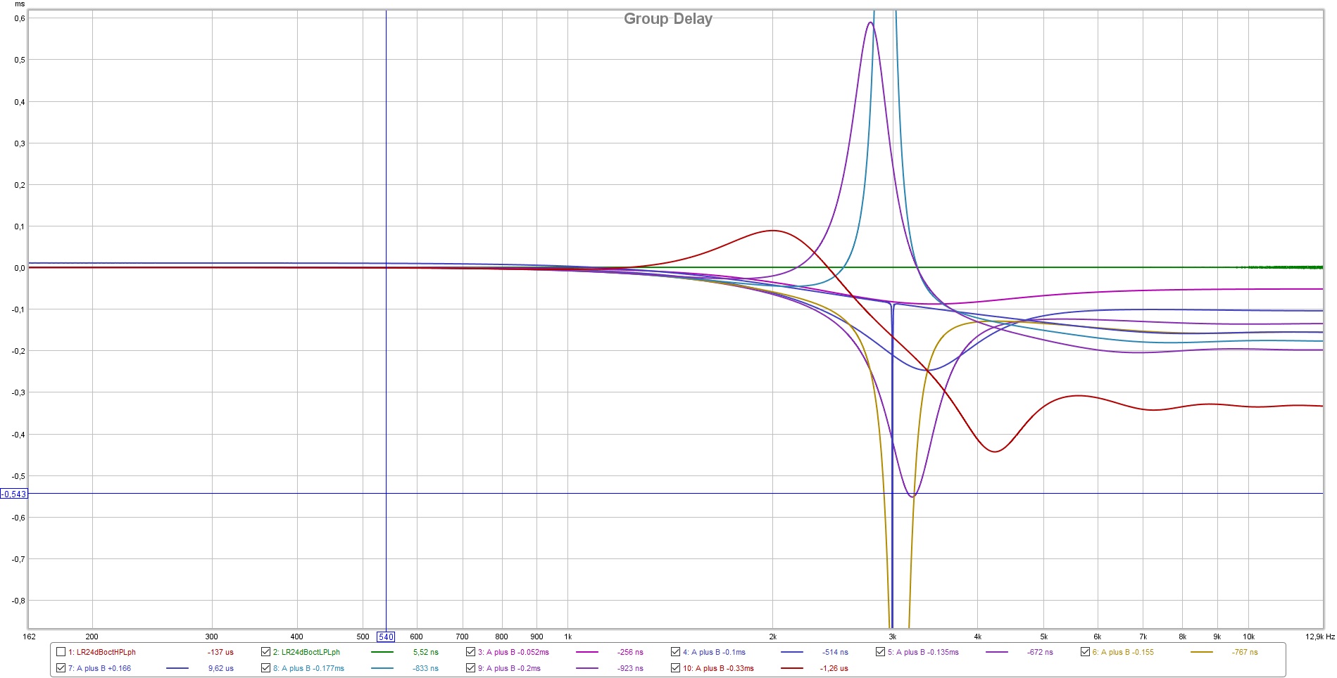

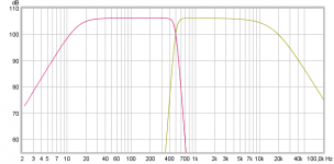

Tried 48dB/oct overlap and 192dB/oct overlap (next post) also.
Went from 0 to 180 degres out of phase of the two filters by introducing a delay on the HP filter.
Made more simulations in the transitions from small to large SPL deviations and round 180 degrees
3k Hz that is about 11 cm wavelangth and period of about 330 uS.
So 180 degrees out of phase is about 55 mm path difference, 165uS delay
At about 63 uS delay the SPL is -3 dB down, about 20 mm path difference.
I set 96k sampling so one sample is about 10uS or 3.4 mm
So it is only 6 samples delay before we are down at -3dB
Not sure about the real benefit of looking at the step responce, but a amplifier designer would worry if he had these amounts of ripple. Of course no stability issues here🙂

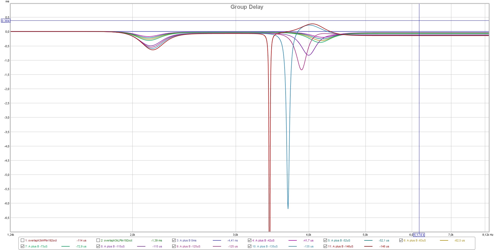

At 192db/Oct the inverted phase GD is extreme in a very small band, where the SPL is way down. Maybe artifacts at special material? (Artifacts: I mean noise or 'unrelated' sounds).
Wonder what happens with cabinet diffractions with that kind of group delay?
Inside dalay window, with accepteble deviation in SPL, the GD looks OK.
To me it looks like the window is larger (a samle more of delay) at 192db/oct. But when it gets bad it really gets bad.

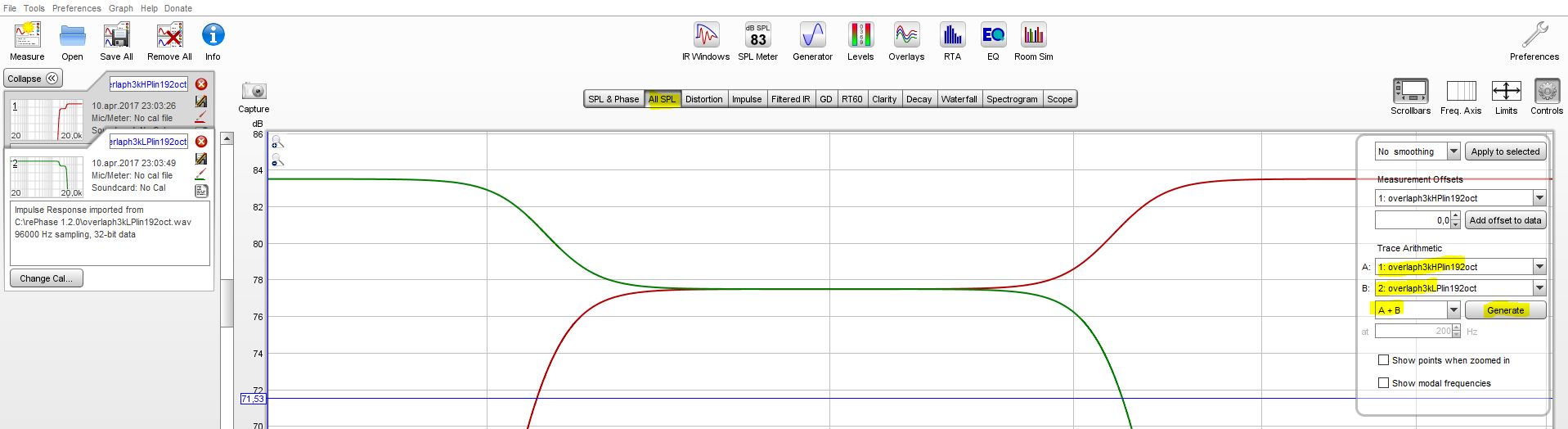

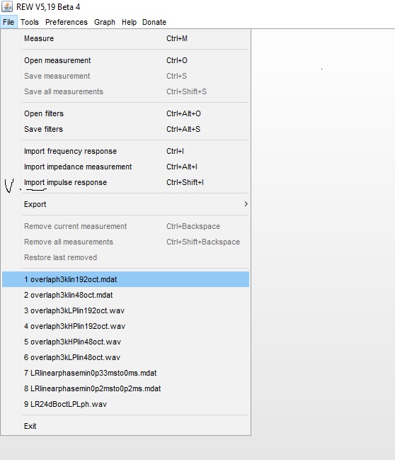

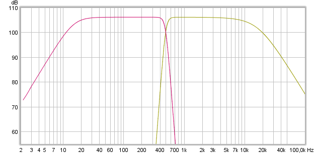

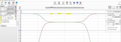

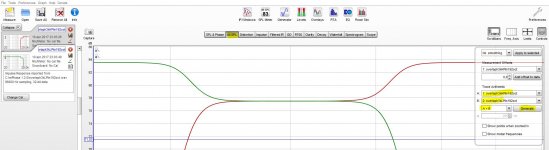

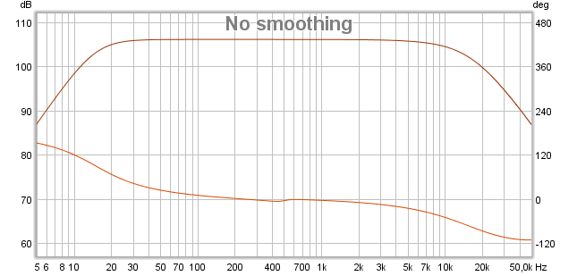

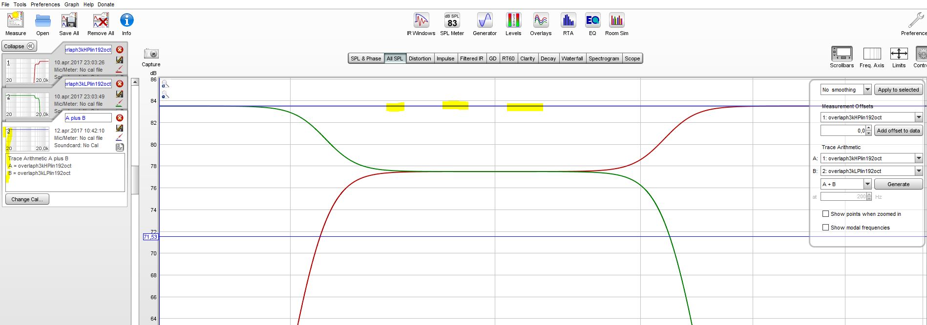

REW:
Import impulseresponses.
Convolution in time = multiplying in frequency = adding in dB in frequency
So adding the SPLs together (actually SPL AND phase) will be the same as convolving the time responses.
Then I guess you can export the new impulse response.
The pictures explaines the steps better.
There might be some issues with windows for very short filters.
