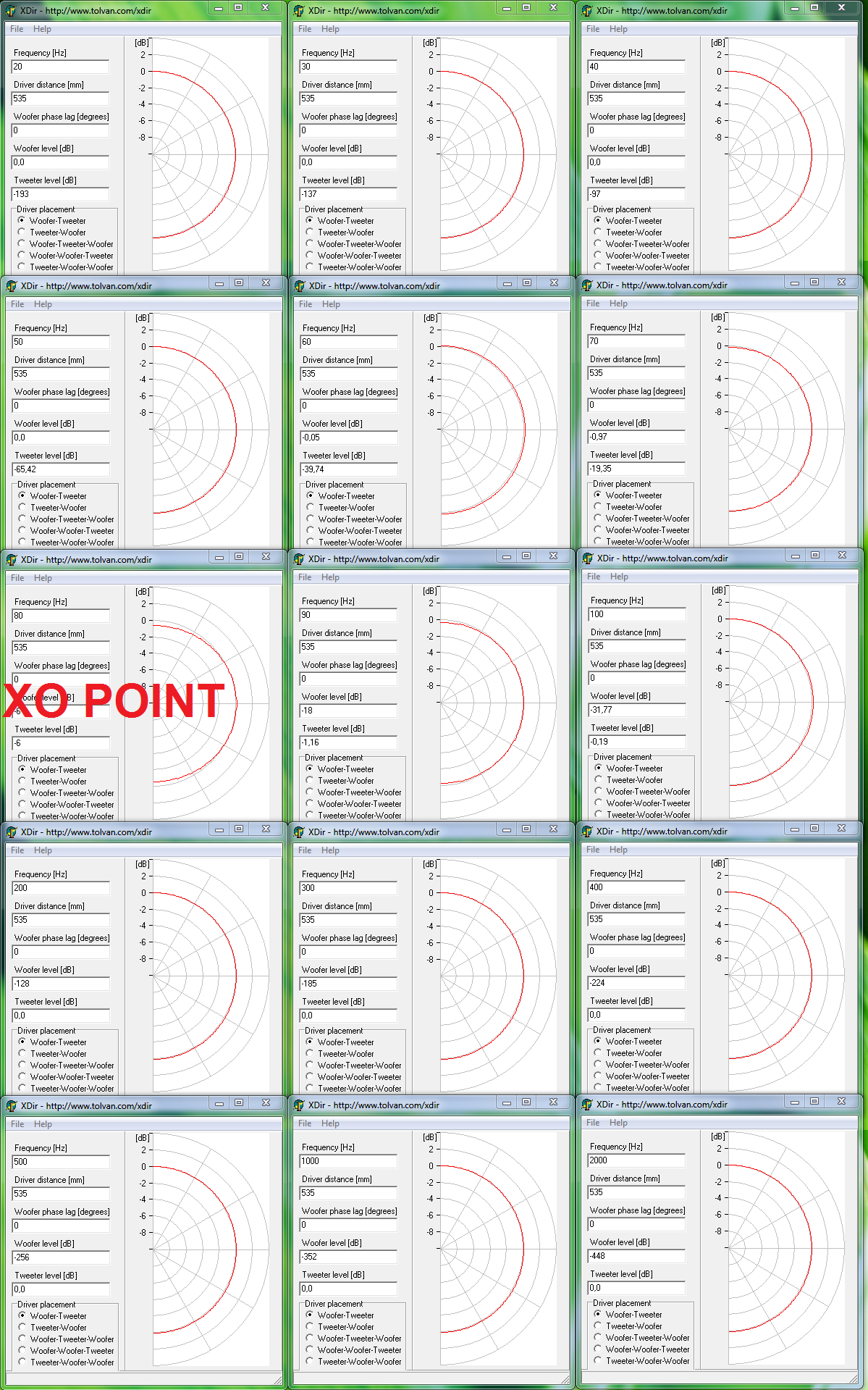

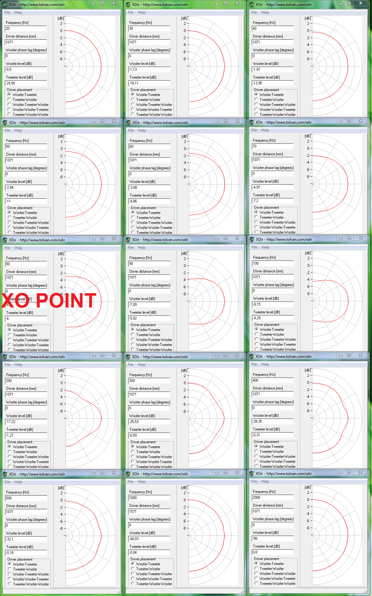

Subwoofer filter LR 8th order at 80Hz verse linear phase inside a 20Hz-20kHz IIR pass band.
attachment.php
Taking care of in design spacing distance to improve inter driver distances when moving off axis think should make also steep FIR filters work, mark100 mention coxial and wesayso have mentioned Synergy which will bring spacing very close but also as in above 80Hz example there should be possibility real life to get driver spacing within 1/8 wavelength (53cm). A midwoofer with 10cm piston and subwoofer with 26cm piston will at and around 80Hz have same polars as seen in first couple pictures below and going steep filter 96dB/oct and short spacing 1/8 wavelength (picture four) verse 12dB/oct 1/4 wavelength (picture three) actually show excellent polar point source integration as seen in Xdir visuals.

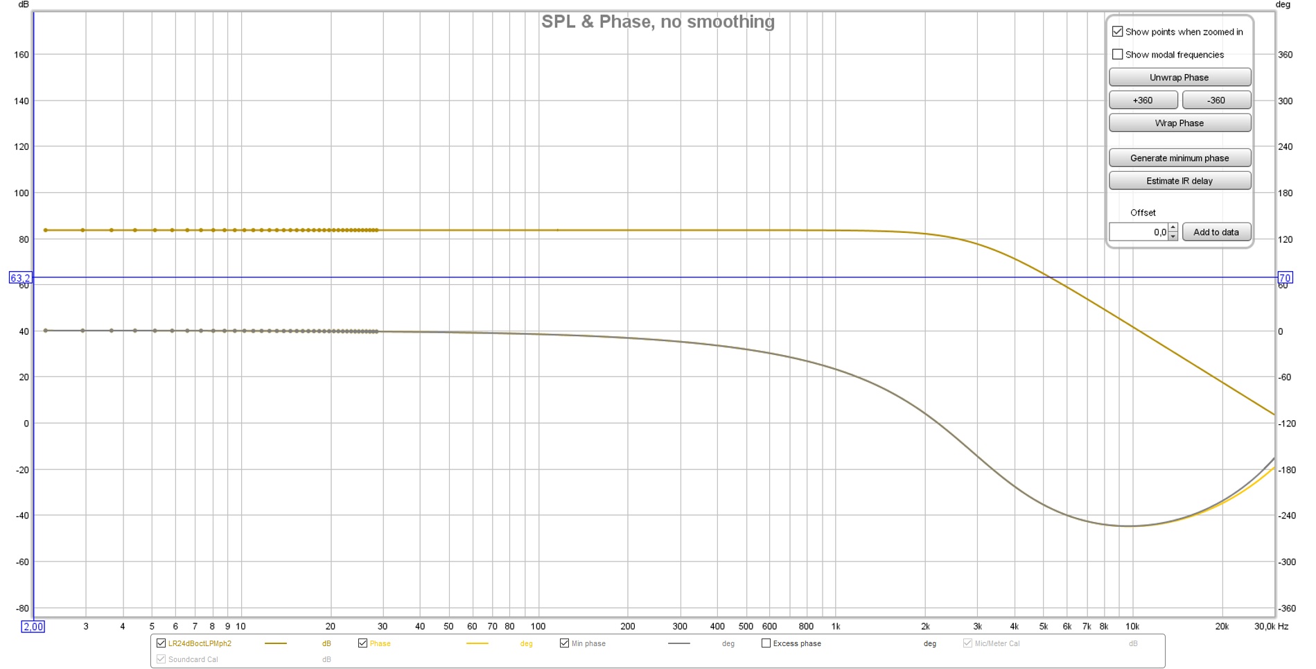

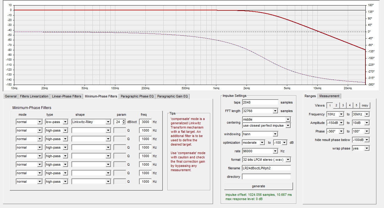

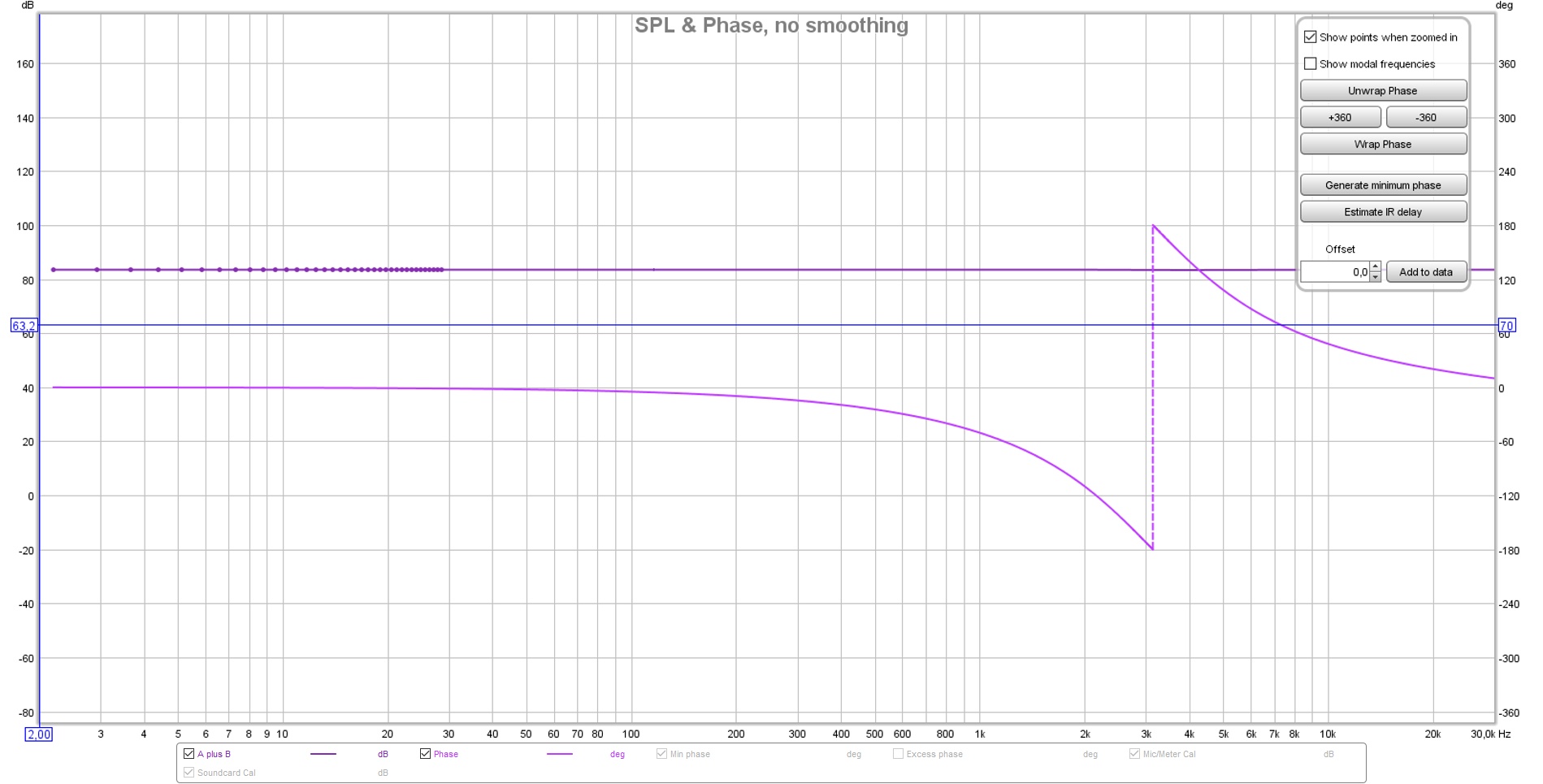

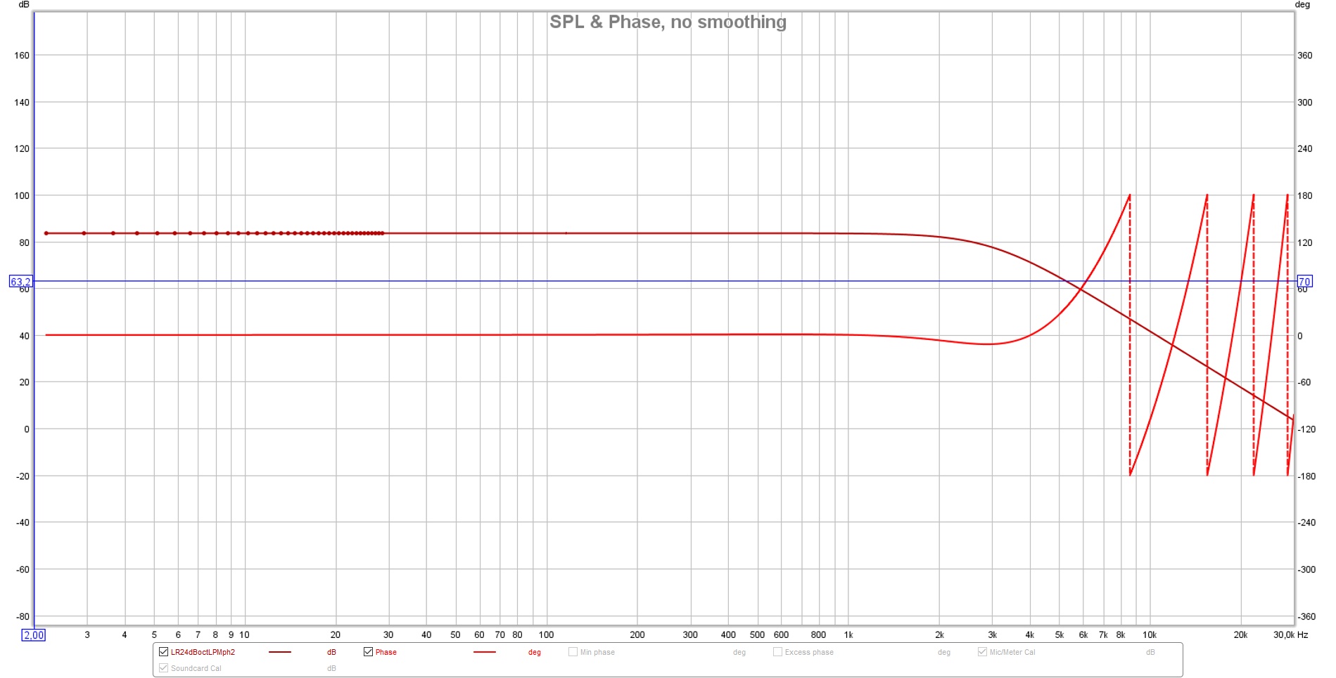

@POS or others: I tried to import a 24 db LR FIR filter from RePhase to REW via the enclosed zipped wavefile. The strange thing is the phase response in REW. It does not correspond to theory and RePhase graphics.
Do only I get that result?

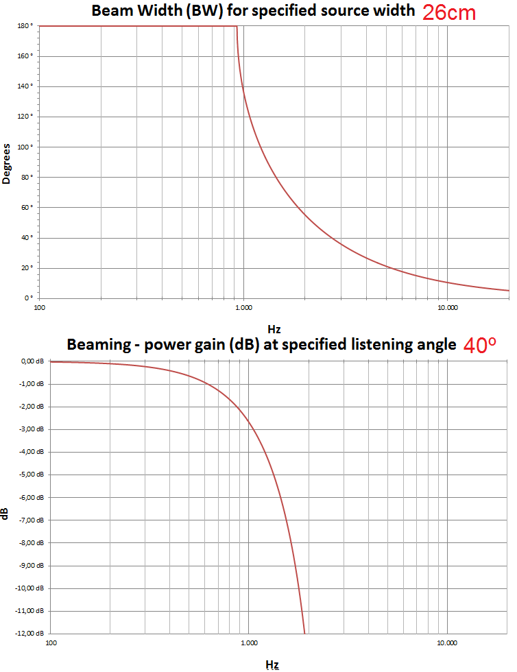

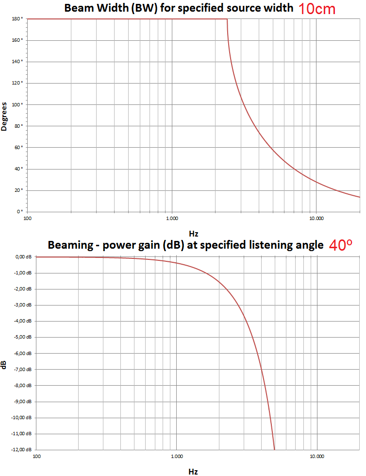

Try compare third pictures beaming below and above XO point to the excellent polar that last picture show and conclude that steep slope can perform excellent if spacing of drivers is low enough.

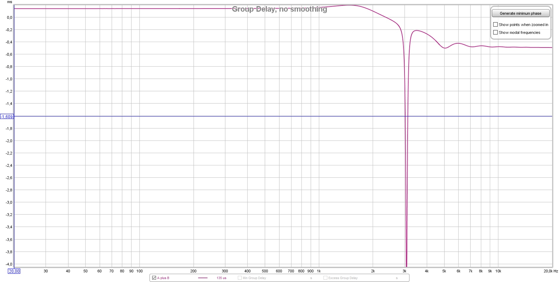

Regarding your 24dB LR FIR filter imported to REW try hit "Estimate IR Delay" and phase will now show right turned 180º around 3kHz point. That said you created it on "Minimum-Phase Filters" tab so its a normal IIR filter, go to "Linear-Phase Filters" tab to create as FIR filter.
Yes the intention was to make a FIR Minimum phase filter, to look at the group delay and maybe experiment a little with time shifts between summed filters.
After following your steps I could sum LP and HP to get the normal response (no time delay).

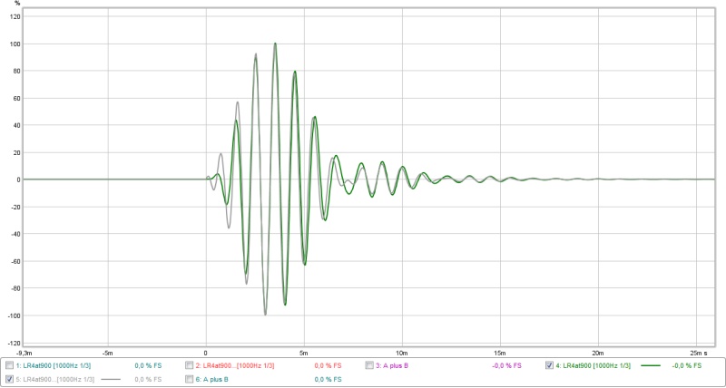

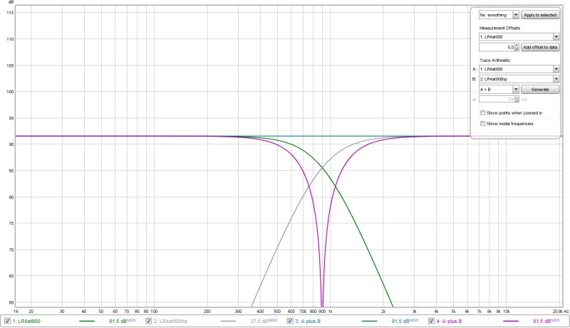

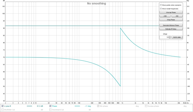

A Linkwitz Riley example I've posted somewhere before:
attachment.php
Seen here are the sum (flat line) the separate drivers (green and grey) and one driver inverted (big dip). A virtual exercise in REW with the crossed over IR's created in RePhase.
If I filter the separate drivers at 1000 Hz (the real crossover is at 900 Hz in this example) on the filtered IR tab I get this:
attachment.php
I used the overlay function to show both drivers at once, filtered on the filtered IR tab at 1000 Hz 1/3 octave and move back to the IR tab to see it's shape there.

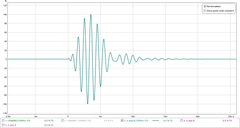

Summed FR and phase plot of the crossover I wanted to create here:
attachment.php
Perfect sum at 900 Hz, one driver (IR delayed on the IR tab) delayed to make them sum like this (summing them on the SPL tab).

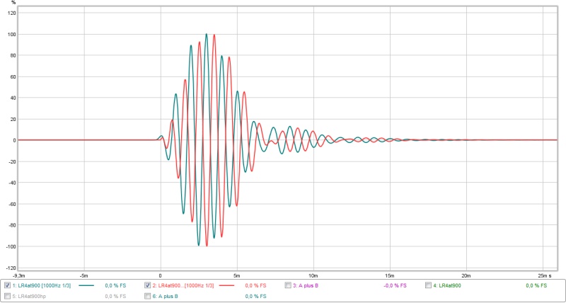

Looking at that same filtered IR's at 1000 Hz will look quite different if I don't time-align the drivers:
attachment.php
See how the drivers don't align with each other? In other words they will not sum perfectly at the crossover.
We all know the theory, I hope I'm not offending anyone here. It could help to play with these theoretical examples of the (almost) perfect version of what we want to create. See how it should look and why it sums like it does. Looking at all the different plots and tabs in REW and their relation to each other.

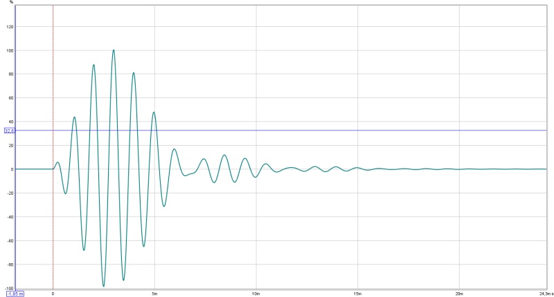

This first example, the one with the two drivers that line up at 1000 Hz:
attachment.php
(looking at a point very close to the crossover point at 900 Hz) add up ideally and when I filter that one at 1000 Hz (still using 1/3 octave) it looks like an almost ideal response:
attachment.php
This is how these drivers should add up.
Compared to a pure Dirac pulse filtered at 1000 Hz (1/3 octave):
attachment.php
Almost the same result.
All these examples are of a normal IIR Linkwitz Riley crossover (at 900 Hz) virtually created in RePhase and summed in REW. Still this might be a useful exercise for some to get a grip on these graphs within REW.
I hope this helps. If it isn't helping you, just ignore it. 🙂 Many more tabs to look at though this will probably do to get started.
Last minute edit: I see some have already started, I typed all of this already so I'll just post it...
