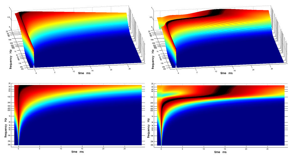

(Pre)ringing length and volume are dependent on filter slope and frequency.The explanation of the artifacts that can be heard, is the time lag off axis between two speaker elements eg tweeter and mid.
Long fir filters creates a long preringing and the time delay between the filters off axis, because of different path lengt to the ear, cause interference that can be heard. Even at as low as 0.5 milliseconds difference in path length. (acording to the thesis)
Using a lower number of taps (and appropriate windowing algorithm) will (gently) shop them at a given length, and as a result reduce slope.
This is the way slope is controlled with brickwall filters: the more taps and the sharper the window, the steeper the slope and as a consequence the more (pre)ringing you get.
But the important thing is that what matters here is the resulting slope.

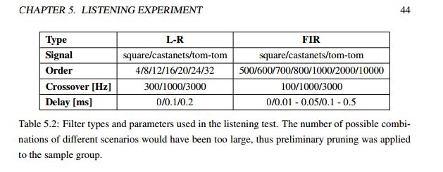

@BYRTT. To me it seems like the paper refers to FIR order as number of TAPS not the order of the filter as in analog or IIR. Also my simulation uses 96k samplerate, think the paper uses lower. (My bad)
@POS. The paper shows that it is not the magnitude error in the frequency domain that is annoying (inside limits). It is the combined timeshifted preringing of the filters that gives artifacts at 3k Hz and more than 700 taps.
So more taps/longer FIR filter gives longer preringing and therefore MORE audible artifacts.
(That is the suprising findings of the paper)

Not same resulting slope, of course. Somewhere down the decibels it will deviate.
The strange ting is of course that the shorter FIR filters performed better in listening tests than the longer.
The filters used are listed in the enclosed picture from the thesis. I think the FIR filters are long enough to mimic the LR IIR filters to a good approximation
It's all described very well in the thesis. (I have no affiliation with the authors or the university, but have an acoustics masterdegree years ago, myself)

I just skimmed the thesis quickly.
Page 17/18 and 45/46 it appears the author is clearly using brickwall filters, and what he calls order in that regard is the length of the FIR.
When designing brickwall filters the longer the FIR the steeper the slope, and of course the longer the (pre)ringing as a result.
Again, the slope is responsible here, not the length of the FIR.
Brickwall filters are undoubtedly the easiest type of filter to build in FIR (windowed sinc, it does not get any simpler than this...), but certainly not the only one, and clearly not representative of what can be done in FIR.
Fortunately directly associating FIR to brickwall filters, albeit still a common shortcut 10 years ago, has become an outdated practice today 😉

For a given filter, longer FIR gives longer ringing because the impulse is not so much truncated by the window/FIRlength. But, is does not matter.
Because that happen longer from the main lobe the longer the FIR filter.
From the paper it seems like the strong ringing close (0.1 to 1 ms) to the main lobe is most critical for artifacts with normal audio filters and off axis listening.
Maybe I'm wrong and it was not proposed by the paper...
