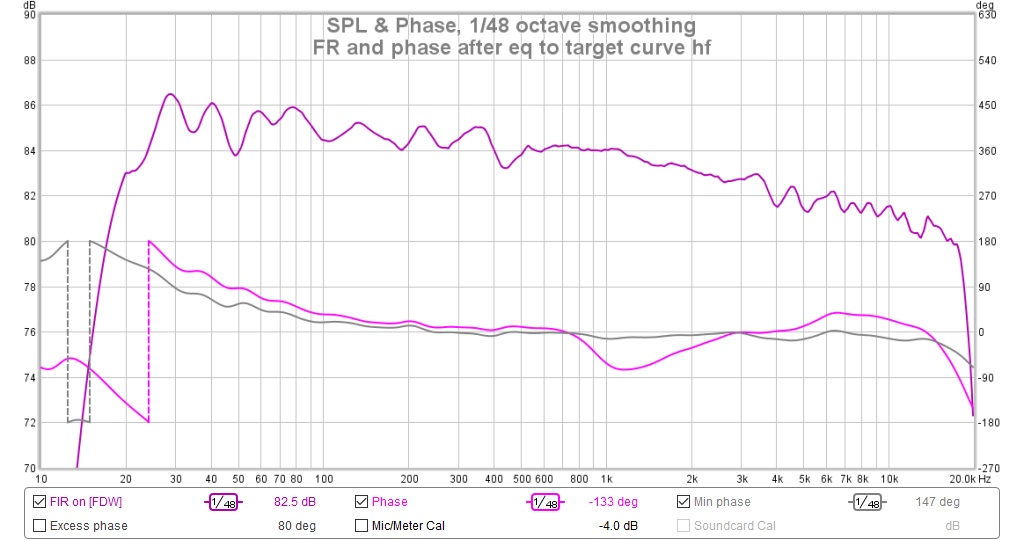

I designed and built a 3 way speaker and used Rephase to linearize its XO filters and got this nice result after some additional IIR eq on the HF:
attachment.php

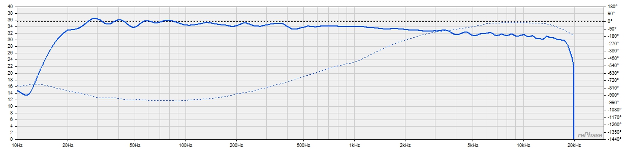

I wanted to bring it back into RePhase to flatten the phase around 1 Khz but the phase I see in Rephase is nothing like what I see in REW.
attachment.php
It looks like there is excess phase in the measurement that I don't see in REW. In REW I had shifted the IR to zero but that only affected the generated min phase.
Based on earlier posts, I thought Rephase time offset field would help but it doesn't. Any suggestions?
found my problem w help from Wesayso. I was seeing phase of a filter already loaded via settings which added to the measurement phase

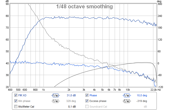

Can anybody explain to me what exactly (mathematically) are referred to as minimum phase and excess phase?
I know that the Fourier transform phase response can be defined on terms of phase delay and group delay (or better, those parameters can be derived from the phase response), but mathematically I have heard about minimum phase only in relation to IIR filters, and I don't remember studying anything about excess phase. Is that the phase related to the time delay of the measurement, that can be zeroed by offsetting t0 in the phase graphic?
sax512,

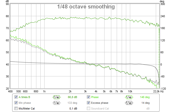

IIR filters are minimum phase, below curves in green show measured amplitude response and absolut phase, asking REW in grey curve to "Generate minimum phase" calculate how real minimum phase curve look for that particular amplitude response and the difference is excess phase. Black curve indicate difference and where it originates from is probably because soundcard/preamp/poweramp was not corrected for in REW settings but also if any reflections that have other distance than direct sum to amplitude or cancel amplitude it will be excess phase.
attachment.php
Now add a linear phase (FIR) XO point to above and hit "Generate minimum phase" will make excess phase error look huge compared to calculated IIR phase belonging to that particular amplitude response.

Thank you, BRYTT
In other words, in the ideal case of no other external sources of phase shift such as chain devices and reflections, the minimum phase is the phase shift that you would measure if you had a perfect flat amplitude and linear phase graph and wanted to make the amplitude the same as the measured one with the use of IIRs.
While the excess phase is the difference (smoothed out, it seems) between that minuimum phase shift and the real measured one. In the case the phase had been linearized through the use of a FIR filter, the excess phase is the opposite of the minimum phase.
Did I get this right?
