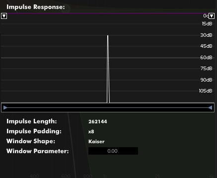

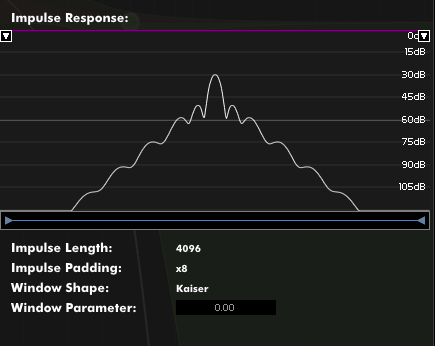

Those screen shots are from my tweeter side impulse response, cut off @ 600Hz.
Woofer side response (cut off 600 Hz + some bass boost) is this. As you can see, low tap graph shows horrible response.
Hi plasnu,
I don't understand what you are showing us...
Are you showing a dirac pulse that has been put through filters, HP, & LP ?
And that doing that with fewer taps gives an impulse horizontally spread out,, ......vs a lot of taps which gives an impulse that is back like a dirac pulse again?
Thanks, I'm having a hard time wrapping my head around what you're showing..🙂

Yes, they are the impulse responses generated by EQ software itself, DMG Equilibrium. The first set was is HP, second set is LP. 48dB. Both with some additional EQ points.
https://dmgaudio.com/dl/DMGAudio_EQuilibrium_Manual.pdf
It looks like longer tap gives ideal impulse response, BUT it is not. This plot is scaled to show difference between very low tap and very high tap, so when the plot is zoomed in, I can see the higher tap is still far from ideal.

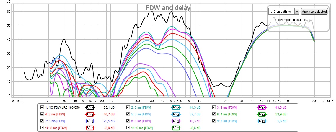

Question to GURU's. How to setup proper delays?
My 4 ways system LF and MID channels in OFF state, just MB and tweeter is working, delay is changed for MB CH.

And what hope on 350Hz?

ustas,
Don't count me as guru : ) especially because haven't real world experience for four way system myself, but over time had run so many sims as do I dare to make my bid.
To set up prober delays there is many ways to calibrate, the one you use here with multiple delay settings think would be better if run between TW/MID-MID/MB-MB/LF and at same for each delay setting also reverse polarity for one of the drivers to get deepest as possible null.
What to hope for 350Hz is difficult to say can think of two things making that error, one is you have some active IIR EQ correction right there that is little off probably because based on not so good measurement quality or because microphone spot in space is since changed and second is you have null caused by room and/or drivers position relative to boundary.

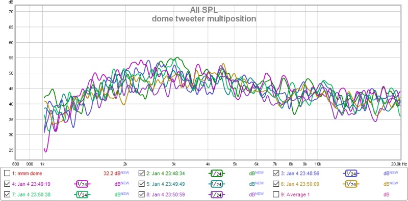

MMM is pretty much summing to an average except instead of say 9-12 averages people normally do , you have hundreds or thousands in an mmm.
single point measurements are too problematic because if you move the mic even half an inch, the measurement changes. and of course our ears are more than said half inch apart.
attachment.php
if you average the responses, phase is removed. are you saying there is a way to average phase?
attachment.php
Yes, use the (A+B/2) in pairs in the SPL tab. A bit of work but when done right it will give you an average with phase. See the link I provided.
MMM is a room average. If you fight reflections in a room the MMM would more closely resemble a single measurement at the listening position.
ustas,
I make it in same way running in real time "Pink PN" and RTA.
ustas,
I check all of this again. Thank you.

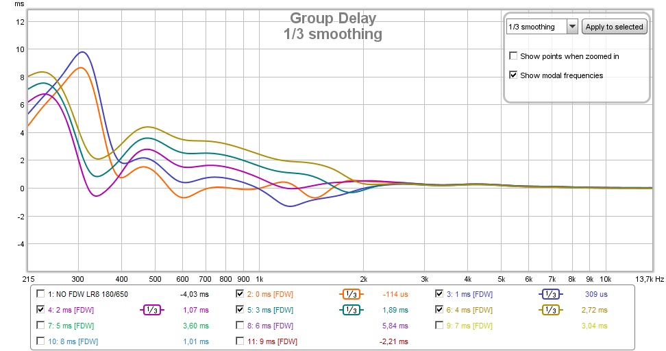

Are that can help with setup delays?
REW "Group delay" Overlays tab:
attachment.php

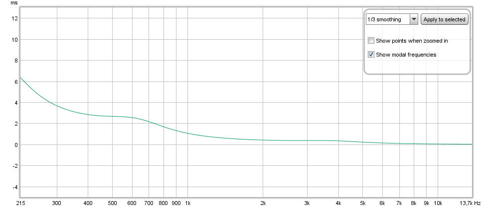

...Are that can help with setup delays?
attachment.php
In a way think they can but REW need so much smoothing for "GD" curves to be readable that not sure how to trust for timing drivers acoustic offsets.
For fun did a guess on your band-pass above have MB/MID/TW turned on with LR8 slopes at 180/650/4000Hz and BW2 stop-band at 20kHz, created in Rephase. Importing this IR model to REW show below curve and if we compare it looks your purple and green comes closest, gold is too slow and the ones firing before real-time is too advanced : )
