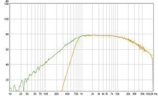

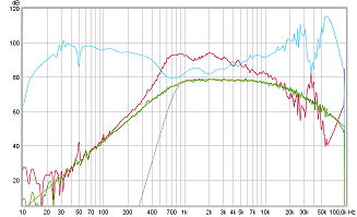

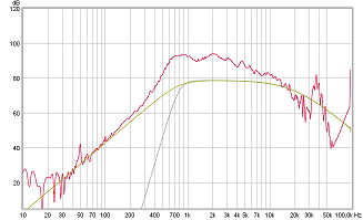

Guess you still at work out in camp and play around with synthetic exercises to educate, can share a little synthetic exercise with some structure support in form of target curves that maybe can help, also it should work in real world if measurement session is good enough quality. There is so many ways to reach right curves so mine is not any more right and better than other ways to think about it and execute procedures so think have an open mind and use ones brain under process helps.
1. Exercise start in REW having one live measurement in red curve of 2426H/2370A combo, and two target curves where gold is first curve wanted red curve to be IIR EQed into and gray is final pass-band including XO point. Rephase creates happily those targets with following "Impulse Settings": taps=262144 windowing=rectangular, rate=important to set it to same as measurement, format=32 bits LPCM mono (.wav). After import target curve to REW use "Estimate IR Delay" to center IR.
attachment.php

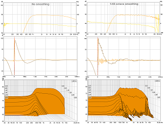

2. Blue curve is IIR EQ than when on "All SPL" tab then "Controls" is X (times) to red curve, hit "Generate" will bring us green curves IIR pass-band. To create EQ curve it was done in two steps where first was auto EQ into REW to help form that high pass 800Hz BW2 knee and exported those EQ settings to Rephase where second step of EQ was finalized and saved with same settings as target curves.
attachment.php
In general think having synthetic target curves is not bad as quality control to see we not way off, at other tabs here some synthetics points verse okay acoustics so far.

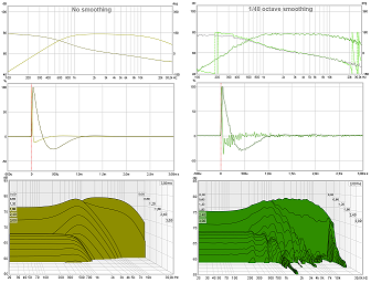

3. In green curve now have a known IIR pass-band 800Hz(BW2)-20kHz(LR2), phase turn at 20kHz roll off (system stop-band) is natural IIR and in mine view don't need any correction but do as one like, but 800Hz(BW2) IIR roll off and its phase turn we like to turn into 800Hz(LR8) linear phase and in we EQed raw driver to a known roll off knee its convenient use neat "compensate" mode in Rephase, that is mode set on "Minimum-Phase Filters" tab and will boost 800Hz(BW2) knee with IIR EQ so driver is flat amplitude and phase down to low frq and don't load such a setting real world because will blow poor coil in compression driver but after this go to "Linear-Phase Filters" tab and set 800Hz(LR) high pass which will steep high pass amplitude and leave phase flat.
attachment.php
Again at other tabs some quality control points synthetics verse not so far acoustics.

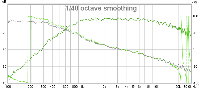

4. All corrections saved in Rephase from exercise can correct this driver when correction is saved as the format ones DSP support. Load it to DSP and recheck real world this pass-band acoustics with measurement at same spot in space perform as synthetics. If any variations these will need investigation and is probably because drivers raw response before EQed had amplitude response with room/object reflections that had some other distance to microphone than direct response from driver. Think some hints for measurement quality in REW is readable "Generate minimum phase" for a given measurement be it the raw driver performance or after EQed as seen in below green verse grey phase, if they not overlaid and follow same general directions other reflections add into response and where green phase makes curls not seen in grey is trouble area and probably only correctable by physical means.

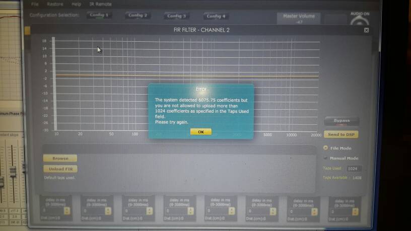

Something wrong..... Did some EQ on a bass channel file today but couldn't get it to load into minidsp. To start with I tried 2048 taps (min samples was 8192). Said I had too many coefficients but you are not allowed to upload more than 419 which is how many taps it said I have available. I used 419 taps in Rephrase when building this filter.

You need to allocate taps across the 8 channels first.
Assuming channels 1 thru 4 are Left, and 5 thru 8 are Right. And you are using 2048 / 2048 / 698 per side, in L,M,H configuration.....
Put 6 taps in 'Taps Used' for the unused channels 4 and 8. You will see 'Taps Available' increase. (Every channel requires a minimum of 6 taps.)
Then put 698 taps in High channels 3 and 7. That should leave 2048 for assigning to each of the 4 remaining channels...if that all adds up to 9600 😉
My plug in is the 96khz so only has 3400 taps available, so I tried using 750 taps setting. went back to rephase and regenerated the impluse file with 750 taps, tried to upload this to minidsp and still got the message: the system detected 4388 coefficients but you are not allowed more than 750 coefficients as specified in the taps used field.try again.

Have changed to the 48k plug in. It still says there are too many coefficients. Seems the coefficients need to match the number of taps.
Only way to make this work is to set a real small number of taps in Rephase.
I'm doing something wrong for sure...

When in FIR Filter (in any channel) 4x8 or 4x8/96:
- choose File mode
- BEFORE you Browse/Load/Send to DSP your intended filter, you must enter manually the number of taps in the "Taps used" field , in the lower right corner above the "Taps Available".
- You need to enter the number which is equal to or higher than the number of taps your filter uses. Program will inform you that if you have "spare" taps unused, it will fill them as zero....
- After this, you can download and "Send to DSP", AND then unclick "Bypass"
- Lastly: tap=coefficient AFAIK

Yea did that.... redid the rePhase with 1024 taps, set taps used to 1024 and selected the filter file. Same message, too many coefficients. Try again.

The program "sees" your 1024-taps designed as 6067.75 taps! Did you check the correct file format needed for MiniDSP?
EDIT: Mark100 already posted the correct file format////

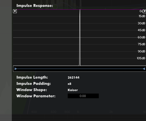

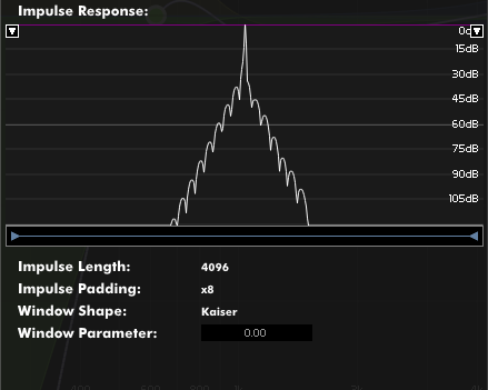

I agree with WESAYSO. For low frequency, low tap FIR is not recommended. 262144 is my current impulse length. That's the max number I can do with my computer, but I wish I can make it higher in the future. Digital technology is still very immature. 🙂
