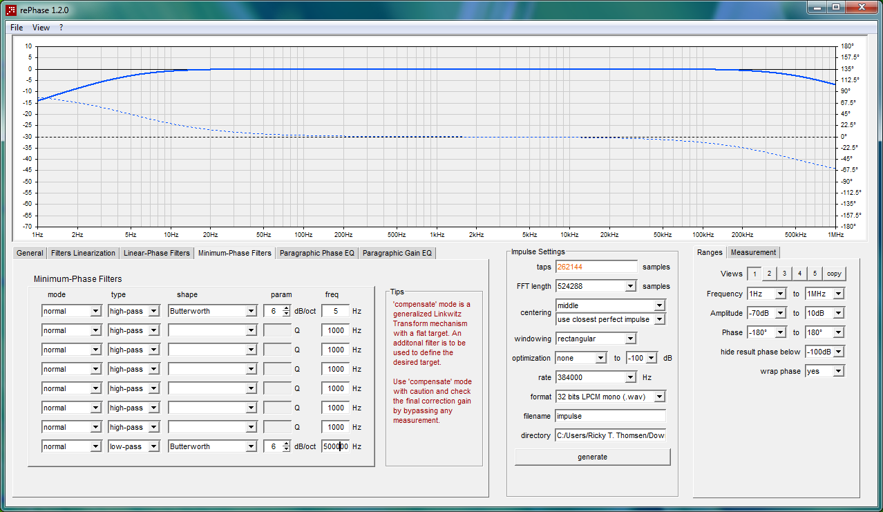

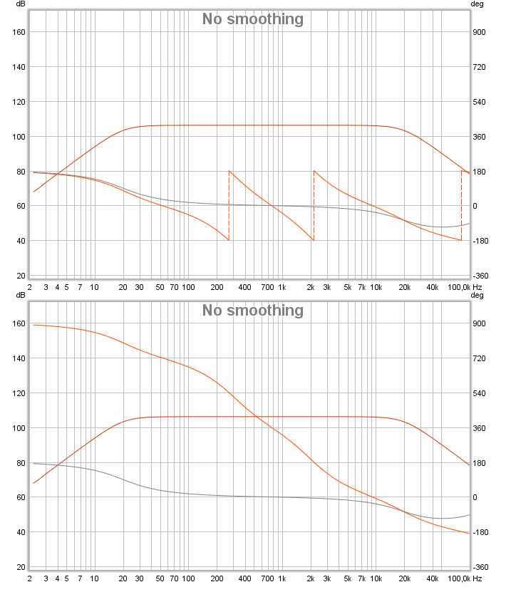

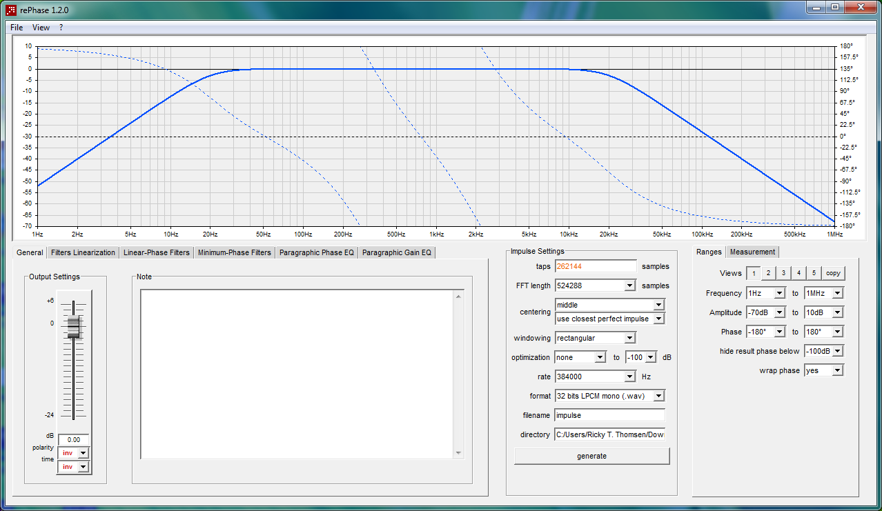

For a given band pass phase verse frequency in minimum phase domain (IIR) in general is turning 90º per order as amplitude falls off, for high pass function phase starts goes lagging direction (slow lows) and for low pass function phase above cut frq goes advance direction, phase turn is halfway at cut frq (stopband).

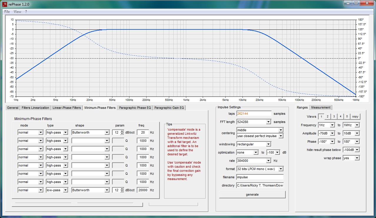

1. example below show audio system band pass 20Hz-20kHz with 2nd order roll offs, phase lag is half way +90º at cut frq 20Hz and 180º down at DC component, up at HF phase is in advance -90º at cut frq 20kHz and full 180º up higher.
2. example show same system band pass but this time its a sum of three united pass bands with LR4 XO points at 300Hz pus 2kHz.
3. example is sim of power amp device 1st order roll off wide bandwidth 5hz-500kHz.

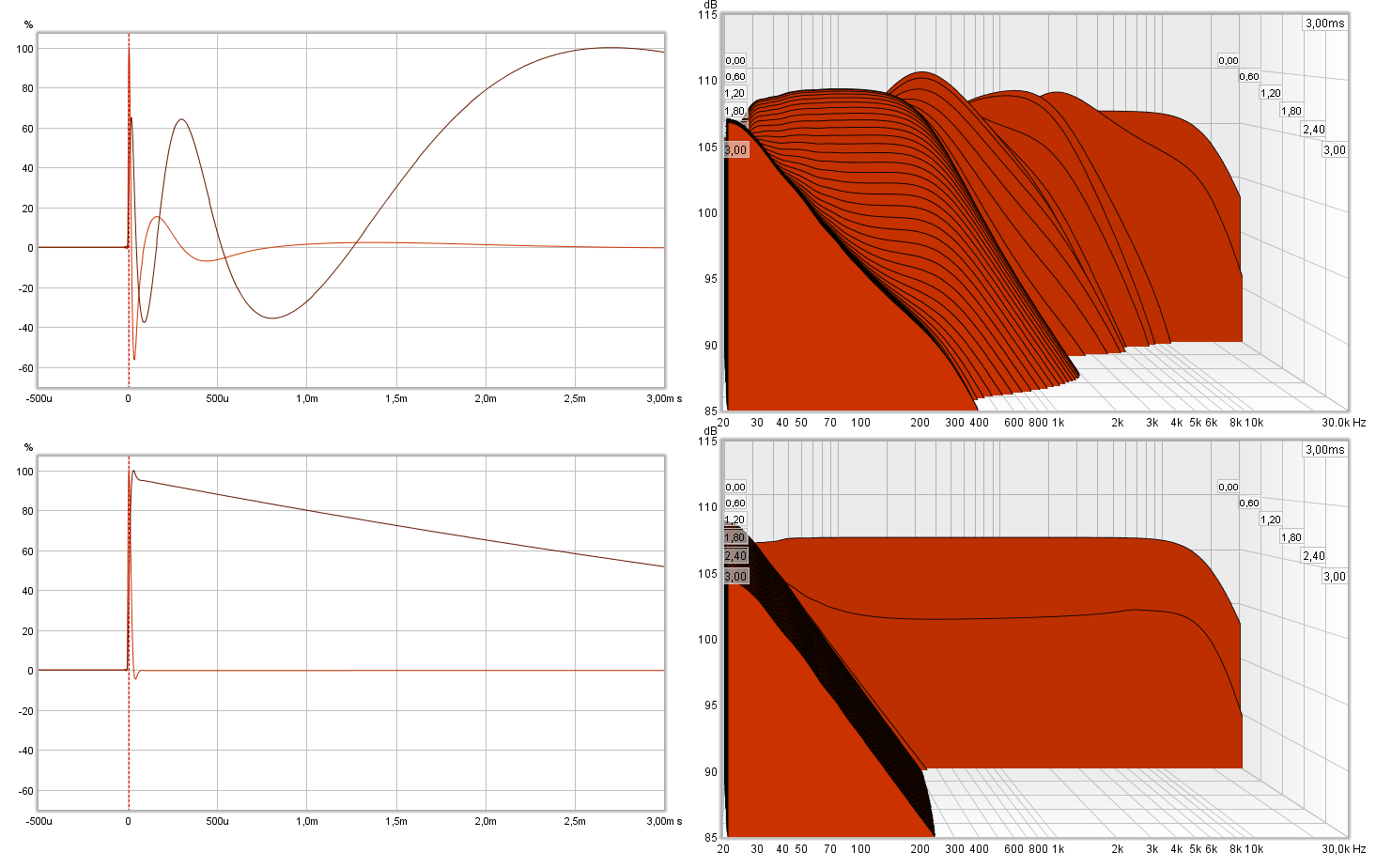

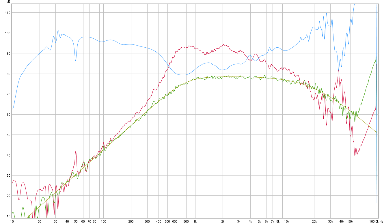

4. example is over in REW red curve is measurement of 2426h/2370a horn, blue curve is correction made in Rephase also gold target curve is made in Rephase, green curve is sum of math at "All SPL" tab commanding red curve times blue curve.

Welcome and glad you got it so run sims as crazy because think its very educating.
About wrapped phase its just a view mode as in below example which is the system band pass 20Hz-20kHz from post 1681 where there is LR4 XO points at 300Hz and 2kHz, with wrapped phase maybe phase looks flatter but it doesn't change reality that phase turn sum inside 20Hz-20kHz audio band is 900º (2x90º at system stop bands and 2x360º for XO points). Grey phase curve is the interesting XO-less one that Rephase can help build to improve transients and ringing
