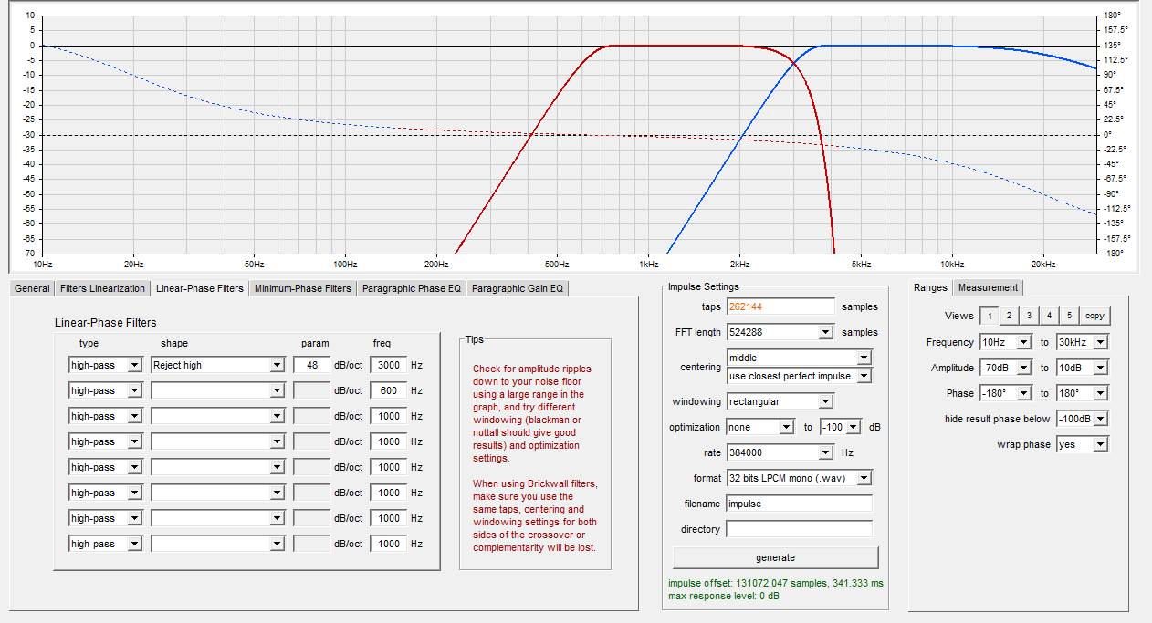

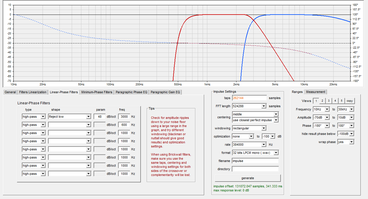

I wonder if it will be a good idea to make a FIR bandpass filter (picture 1) as a cascade of a HP filter and LP filter with lowest possible length + initial delay. (picture 2 and 3)
The reason is the tests in this thesis that suggests that long fir (regardless of dsp platform) can give audible distortion!
http://lib.tkk.fi/Dipl/2008/urn011933.pdf#page61
With some engines two fir filters can be cascaded so this can be realized.
Or could the delay and LP filter be convoluted with he HP filter to make a single that does the same?
That is have shortest possible ringing for a given LP or HP filter at a frequency

Basicly both does the same. There may be interference arifacts caused by the limited tap length of the first filter convolved with the same type artifacts of the second filter ...
I think it's better to convolve "perfect" low- and hipass and run the tap reduction afterwards on the resulting bandpass.
For a given response target the more taps you have the better.
Brickwall filters are another story, as the more taps you have the steeper the slope, but that is kinda taking the problem upside down...

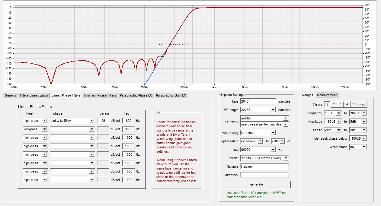

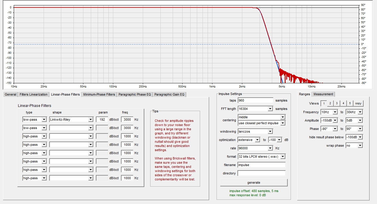

...The reason is the tests in this thesis that suggests that long fir (regardless of dsp platform) can give audible distortion!
http://lib.tkk.fi/Dipl/2008/urn011933.pdf#page61...
All 75 pages in that pdf document study would take long time to read 🙂 i could be misunderstanding what you point is but can see in their chapter 7 conclusions quoted below that you should be good to go in that your used filters is much lower in order.
Rough safety limits according to both test methods would be to keep the order of a linear phase
FIR crossover filter under 600 at higher frequencies (1 and 3 kHz) to prevent from the ringing

The explanation of the artifacts that can be heard, is the time lag off axis between two speaker elements eg tweeter and mid.
Long fir filters creates a long preringing and the time delay between the filters off axis, because of different path lengt to the ear, cause interference that can be heard. Even at as low as 0.5 milliseconds difference in path length. (acording to the thesis)
A single driver will NOT produce the artifacts if not a time delay between the filters are introduced. (The headphone test)
A steep BP filter at 600 Hz and 3k needs a lot of taps (4k taps?)
So then I think that the 3k LP filter has the same preringing as the 600HP filter, that is the preringing as a 4k tap filter. (And that is much longer than a 700 tap filter.)
Or does rePhase only use the taps it needs when making the 3k LP part of the BP filter. That is: The preringing of the 3k filter (in the 600 to 3k BP filter) is much less than 4k/2 = 2k samples?
(On a sidenote i'm very suprised that preringing artifacts can be heard. But maybe the ear is more sensitive to difference signals? Ref tuning an instrument by listening to the pitch difference between two instruments)
This is perhaps stupid but...
Since I can hear the artifacts with sine waves pure tones (pretty easy to verify) it should be perhaps useful to test (or not) the filter settings with pure tones before theorizing too mutch ?
(less headaches for idiots like me)
