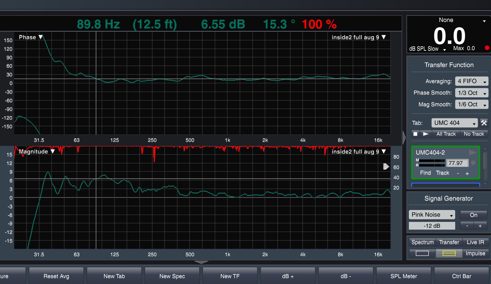

Here's a measurement indoors, horn loaded sub and mid, coaxial compression.
6144 taps on sub and mid, 2048 on HF and VHF. (Aug9 date was Apr9...too much wine haha). x-over all 48LR's @100, 650, and 6300.
I can't believe how relatively easy it is to tune with flat phase, compared to trial and error of matching phase slopes using IRR. Looking forward to further tuning outdoors..

mark100,
Your plot show nice data :) having a listening position in same spot as where mic was placed must sound pretty good.
Thanks BYRTT !
I tune to outdoors and seldom measure inside. But I was dying to see how well rePhase and 6144 taps could do at phase flattening below 100hz.
Frankly, I was a little surprised to see fairly decent indoor flatness at lower freqs. Lucky mic position I guess...
The phase flattening is what really has me psyched..can't wait for outdoor testing...
It's PA gear..sweet spot is 20 meters wide :D

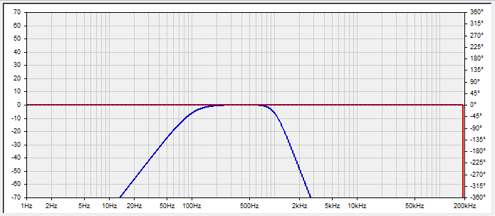

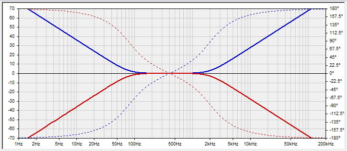

You know having a audio device with unlimited bandwidth from DC to light speed will be perfect audio device, in it have totally flat amplitude and phase inside and outside of audio band. Real speaker drivers have limited bandwidth and are minimum phase devices, so if their fall off slopes outside their stop bands is corrected with high SPL numbers of minimum phase correction they in theory end up be a DC to light speed device.
Below example red trace should simulate a mid-bass when mounted in a sealed box that end up a 2nd order 80Hz roll off and in HF area it rolls off 2nd order at 2kHz, and lets say all peaks and dips including break up modes is corrected with minimum phase (IRR) EQ at "Paragraphic Gain EQ" tab or corrected with passive filter components. Blue trace is if we look isolated at how compensate mode correct for a HP 2nd order 80Hz point plus a LP 2nd order 2kHz point. It's the IRR reverse mode of driver itself and will correct driver to now be perfect linear phase wide bandwidth device.
545137d1461443356-rephase-loudspeaker-phase-linearization-eq-fir-filtering-tool-90.png
Result of above red trace corrected with blue trace would be as below red trace, but it won't work in real world because audio system lack dynamic range to correct for so much EQ boost and driver itself won't like that much boost and also won't perform good sound outside its intended pass band. But now we can add new stop bands that is inside drivers intended pass band working area in Rephase's "Linear-Phase Filters" tab that only correct for amplitude and leave phase as is (FIR filter), blue trace below is that correction with HP LR4 at 100Hz and LP LR8 at 1kHz.
545138d1461443356-rephase-loudspeaker-phase-linearization-eq-fir-filtering-tool-91.png
In real world think to hit the right compensate filter will take some hack time to hit right filter, by sweeping up and down frq point and try different order of slope or mix multiple slopes. High pass compensate mode for sealed box should be second order, vented fourth order, and guess OB be first order and leaking box be third order.

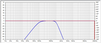

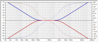

BYRTT, a very nice and clear illustration and explanation.
