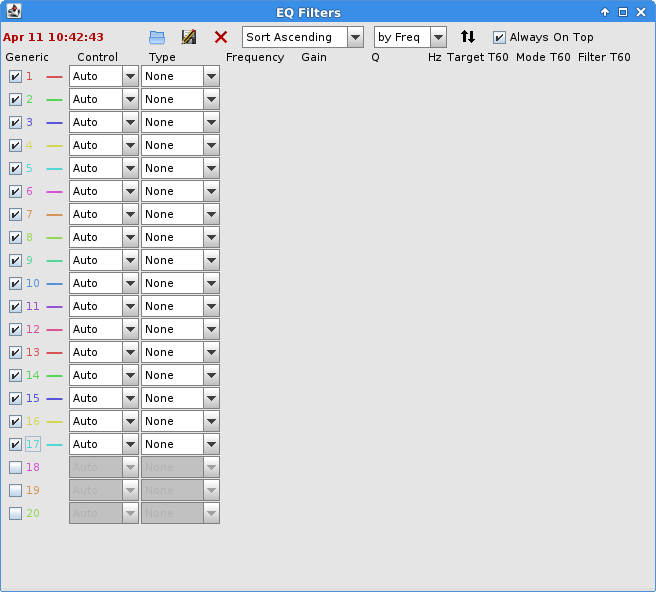

It is easy to limit the Numbers of Filters to 17, so that they will fit to a single Bank(Screenshot) and I never found Notch Filters in automated Corrections.
Usually I do not get more then 5 -6 Filters..
REW Filters Sets are more a "Suggestion" to me and in most of the Times not final, but they are a very good start and make Work faster....
Regards

You do NOT need to install a Full Java package 🙂 There are versions of REW which come with it's own Very light install of Java Index of /installers
I did not know about these "offline" versions, thank you!
I will start implementing an import functionality for the next release.It is easy to limit the Numbers of Filters to 17, so that they will fit to a single Bank(Screenshot) and I never found Notch Filters in automated Corrections.

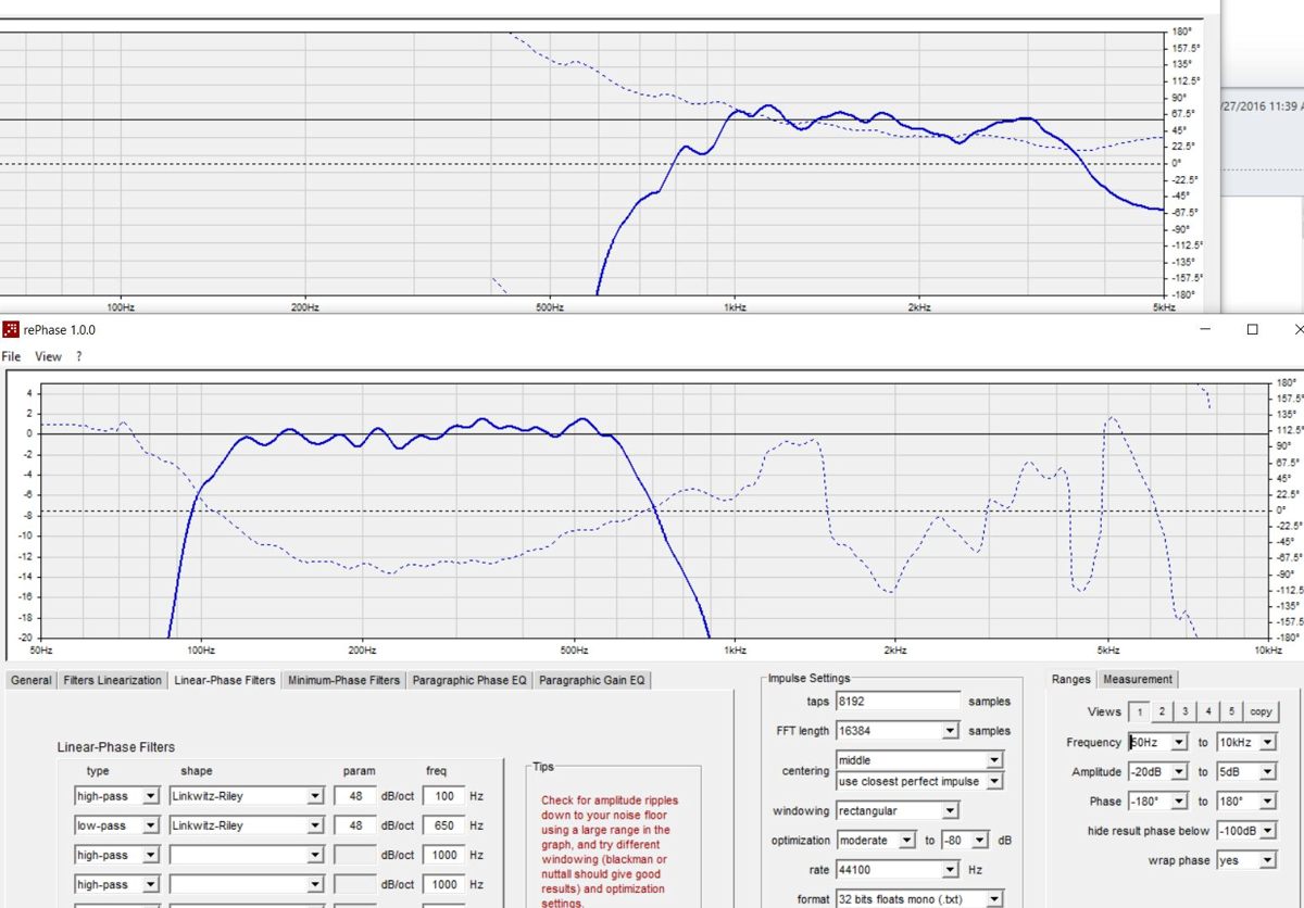

Hi Osse, near total noob here too, other than I've been playing with rePhase and some mini-dsp units for a month or two..
I'm trying to do the same thing you are with some 4-way PA gear (3-way main and sub).
I'll post comments with the hope they will be supported or corrected as need be... IOW, don't bank on anything I say, haha
As you allude, it seems there are two main paths to phase flattening.
One is too use our IIR equip as usual, and insert miniDSP / rephase (may i term this 'MDR' ?) into the chain as a global phase correction.
The second is to use MDR as the complete crossover solution on its own, and perform driver by driver phase flattening.
From what I understand, either will work nearly identical for a single point in space.
But, using MDR as a complete driver by driver solution, is superior for multiple points in space.
Reason...well, when thinking about on and off axis response like we have to with club/live sound gear...
We know that we have ultimately to measure off axis response at different x-over frequencies and typologies within the possible range of crossover freqs, to find optimal off axis response. On axis is relatively easy.
If we use MDR as a global correction, trying different x-over freqs and typologies without rerunning an entire new global response for each attempt is invalid, because we flattened phase based on the combined response of drivers at a previously given freq and topology..
If we use MDR driver by driver, we have a lot of room to move x-over freq and topology around as we search for optimal, because we should have good summation.....because each driver is flat with the range we deem possible...

Hi Mark
In a properly implemented acoustical LR crossover both acoustical filters are perfectly complementary and sum to a flat magnitude response (on axis at least).
When temporally aligned each driver encounters the same phase shift, which is also reflected as an allpass in the final summed response. This is called phase tracking and means the two drivers are in phase with each other.
If you then "linearize" the phase of that summed response with an inverse allpass you get a perfect linear phase crossover, exactly identical to what you would get with two linear phase "LR" acoustical filters.

Hi Pos,
Thx. Read the Linkwitz link and understand the influence of other crossover points...like you say, all the more reason for linear-phase crossover filters. 🙂
I'm pretty familiar with phase tracking...been using smaart to align phase traces, subs to main, for a while.
All in all, electrical crossovers are making sense....no real difficulty there..
I'm still not quite so clear with the mechanical part....ie the drivers' raw acoustic response....and corrections for these responses.
I have a hard time seeing how a global correction can correct the phase of each driver individually, through the x-over region. I can see how global can correct the summed response easy enough..
But it still seems like a summed correction is suboptimal to having each of the drivers flattened first..
Sorry for being so dense....
But hey, I really do think I get compensate now 😀
When you have an in-phase complementary minimum-phase acoustical crossover both drivers have the exact same phase shift throughout the crossover.
Once you are there, if you were to correct those drivers to get linear phase acoustical filters for each of them, you would use the exact same correction for both. Hence you can as well put that correction on the input and the result will be identical.
Thx for bearing with me POS 😱
Maybe this will help you see what i'm am missing...
Below are the HF driver (top) and MF (bottom).
Each have a couple of para eqs for a little amplitude smoothing.
They also have linear-phase 48db LRs at 100 & 650, and 650 & 6300.
I know the linear-phase crossovers did not effect phase on either.
Nothing else was done , the corrections (windowing, taps, sample etc) are not what I'm using, just a quick throw together for illustration's sake.
If I look at say 700hz on each, where summation is taking place....
on the HF, I see about 95 deg phase
on the MF, I see about 3.
So about 90 degrees diff, which gives maybe around 3db summation.
OK, so i go measure combined response and easily add para eq to flatten...
But if I adjust phase at 700, what am i adjusting..wouldn't I be moving both drivers the same number of degrees, when i really want to bring them together?
