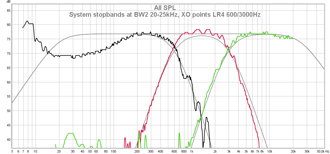

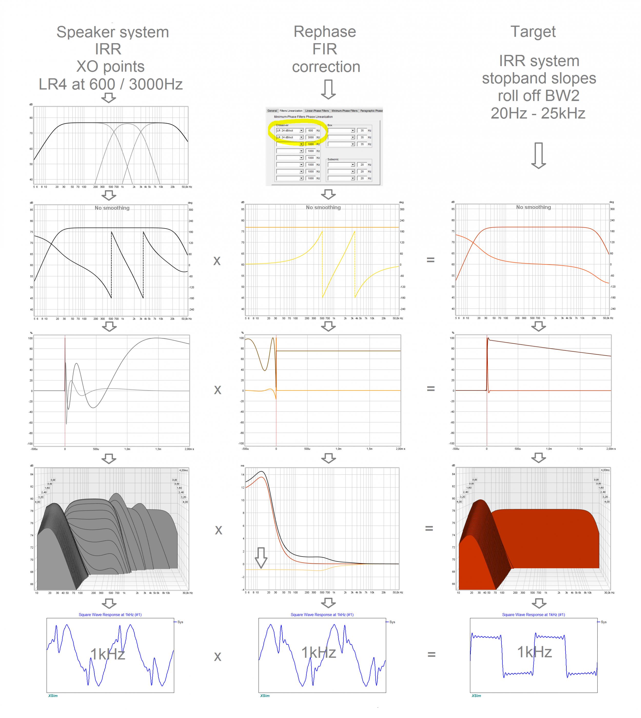

AndrewUK1990,
Nice build there, traced your plots in below picture-1 overlay compared to textbook system stopbands at BW2 20-25kHz and LR4 XO points at 600/3000Hz.
Short version think sounds as you got it right, drivers are minimum phase devices (IRR) and you at present correct system with reverse IRR EQ, then if measurements are right plus correction for acoustic center offset between W/M/T you just need the phase correction that Rephase create on "Filters Linearization" tab setting one filter to correct LR4 600Hz and another filter to correct LR4 3kHz. This filter will neutralize IRR 2x 360º phase turn caused by summing your system with 2x IRR XO points so that after correction only phase turn left back is the two IRR BW2 stop bands that in these simulations is set to 20Hz at LF roll off and 25kHz for HF roll off.
Above correction will fail if measurements or acoustic offset isn't right because phaseturn isn't where we expect it to be but think no harm to try and see result, if your DSP need one correction that include both IRR and FIR correction in same config file or IR-wav file there is more work to be done or maybe better to use compensate mode as pos has guided.

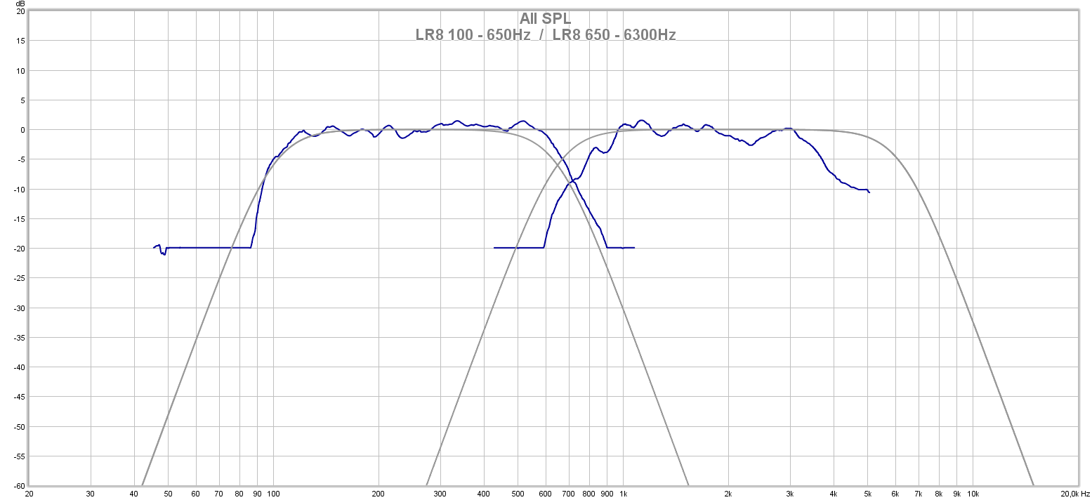

Hi guys. I posted a thread with this question but thought perhaps it would be more suitable here as it involves using rePhase.
I have recently finished making a 3-way crossover using the IIR and PEQ capabilities of my MiniDSP Open DRC-DA8. The result is a flat amplitude response (using appropriately gated measurement to eliminate reflections) at the measuring point, 1m from the baffle at tweeter level. The gated overall phase response is not linear, but integrates well between drivers and has an overall gradual slope from +180deg to -360deg from left to right over the frequency range.
I want to use the FIR capability in tandem with my current IIR crossovers and PEQ filters in order to carry out phase only correction using said FIR filters for each driver on my DRC-DA8 to linearise the overall phase of the loudspeaker.
To do this, do I:
Measure the individual gated response of each driver with the current IIR filters, PEQ filters and time delay applied (as shown in screenshots below)? Each driver is measured individually from the same point (1m from baffle and in line with the tweeter) as is the overall system response. Once this is done, import the results individually into rePhase, then use the phase EQ tabs to change the phase of each individual driver to be a flat line over the usable frequency band (Also im not sure if the phase should be flat/linear at the same point for each of the three drivers, ie. they all must be 0 degrees or all 90 degrees etc as long as they are the same). Then, use the rePhase generated output for each and put this into the FIR filter for each individual driver on the DRC-DA8 plugin.
Presumably once this is done, I would measure the response of each driver again, measure the overall combined response and hopefully find that the response is still linear in amplitute throughout the loudspeakers frequency range 30hz-20khz but now also linear in phase.
Is this the correct method where my goal is to linearise the phase of my loudspeaker after already applying a conventional IIR 3-way crossover and PEQ filters?
Note all measurements attached are gated to 3.2ms to remove reflections so low frequencies <300hz are inaccurate.

Hi guys, thanks for the info. Brytt - the above measurements include time alignment of each driver to allow for acoustic offset to the measuring point (1m from baffle in line with tweeter). The impulse peak is also almost exactly the same for each driver at this point following the time alignment.
Bohdan - to clarify:
1. Dynamic range is relatively low on these measurements because I live in a shared house and could not measure at high volumes. I will carry out another set of measurements with greater dynamic range when i get the chance.
2. Phase response is possibly rising on the tweeter after 10khz because I have a mild high shelf filter to compensate the rolloff of the soft dome (or accidental lack of accurate measurement at high frequencies?). If this is a problem i can easily remove it from my PEQ filters.
