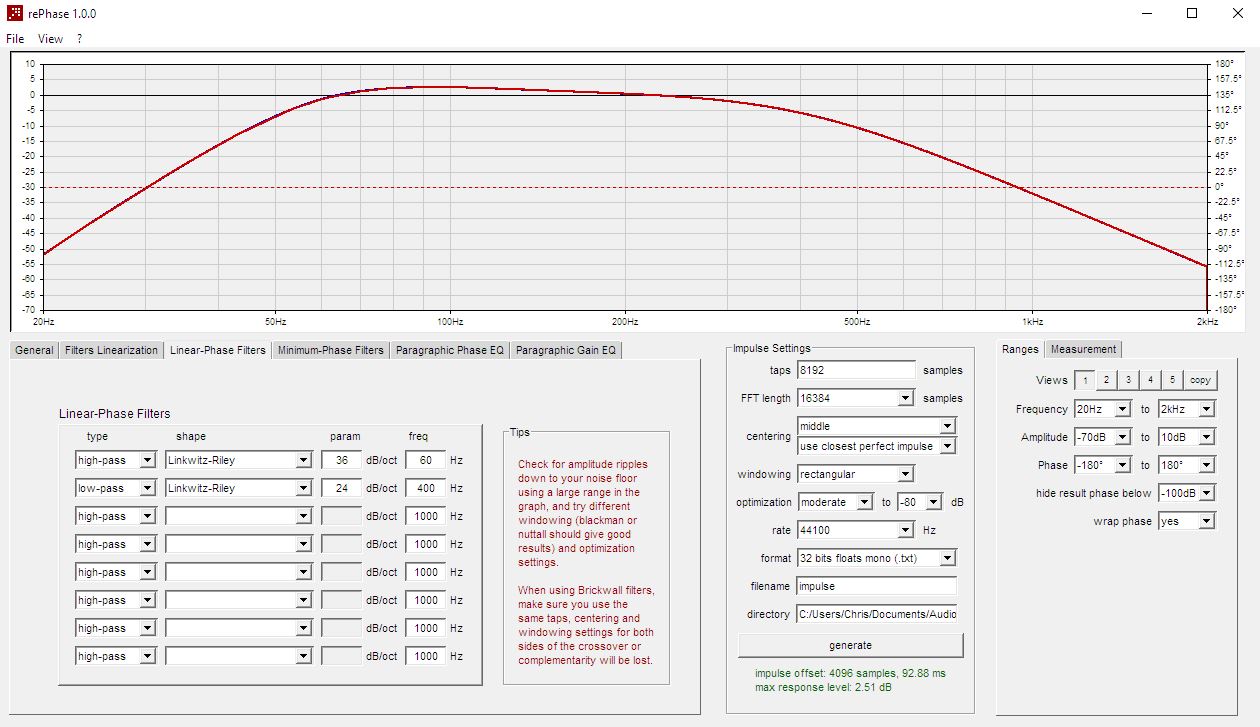

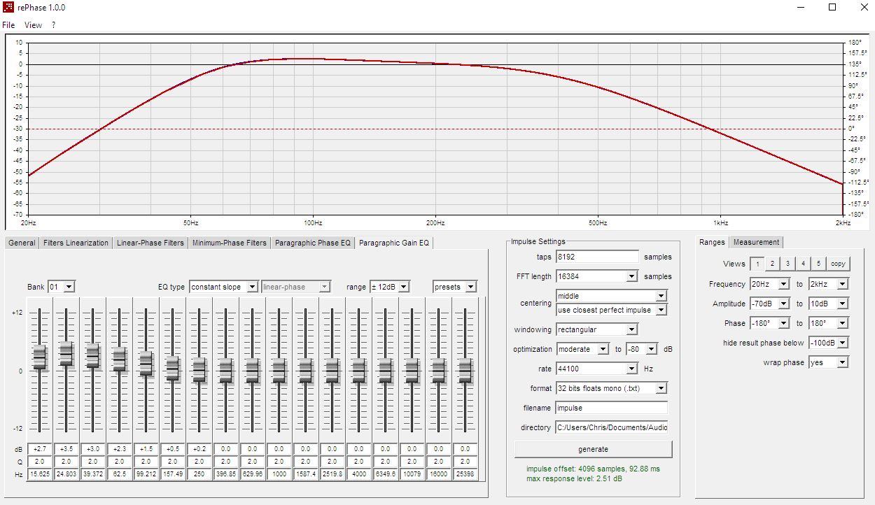

Hey guys,
I've read through the first 20 pages of the thread then the last 10 pages. I'm doing something very similar to jojip, also using JRiver, except I'm doing it in stages.
I just finished a pair of 10" mid bass I'm inserting between my sub(s) and a set of bookshelf speakers. After playing with my crossover points and slopes a little and adding some low shelf for baffle step compensation they are sounding pretty decent. I've just been doing it by ear so far but will take real measurements this weekend, following the tutorial on the JRiver forum.
For now though, is there any reason I shouldn't use rePhase to generate FIR filters matching the IIR filters I created so far in JRiver PEQ? I'm really wanting to remove the crossover phase shift and then do some time alignment with the greatest null thing to see how it sounds. My sub and mid bass enclosures are sealed so there shouldn't be much group delay from the box.
I was messing with it earlier, trying to create the bandpass filters for just this mid bass and trying to include some baffle step compensation at the same time.
Does what I have done below look reasonable? I just created the filters to match what I did in JRiver then I found the loudness preset which gave me a curve that looks close to what I want.
Am I messing anything up badly here?
Thanks,
Chris

Hi Chris,
Good minimum-phase settings, such as the one you can do using the IIR filter in jriver, will shoot for a complementary acoustical crossover (LR for example). This means you will take the actual "natural" rolloff of the driver+box into account when creating the electrical filters and EQs, so that the two add up and end up being your acoustical target.
If you replace you minimum-phase filters with linear phase ones you will reach the same magnitude response, but the phase response will be different as even if you electrical filter do not add any phase shift the natural roll off of your driver+box still adds his.
One solution might be to linearize the phase of said natural filter.
Another option is to use the compensate mode to "delete" the natural filter and replace it with whatever filter you want, and your electrical filter becomes your acoustical one.
This second option has my preference, but both will require you to measure what is actually going on.
In the end doing a multiway linear phase filter is much easier than a minimum-phase one, because you don't have to take into account the influence of one crossover point of the others...
Still, with no measurement you are shooting in the dark. I don't say it cannot be done (I could not myself, but some probably can), but this is much more difficult that using good measurements.

One last thing regarding your screenshots.
When doing speaker correction you want to use minimum-phase EQs, because what you are correcting *is* a minimum-phase system.
There is basically zero situation (that I know of) were linear-phase EQ would be at an advantage there, unless you completely separate magnitude and phase EQ, but this not a really efficient way to do it...
Filters (when used in a crossover) are a different thing...
Reactions: Oabeieo

I did recreate my crossovers as linear phase yesterday but didn't try to include any slopes at the same time. Listening to it convoluted right now. I still haven't been able to measure my individual drivers as I had to order a microphone stand. But I've been learning a lot more about how to use different software tools, just from measurements at my listening position.
I'm still getting my head around what I should do with linear phase and what should be minimum phase.
I know linear phase is good for my actual crossovers.
But correcting driver response should be minimum phase so I think it would actually be just fine to do with IIR PEQ, which is much easier to tweak.
I think the response curve I'm applying with a low shelf should be done linear phase since it is pretty similar to crossovers.
But I'm not so sure about trying to level out peaks caused by room modes. It seems like linear phase EQ is the way to go there though.
Am I really off base with any of that? If not, how would I go about creating a house curve when I'm using 3 separate .wav files now and could even end up with a file per driver in the end? The low shelf I'm using right now spans half the midbass driver frequency range and all of the sub frequencies. I'm going to experiment with it but any advice would be much appreciated.
Thanks,
Chris

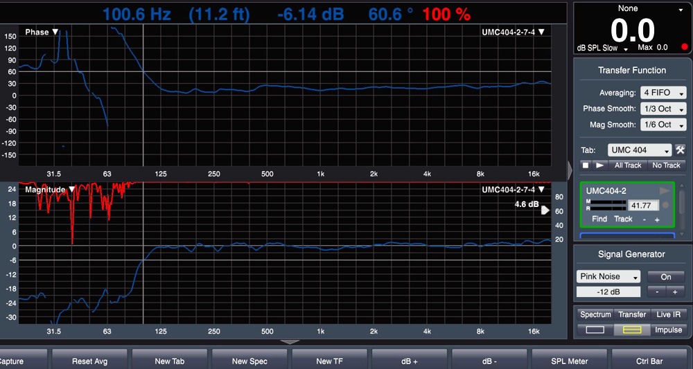

Hi Pos, new poster to rePhase thread.
First, many thanks for your great program!!
I'd like to ask a few questions on how to use rePhase with my tuning project.
The project is a 3 way main speaker and ultimately aligned with horn loaded subwoofer. It's PA gear and I'm using a miniDSP OpenDRC DA8 and also a 2 channel DA, feeding into a X-32 rack mixer enroute to amps.
Measurements for import into rePhase have been made with smaart, outdoors, at a little over 2 meters. I've gone through driver by driver tuning per the instructions on the miniDSP site with fair success, but just recently found updated instructions such as your post #674 in this thread, and am now working with those.
Crossover points are: sub to MF @100hz, MF to HF @650hz, and and HF to VHF @6300hz. I'm currently using LR24 at 100, and LR48 at 650 and 6300
I was going to use the DA8 in a 2X3 configuration for the mains, but found I could not get as much phase flattening as I would like on the main MF section's 100hz crossover with the 2048 taps available in the DA8, so I am currently using the DA's 6144 taps for the MF, and the DA8 for HF and VHF.
So first questions....
I've read your posts to keep filter topology the same on both sides of x-over.
I don't think I need to be concerned with one side of x-over at 650hz using 6144 taps and the other 2048 taps, but I'm wondering if there are any special steps required other than time alignment. (I can do time alignment with either the mixer or DSP amps).
Also, I'm simply using a Y cable to feed the spdif coaxial inputs of the two miniDSP units...any prob there?
As far as sequence with rePhase... my understanding goes like...
1. use Paragraphic Gain(minimum phase) EQ to first flatten response in the passband
2. then use Minimum-Phase Filters 'compensate', and 'time offset' in measurement to flatten phase, and to continue flattening amplitude.
3. Apply Linear-Phase Filters
Q? #1 and #2 affect each other...I assume you just keep going back and forth?
Q? I'm trying to get amplitude and phase flat through the passband and beyond, at least to -15db corners. So far I have had to use Paragraphic-Phase EQ in addition, to do this. But I read in post 677 that I should never have to use phase EQ for individual drivers...
Am I giving up too soon, going to Phase Eq?
Do you use mulitple HP and LP compensations or something I'm missing?
Last Q? 🙂
Regarding 'maximum response level' given under generate....
Does it need to stay below zero?
Again, thanks for a remarkable program...here's a transfer function from smaart when using 2048 taps for MF...been too windy yet,to measure 6144 tap try. I'm stoked how well your program works!

Hi Thomas,
😱 it can be hard for a single driver (with limited bandwidth)
Why don't apply directly the target from an another instance,in a free bank (once the measurement is flattened) ?
Thank you Thierry,
Yeah, I saw that post before and still don't understand it...😕
I haven't been thinking in terms of a target curve.
I have a 3 way active (and a sub bank to bring in to the picture later) that I'm simply trying to get level response as a first step.
And I do mean simply..I've gone to some trouble to build an easy to use, outdoor test rig to eliminate complicating reflections.
The target response I've been hoping to achieve, is flat magnitude and phase (at zero degrees) through each driver's passband.
And remaining flat in phase through at least -15db magnitude rolloff points, with whatever crossover I'm trying (either LR 24 or 48 for simplicity).
Reason for flat phase to at least-15db ...I want to experiment with adjusting crossover points for best off axis response, .....without having to be concerned much with summation..
So to this end, I've been importing measurements driver by driver, and just playing to get desired response.
My use of 'compensate' so far, has been to think of it in the same way as the "Box" and "Subsonic" fields work in the Minimum-Phase Filters Linearization tab.
Is this a proper use of compensate?
I guess understanding how 'compensate' works, along with the comment that phase eq should not be needed driver by driver, is what I'm trying to get a grip on....
Thx ..
