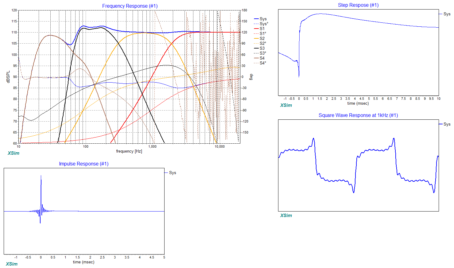

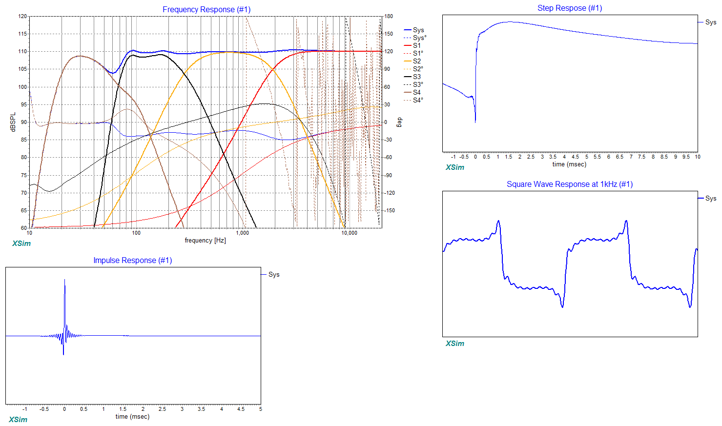

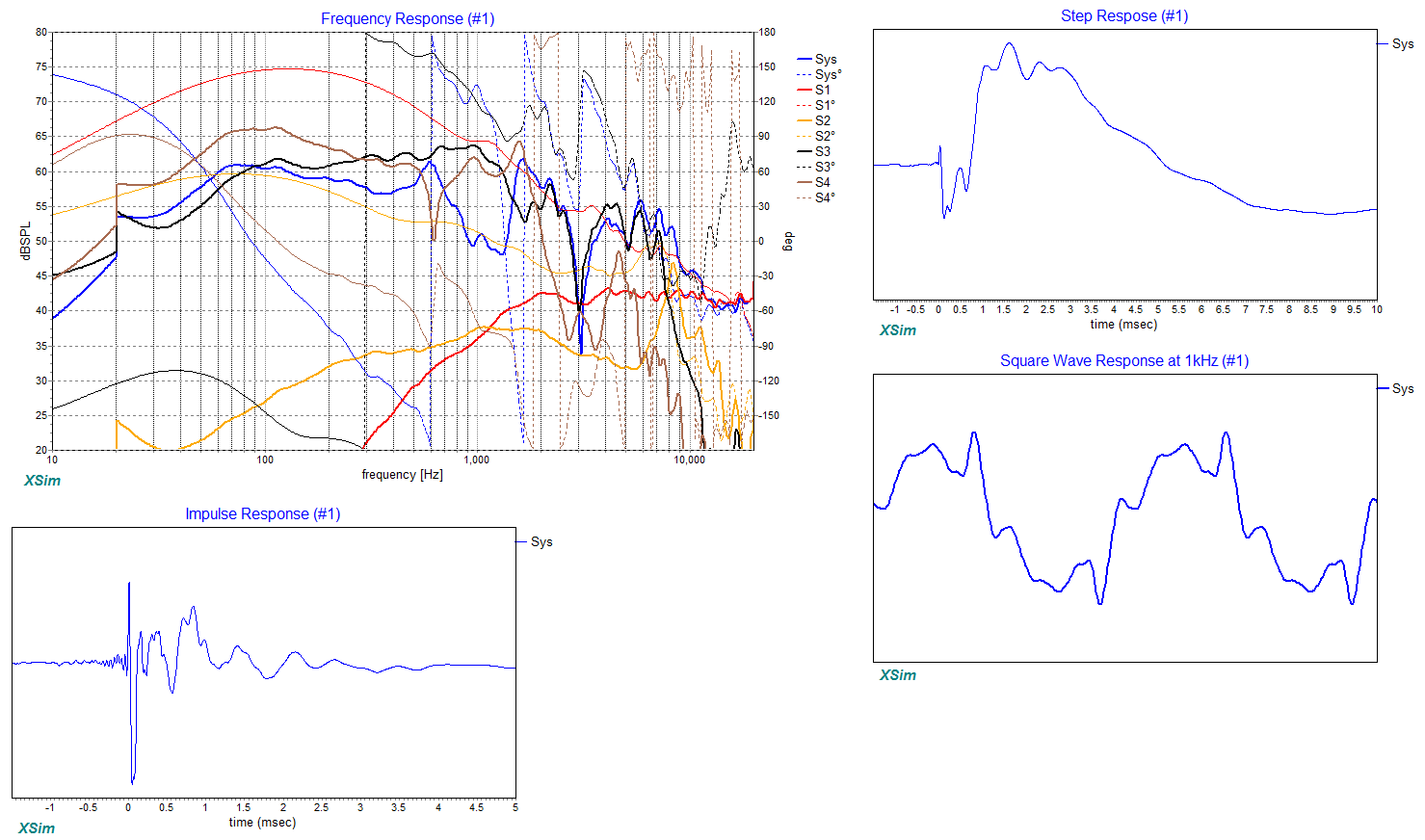

Good here the four band passes into XSim linked to four individual parallel coupled drivers, blue traces is sum.
First plots the four raw frd responses, second plots the four rephrase corrected files, third plots same a second but with MW lowered -3dB.
Looks as slopes for W and MW need more trim care.

Thanks a lot BYRTT for the analysis.
Yeah, i will do the level match using Jriver plugins as you had suggested.
I will work on better blending of the XXLS and W22s
Do the phase and driver delays appear ok?

Based sense from previous posts this is your first attempt into DSP and Rephase this is very good work, system phase (blue) varies in bandwidth around +/- 20º and in finale system you still have live delay and spl switches to tweak on, and also a system EQ to form a house curve could be added there.
Did look closer in Rephase files and some error seems MW has LR8 HP and W has LR4 LP filter, will try edit and come with two new plots where W/MW XO with LR4 and or LR8 slopes.

Yes that was an error on my part. I intended to use LR8 symmetrically for XO between the W(XXLS) and MW(2x parallel W22). Note that the XO is at 60Hz, but i also wanted to shelve the drivers to overlap over 60-100Hz range.
One thing i want to mention is that the 12" XXLS are mounted on the sides of the speakers where the W22 are on the front baffle.

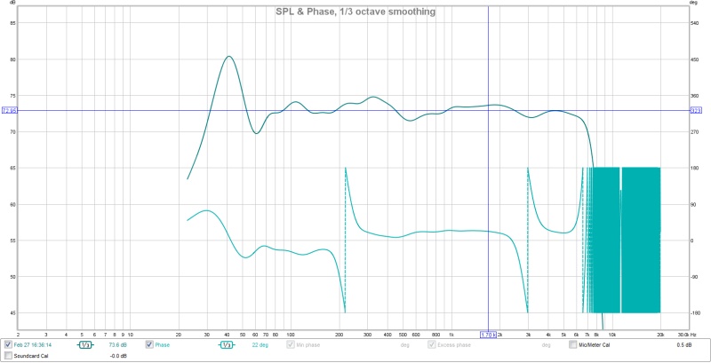

Hi folks,
can someone explain why the high freq steeply rolls off at around 8k?
Is it a measurement artifact or something off with the filters?
including the rephase files.
Jriver is set to resample everything to 96KHz
