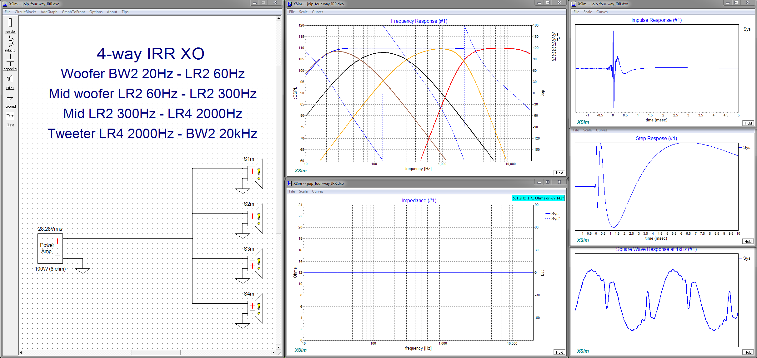

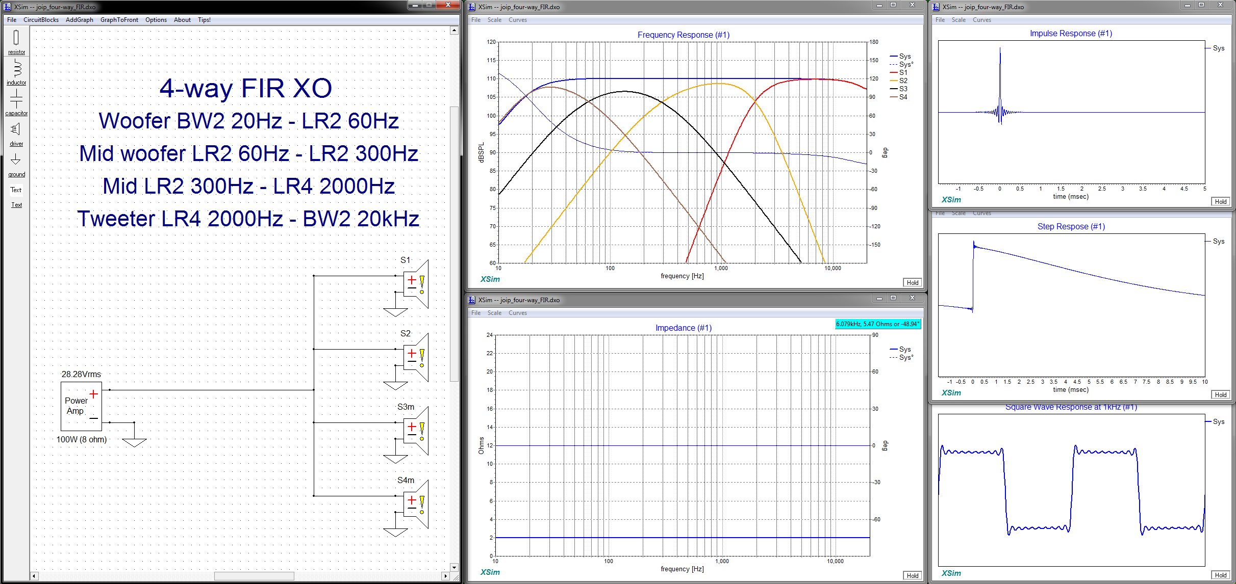

once i have the per driver filters created, is there a simple way of seeing the predicted consolidated response with all drivers together?
If you end up with complementary acoustical slopes (same crossover type for low and high pass) then it is only a matter of getting the levels and delays rights (as well as polarity if you inverted it in some measurements!) and you should get a flat summation.
This is easy to check, for example using the reversed polarity null method.
Having two IR-wav files imported into REW there is some tools available in there, it can make the delays by offsetting IR and offsetting spl level is also easy, then on "All SPL" tab there is average response button and other tools if choosing "Controls" when view is in "All SPL"-window buttons as make A+B plus more. But to blend more than two imported IR is over my head.
XSim seems a possibility connecting its build in textbook perfect wideband driver direct parallel to power amp and get real world measured drivers response blended with correction filter linked to driver in XSim. XSim can't read wav-files but REW can read and export to frd-file that then is linked to driver in XSim.
Control settings in Power amp in XSim is watt/impedance/delay/polarity and control settings for each driver is polarity/mute/spl/delay, and add to those settings that one can pull each driver in and out of network on the fly, and if that is not enough control then open XSim as many times as computer can pull with same template circuit and make different settings within each template so as to compare results when hovering mouse over MS taskbar.
Below is a 4-way speaker example probably close to joip targets, first is pure IRR setup and second is IRR system pass band with FIR XO slopes seen on steps and square wave plot. Drivers pass band for examples is textbook slopes made in Rephase imported to REW and exported as frd-file for use in XSim. For IRR example had to offset IR to zero for them to sum right but could have slided delay up or down for each driver to get to same result.
So think above request can be summed and steered with controls for each driver for polarity/mute/spl/delay inside Xsim. To create one of four band pass for XSim then open that drivers measurement in REW plus import its Rephase correction and then in "All SPL" tab under "Controls" chose "A:" to be driver measurement then "B:" to be Rephase correction and set command "A * B" and hit "Generate", export this new "A times B" as frd-file to link in XSim.
