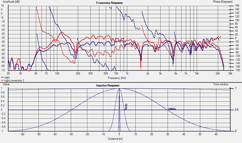

Im sure I screwed something up. Trying to correct my desktop listening position. Source is an Oppo 103D to a MiniDSP OpenDRC DA8 to a Yamaha power amp to wharfedale diamond 220s. Also have a sunfire mkIV sub, but that's off for these adjustments.
I corrected frequency response at the listening position and am happy with the results considering all the room issues (hard surfaces, sitting on a desk). Thought I would move onto to try phase correction. Here's what I did (mostly followed mwillems' tutorial: Guide to Speaker/Room Correction Using Freeware and JRiver):
Took measurements in HOLM of right and left channel at listening position (near field ~ 3 feet, laptop output HDMI to OPPO, UMK-1 mic). They were essentially equivalent so I loaded one into rephase. Choose a crossover linearization and port setting that got rid of wrapping. Used slide bars to get it pretty flat. Using 1650ish taps generated filters and uploaded them to the minidsp. Remeasurement shows phase no longer wraps in above used portion of frequency response.
But...
It sounds weird! I'm no golden ear so bear with me - soundstage is more open, more atmosphere, but everything sounds less natural. Voices too forward and less focused. I recalibrated without the slide bars - only trying to eliminate wrap, but didn't help.
Am I just not used to in-phase music 🙂? What is the expected improvement?
Is it the single measurement at the listening position rather than close speaker measurements?

I'll reply here. If you use some heavy smoothing before exporting from HOLM, you get a clearer phase curve. 1/2 octave works for me, sometimes even 1 octave. That lets you see phase tendencies more clearly and know what to correct of not correct. You don't want to correct every little kink, as POS pointed out on the other forum.
