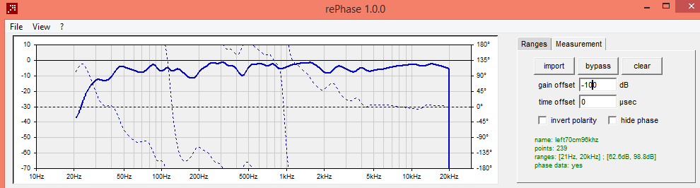

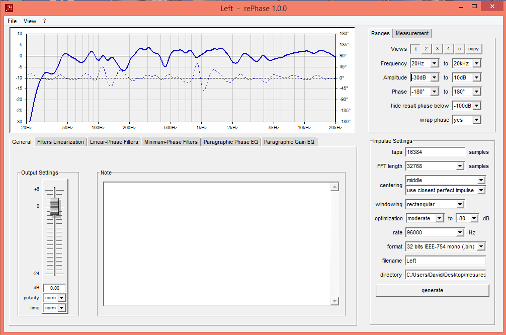

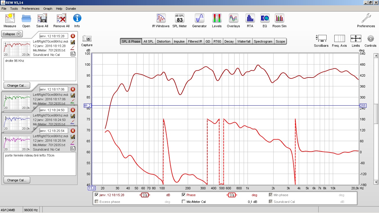

Hello,
Here are some visuals of :
left and right measurements in REW. I have not done specific settings except calibration of the microphone and setup of asio devices. All my measurements and corrections are done at 96 Khz.
I did not touch settings with regards to polarity and timing.

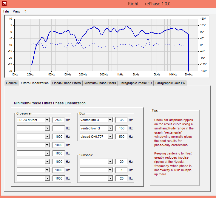

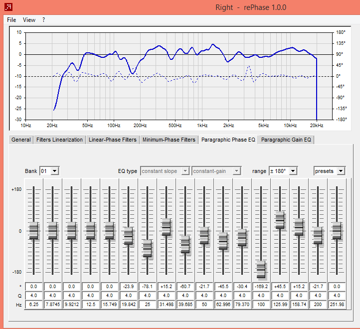

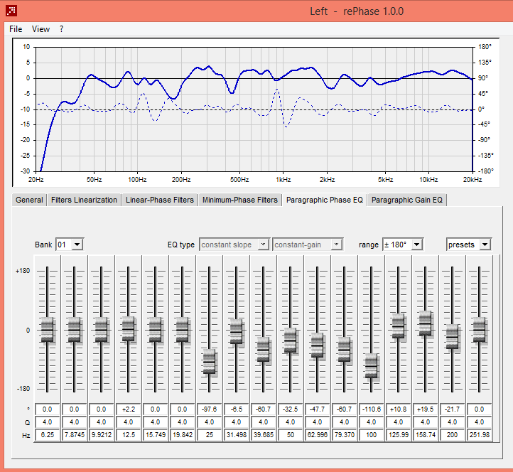

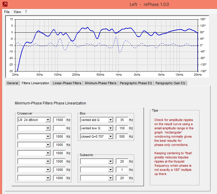

Then usage of rephase for phase correction with those settings :
For the left channel :
On this tab, I used 1/3 oct bands and corrected on the 3 of them

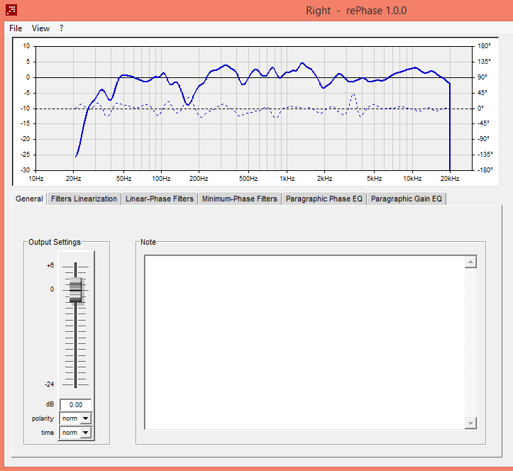

For the right channel :

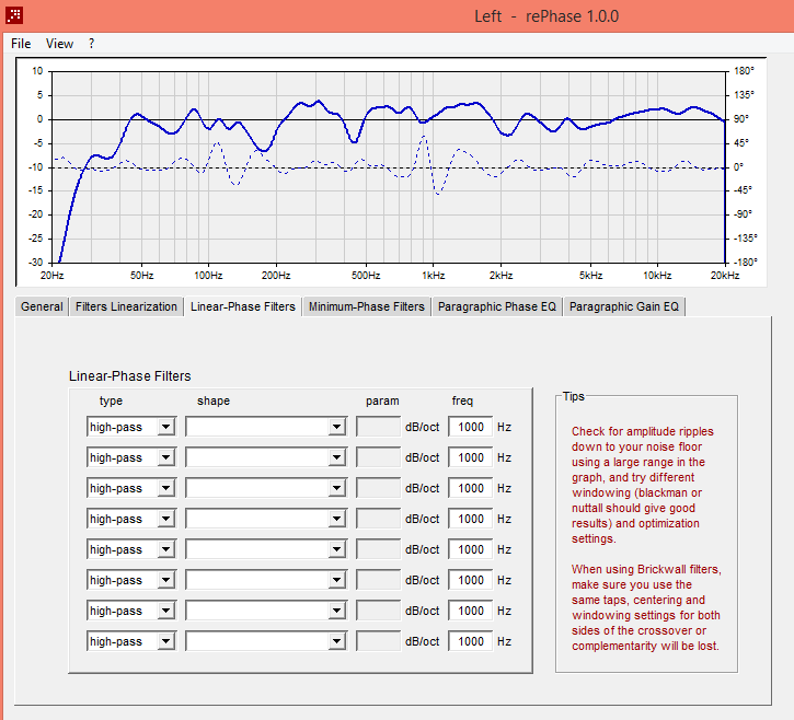

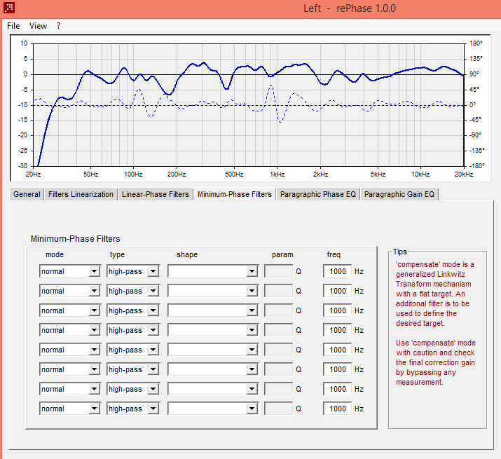

Filters are well exported with success to Daphile or Fedolight, but the results are not so much noticeable... I'm sure I might do something wrong.
Also looking at the wave form in Audacity, there seems to be very few elements in the wave. Is this normal ?
Many thanks for your help
David

Hi David,
Can you also provide REW measurements (SPL/phase) of the equalized loudspeakers at 70cm and 80cm?.
My apologies if you have already done so, but I somehow missed this - thanks.
Best Regards,
Bohdan
Hi Bodhan, if you mean their import in rephase before correction, there you go :
David
Hi David,
No, that is not what I was asking for.
I was interested in SPL and phase after correction.
This measurement should be taken at two locations: (1) at the same distance as the original measurements and (2) 10-20cm further away.
You have also provided already Audacity screen shot of what seems to be an impulse response of the equalized loudspeaker - am I correct?.
If this is the case, please expand the Audacity screen to full size of your PC monitor screen and change vertical axis to Logarithmic. It is useful to evaluate IR in logarithmic scale.
Best Regards,
Bohdan
Hi David,
The JMR Cantabile are supposed to be filterd as:
" 6, 6 and 18 dB/octave
. Cut of frequencies 600 and
3800 Hz. The two woofers are working together
under 600 Hz. "
and can be seen like a two ways for xover.
If you look at global shape of the phase measurements, accidents free,( at 110 Hz ect ) it gives:
in rePhase ( time inverse ) just two settings: ( grosso modo ) to reach
the global shape, then some eq to add.
cdt

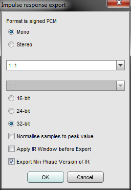

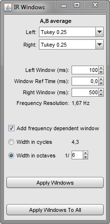

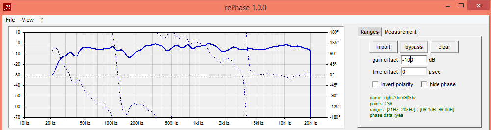

zizione, have you zero aligned IR those REW mesurements before export to frd-file to use in Rephase.
Here a couple of ways prepare in REW before export to frd-file, no claim these is the only and right way.
In general its worth after a new measurement look in both "Distortion" and "Impulse" windows as first thing after a new measurement sweep, if anything there looks weird and collapsed sweep again. Many has no problem but many setups show measurement chain trouple at some sweeps probably caused by environmental interferences and sample rate converting somewhere. Frq response often looks fine therefor look into the other two windows to see these sweep flaws.
1:
After a measurement or opening a old saved one view window in either "SPL & Phase" or "Impulse" plot then hit "Controls" and "Estimate IR Delay". Now export that as frd-file to be corrected in Rephase.
2:
Above will have phase plot that is speaker + room, this one will form phase as to be same minimum phase plot that is associated the actual frq response. First do same as point 1 except do not export as frd-file but export as "Impulse Response as Wav" as in below picture 1. Now import that IR-wav-file and zero align it with "Estimate IR Delay" command and its now ready to be exported as frd-file to be corrected in Rephase.
EDIT for point 2 after hit "Estimate IR Delay" then button above it "generate Minimum Phase" need be pushed too else one gets error pointing to this subject under the export as "Impulse Response as Wav" command.
3:
This is same as point 2 but add a frq dependent 1/6 oct 4,3 cycles window so as correction made in Rephase is more based first front wave than room. Procedure is before export frd-file as in point 2 ensure at left side that imported IR-wav file is high lighted then hit icon "IR Windows" and set it as in below picture 2 and hit button "Apply Windows". Now export that as frd-file to be corrected in Rephase.
In all three points above IR will be aligned but big difference is what measurement present to Rephase to correct for in time domain, so one must judge what will be most right if measurement is taken at 0,5-1,0 meter distance or at listening position and how much room is really present into measurement. Point 2 and 3 is inspired from another thread subject starts in link http://www.diyaudio.com/forums/full...eaker-correction-networks-21.html#post4548875.

Hi guys,
During the week-end, I have tested all methods. So far, I'm staying with Method 3 of BYRTT which provided the best improvement. It is quite amazing how deeper and clearer bass sounds, instruments are much more differentiated, space gained also a lot.
On complex messages like "Unsustainable" of Muse, everything is in place, and much clearer...
I'm going to continue a little bit my investigations, but I'm an happy guy right now...
Thanks Jmbee and BYRTT for your help
