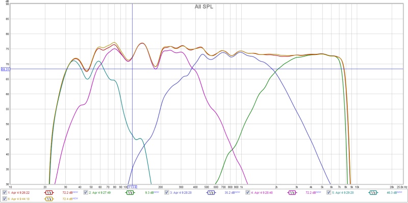

Hi folks,
can someone explain why the high freq steeply rolls off at around 8k?
Is it a measurement artifact or something off with the filters?
including the rephase files.
Jriver is set to resample everything to 96KHz
You don't seem to have any crossover point around 8khz, and your rephase correction file is not doing anything crazy in that range.
So I don't think this has to do with the measurement windowing.
When listening to the speakers to you here the >8khz range?
What happens if you measure the tweeter only?
I played some HF tones. I was able to hear 12.5, but nothing above that, my 5 year old did confirm that he was able to hear 16KHz. So likely the HF is present.
When i measure the tweeter with the filters bypassed in Jriver, i see the response upto 20Khz
