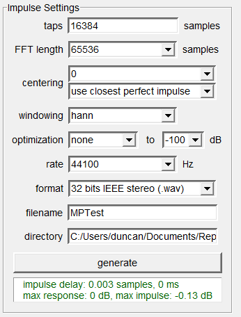

Hi!
Basically I'm using RePhase as equalizer (nothing fancy it would seem, just generate a filter after adjusting the gain EQ phase)
My hardware for this is OpenDRC
I have several questions
1)
Centering part of RePhase UI allows to specify delay in ms instead of "middle" or "energy"
Middle doesn't seem to work at all (the optimization step never finishes, goes into thousands of iterations and keeps going for many hours with no end in sight)
energy works, filter is created but UI printout claims that expected delay is quite hefty - 52ms (ouch, I guess)

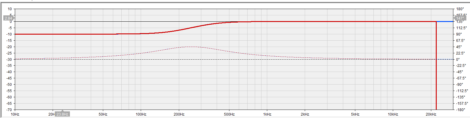

specifying some very low ms value (2ms) results in apparently successful creation of filter with no apparent deviation (both thick red line for gain and punctuated red line for phase match the predicted curves perfectly)
What is the tradeoff from specifying a very low delay value (1-2ms) in the "centering" part of UI specifically in context of using minimum-phase gain EQ for headphones?
Would the resultant EQ be somehow deficient / introduce unusual noise / ring / anomalies relative to the energy-centered, "heftier" 52 ms version?
2)
Does it make sense quality-wise and latency-wise to break the EQ down into "problem" part that PEQ GUI of open DRC doesn't handle (due to Q<0.5) and "do the problem part" in FIR and then add the missing "normal" peaks (Q>1) via OpenDRC's PEQ interface (thus essentially chaining filter-as-EQ and "proper built in EQ")?
To center in ms , the filter taps need to be at least the length or half (??? What I’ve noticed) of the amount of delay…. Like you can’t do 10ms on a 200tap fir , but could on a 1024tap fir for example
moving the centering forward is for getting better centering on low frequencies. You can use “less taps” and get good phase and amplitude on your fir
you can’t capitalize “ms” in the box or put spaces
i think Just try all lower case like centering ten milliseconds would be typed ; 10ms
if your using an OpenDrc and doing a correction on everything I would go for use center of impulse or exact centering. Use the max taps if it won’t generate clean. And try starting with a rectangular window first and try other windowing schemes after rectangular works. (I always use rectangular or Hahn)
and you should see 64ms of delay using the 6144taps. So 52ms isn’t bad.
as far as other errors, idk , pos would know
@Oabeieo there are taps to spare it would seem given that I'm not doing much other than EQ, so using them all up to get a fast and reasonably accurate EQ is okay by me.
The filter apparently generates fine with very low values in ms (like 1 or 2) and as far as I understand the GUI is very congruent with expected curve and phase

It does not take less taps as that will will affect the frequency resolution and shape of the filter.
A minimum phase filter doesn't need to have the impulse centred or offset as the impulse response is not symmetric like a linear phase or symmetric'ish like it would be in a mixed phase filter.
When there is no phase/time correction being applied the peak can be right at the start. The actual latency that you get through any device or computer will depend on how the convolver is programmed and the length of any buffers used too.

So what do you think his issue is , an install issue with rephase?
Bad choice of settings I think. Enter 0 with closest perfect impulse to get the lowest latency.
I tested this with Jriver and it gives me the shelving as depicted with effectively no latency, for MiniDSP would need to be a 48K bin file at some other number of taps.
I don't think I have a "problem" per se - with settings like 1ms the filter builds and does not exhibit any "coarse" anomalies (one of the problems with headphones that are good, is that equalizing them to be even better can get placebo-tricky very fast ;-) )
I am mostly curious whether specifying a delay/latency and very low one like that (I'll try "0 with closest perfect impulse" today) has any substantial drawbacks with my application (a "no frills minimum-phase EQ).
I suspected it might have drawbacks given that "default settings" produce a filter with delay in 50ms range and decided to seek more knowledgeable people.
