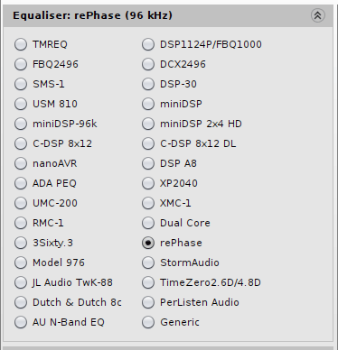

What's the thing with rePhase showing 96kHz in EQ setting in REW?
Are there anything i should know regarding this if i would create some PEQ filter's to an Pre-EQ on my CamillaDSP engine?
As far as i know, the PEQ/EQ is not samplerate dependent, so one EQ can be used for all samplerate's.
What about if i instead of using the PEQ/EQ directly, take the easyroad and create some fir's (.bin etc...) instead, will there be anything ragarding 96kHZ then ?
My UMIK mic. is only native 48kHz, so better stick to this when measuring. - So not able to create 96kHz with/in REW i guess.
Sry. guy's, i find this a little confusing, and can't really find any information about it.
(I just need to understand it proberly 😊)
Looking forward going into DRC/DSP again btw... - It's been awhile!

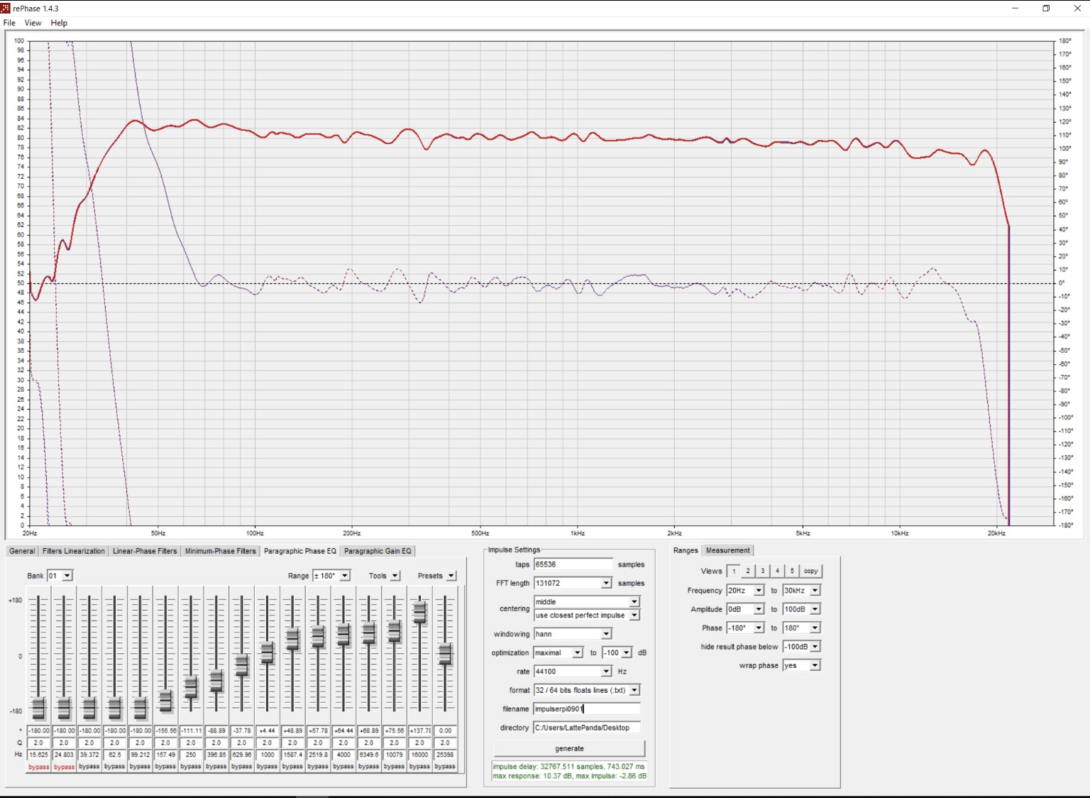

So ran extensive testing…. Got like the most ultimate tune going with rephase… it’s absolutely stellar…. So here’s some gif bits that everyone might benefit from
Over and over you’ll read in this thread not to use linear phase EQ…. That is good generic advice, but it also dodges some very technical and advanced exceptions..
I’m in a highly reflective environment (some of you may be in small rooms like mine)
I’m flat flat responce with a default target that’s a small tilt down…. (About 1.6db-octave 3000-20k) and a tilt up from 300-DC) and dead flat from 300-3000…
Target means nothing for this, but if your impulse looks better with small eq cuts where you do not want them, I would suggest trying using linear phase EQ…
Here’s the deal , keep the Q wide! 2 or less!
And don’t go more then cutting more then about 2db…..
If you need to make a EQ cut but don’t want the timing change, try linear phase eq…
I’ve had excellent success, it actually lessened my pre ringing as I was able to retain impulse shape yet follow my target precision to +/- 0.5db (1db total)
I have discovered (for myself at least) linear phase EQ does have a place in reproduction, and boy can it really help when your working down down between 2db and 1db of your target shape…
Only use it when things are really really dialed in and only use it between 700hz and up… maybe a little more of less, but stay away from the midbass as that will pre ringing very easily….
Obviously you have to be way zoomed in to see it

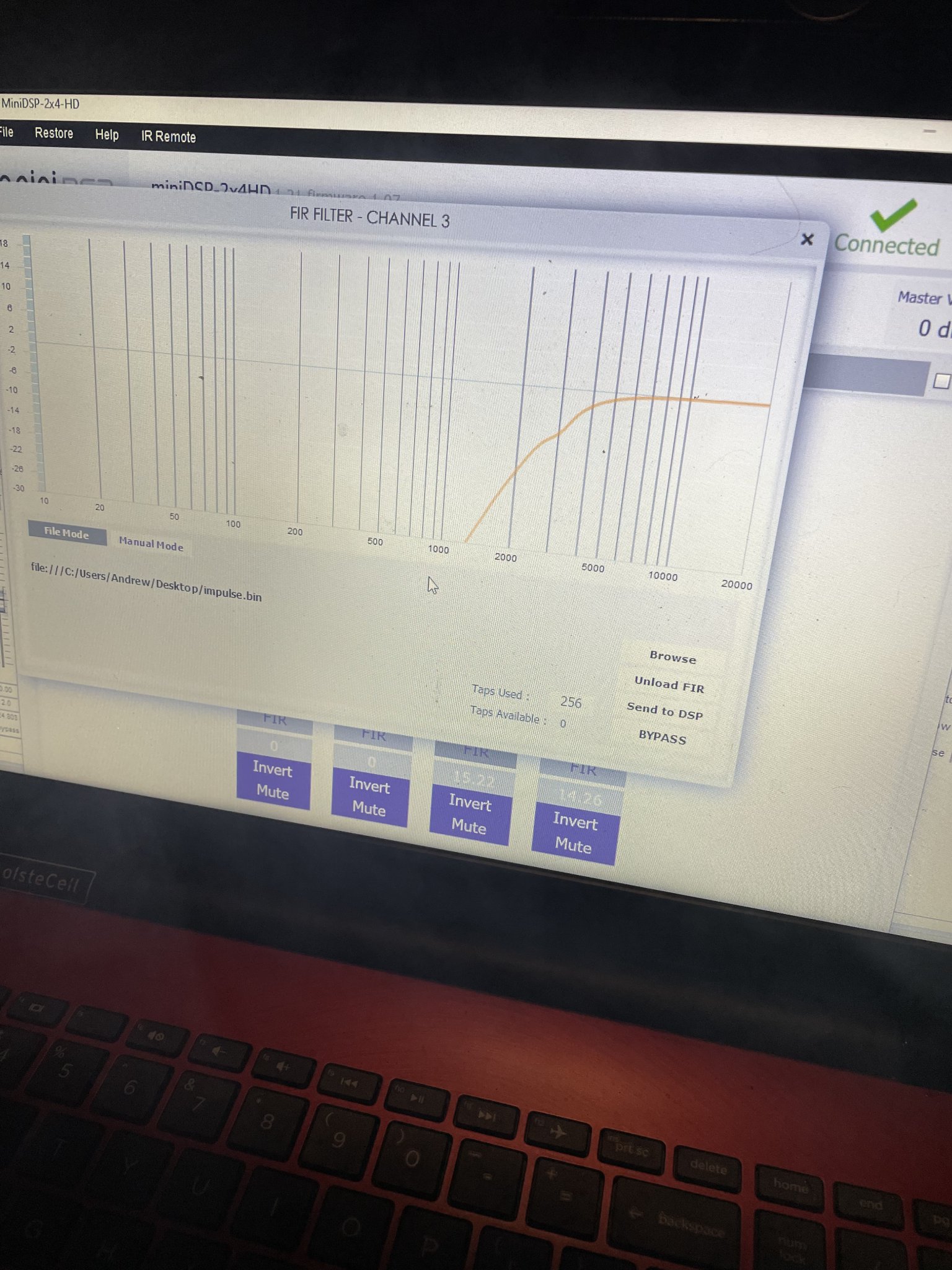

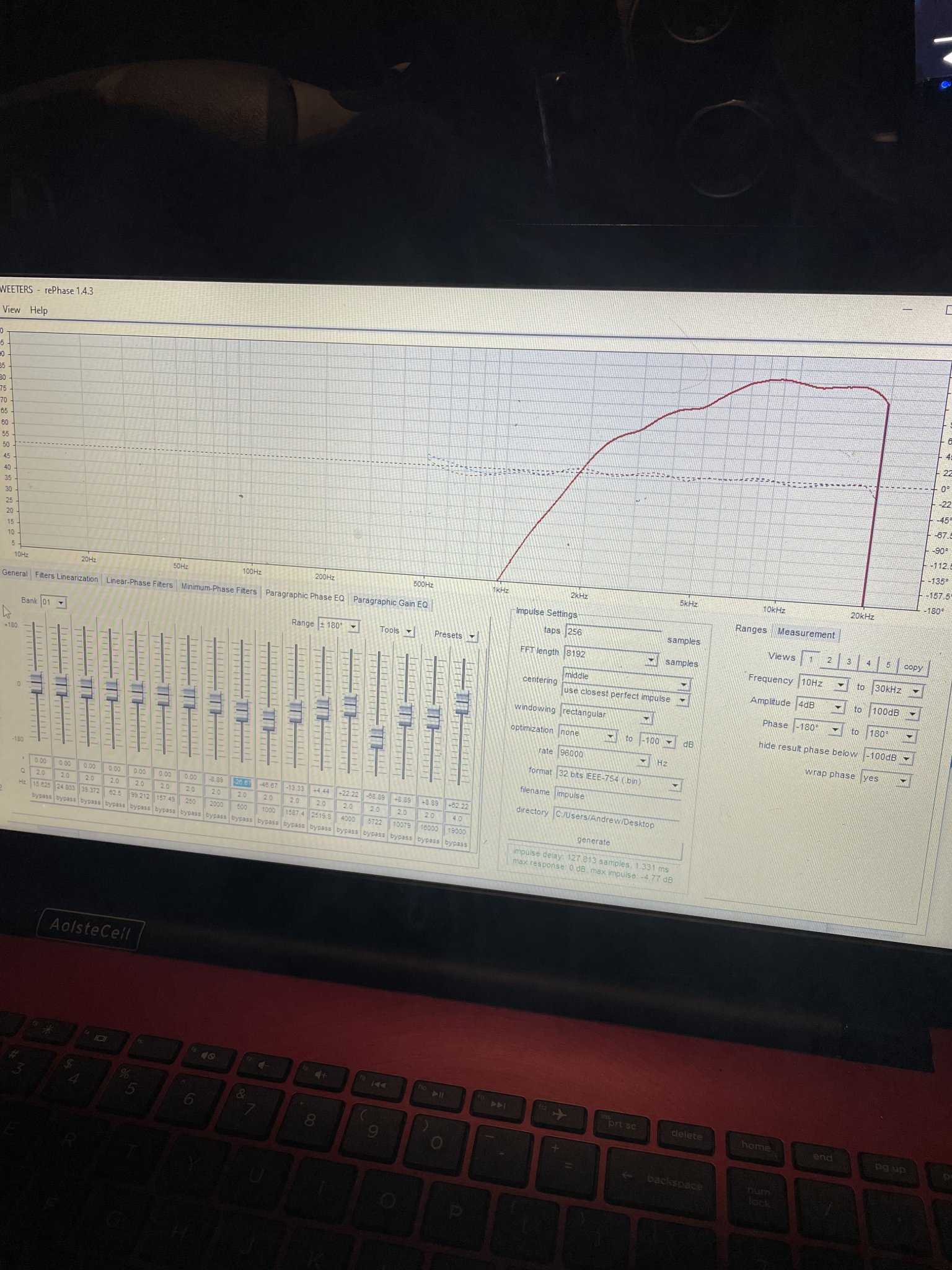

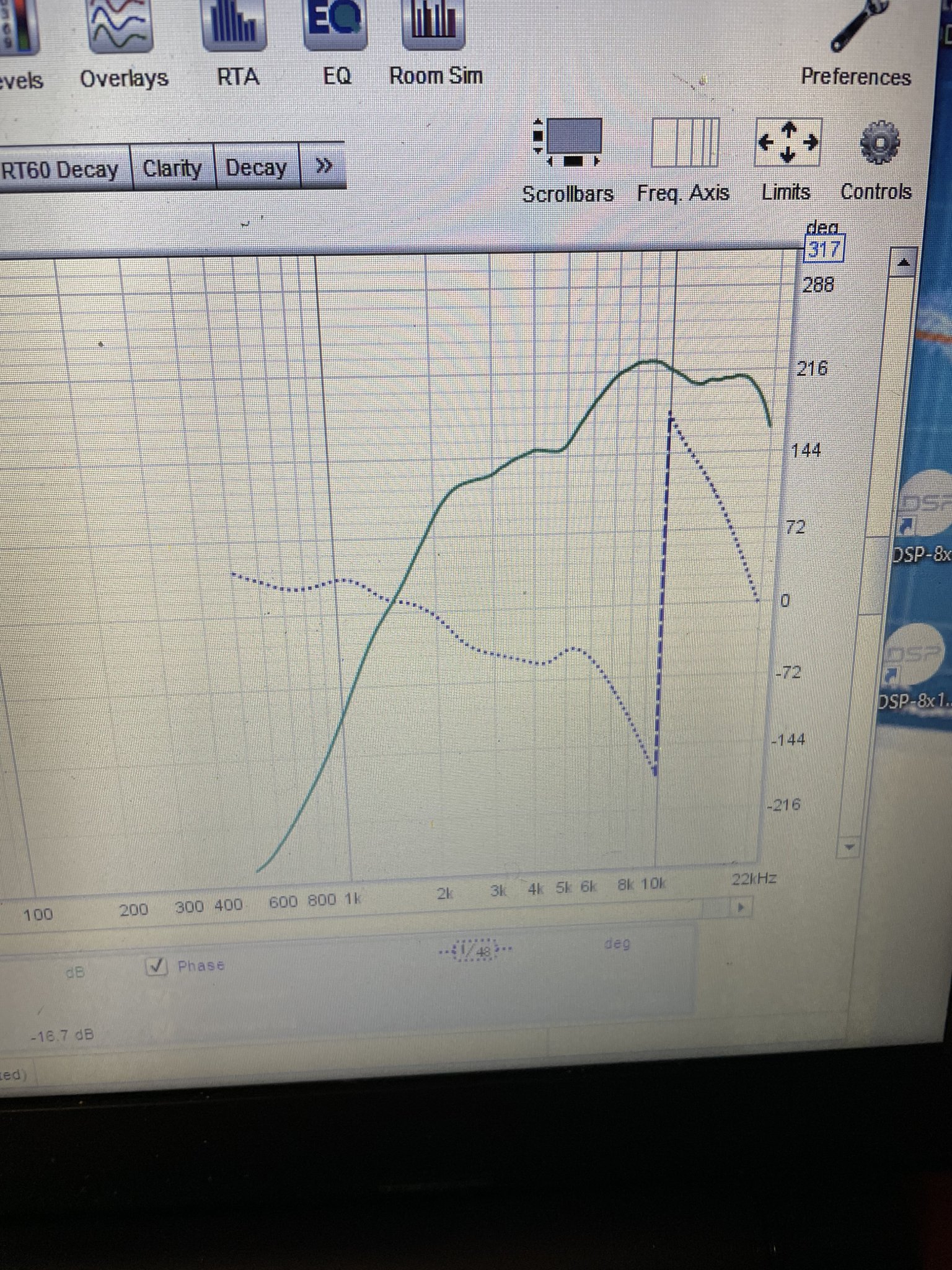

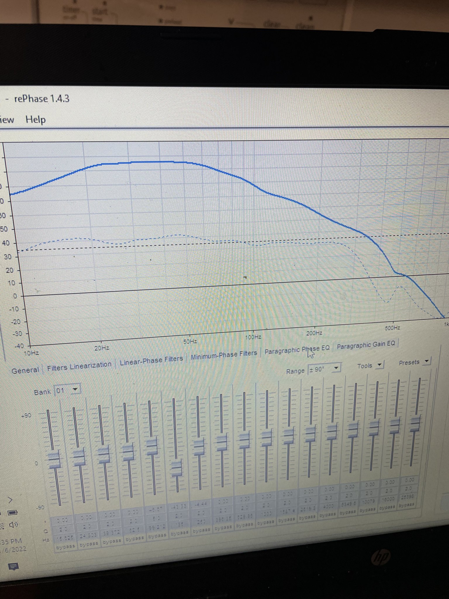

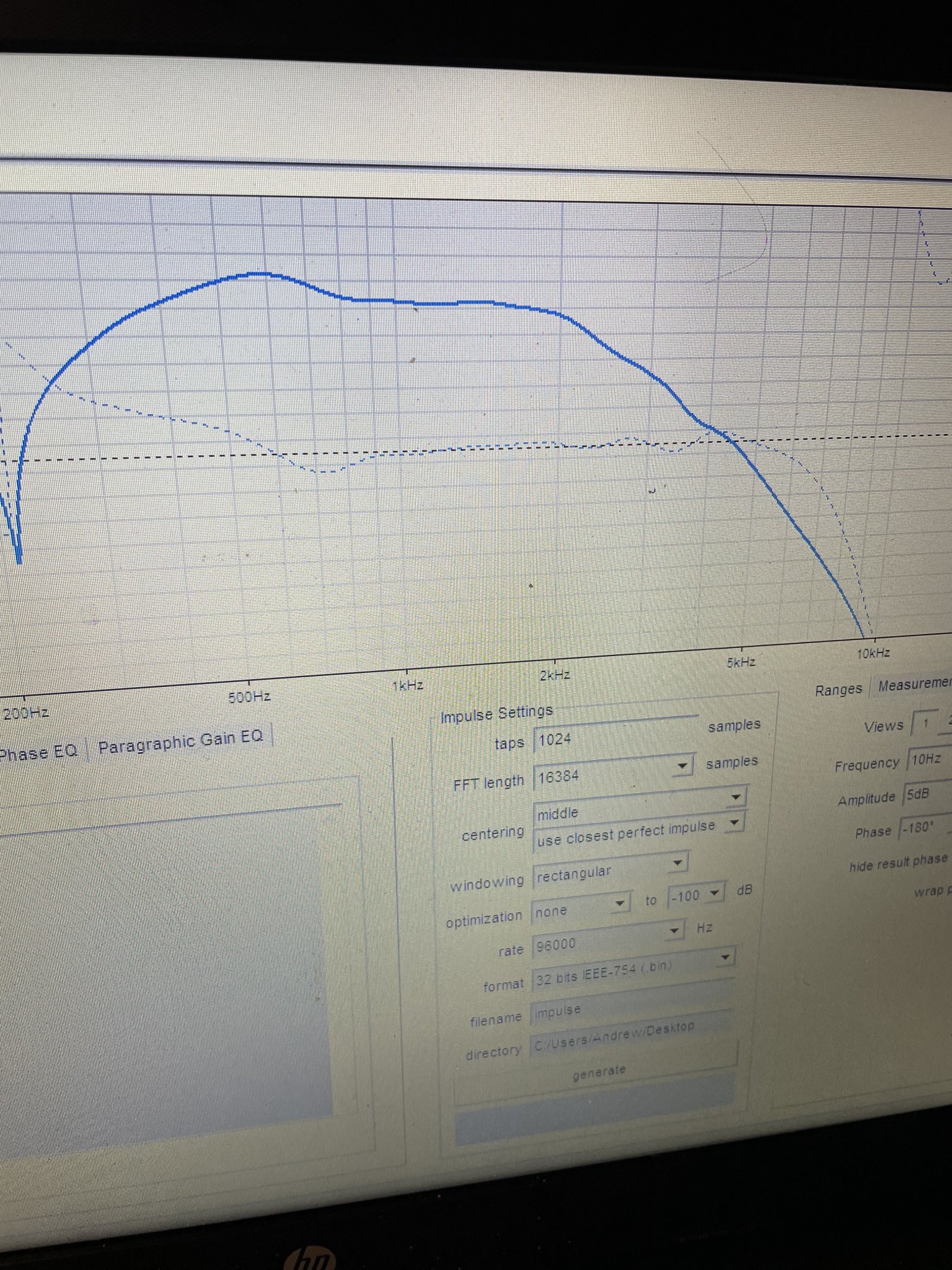

Did some tuning , my goodness things are getting really dam good now
What I can do with my limited taps ,
256 on tweets
1024 on everything else except sub
Sub 1792 taps
Rephase is very (very) bad *** boys…. It makes a car sound superb

I use 1 ddrc22d with is2 clock synced to a OpenDrc running 4x8 96k plug in (in 2x2 mode using optical out) OpenDrc is first in the chain.What DSP do you use in a car?
3 way optical splitter
3 2x4hds (1024 taps per channel)
I basically have my sub and tweets on one 2x4hd so I have 256taps on tweets and 1792 taps on subs
Then 1024 taps on everything else
I basically did this
Crossovers off make response flat on speakers , then turn crossovers on and make linear….
Then ran Dirac , set a target that I really like.
Then , close mic to each Left speaker and make phase flat and apply correction to left and right
Then go to OpenDrc in 4x8 mode and only using CH:1 and CH:2 for 2048 taps on each channel and make magnitude über flat and smooth and get rid of peaks Dirac left, I do the sums of Left and right l together (Dirac does a fine job at separate L and R eq without de-correlation. (That’s why I use Dirac at all, I can’t figure that part out manually). So the OpenDrc just ices the cake… I make the sums of mag and phase smooth with OpenDrc
I choose the 4x8 plug in because it runs at 96k… that way the entire signal chain stays 96k. The toslink at my source is selectable 48/96 and is fixed , so any resampling happens in the deck.
But it makes my hi res tracks actually work (although I can’t hear a damn bit of difference) it’s just for the coolness factor 😎

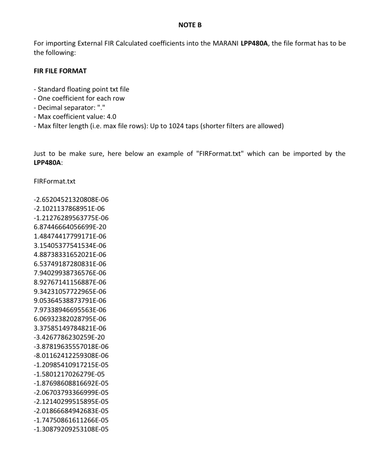

Sorry of I somehow missed this but can the output be configured like the example in the image?
I have confirmed that the Thomann Fir enabled dsp can use the config by inserting the example from this file that the screenshot was taken from: http://www.marani-proaudio.com/public/LPP480A_SwPC_QuickUserManual_180324.pdf
I used the software provided by Thomann in demo mode and imported the filter.

It was suggested somewhere by someone that they might be the manufacturer for Thomann’s house brand.Those are Marani products. I have been to their factory in Guangzhou. They make decent stuff. But not so large number of taps if you want to really create corrections.
So I treated the manual from Marani as if it was for the Thomann equipment and tested the example filter provided in the manual. And it worked.
I’m hoping to replace my Volumio raspberry pi 3 and DB-mark xca28+ setup for my three way synergy horns + tham15 with a 8ch processor with Fir. (On a reasonable budget)
But as you said the hardware don’t support the filter I’m currently running on the PI.

I have made a 192khz measurement in Rew that I want rephase to create an impulse response of, so that I can use that output, in a convolution engine.
There is no problem in importing the measurement into rephase, and it looks exactly like the data in rew, but whatever settings I use in rephase "impulse settings", the export file (either txt, wav or even frd) will result in a completely flat magnitude and phase, when loaded back into rew or any convolution engine. It is completely ignoring the input data it seems, when creating the output file.
The slightly weird thing is that when I press "generate" in rephase, the result is shown in rephase plot window, and that perfectly tracks the input measurements. So it is the output file itself, which deviates.
Can anybody try to make an impulse response in either txt or wav with the attached rew measurement, and see if I am the only one getting this error? Possibly explain how I can avoid it.
The subrew.txt is the rew data for rephase, the subre.txt is an example output from rephase, which shows no data/only noise.
If I do simply EQ directly in rephase and export that, there is a response in the output file.
Kind regards
Michael
@Quickmcj
When you import a measurement, it’s only for viewing,…. When you generate a filter the measurements does not go with it , only the filter you generate..
When you import a measurement it is simply a visual aid to help you make a filter
You have to make some adjustments in rephase controls (eq , linearizarions, etc ) for the output finger to have any change
