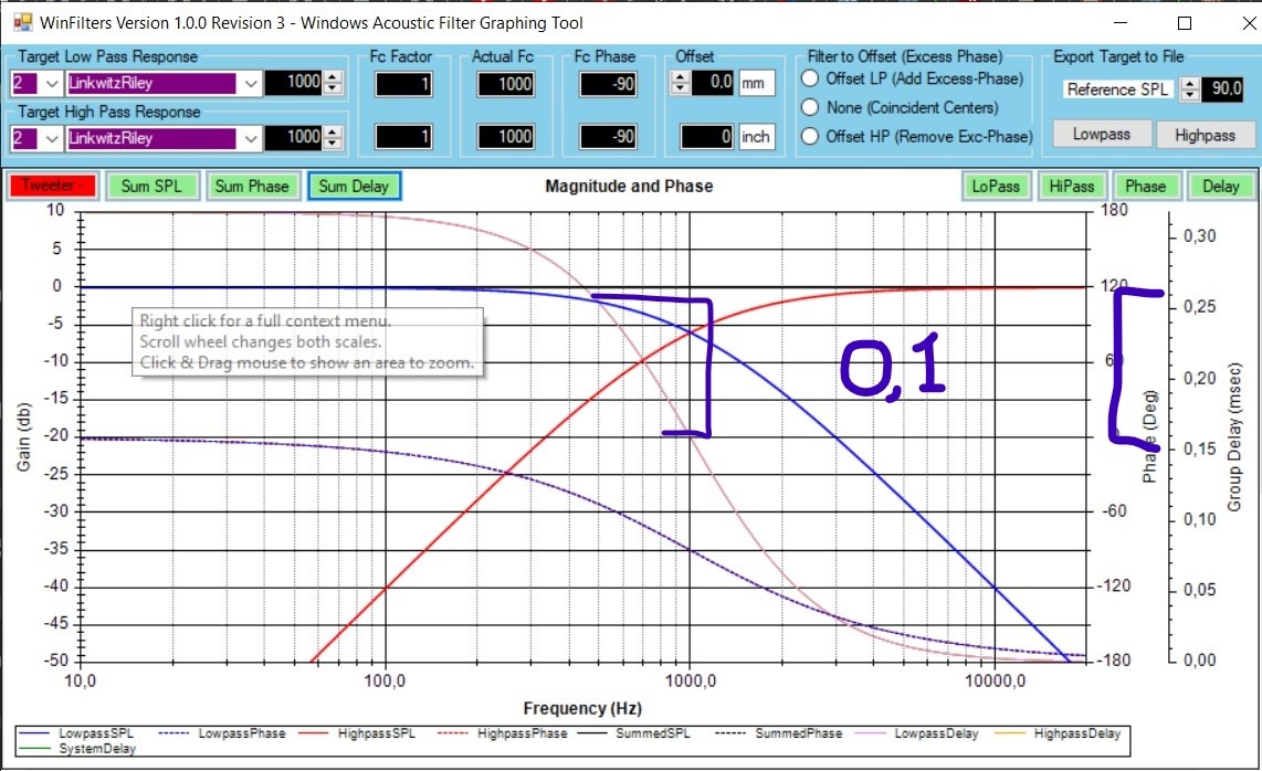

A 48dB/octave high-pass produces more excursion than either 3rd- or 4th-order, because the sharper transition gives more output above the XO point. The difference is fairly small (and excursion is much less below XO, of course), but the key point is that higher orders don't always allow a lower XO frequency.
Right, but you should be able to move the XO point and cover more bandwidth, at 0 transfer function, and to a lower point.

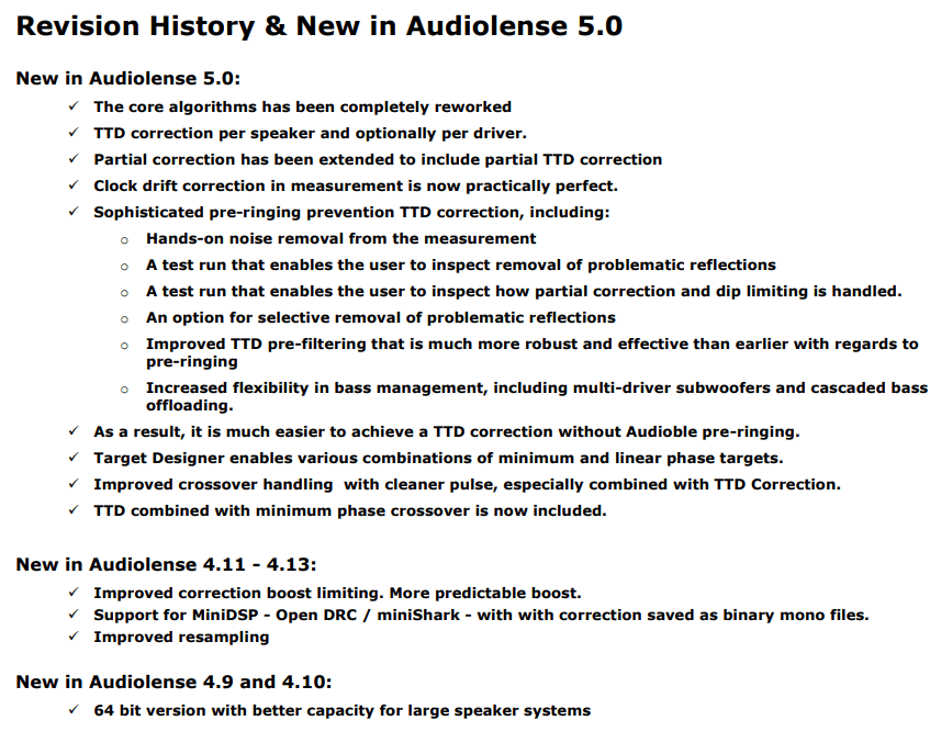

I'm not going to pretend like I know, but some of our well formed members have commented to that Audiolense's filters don't ring.
camplo there is a bit of difference between the type of filters being generated in the "room" correction software like Audiolense and Acourate and those which rephase can make. Acourate has quite a lot of pre-ringing suppression features that remove it while still allowing the wanted parts of the time correction. Filters created through windowing and inversion can be processed more easily in a way that leaves much of the pre-ringing out.
