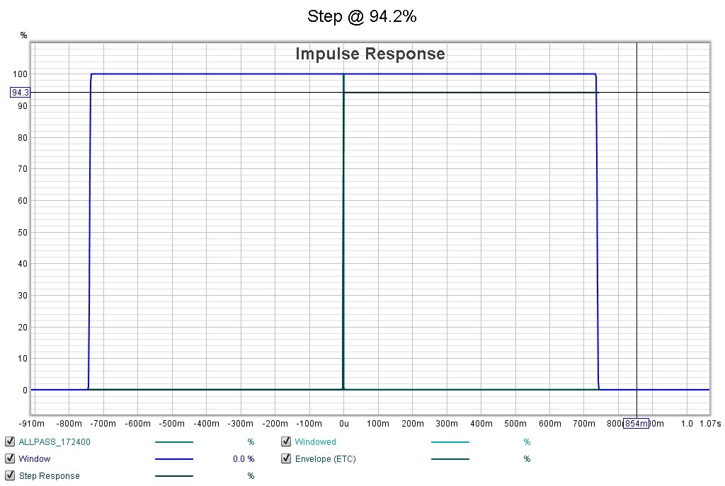

Is there a way to make a linear phase "all-pass" filter in RePhase with a 100% Step peak to prevent any high frequency loss or is such a digital filter even possible ? When I try to create one, the step is @ 94.2 % and haven't figured out how to improve upon that.

No clue , one of the actually smart ppl should step in
but isn’t that just a brick wall filter ?
I’m curious now too 🔈🔊🔉

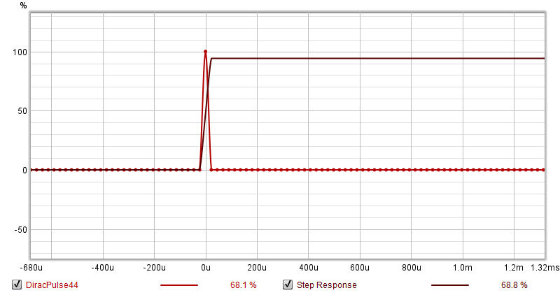

That is a Dirac Pulse where the impulse changes from zero to 100 % over a single sample and back again. What you have there is as good as can be, the impulse is already at 100% to get the step response at about 94%. The higher the sample rate the shorter the sample period will be to extend the response out but will ultimately be band limited in reconstruction.
Ah ha ! Yes of course!
I can’t figure out why I can’t ever think of the answer …. It’s right there !!!
Thanks Fluid.
So to avoid the inherent HF loss I should substitute the "all-pass" filter for a delay the length of ((#taps/2)/sample rate) as a substitute "spacer" to maintain the relative parallel timings.
I learned something new today.
That is how I made the plot above using exact-center-frequency, 176400 and 256K taps (and the 1st empty frequency bank set to "linear-phase".
The number of taps doesn't matter so much for this because there are only two sample values and the magnitude and phase is flat. The bank can be set to anything as long as no filter is set. rephase then generates an impulse with flat magnitude and phase, the Dirac Delta or Pulse. There is no high frequency loss, what you have is already as "perfect" as it can be. The step is different because it is the integral of the impulse. If maths helps
