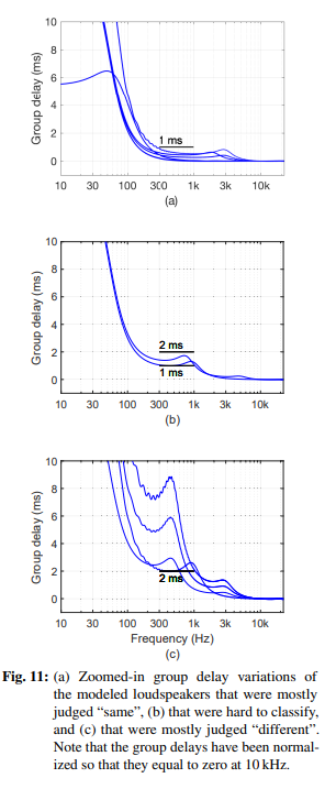

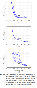

The group delay threshold at low frequencies and associated conclusions don't track with all of the current research on that topic.
One example here
Audibility of loudspeaker group-delay characteristics
— Aalto University's research portal
That is my point how the system is implemented and where it will be used has a big impact on what the best option might be, it is very easy to end up generalising about something that is anything but.
One example here

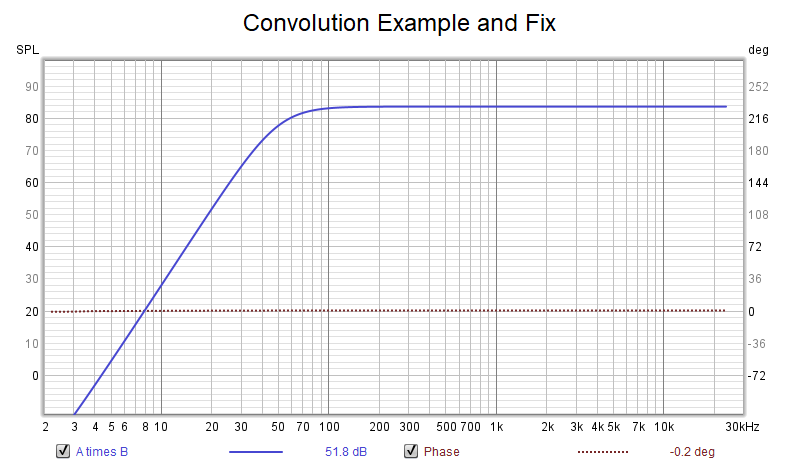

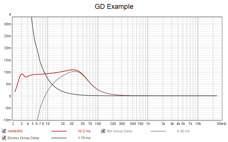

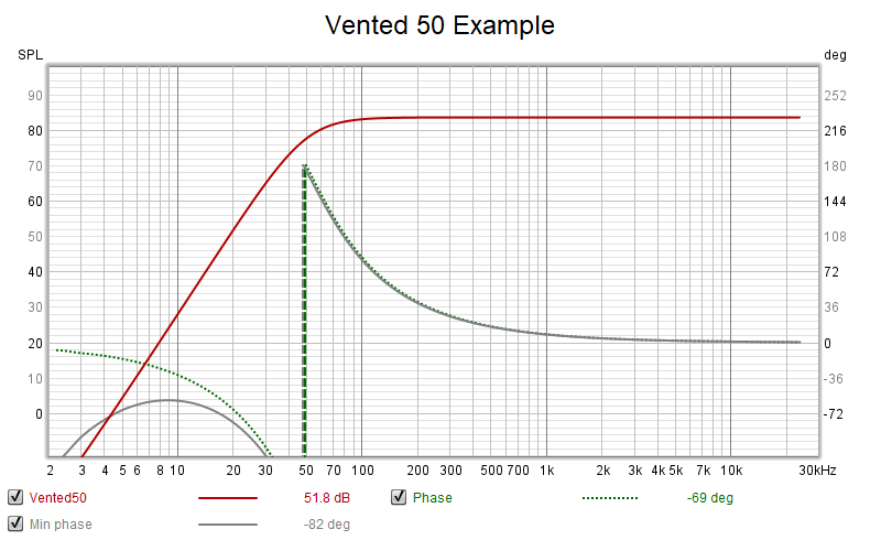

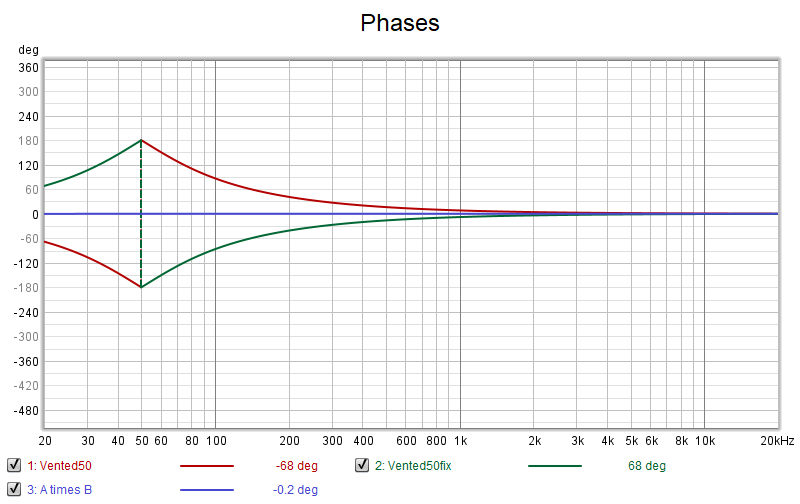

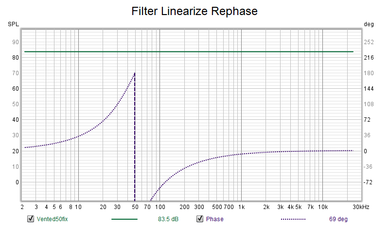

I think you are, I'll try and show you why.At least how I understand it , tell me if I’m wrong
Here is an example of a fictional vented box made with two linear phase 2nd order filters and a BR rotate at 50Hz Std Q.The ported linearization looks like a filter lunearization because the port is a HPF, an acoustic one. It has the same effect on phase as a minimum phase filter would. The amplitude dips and phase rises. The gain from port eq will remove.
The group delay is not that high, this is not an extreme example.
The rephase BR linearize is not minimum phase the magnitude is flat but the phase is the inverse of the BR box. This is what it looks like.
When you convolve the two together you are left with the 24dB slope but flat phase.
Phase comparison

Iterative REW / RePhase Workflow Method
To do this, use REW's EQ function, setup your desired target curve and instead of doing the entire N dB "Match Response to target" cut, do it across multiple passes. Select an incremental cut amount and generate the 1st set of PEQ's and save them using "Save filter settings to file" labeled as "left bank 1".
Then select the "Generate measurement from predicted" option below the "Save filter settings to file" to generate the new "predicted measurement".
Then select the EQ option on the newly generated "predicted measurement", lower the target curve by the chosen incremental amount and repeat the process naming the subsequent filters "left bank 2, left bank 3, ..., left bank N".
You can then load all N-incremental-banks into RePhase and get an aggregate filter more refined versus doing it in a single coarse pass in REW.
