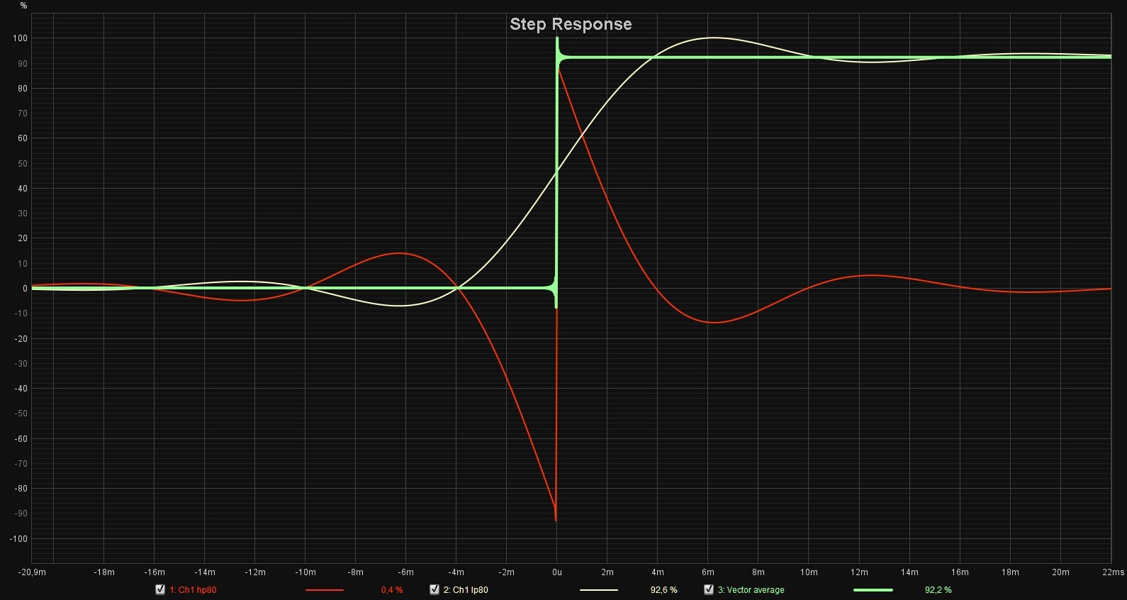

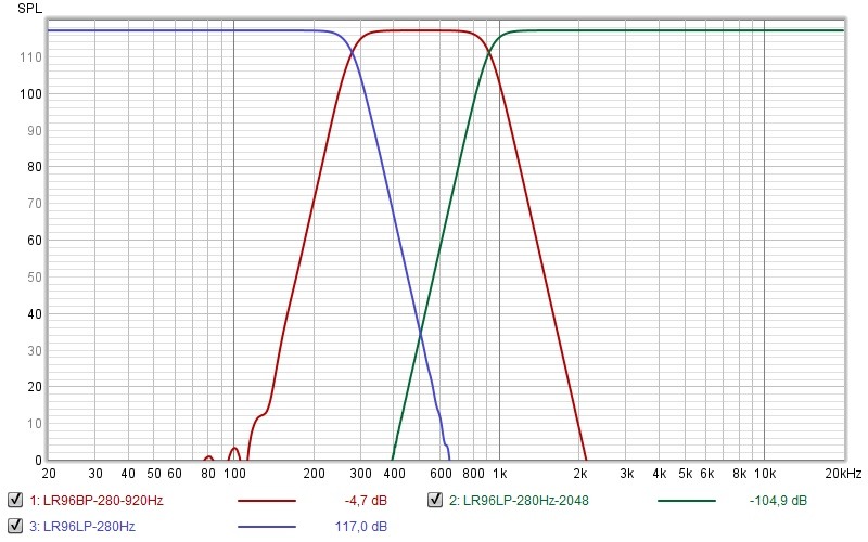

I plan to move to FIR processing using CamillaDSP as the engine. I am trying to learn how to implement linear phase crossovers first. This is 96 dB/oct LR filter IRs generated by rePhase and imported to REW. So now I only need to get these files to CamillaDSP (in correct configuration, I made already crossovers there with biquads) and I should be set. Is that correct?
Is there any rule on how many taps to select? Like having a nice number (512, 2048, etc.) or should I just keep it as low as possible to get the desired target?

FIR filters always ring by definition, there are ways around it, but it will introduce other compromises.
The higher the slope, the worse it gets.
If that's acceptable, I don't know totally depends on the situation or what one find still acceptable.
I was just warning about the fact that you will make it yourself very difficult without gaining much advantages at all.

1) Lower frequencies require more taps than higher frequencies to preserve the shape of steep XOs. This can been seen by adding steep high and low pass filters around sub frequencies, selecting generate and then view the resulting plot window. The target and calculated traces won't match if the number of taps are too small for the chosen filter/tap/sample rate combination. The low frequency side will be more off than the high frequency side. The same filter slope higher in frequency will show fewer taps are required to handle those frequencies. Keep this in mind when selecting the number of taps for your filter, XO points, slopes and sampling rate.I plan to move to FIR processing using CamillaDSP as the engine. I am trying to learn how to implement linear phase crossovers first. This is 96 dB/oct LR filter IRs generated by rePhase and imported to REW. So now I only need to get these files to CamillaDSP (in correct configuration, I made already crossovers there with biquads) and I should be set. Is that correct?
2) The required number of taps doubles with sampling frequency. Example: 64K taps (65536) at 44.1kHz is equivalent to 256K (262144) at 176.4kHz with respect to processing resolution and delays.
3) Don't mix and match the # of taps with different sample rates in CamillaDSP. Pick a playback sample rate and match the number of taps accordingly, else the XOs will change with sampling rates. CamillaDSP does its magic at the playback sample rate so match your filters accordingly.
You can load your XO's into REW and use REW's "trace arithmetic" to add all of them into single FIR to simulate how they sum as a system (read: see if they sum flat or form a null or peak). You need to use the "trace arithmetic" BEFORE applying any smoothing or windowing to the loaded XOs, else they won't sum properly in REW.
Also be aware that the visual shape of the XOs in REW will change with the current "smoothness" and/or FDW setting. Using 1/3rd octave smoothing will change the perceived slopes of the XOs compared to "no smoothing".
As for length, the bottom of RePhase's helpful processing window displays the delays in number of samples and ms units. The longer the delay, the more video/audio lipsync will be out and the longer it will take for tracks to start after pressing play. Example: 256K taps @ 176.4kHz and 64K taps @ 44.1kHz are both 743.xxx ms or just over half a second delay.

Thanks! I want to replace the biquad processing with FIR. I do not understand point 3 fully. I will playback at 44.1 kHz only. Can the three filters have different number of taps or all need to have the same amount? I would start at the low frequency part and use the same number of taps for the higher frequencies - or does it not matter? Also, can I have some arbitrary number of taps like 1234 if the calculated response matches the target to my satisfaction? I tried adding the traces in REW and get only a fraction of a dB wiggle.

If you use different numbers of taps @ 44.1kHz, you will have different delays between the drivers. Different delays cause different phase shifts so the XO region phases will be off and sum incorrectly causing peaks and nulls for otherwise well designed XOs. If you take this into account and add artificial delays to realign the drivers, you can get by with it. CamillaDSP is very efficient. I would suggest using the same number of taps and save yourself some headaches unless you have reason and are confident to do otherwise.Thanks! I want to replace the biquad processing with FIR. I do not understand point 3 fully. I will playback at 44.1 kHz only. Can the three filters have different number of taps or all need to have the same amount?
That is the plan. The lower frequencies define the lion's share of the work.I would start at the low frequency part and use the same number of taps for the higher frequencies - or does it not matter?
It is not only SPL amplitude, it is also phase. Also important when doing speaker corrections. Many people initially look at SPL while ignoring the importance of phase.Also, can I have some arbitrary number of taps like 1234 if the calculated response matches the target to my satisfaction? I tried adding the traces in REW and get only a fraction of a dB wiggle.
You should stick to multiples of 2 for processing purposes. Many of the playback-time (and filter generation) FFT algorithms are faster/more efficient with filters that are powers of 2.
Perfect! Thanks a lot once more. The summed phase was perfectly flat (or looked like that on normal zoom level). Emailtim, I am pretty sure your advice saved me a lot of headache.
Another thing to remember, REW's smoothing and FDW settings will alter/mask ones perception of the XO. When analyzing synthetic FIRS (i.e. not actual measured sweeps with hash), I use no smoothing and no FDWs to get a more representative impression.... I tried adding the traces in REW and get only a fraction of a dB wiggle.
