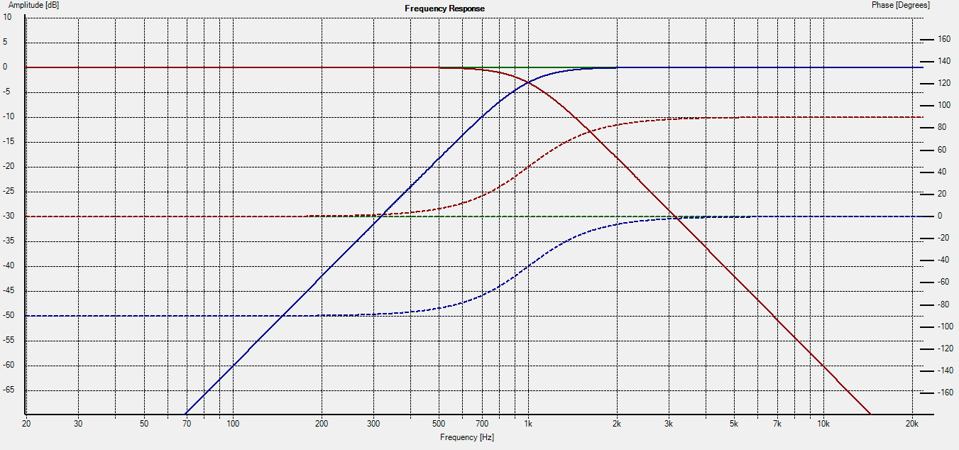

And here is an illustration of the crossover, with the sum in green

A 1st order crossover does not need any phase linarization as it is already phase linear ;)
It is pretty much impractical for any real world application though.

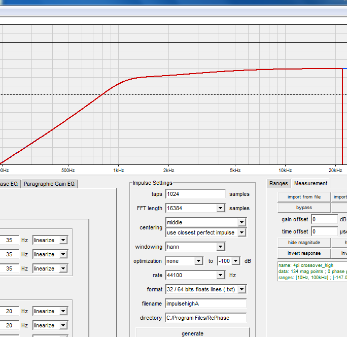

Aaahhhh now I see !!! Yes I can replicate that and do it with 1024 taps no problemo!

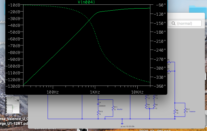

Hi everyone, I'm attempting to emulate a passive crossover circuit in my Minidsp, its a two way design but has a response that is not as simple as crossover point and slope.
I've generated a filter slope by modeling the circuit in LT Spice, here is the tweeter:
Spice will export a text file that after a bit of reformatting I can import as a measurement into Rephase:
When I hit the generate button I get the red curve - my assumption is I can then export this as a filter file but the file I get is the same regardless of which curve I've imported (woofer or tweeter). Guessing the filter it makes can only be from the the settings within rephase? I looked around a bit but didn't find a clear answer, so apologies in advance if I'm missing some basic information. I've been messing around with audio stuff for a while but the dsp and filter stuff is deep and I'm very new to it.
Thanks!
The measurement loaded in rephase is only a guide upon which you are supposed to build a correction, and generate its FIR. If you simply load a measurement and generate a FIR then you get a flat transfer function and no correction at all.
Here you have generated the response you want to emulate, and not a measurement you want to compensate, so in order to build a correction that corresponds to this response you will need to use the "invert response" functionality, and then use whatever filter and EQs needed to get a flat curve. You can then do a sanity check using the bypass button in the measurement tab.
In your case you want to stick with minimum-phase filters and EQs only.
In the end depending on the complexity of the correction, you might even just take note of the different filters used and simply set them in your minidsp, without having to use its FIR capabilities at all.
Looking at the response you are trying to replicates it looks like a 4th order high pass and a shelving could be enough.
