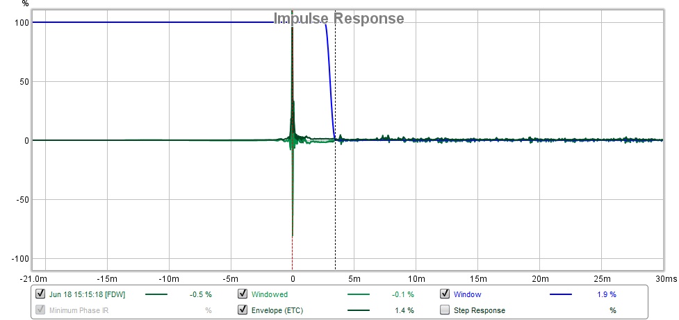

In regards to gate time I set it to 3.5ms due to my room beeing quite small. If I have understood things correctly that will yield acuracy down to about 285Hz. Attached pic of IR from that measurement from my last post

You won't get accuracy at 285Hz with a 3.5ms gate. That is considered to be the minimum frequency for the data to be in any way valid but the problem is the smoothing effect it has on the response.
At 285 Hz it is like having 1/1 octave smoothing being applied with the smoothing getting less as frequency rises until you get to a point where there is virtually no difference.

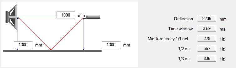

Vituix's calculator can show the frequencies of different effects based on the reflection time

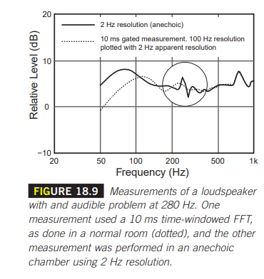

Here is a comparison from Floyd Toole's second edition book showing an anechoic vs 10ms gate. You can see that at 500Hz it is virtually the same but below that it is not that accurate. At 3.5ms the same effect will occur higher in frequency.

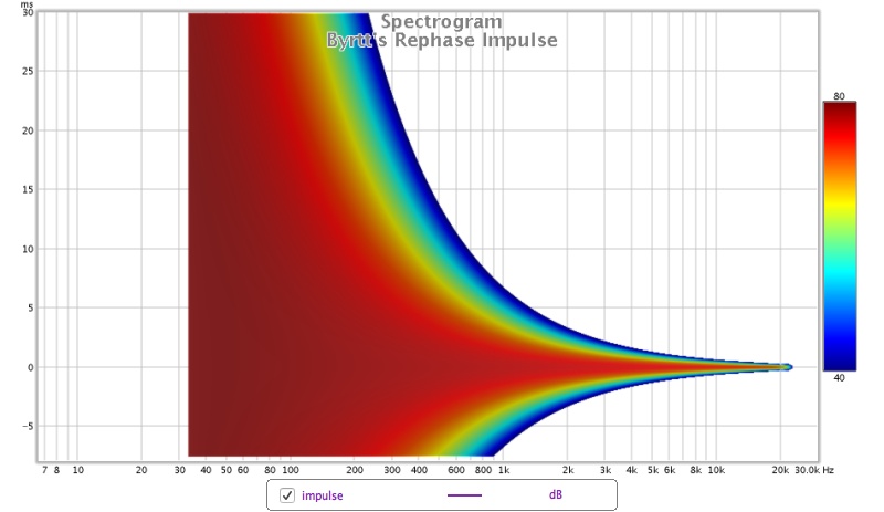

Here's an old image showing the idea, it is a time vs frequency graph that makes it easy to see where in time the frequencies are happening. This is a rephase generated Dirac Pulse.

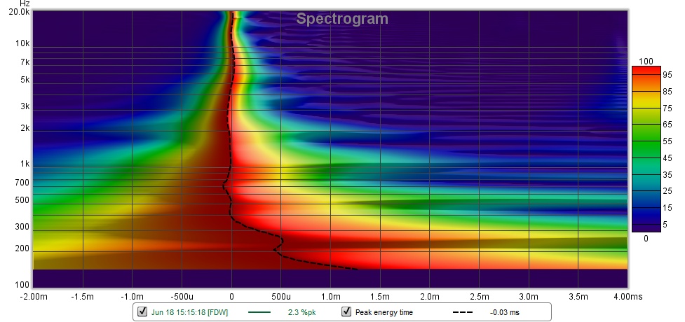

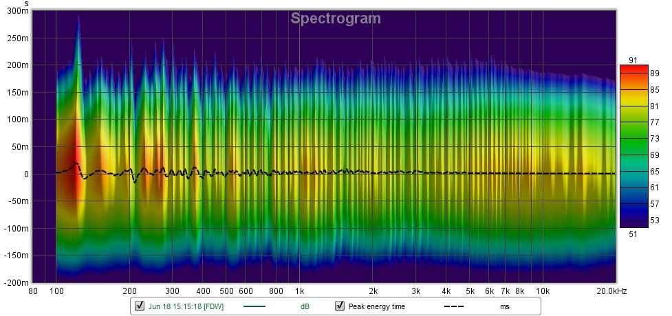

You are correct, I was thinking about polar plots. I think I understand the spectrogram example you posted and tried generating one from my measurement, not sure what to make of it though...

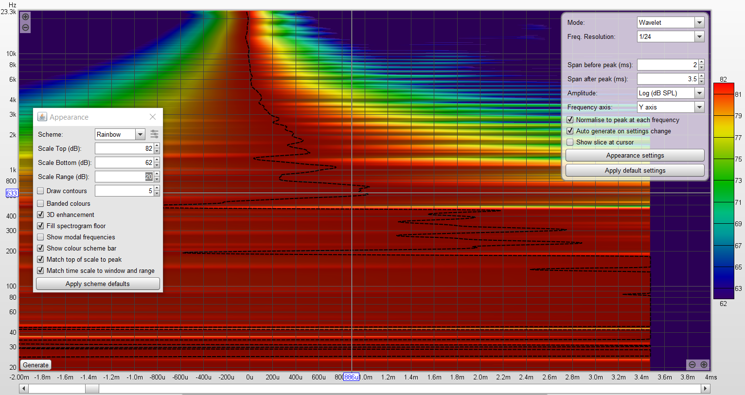

As for the spectrogram you have to change the settings to get anything useful and some of them will depend on the signal level etc.
I have attached a screenshot below that might help get you something more useful.

The dotted black line should be straight at 0 but you have some swings either way possibly the result to using phase EQ. An ideal minimum phase speaker response would be straight with a bend to the right at the low frequency roll off point.
Yes stereo will just put the same filter in both channels mono would be be for separate channel filters.
It has nothing to do with latency. If you use phase EQ that can add pre-ringing to the impulse response which will show up on the left side of that graph. The dotted line is the peak energy curve and shows that at some points the peak energy is ahead of the main impulse peak time.
The problem with equalizing phase to a flat line is it doesn't help you to understand where that phase came from or whether you should try and change it.
In a speaker with linear phase crossover filters there should really be no need to use phase EQ.

It looks like the phase has been corrected for the direct sound plus it's reflections.

I would think you are correct since my measurement wich EQ is based on is not very accurate and more than likely contain more than just direct sound
