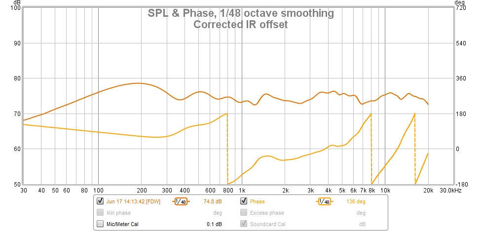

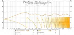

Early stage venture into active FIR crossover
Hi all
I'm trying to learn this active FIR crossover stuff and was hoping I could ask for some advice. Today I took some measurements of drivers, imported those into rephase and did some amplitude EQ, phase EQ and set up some steep LR filters. After generating the IR I imported those back into REW to simulate the result. After some tweaking I loaded the IR files into EQAPO and remeasured speakers.

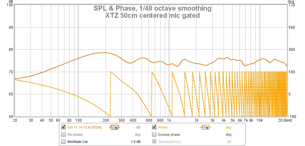

I was reasonably happy with the FR but the phase plot seems like a mess to me. Is there anything obvious I'm messing up here you think?
My setup :
Laptop running EQAPO, REW for measurments with UMIK-1 and rephase to design filters.
HDMI to 7.1 reciever Yamaha RX-V1700 feeding two XTZ 93.23 mkII with crossovers removed.
Hi all
My setup :

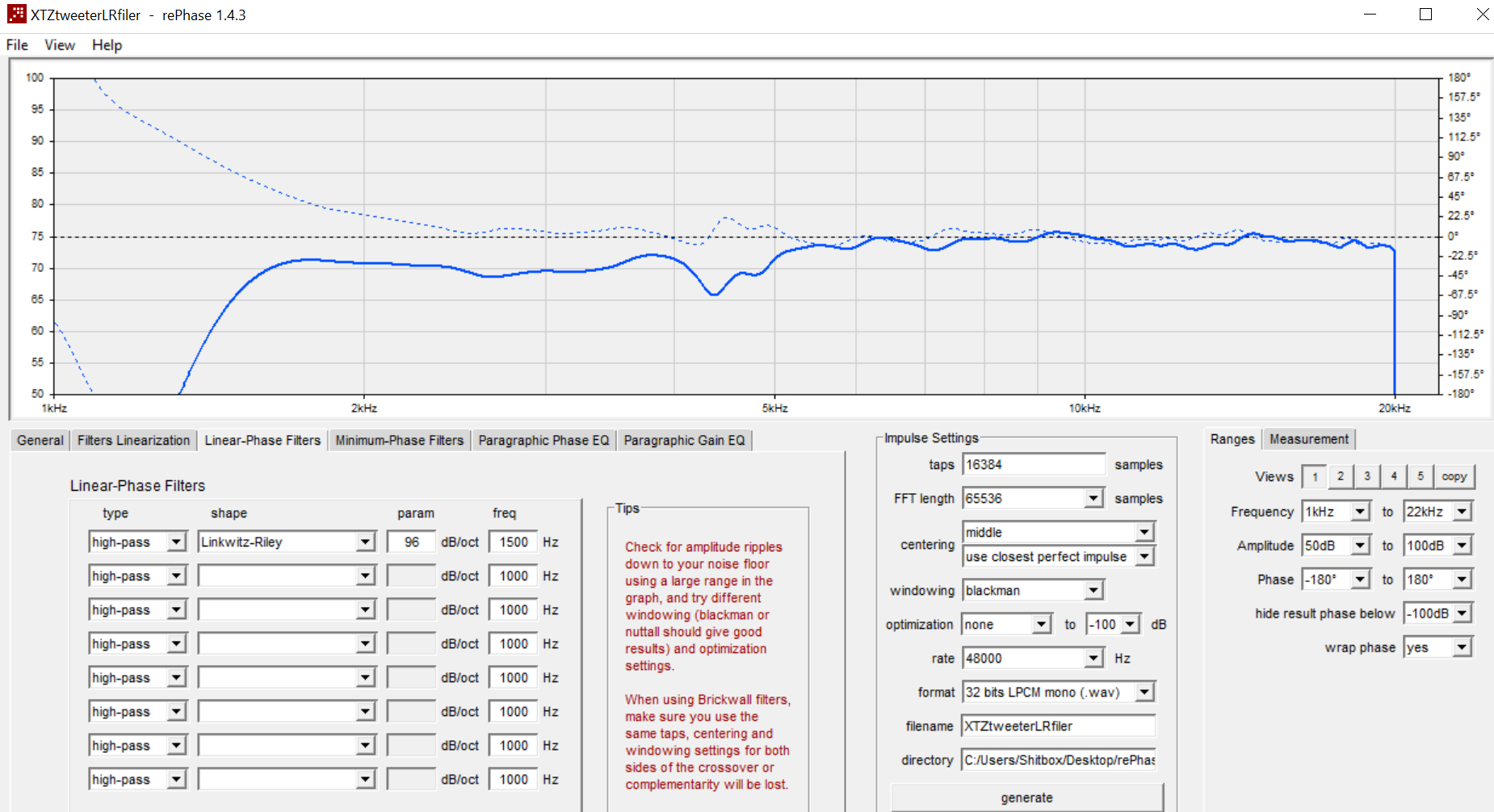

Hi, phase looks pretty good really...certainly so in comparison to using minimum phase xovers.
And if you notice, the phase wobbles occur in coincidence with the frequency response wobbles.
Use the Paragraphic Gain EQ Tab to smooth out the frequency response, and watch how phase smooths itself out too.

Thanks for your response.
I guess you are mainly talking about the rephase picture with my filter settings? I have done what you suggest to some extent, but I don't concider myself done
I was mostly wondering about the REW measurement, where FR is reasonable smooth but phase seems to wrap endlessly - wich I don't understand why the measured phase do not resemble the phase plot in rephase, at least to some extent. I thought this was the effect of linear phase filters
My gut says I'm missing something pretty obvious here in regards to my measurement

Gotcha.

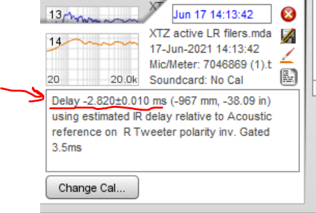

In REW, it's just a matter of getting rid of the constant delay, time-of-flight, etc, from the measurement.
I use loopback timing to do this, which makes life easy.
Not exactly sure how Umik works.
But i'll suggest:
1. go to the Impulse tab, and click on 'Set t=0 at IR start'
2 go back to SPL & Phase and see how phase looks....should be much better, other than maybe VHF tail
3. still in SPL & Phase, open Controls, and click on 'Offset t=0'
4. move slider around a little till it matches rePhase, looks right, etc.

By loopback you mean for timing reference of your measurements?
I also have a Behringer emc 8000 and a external soundcard but I havent gotten far enough to try it out yet. I thought the UMIK would suffice. I have been using acoustic timing reference though, and thought that would work about as well as loopback.
This is about as good I could get it. I took the delay data from measurement and added to offset, that put the peak of IR at t=0, but is this method of measurement not acurate? Or what I'm struggling to understand is why does this happen to the phase plot now, but I havent seen this in other measurements of drivers.

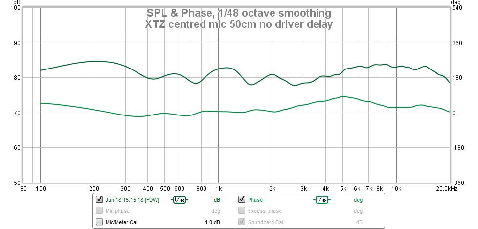

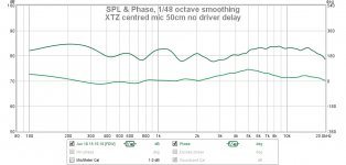

I had a some other measurements after several tweaks in rephase, and I see all of the phase plots in REW resembles the plot in rephase, if I use the measured delay as offset. Only my last measurement (the one I posted) would turn out with phase wraps. Then it dawned on me - one thing I did was add delay on the tweeters in EQAPO to time align the drivers. I would guess this is what causes the mismatch of phase in rephase vs. REW plots
So I guess my next thoughts are; how do I go from here to tweak the phase of my whole system/speaker including delayed drivers? I'm not entirely sure how to go about this task since I have made one IR wav file for each driver. Do I make one correction file on top of these, or is it possible to implement the corrections to each individual files?
Against loopback timing, all that is needed to get phase right, is first measure with 0.0ms 'Timing offset'. Then, put whatever Delay is shown in that 0.0ms measurement tab into 'Timing offset' and remeasure. It's that simple, with loopback.
Again, don't know how Umik, or acoustic timing reference works.
REW can have a truly bewildering array of timing options.
What i do on a multiway (using loopback), is with mic in same position, find each drivers' delay vs loopback.
That tells you which driver, the one with the greatest delay vs loopback, is the one the other drivers need to be delayed to.
And for the other drivers, by how much each of them needs to delay to match the longest.
Put the delay of the longest driver into "Timing offset'.
And add into the processor, each of the drivers' delays that are needed to match to longest.
All should be well. If not, measure each passband with delays in place and balance accordingly.
(If done right, delays should be within samples of being correct. If not, boo-boo has been made somewhere.)
Just remember, delays have to be set relative to longest measured.
Did you notice the frequency of the graph goes from 1k to 20k and the gain in phase at the bottom is below the crossover point?Hi, phase looks pretty good really...certainly so in comparison to using minimum phase xovers.
The phase in this graph looks strange to me. There is still a hinge point at the crossover frequency but you are losing phase below it and gaining phase above when it is usually the other way around.This is about as good I could get it. I took the delay data from measurement and added to offset, that put the peak of IR at t=0, but is this method of measurement not acurate? Or what I'm struggling to understand is why does this happen to the phase plot now, but I havent seen this in other measurements of drivers.
The main areas of excess phase from a speaker will come from minimum phase crossovers. If you make them linear and complementary then pretty much all of the excess phase should be gone. It should be quite close to the calculated minimum phase once you remove the time of flight delay like you have now and there should be no real need for the paragraphic phase EQ.
I think this was because I kept lowering the XO point on the tweeter filter and entered into where my protection cap starts to work. If I understand correctly what you say about minimum phase filters this would do weird things to my phase. I also tried reversing tweeter polarity because there was a consistent big dip at XO point. This resulted in ok summation in FR but then phase got a lot worse. Add to that the delay on the tweeter I was messing with in EQAPO, I'm sure I just made a mess of several things.
Sorry for needing to be spoon-fed, but I'm not sure what the complementary thing means in rephase.The main areas of excess phase from a speaker will come from minimum phase crossovers. If you make them linear and complementary then pretty much all of the excess phase should be gone.
I tried this and still was having a hard time until I just deactivated the delay on the tweeter. Result was much better - see attached measurement. This is as far as I got before family duties called.I wonder if perhaps your acoustic crossover slopes don't match your electrical slopes. If the drivers are equalized flat for a little distance either side before the 96 dB crossover is added then they should end up being the same.
As per now this is presicely what I feel happened, only opposite😕😀 I can't wrap my head around how I can add delay to one of two drivers that sums in phase without messing up the phase coherencyIn a properly constructed active speaker the time delays can compensate for most of the drivers distance offset and the EQ and crossover components should result in speaker that does not really need much more tuning than it already has as the overall slope and tonal balance can be set in.
Nope, i was blind as a bat ! thx 🙂
