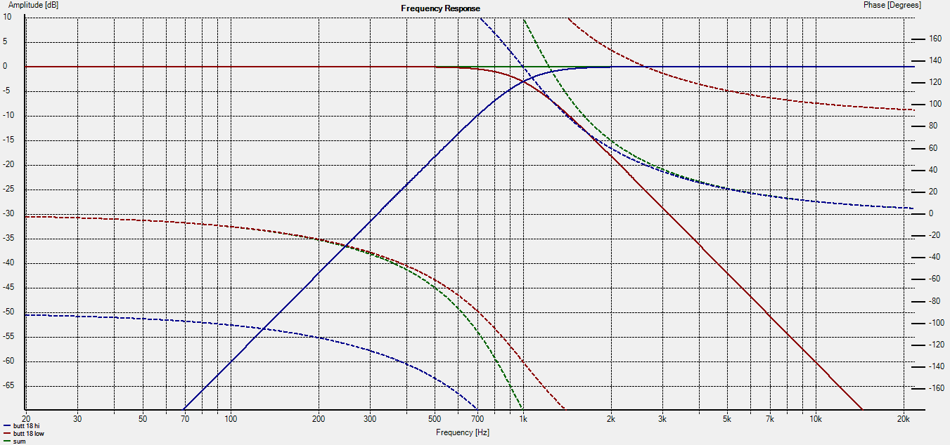

Here is an illustration with a pair of 18dB/oct Butts (3rd order) at 1kHz.
You can see the phase traces are 90° apart throughout, both filters are at -3dB at 1kHz, and the sum is a 2nd order all pass.
It is the exact same summed response as a LR 24dB/oct, and can be linearized as such.
If you want to try this you have to remember that this only works with odd order Butts! Using even order Butts will give you a +3dB boost at the crossover point as both filters are in phase.
Now regarding the potential advantages of these type of crossovers, you get a flat on-axis response (like a LR), a flat power response (unlike a LR that has a -3dB hole), but you also get a +3dB lobe somewhere off-axis (unlike LR). So this is a design choice...

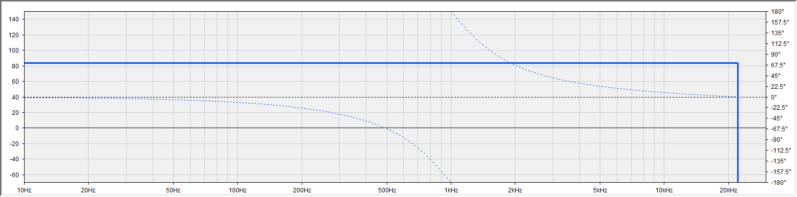

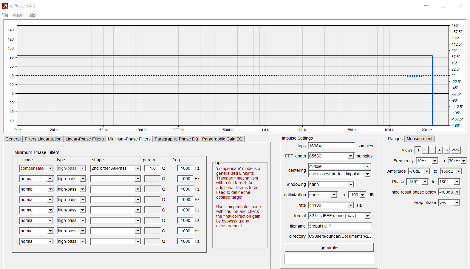

Here is an example of a 3rd order Butterworth crossover created with rephase and combined in REW. The alignment of the impulse had me scratching my head for a while as using estimated IR delay did not work.
To linearize this I used a 2nd order all pass with a Q of 1.0 in compensate images below due to size. I found linearizing with an LR4 wasn't quite right as it is the same as a Q 0.707 2nd order all pass which still left some phase variation.

Yes you are correct the Q is 1, not 0.707 like a LR would be :ashamed:
Regarding impulse alignment, when I import a FIR in HOLM I usually directly use the offset value shown by rephase, but of course when dealing with a real world measurement you have to adjust manually, looking for that asymptotic phase value up high...
When centering is exact you get a perfect 2nd order allpass-pass (Q=1!) when summing, which in turn turns into a perfect linear phase when compensated for.

If using a MiniDSP the Butterworth IIR filters are available as presets or if not they can be created directly in rephase under the minimum phase tab. The filter needed to linearize can also be created in rephase (Compensate 2nd order All Pass Q 1.0) as I showed before. How much simpler could it be?
