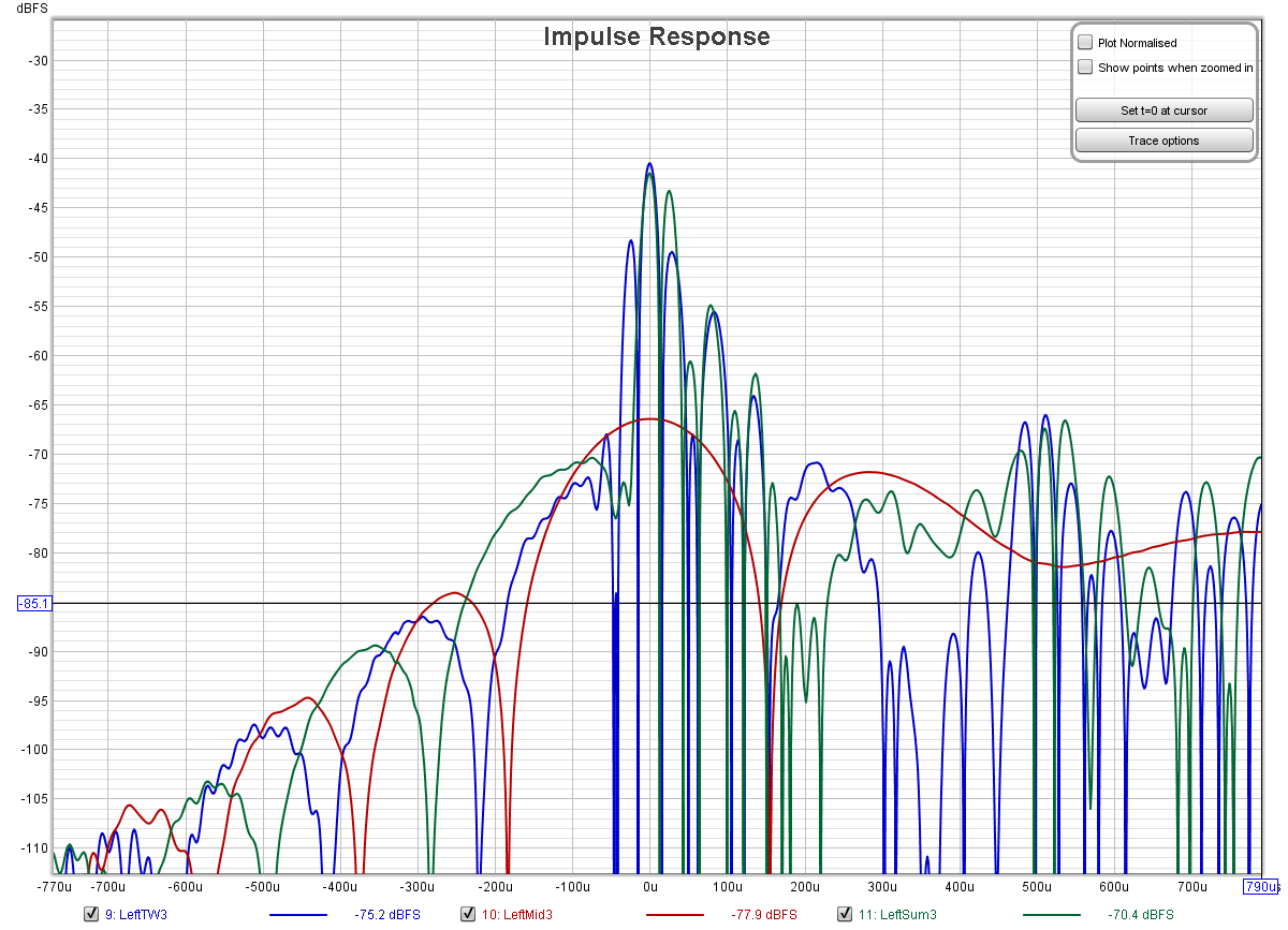

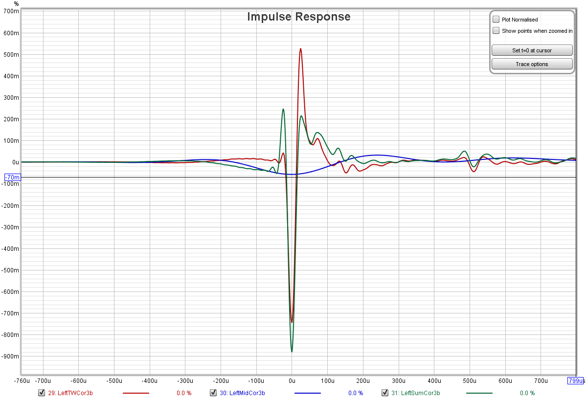

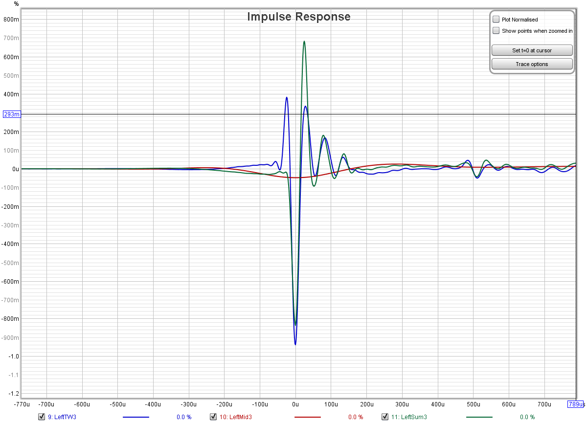

I made real life measurements from listening position with real speakers. Filters where linear phase LR48 at 2700 kHz for Hing pass and low pass, no other filters, just speaker elements as they are, only acoustical radiation center displacement compensation delay and level compensation (not in rePhase FIR filter) where involved.
I see nearly no ringing cancellation at all. Impulses are not normalized to get all in same scale.
Yes I know ringing here is very short and not audible, but to avoid room influence I not made measurements with bass and mid speakers, there will be 10 times longer ringing.

POS's advice in #3317 has always worked best for me.
That being, to disregard the impulse response and work with the frequency response.
When both mag and phase are flat, the impulse response will be spot on.
And just becomes another form of conformation of good tuning.
It's sooooo much easier to discern what to correct, working with frequency response (again, mag and phase)
Your crossover does not look to sum correctly. Generate a textbook version of the slope you want to achieve and compare it against the measured one. Add EQ until you get a closer match which should result in a good sum then you can see if it worked better.
A good way to get this is to use a compensate of the target filter, apply whatever correction is needed to get a flat response, and remove the compensate filter.

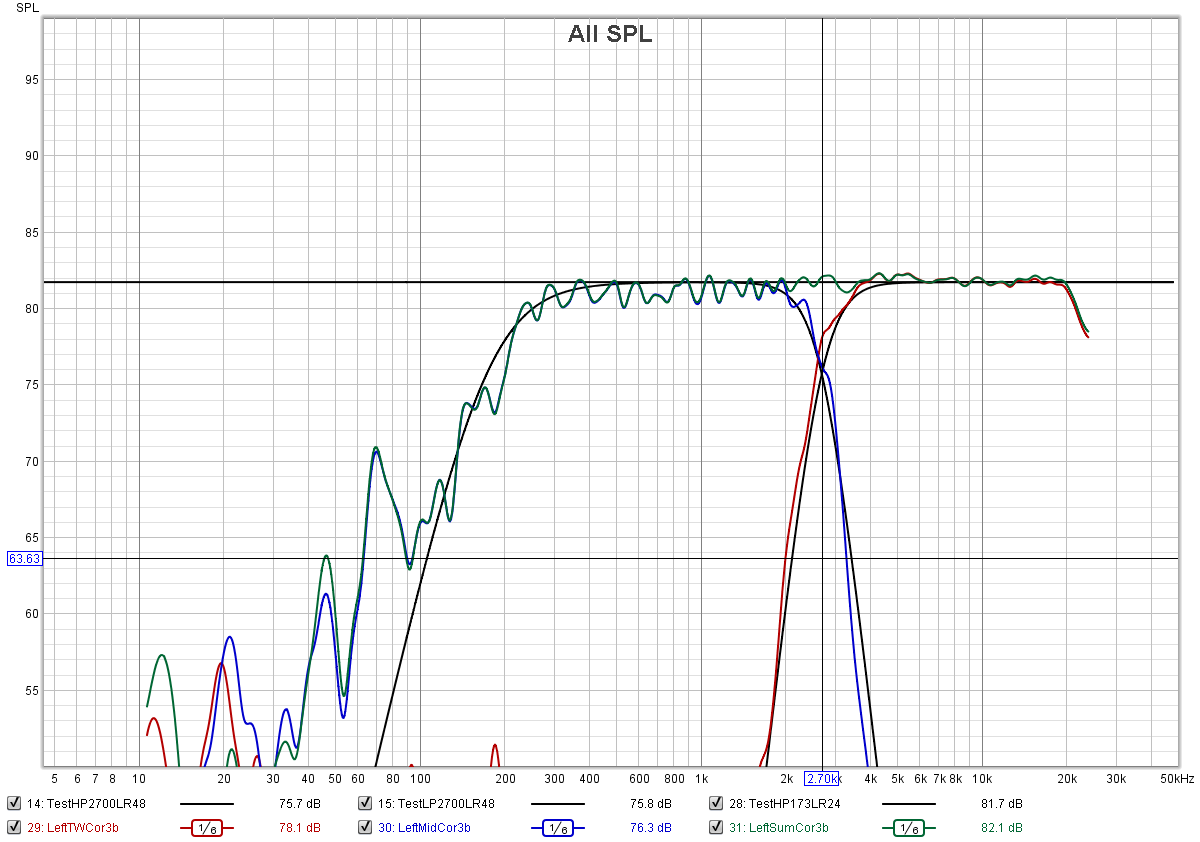

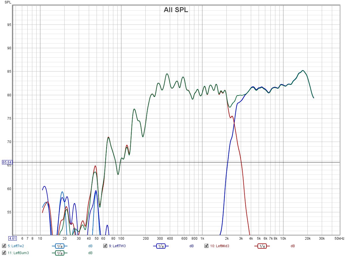

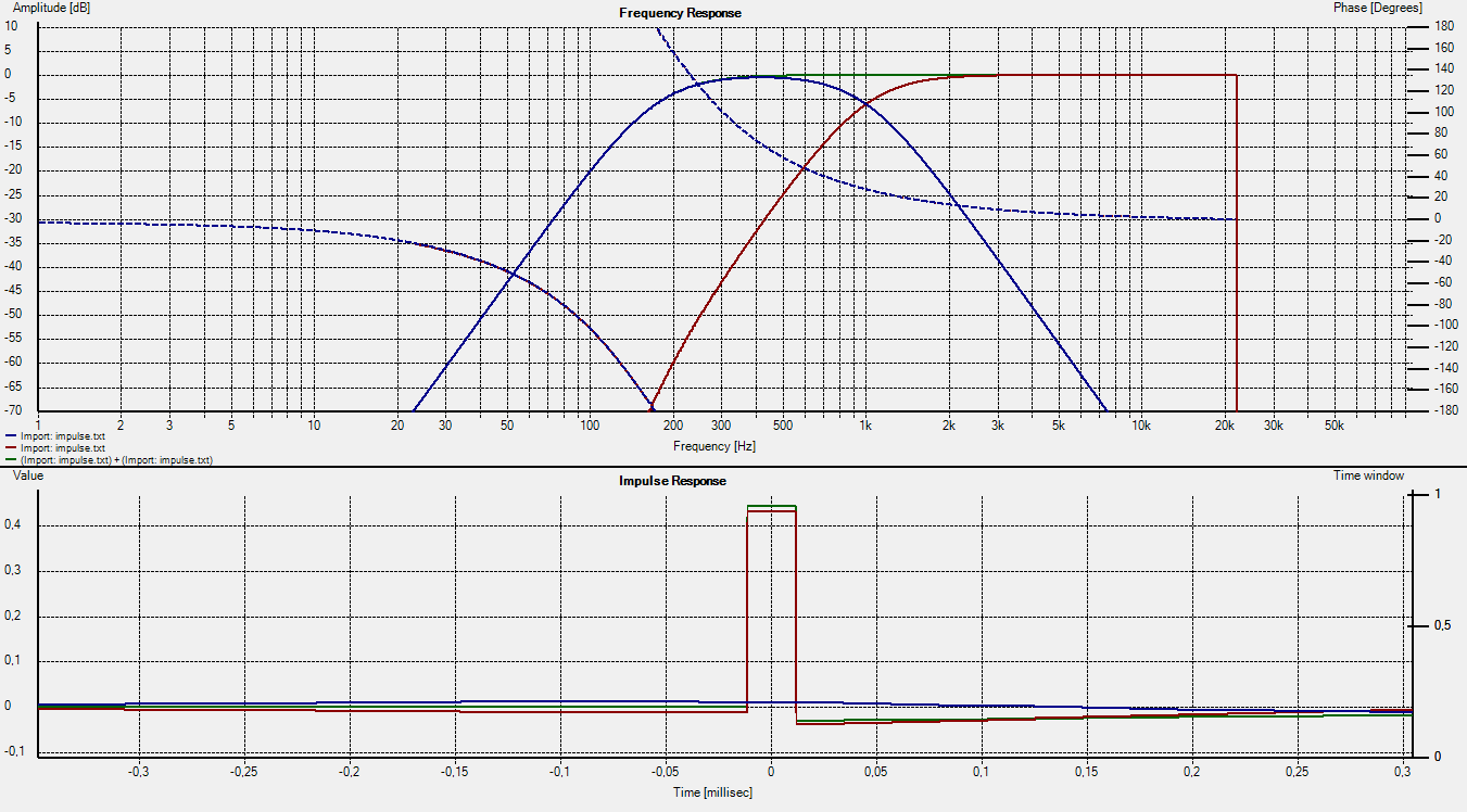

I made corrections to fit slopes better, I include to tweeter HP LR24 on 173 Hz what is approximate mid range HP natural acoustic filter, but not get any real ringing cancellation. I get less post ringing with compensations, but no pre ringing cancellation.
On FR image with black are displayed FR of filters without EQ compensations made with rePhase.

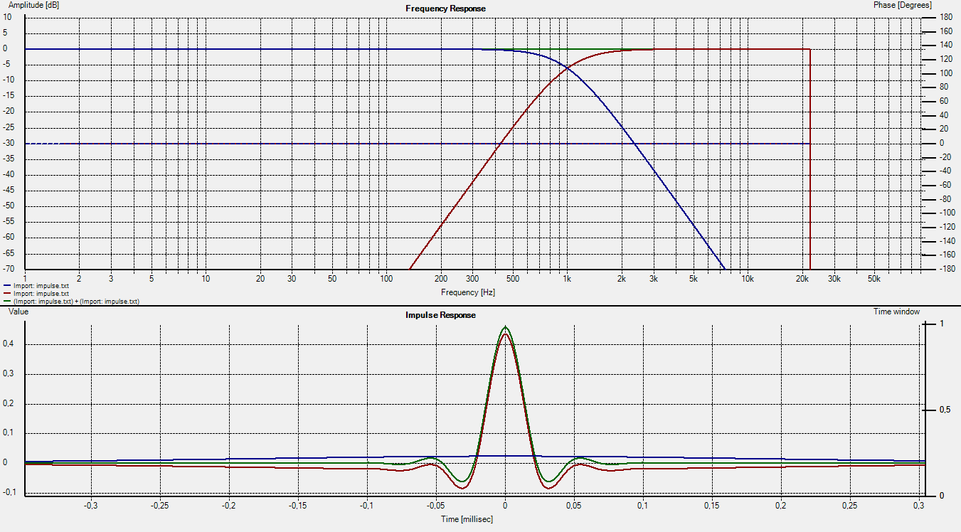

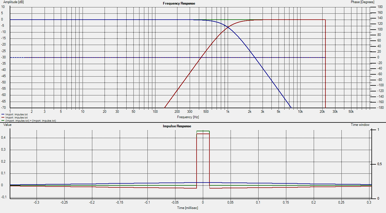

You might be mistaken at what to look for here.
To see what IR target you should obtain you can try generating some textbook responses in rephase and see what the impulses look like.
One with that 173Hz hi pass and 1kHz low pass, and a second one with the 1kHz+173Hz hi pass.
Summing the two in REW should give you the same impulse as a 173Hz hi pass with no 1kHz low pass.
You might also want to include the 20kHz+ low pass as it might get you some visible (yet inaudible) ringing.

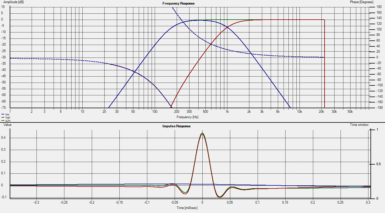

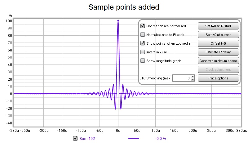

Turning the interpolation off in Holm is a good way of showing what is happening. I was trying to do the same thing myself in REW but if that function exists I haven't found it. What you can do is display sample points to see where the data is which looks like this
attachment.php

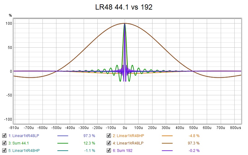

Here is an overlay of the difference between Linear Phase LR48 at 1k made at 44.1 and 192K. You can see the difference in the look of the impulse that the ringing displayed through the interpolation has changed and that the peak is narrower from the increased bandwidth and closer sample points. So I think how the impulse is displayed has a lot to do how much "ringing" there seems to be even though the samples underneath are the same.
attachment.php

I made ringing cancellation test with cookbook complimentary filters in software already before my measurements. With theoretical cookbook complimentary filters ringing cancellation is present, no doubt.
My point is that in real life, with real speakers and room, it is nearly impossible to get this ringing cancellation even if real speaker element resulting filters are compensated to be very close to cookbook filter slopes.
For example in my case I had MTM type midrange-tweeter section, midrange is OB on triangular baffle, what in my opinion make mids not very minimal phase type. I had no identical amplifiers feeding the mids and tweeters, amplifies had different LP and HP cutting points. Also my tweeter is ribbon type with transformer and DC blocking capacitor with Fc about 1300 Hz. This all brings more different IR in series what all disturb ringing cancellation.
With my speakers I find also that audible ringing is much bigger in stereo than with left or right speaker alone. Probably in stereo is possible also ringing amplification of summary response from left and right.
Any response variation (delay, filter, etc.) caused by any element in the chain (DAC, amplifier, box, driver, etc.) absolutely needs to be taken into account and compensated for when building the correction.
Now if you find you cannot compensate for some aberrations, or your compensations do not hold throughout the listening window, then it is either a measurement or a design problem.
It has been my experience that with a proper design and proper measurements (emphasis on the "s") it is surprisingly easy to get close to textbook responses over the intended frequency range.
Proper design includes good directivity matching and small enough distance between drivers, drivers showing low breakup or resonance behavior, decent diffraction/reflection handling, etc.
Not sure I exactly get what you mean, but looking at the frequency response and the impulse give you the same information. You can disregard the impulse in most cases, the frequency response being much more revealing and less confusing: simply try to get matching/tracking phase shift between drivers, and ignore the impulse altogether.
If you (virtually) get each driver's phase and magnitude flat in and around the passband (using compensate filters), and add linear-phase complementary filters, then summation is as easy as dialing the proper delay.

As a side note, minimum-phase and linear-phase filters do have the exact same amount of ringing for a given slope, the only difference is how that energy is spread around the peak. As such, minimum-phase filters post-ringing also cancels out when properly summed in a crossover.

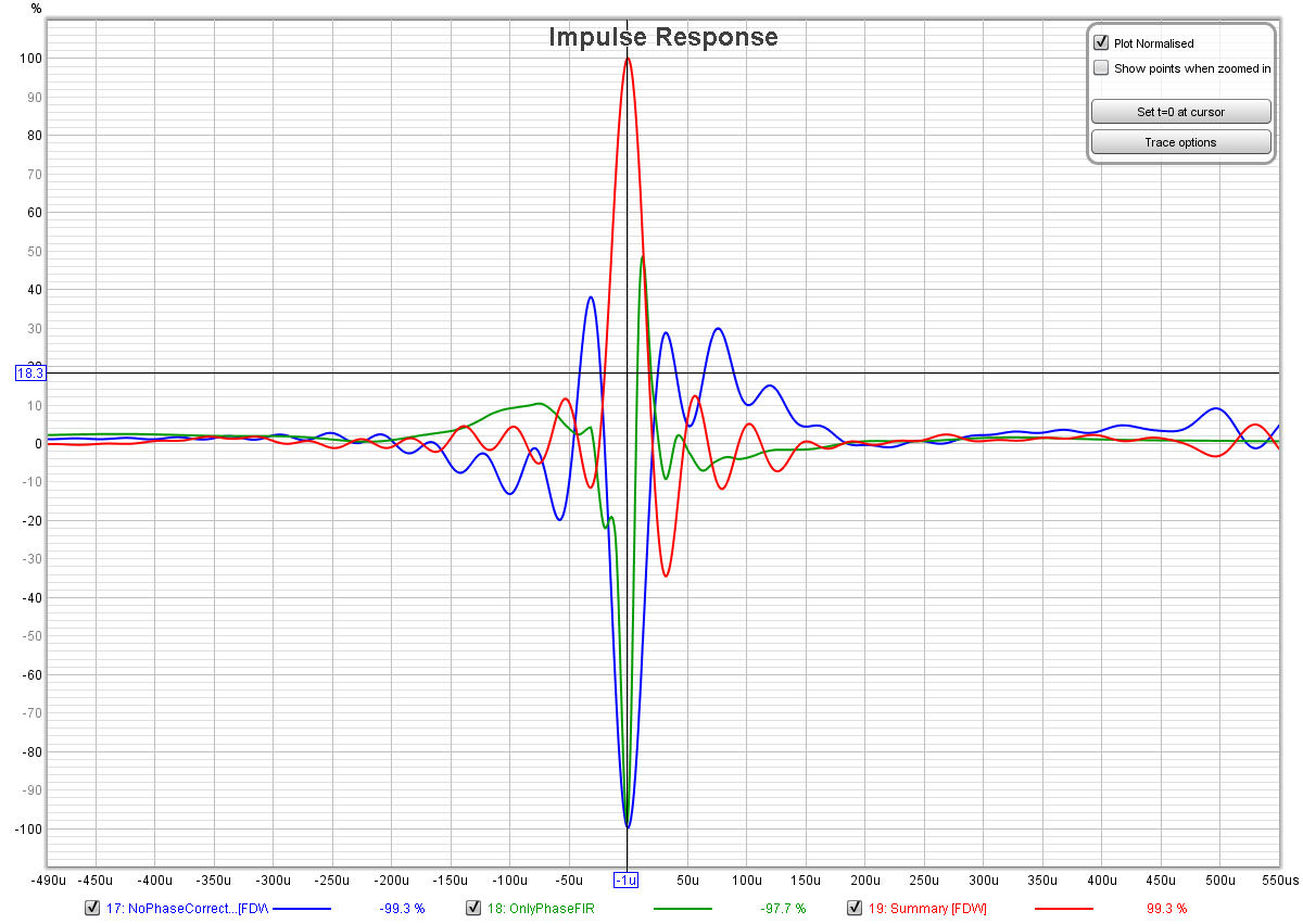

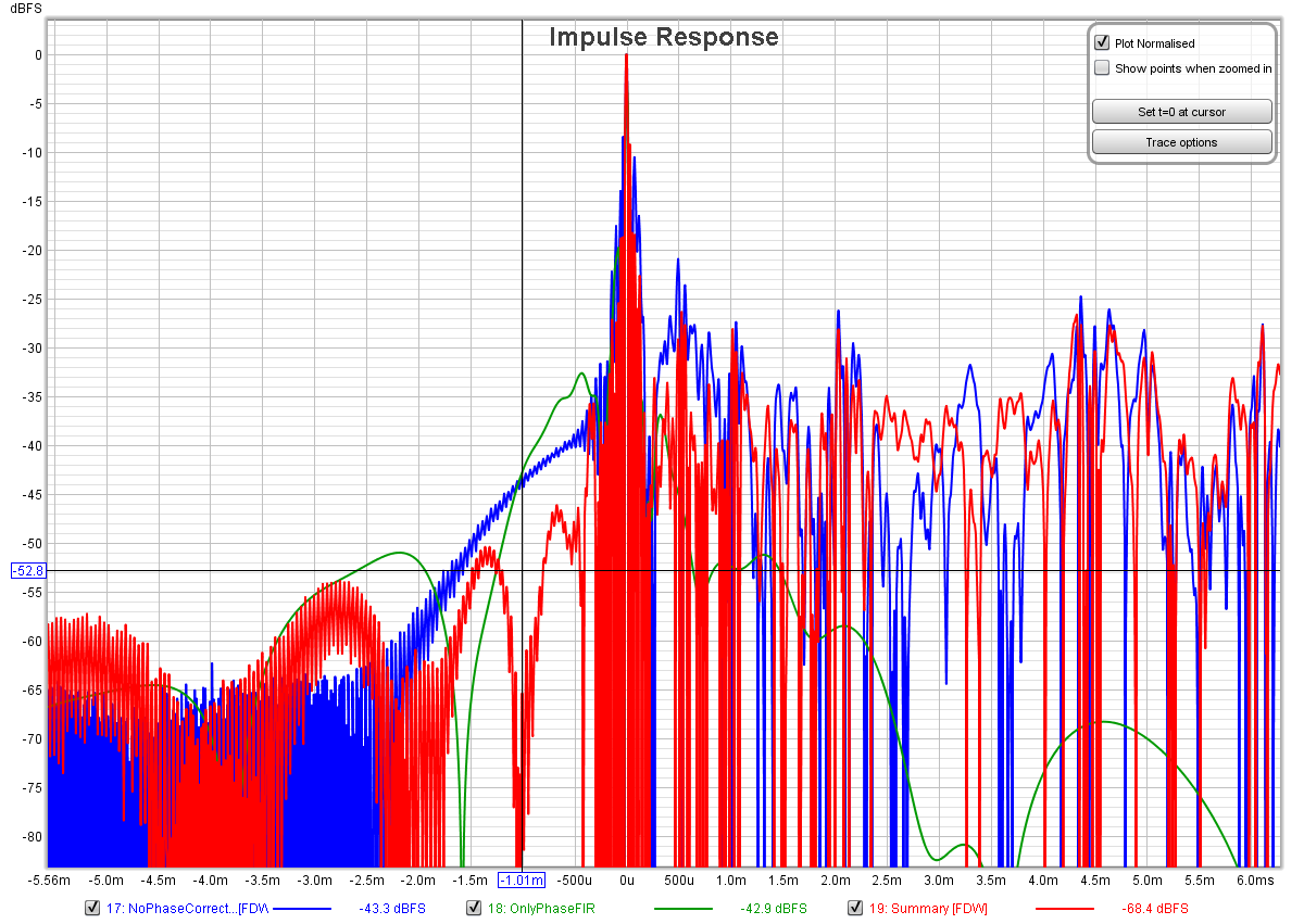

I find that if in clean flat filter I make phase tuning based on measured phase response, resulting IR have opposite pre and post ringing with system IR for what I made phase tuning, so somthing like ringing canceling is happening.
Is this just coincident or there is existing some mathematical background what make this kind of ringing canceling possible?
This is real IR measurements from my speaker with no phase tuned FR, phase tuning filter IR from reFhase FIR and measured summary when phase tuning FIR filter is applied. I see good ringing cancelling here.
