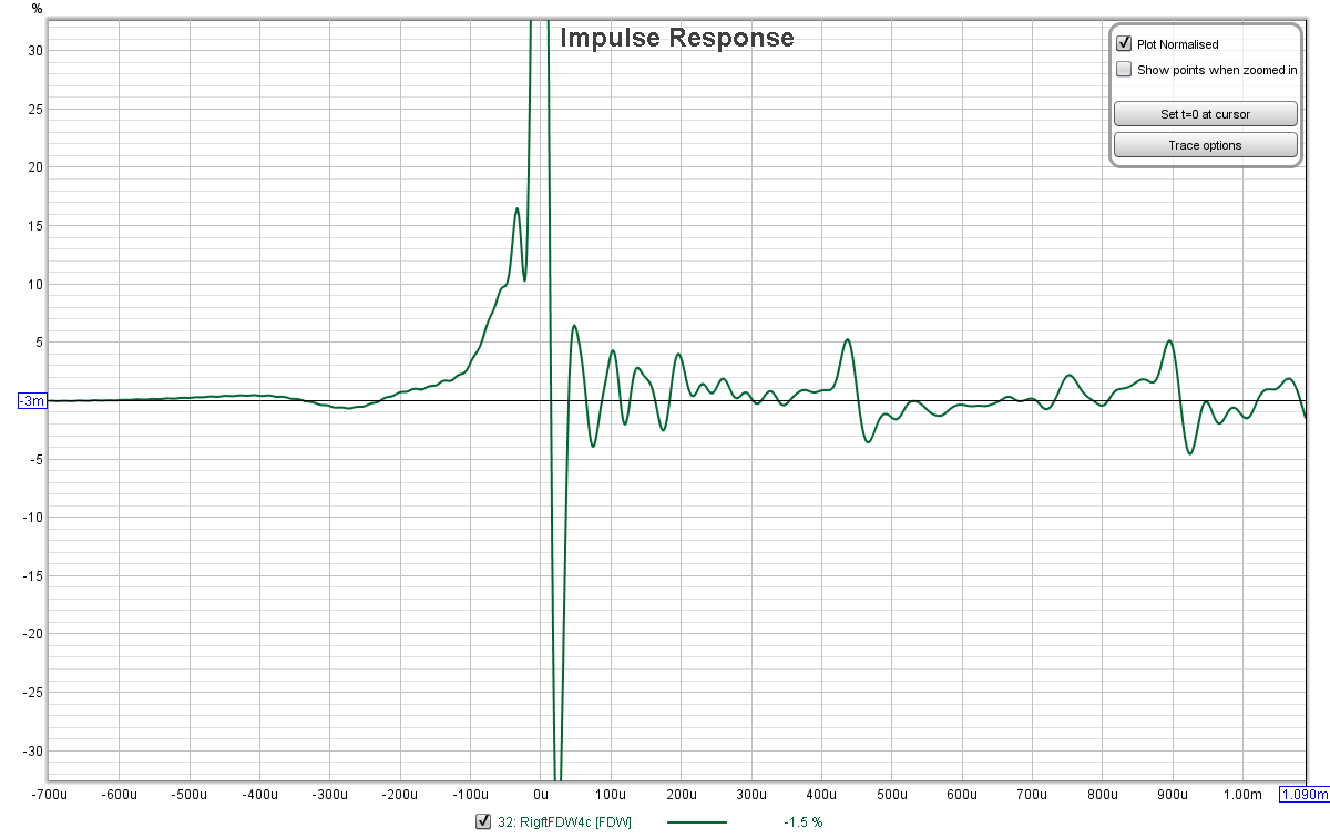

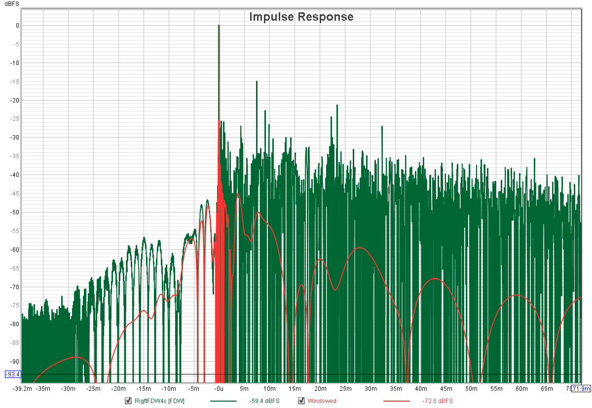

Can anybody tell how long and how big (by amplitude) pre-ringing caused by FIR filter can be heard?

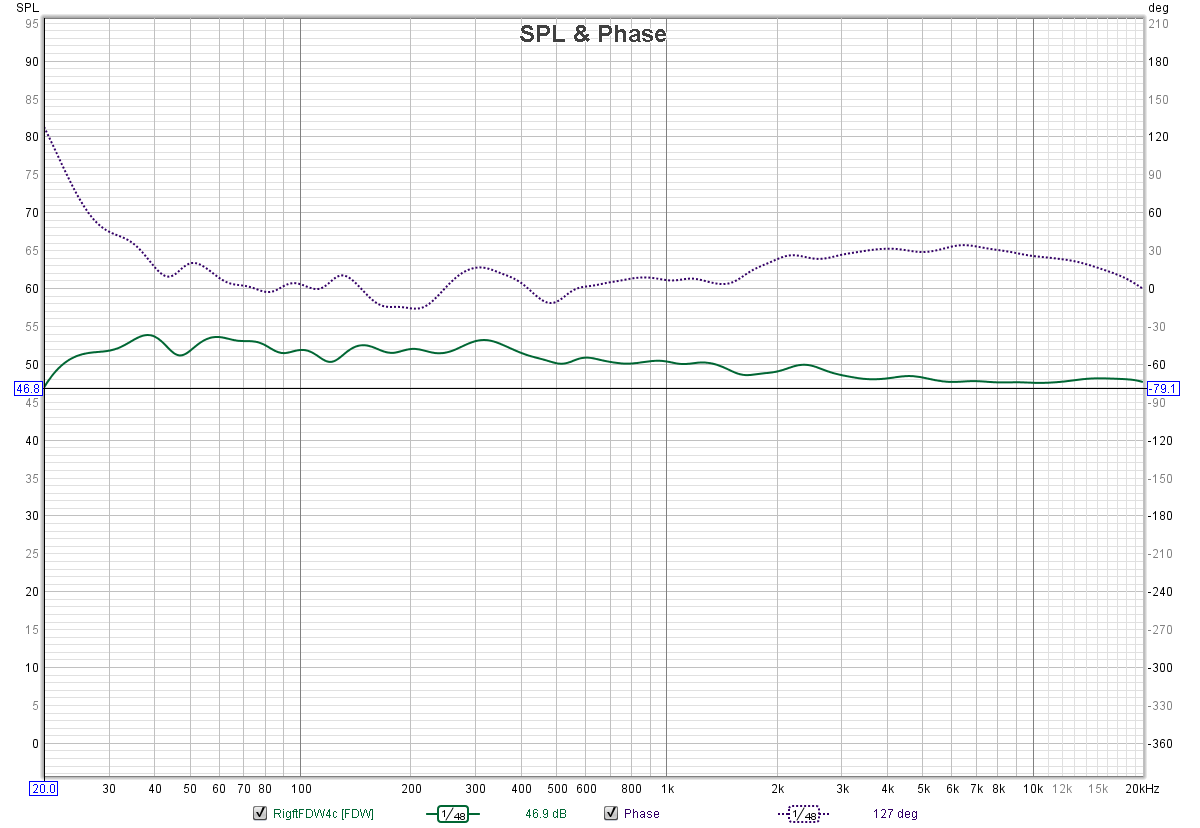

Image from my speaker measurements, normalized and zoomed in. I suspect I hear some artifacts.
attachment.php
It is measured, 2,6 m from speaker.

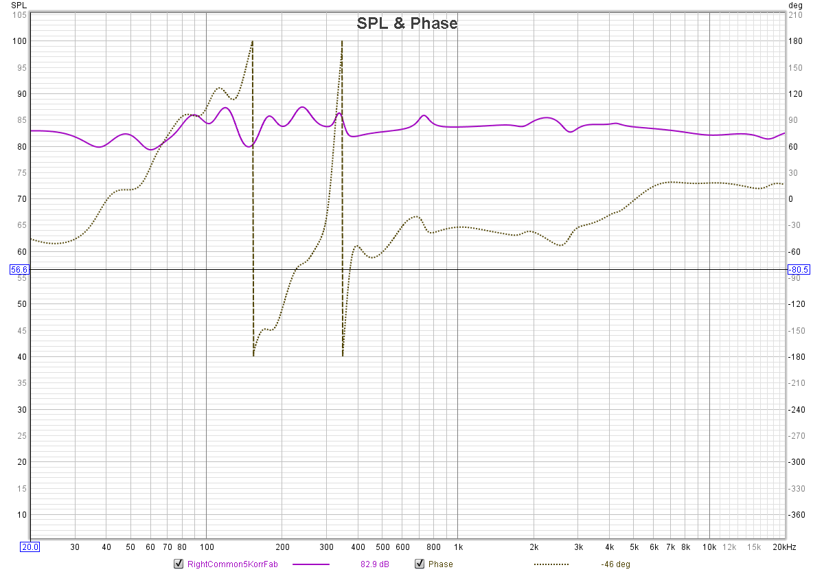

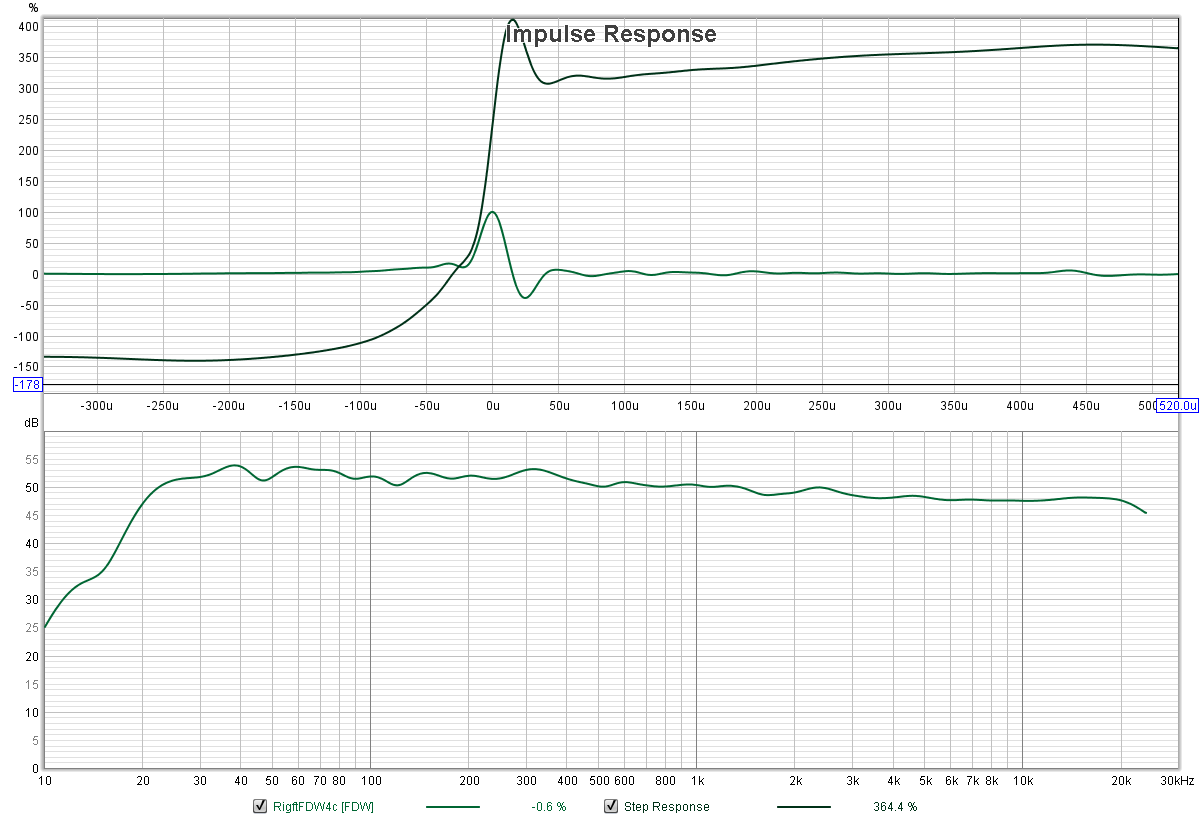

SPL and step from same measurement are looking as below, FWD is 4 cycles.
On other impulse image is also step, but it is differently averaged/filtered by REW, I not find way to change it.
attachment.php
attachment.php
It is 3 way active OB.

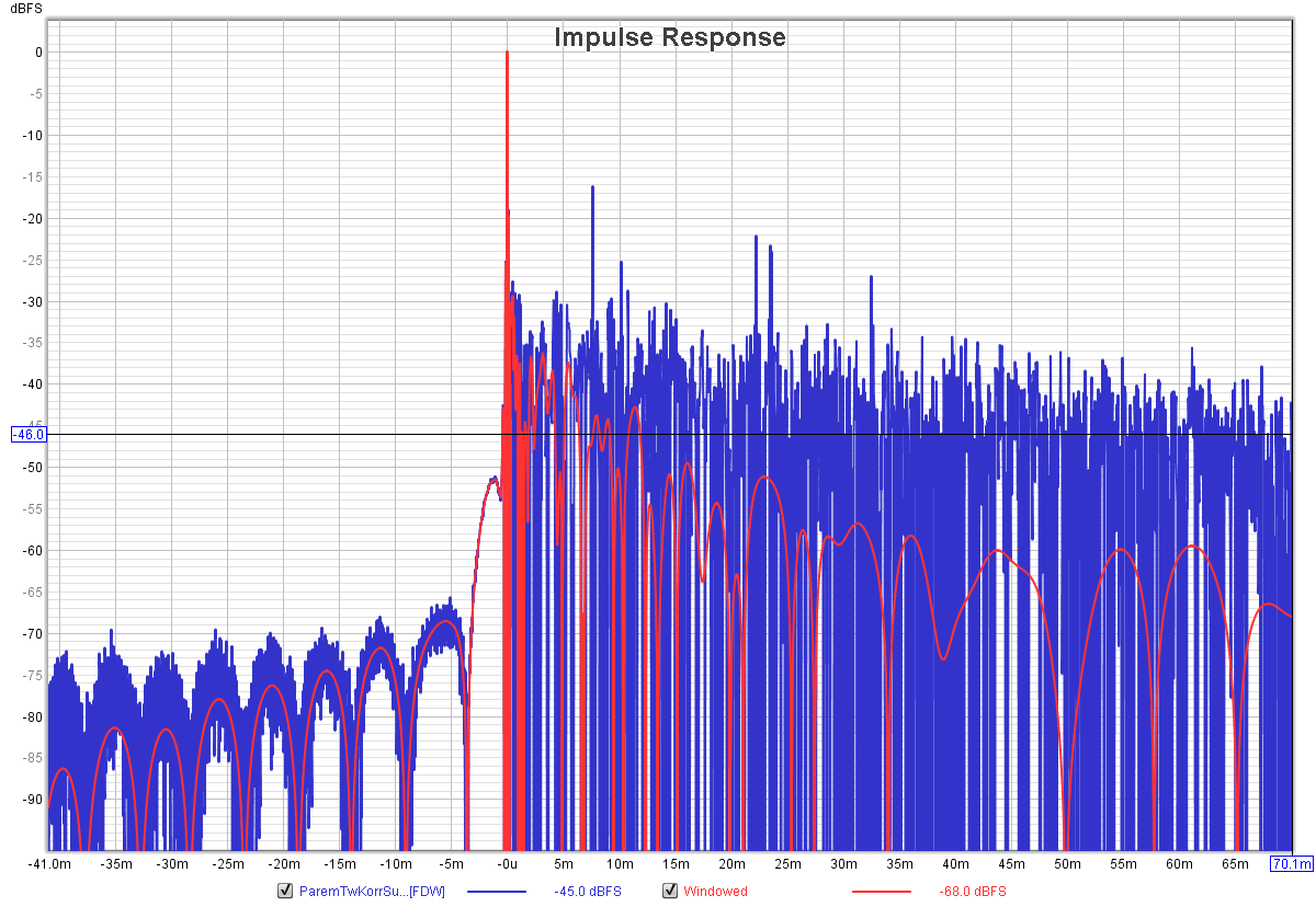

Filter is containingin 2 steps, first FIR correction of general balance, minor room modes (both made with REW) and phase, then FIR filtering (all minimum phase low and high passes) to 3 way, small corrections in mid and tweeter and bigger room mode corrections in bass range.
First correction FIR impulse imported to REW looks this:
938021d1617306377-rephase-loudspeaker-phase-linearization-eq-fir-filtering-tool-phaseandamplitcorrection-png
I also tested system without first general correction filter and I not noticed ringing.
Right channel impulse without this correction is with significantly less pre ringing.

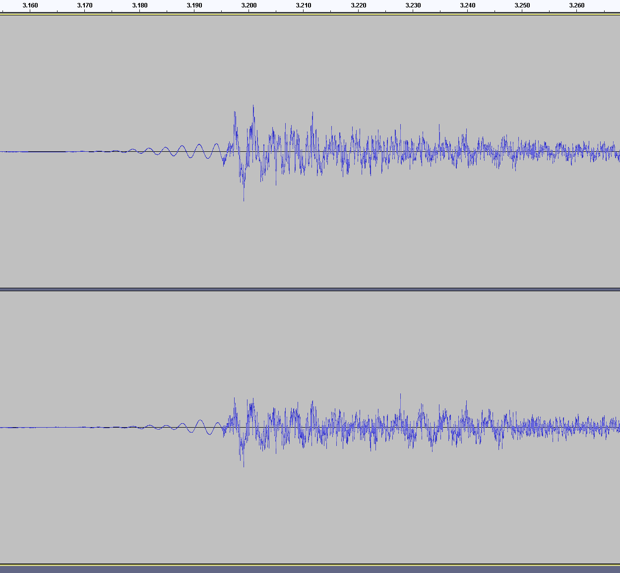

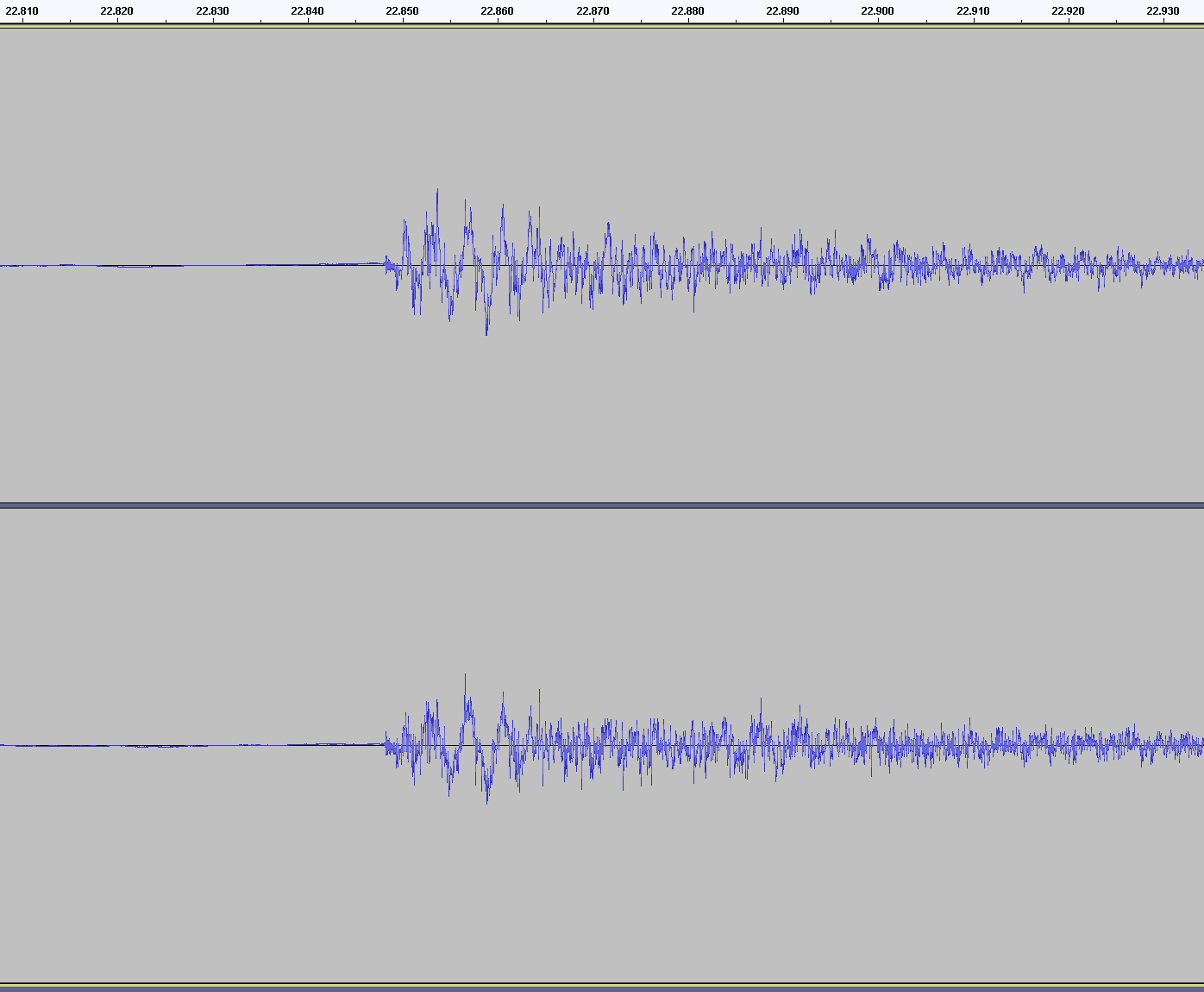

I also recorded with stereo microphone, from usual listening position, part of drum solo where ringing was most obvious. On recording (if listening with headphones) it is not so obvious as directly from speakers. Probably also left and right speaker summary in real room had some influence.I uploaded also mp3 file of recording, first part is with correction FIR.
Images from recording, first without correction FIR, from exactly same part, same amplitude and time scaling.

I noticed your zoomed in to nanoseconds....
Like 20ish nanoseconds between those peaks , that’s not a lot, I would be worried if it was millisecond ....

So, you're using a 3-way, right?
And what are the xover freqs, types, and orders?
Looks like maybe LR4's at about 150 and 350Hz ?
Are you using FIR to correct everything across the input, with xover's in place?
Or exactly what?
The impulse in #3282 looks like a mid driver is leading the higher driver...
but in #3285 it looks much smoother; is #3282 due to FDW, or gating, or some other type smoothing?
(If so, I really advice against FDW and/or gating if at all possible...usually overdone and dumbs down the data way too much...stick with modest smoothing is best bet , ime)

I am looking direct phase, direct SPL without audible pre and post ringing.
I had LR6 at 210 Hz and LR4 at 2700 Hz electrical filters defined manually in rePhase, as I had OB so acoustically 210Hz filter is more like LR8 on 210 Hz and 2700 filter like LR6.
Actually I had not problems on filter as I had same speakers before (and also now if needed) with DSP based IIR filters and I had tuning the filters long time.
I get audible artifacts after adding correction made base on house curve on REW and manual phase correction, they are in same rePhase FIR.
REW had different gating/filtering on different Impulse views, I actually did not know the difference.
#3282 and #3285 are same measurements with FDW 4 cycles. #3282 is from Overaly/Impuse, #3285 is direct Impulse view.
