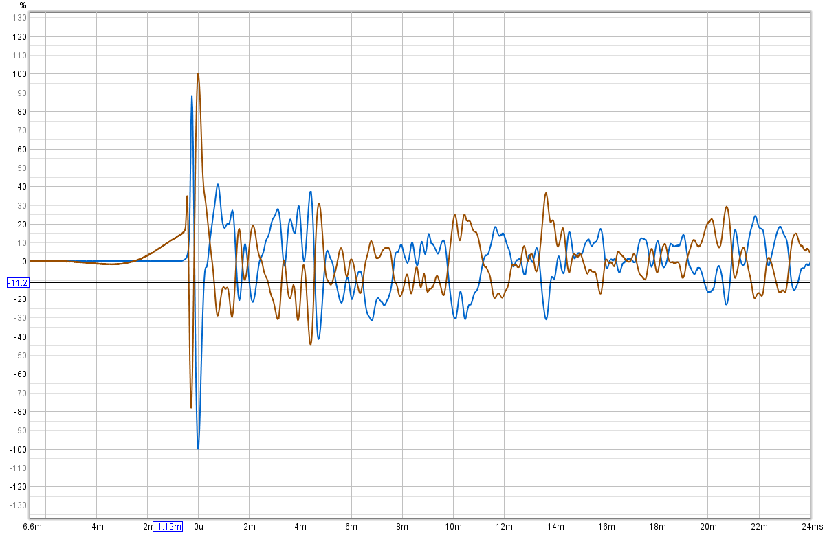

What is criteria based on what can be decided, that measurement polarity is correct?I also often see measurements with wrong polarity imported into rephase (with the well recognizable phase shape on top). That cannot be considered a valid base for any phase correction, let alone an automated one!
A properly measured loudspeaker (for a given frequency range) should produce a measurement that is easy to cleanup (gating and/or smoothing, preserving what is important, with correct polarity and delay compensation), the phase of which would in turn be easy to linearize using one or two "filter linearization" entries, and maybe a tad of phase EQ...
Highest impulse peak is on positive side, or fist impulse peak? Or something else?
What can be wrong (measured or other) when after correct "filter linearization" entries in rePhase (when linearizing filter with imported measurements) phase is nearly direct line, except one 360 degree turn on frequency between filter frequencies?

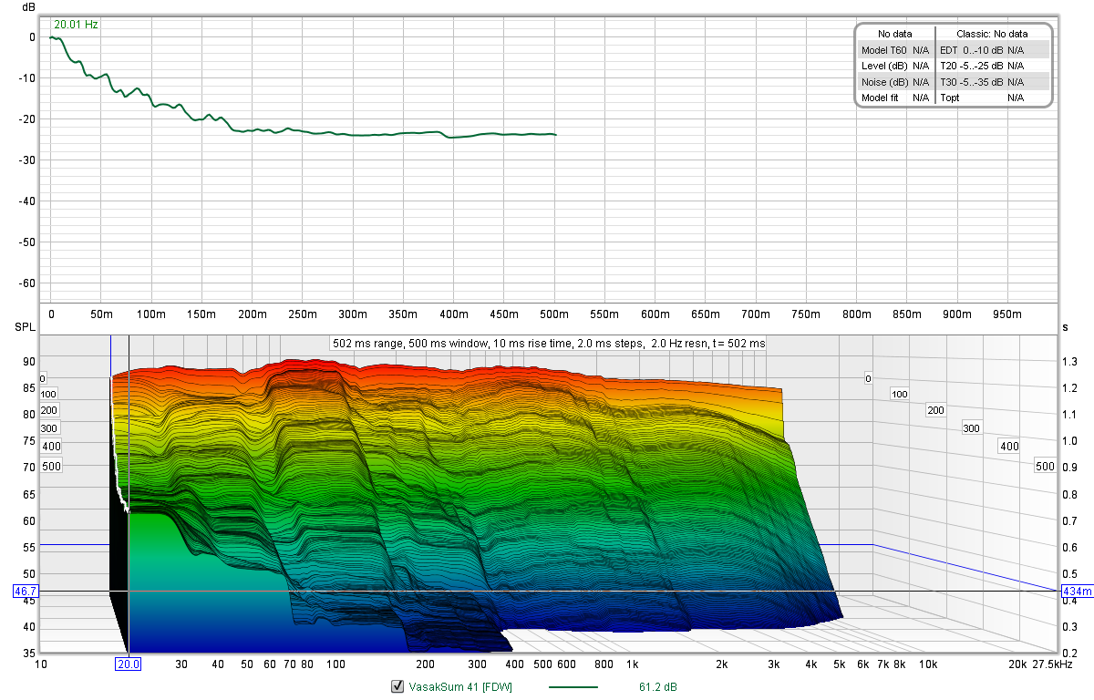

Room has next RT60, measured 2,6 m form speaker, FWD is "with in cycles 10", speakers are active 3-way OB, filters also made in rePhase. Measurement is made after my initial rePhase+REW correction.
10 Cycles is quite a lot of time, to let the reflections in. OB is going to have reflections, not the early ones from side walls, but that back energy is coming from the room at some point in time. To get an idea about the first wave front that hits our ears, I usually use a waterfall like that, but way shorter. Something like:

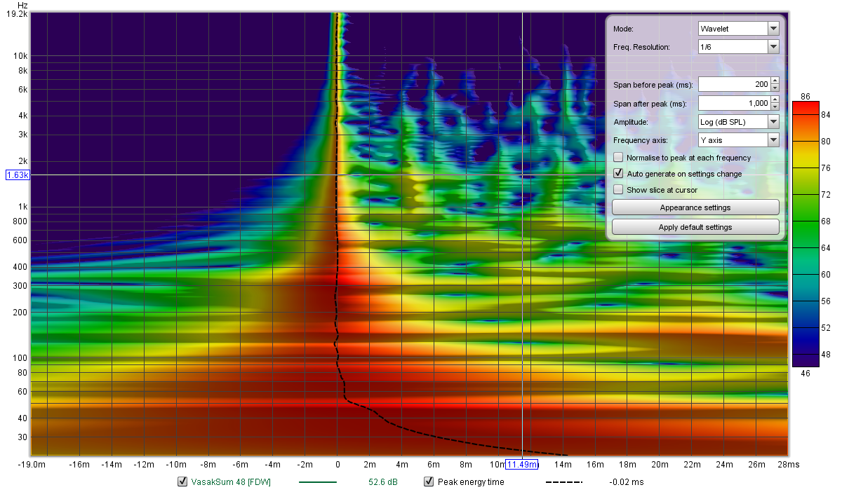

Combined with a Specrogram, to check the timing, but that view is also very dependent of what setting you use.

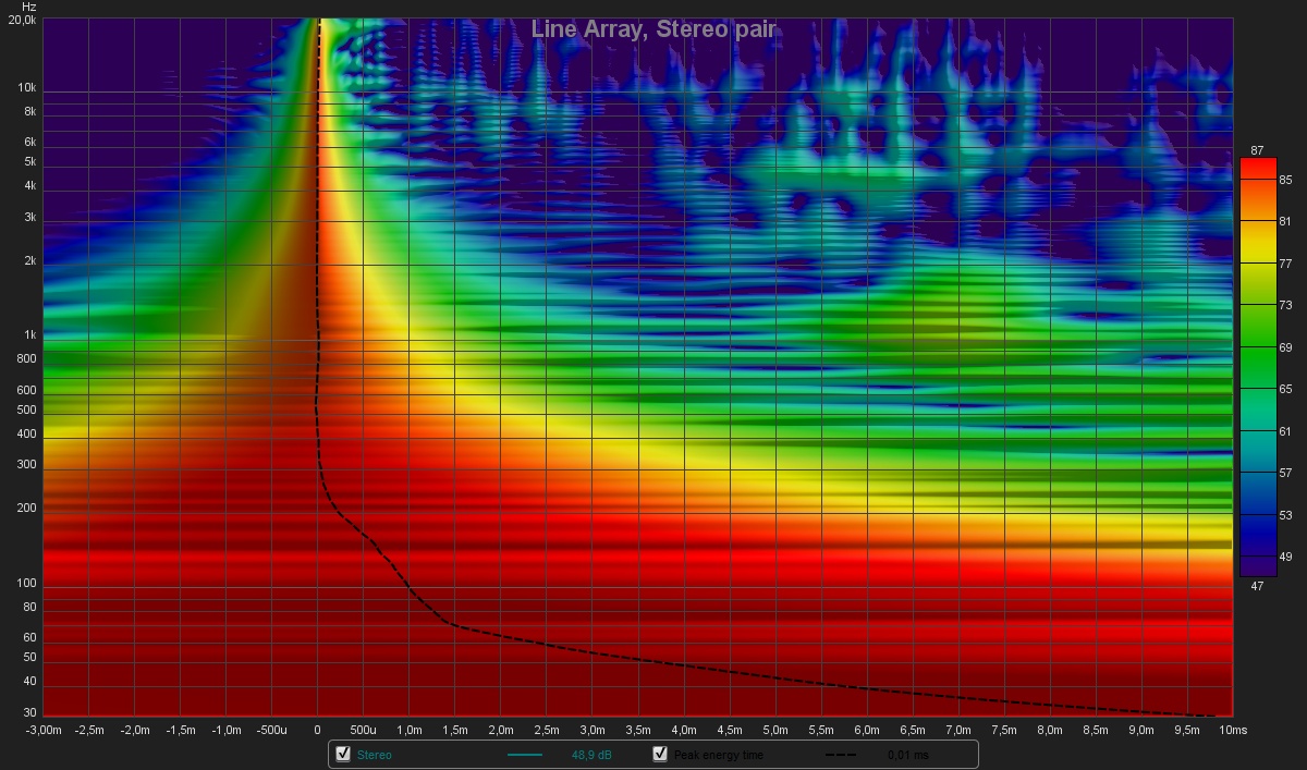

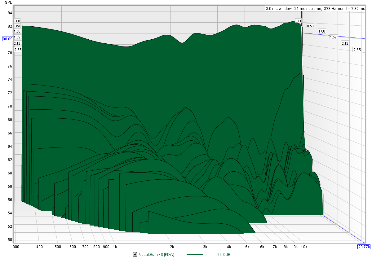

An example of it of my speaker pair:

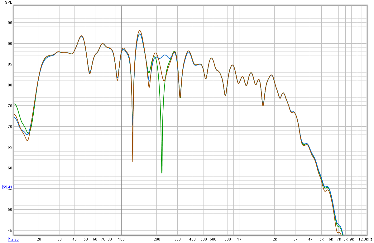

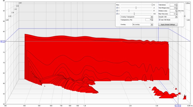

I made other test where bass and mid FIR had both 100 000 taps, mid delay is changed accordingly.But I can test same taps FIRs tomorrow, currently I already using middle centering.
Result is same, brown line where bass FIR is inverted, mid direct; blue when mid is inverted and bass is direct.
Added also SPL line, color coding is same, green is when bass and mid both are direct and impulse in green when both are direct.
My nearly same images from 10 Cycles FDW data. Abou wavelet setting I am not sure are they reasonable.10 Cycles is quite a lot of time, :
Play with the cycles, get to know/hear what it does. At 4 ms you seem to have the first reflections, probably visible in the IR too. Early reflections don't all have to be detrimental to our perception. More on that later.
Experiment with a couple of corrections based on different window lengths. That way you will learn what suits you. My personal goal has been to try and limit the window length, used for correction, as much as possible, without losing the advantages. I use DRC-FIR, which has a tad more resolution in it's frequency dependent window compared to REW, and I use different lengths for high, mid and low frequencies that fit my personal preferences (and speaker type).
Whichever peak has the greatest magnitude, positive or negative, make that peak the positive one via polarity. Whether it is the first peak or not.
Use that peak as the timing reference.
Best way to find what can be wrong that i know of, is see how well acoustic measurements conform to predicted.

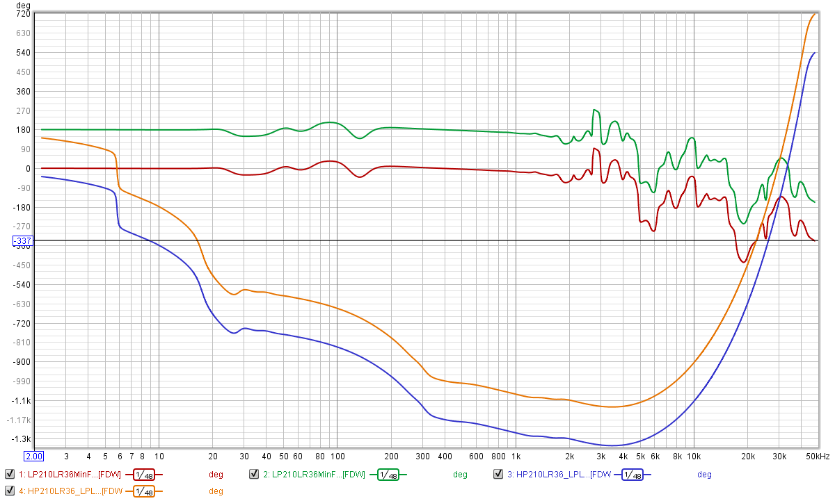

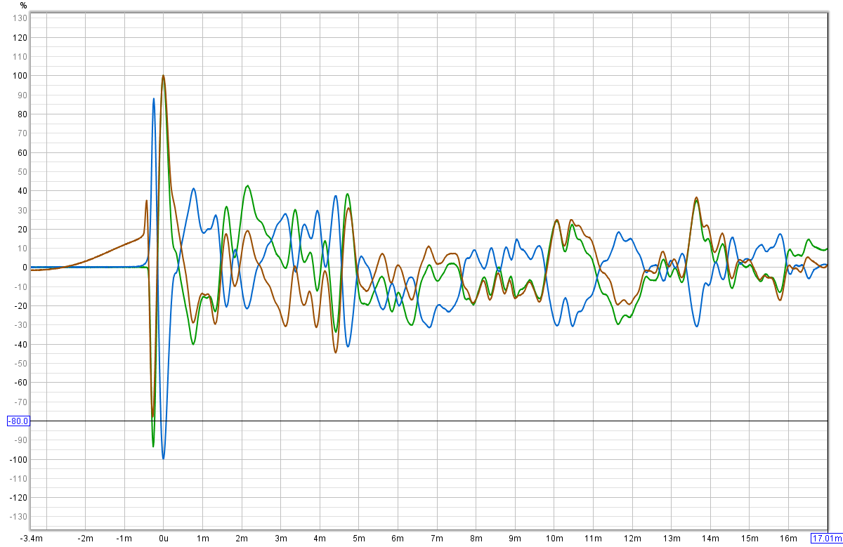

You might try inverting the polarity of the FIRs using something else than rephase, and see if the problem remains.
If it does then the problem lies in the way the FIR are applied and/or the different channels are summed.
I imported rePhase generated bass and mid direct and inverted filter versions impulses to REW.
