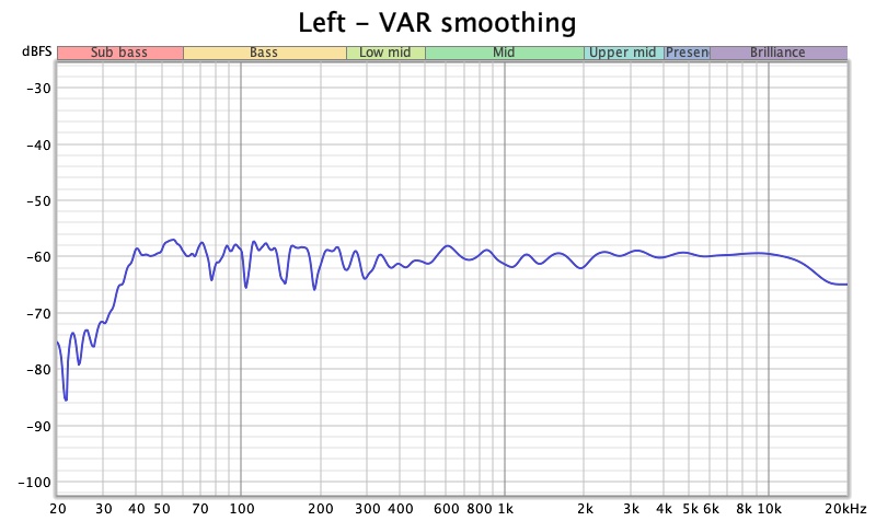

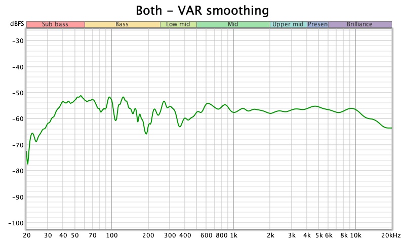

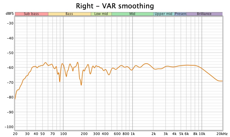

Yes sure - files attached.
That has a look of boundary interference to it. Have you got the measurements of what the response was before you EQ'd it? Have you tried to measure from different positions left to right?

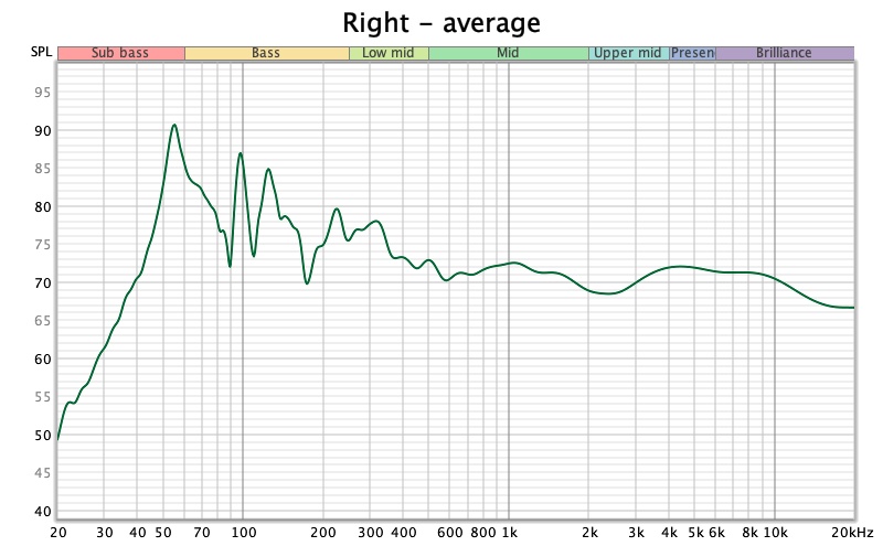

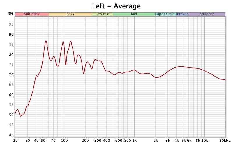

Many thanks. Here are the left and right pre-EQ responses. I'm afraid I don't have one for both speakers together. Each of these is an average of three sweeps. One at the listening position, one approx 50cm to the right and one approx 50cm to the left.
Looking at the different positions separately can help to identify where the issues are developing. Averaging the curves together hides the real problem.
You can get a good idea of the combined response by vector averaging the left and right impulses in REW after they are time aligned.
If you have the measurements in one REW project you can zip the mdat and attach it to a post if it isn't too big.
I wonder if the 2k dip is related to directivity mismatch and by filling it there will end up being a peak in the on axis response. This is the difficulty in trying to EQ speakers in a room when you don't have anechoic or semi anechoic response data for them.
