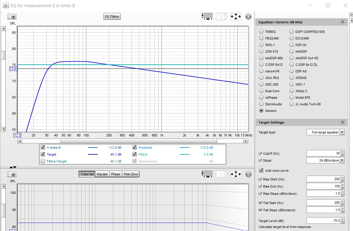

I don't wish to be negative so please take this constructively. If I was writing the tutorial I would try and cover every step you took as it was that aspect of the swissbear tutorial that lead to your questions about it.
I would start with a target curve something like the screenshot. The LF rolloff point will depend on the ability of the speaker and what type it is. The ideal slope can vary by room and speaker as well as personal taste, anywhere from -0.8dB per octave to -1.2dB will usually work. If you haven't tried it you should the difference in 0.1dB per octave over that range can have a very large effect on the perceived tonality. An extra shelving cut can also help sometimes, putting one in the MiniDSP and sweeping it in real time could be worthwhile trying.
I ease the slope off at 100Hz some people like it to go down further. I find it makes things sound too bass heavy if I don't flatten at 100Hz.
My current approach is to flatten the response based on a windowed measurement that should be representative of the direct sound and then add PEQ shelving filters to reintroduce the slope but being adjustable I can tweak the slope at different points based on listening. This approach is not necessarily the best way for all speakers and rooms but it has proven to give the best sound for me so far.

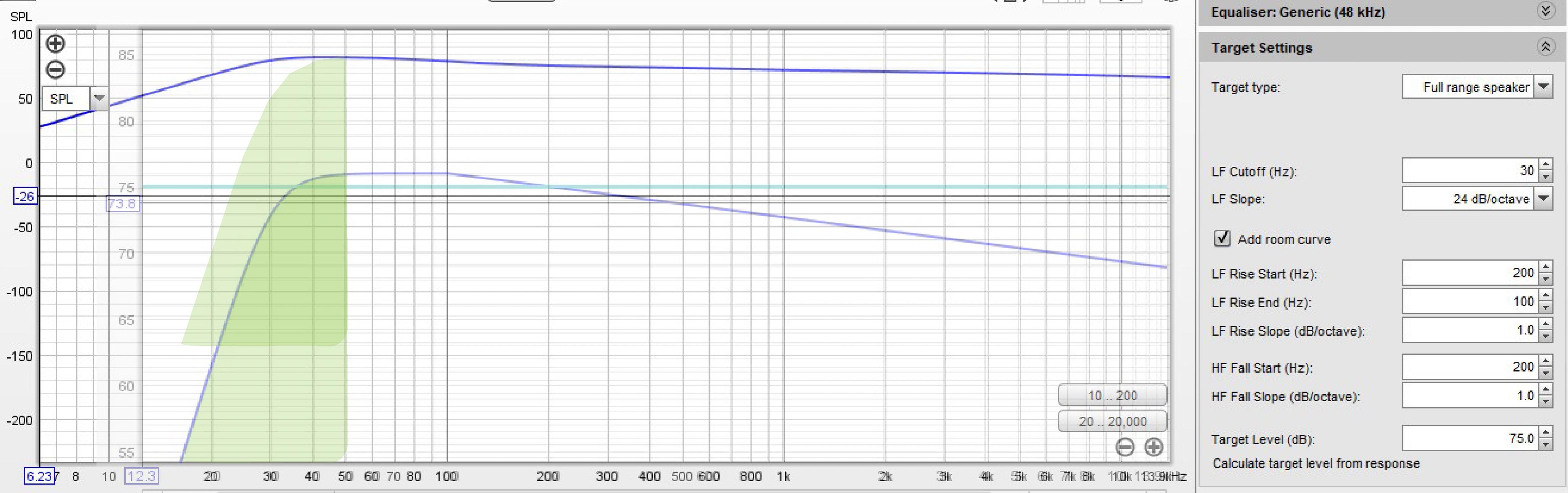

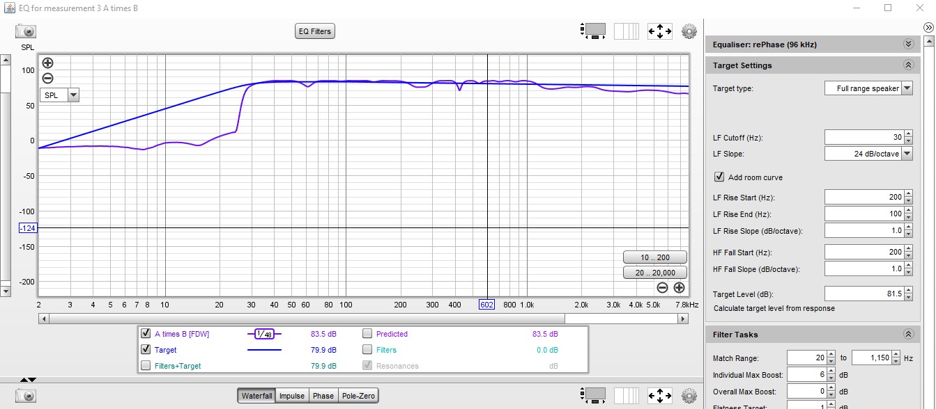

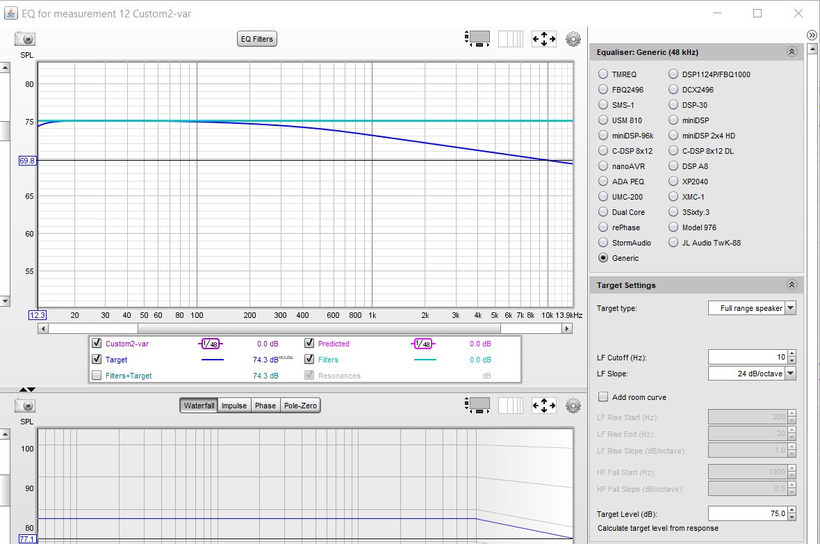

In your picture example target curve LF slope is much steeper ..I have make the same settings and getting very shallow .
Same how I cant repeat it with target settings in my REW.
Have overlapped your picture from over mine .Picture 1
Could t we get the similar result if to import room target curve in REW thru
preferences ? Picture2

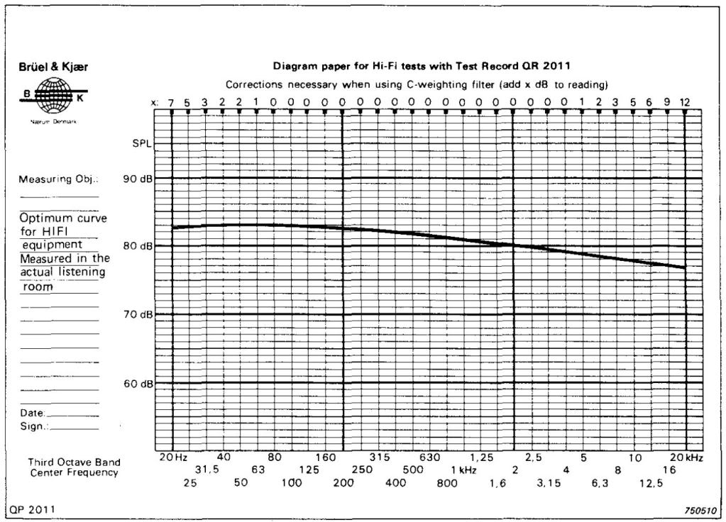

BTW ? old B+K curve ? what is it, how to decode ?
It is the scale that is different, in my shot it is in 5dB steps with a range of 30dB in yours the range is over 300dB so it is zoomed out over 10 times as far. Press the plus button in the top left until your scale matches mine and your curve will appear steeper. Edit: wesayso beat me to this one 🙂
The Bruel and Kajer curve (image attached), my memory was faulty on that one the flat to 1k then tilting down was one of Bob Katz' earlier recommendations. Mitch Barnett has some good information in his Computer Audiophile / Audiophile style articles.
A well designed speaker with a flat on axis and listening window response that is relatively conventional in design will have a falling in room response much like these curves.
If the speaker has good directivity then approaching the target backwards like this can be helpful in getting a sound to your liking in room. If the directivity is not so well controlled all bets are off and using this target may well not give the best result.
All of this is covered very well in Flyod Toole's book.

Look at the dB scale on the left of fluid and your graph. You can't overlay these two unless the scale on the left is the same.
On your plot each horizontal line represents 10 dB. On fluid's plot the same lines represent 1 (one) dB!
Thank you ,wesayso will correct that mistake. Always grateful for feed back.
The SPL axis span of your graph is so huge (more than 300 dB) it will be difficult to see slopes of 1 dB/octave. Use a more sensible graph range.
Mitch Barnett has some good information in his Computer Audiophile / Audiophile style articles.......

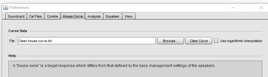

Would be reasonable to make *.txt file for room curve same thing like this:
31.5 6
40 5.9
50 5.5
63 4.9
80 3.7
100 2.5
125 1.3
160 0.6
200 0.2
250 0
1000 -1
32000 -6
And import file to REW in "Preferences"--> House curve ?
Or that not be the same as to make it in "Target settings" for it in REW "EQ" ?

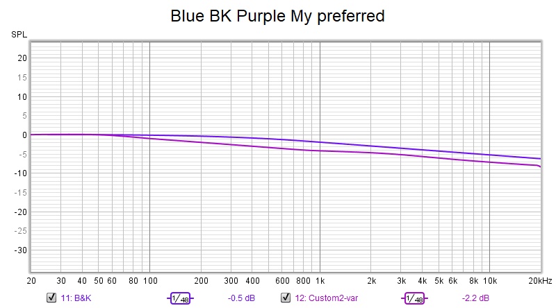

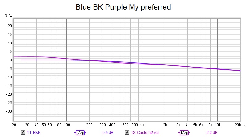

Yes you can do it that way, thumbnail example below showing a BK curve set as "House Curve" in REW, just be sure to untick the add room curve in EQ or you get both combined.
Here is the difference between BK and my preferred curve.
attachment.php
When you adjust the levels to overlap you can see that it is a bass boost and a little more cut here and there, text files attached so you don't need to reinvent the wheel.
attachment.php
I came to mine based on a lot of listening and manually adjusting shelving EQ's. It is amazing how similar these curves are to each other considering when and how there were created 🙂
