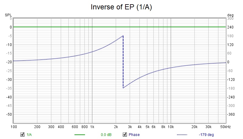

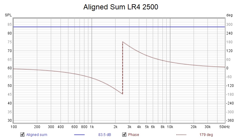

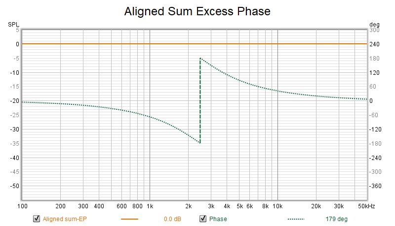

The filters would be the deltas between the excess phase plot and a flat line.
You can do something like this directly in REW if you want to.
Here is an example using the synthetic LR4 2500 from before
Basic aligned sum with flat SPL but changing phase from the crossover
attachment.php
Excess Phase version 0dB SPL but changing phase
attachment.php

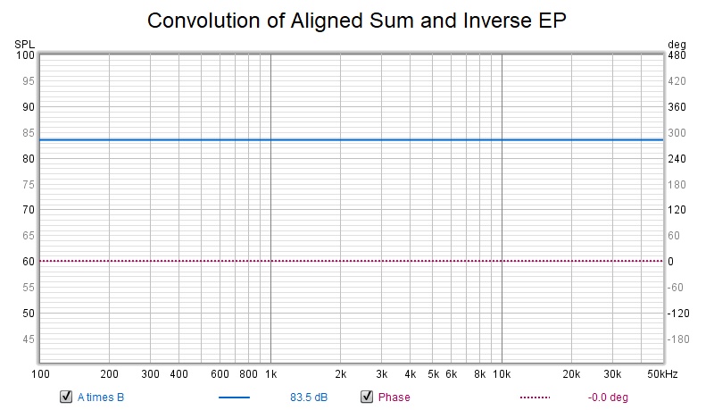

By Using the 1/A function in Trace Arithmetic (All SPL) you get an inverse response
attachment.php
If you then convolve the inverse response back with the original you get flat SPL and phase
attachment.php
The inverse filter response can be exported from REW as a wav file for use as a convolver filter, the length will be long if the response is not windowed before export.
This is a complete inverse which may or may not be a good idea 🙂 And is related to what pos wrote above about the measurement being correct.
For a more automated correction where limits and windows can be chosen DRC_FIR is a good free program. There is good thread here if you are interested in that A convolution based alternative to electrical loudspeaker correction networks
It's probably worth noting that the same inverse phase response generated by the 1/A function in REW's Trace Arithmetic,
could be done directly in rephase with Filters Linearization of a 24dB/oct LR4 at 2500Hz.
Much simpler, more direct.... with less chance of error than using REW with the additional trace arithmetic steps, and then setting export window size & sample alignment .........imho.
It's probably worth noting that the same inverse phase response could be done directly in rephase with Filters Linearization of a 24dB/oct LR4 at 2500Hz.
If you only want to generate the inverse of a known LR filter then filters linearization is the simple way. Someone asked for automation, of paragraphic phase EQ which suggests a much more complicated inverse hence the other method. The example was not meant to be taken literally 😉

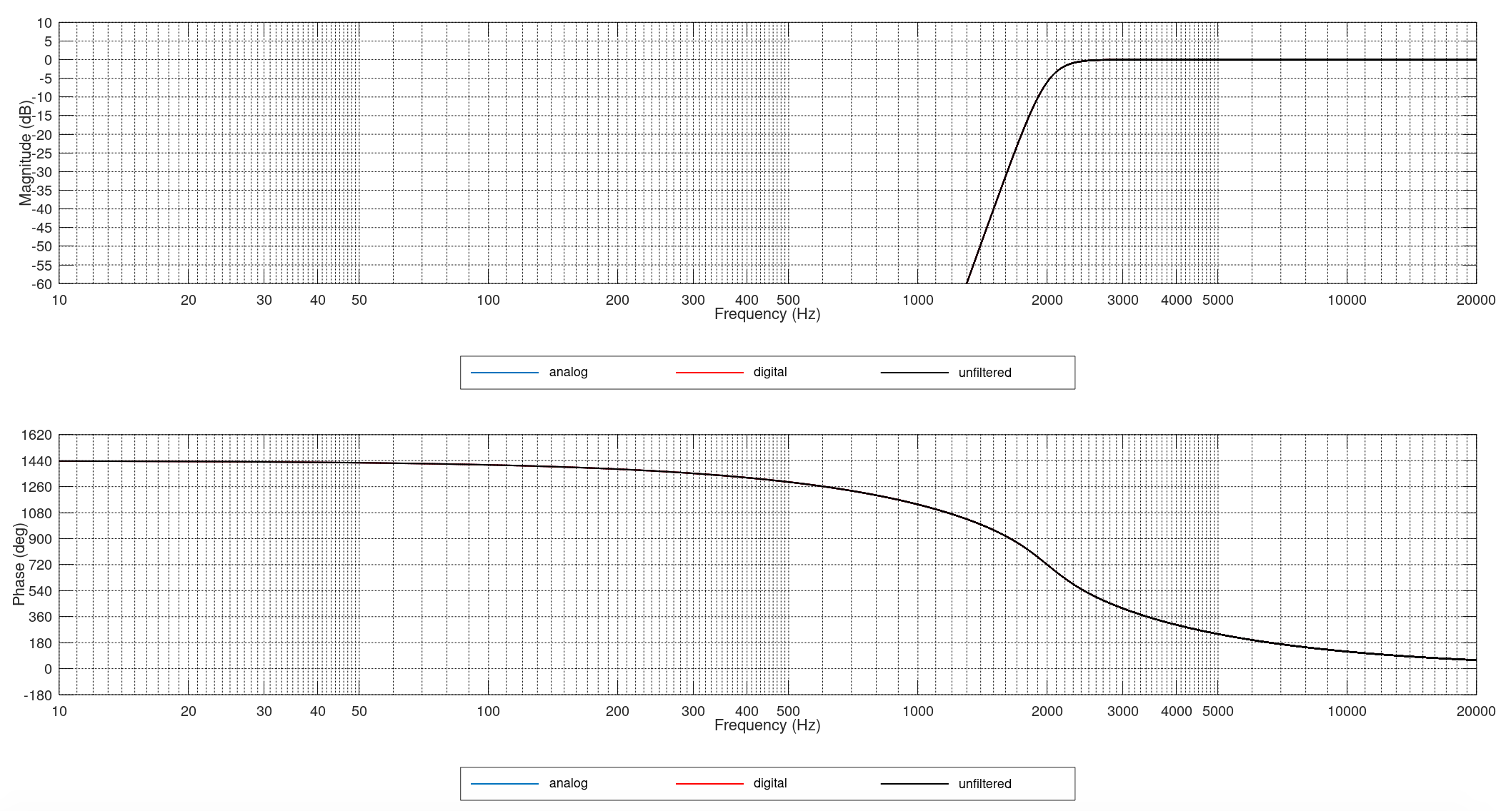

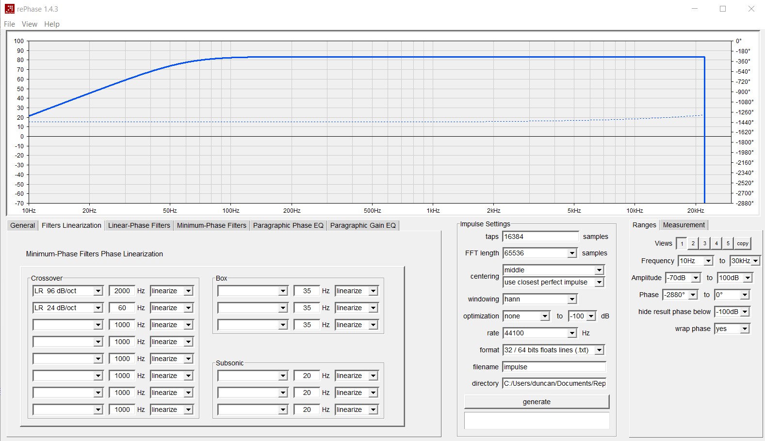

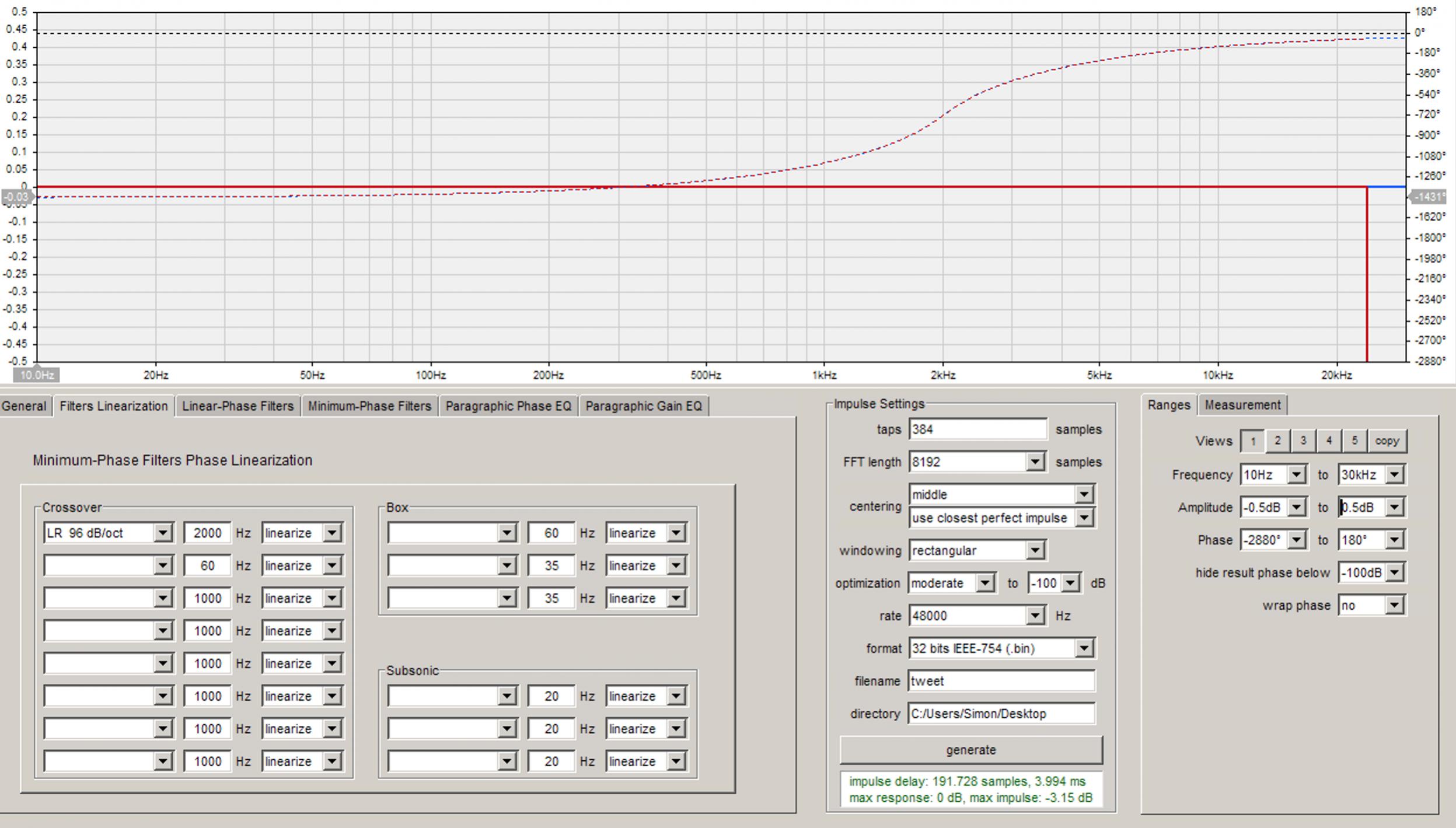

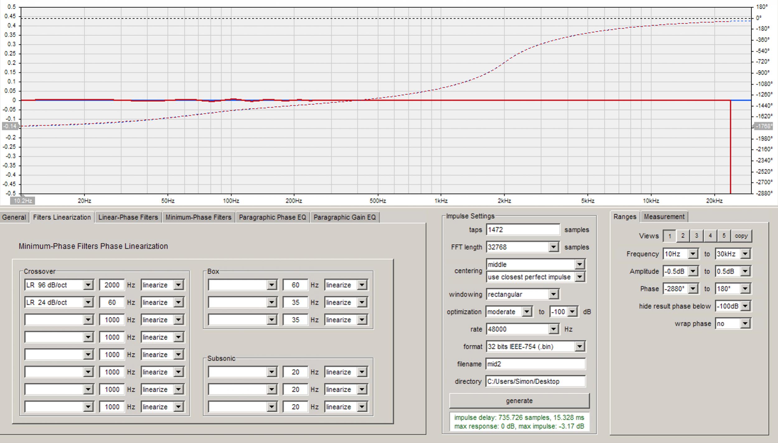

I've been trying to wrap my head around something in rePhase and am looking for some input to increase my understanding.
I am trying to linearize phase of a crossover using a miniSHARC. The mid has a LR4 60 Hz LPF and a LR16 2000 Hz HPF. The tweeter has a LR16 2000 LPF.
When I look at the correction filter that RePhase generates I notice that it appears to "subtract" phase. As a result the corrected phase appears to be a flat -1440 deg for the tweeter and a flat -1800 deg for the mid.
How do I interpret this 360 deg offset? My first pass interpretation would be that the mid will be one cycle behind the tweeter at all frequencies but I am not sure that is correct. If this is the case a delay really won't help and the only way I can think to get similar phase response would be to tack on a LR4 60 Hz LPF to the tweeter and linearize that (which would obviously greatly increase the amount of taps needed for the tweeter).
Any thoughts? I feel like I must be thinking about this incorrectly.

Thought about my previous post and I think I just confused myself even more 🙂.
The numbers quoted in my previous post did not account for the fact that the HPF phase will be 0 at high frequencies and will increase at lower frequencies but the LPF will be 0 at low frequencies and will decrease at higher frequencies.
To me this would suggest that the phase offset would be even greater as the corrected tweeter would have a flat phase response of 0 deg and the mid would have a flat phase response of -1440 deg. As I can't think of any easy way to correct this I feel like this must be a non-issue and I must not being thinking about this correctly.
Michael

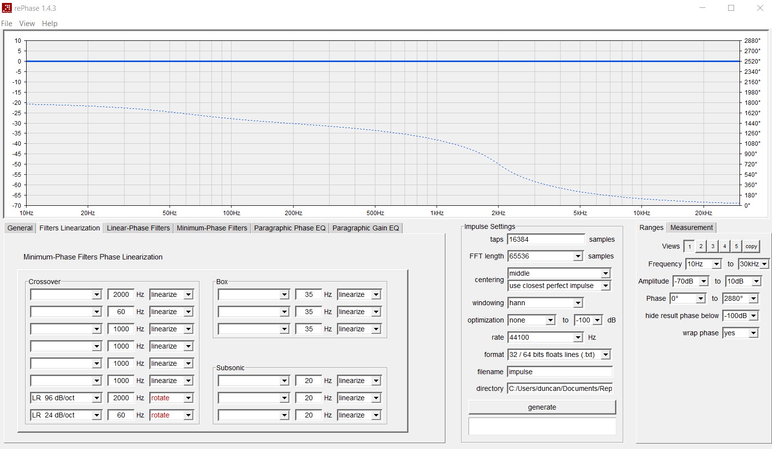

If you change linearize to rotate in rephase it will show you the phase lag being created by those filters, 1800 degrees positive. If you then add the same filters with linearize you will get back to 0 degrees.
The point of the linearization is to undo the positive phase caused by the filters so it has to be negative to do that.

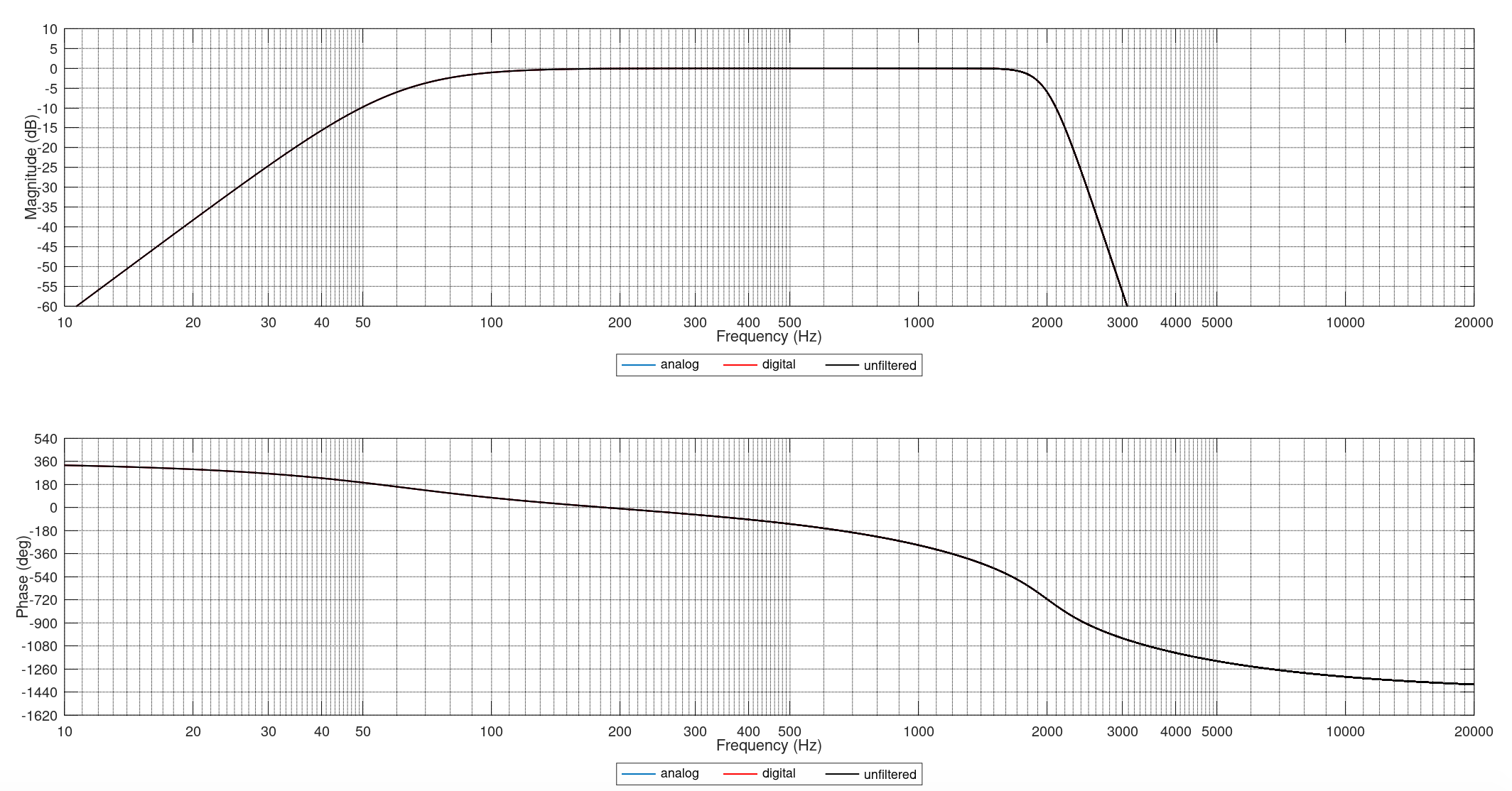

I think you may have posted prior to my second post was cleared by the mods (long time lurker, just started posting recently).
Won't the LR16 HPF (tweeter) phase have a range of +1440 / 0 and the LR16 LPF and LR4 HPF (mid) phase have a range of +360 / -1440 (see attached images)? And after correction the tweeter will be at 0 deg and the mid be at -1440 deg?
What I am missing?
Michael

I did post before I saw your second one, now I'm not sure what you don't understand and I'm sure what I posted didn't help 🙂
Here is a simulation of the uncorrected response and then the linearized one. The uncorrected response goes from -1260 to plus 360.
When it is linearized it comes out fairly flat at -1440.
A flat phase with positive or negative number is just a time offset, in this case if it was removed the phase would show as trending to 0.
Maybe that helps?
