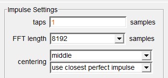

More than 131072 taps causes text entry to turn red ???
Is there a reason why entering more than 131072 (128K) taps in the "Impulse Settings" dialog causes the text entry window to change the color of the text from black to red ?
I see there is mention of using 262144 (256K) taps in this thread, but the GUI seems to be drawing attention (e.g. warning or error) to these larger values.

I'm not sure exactly what the red text signifies but you can also get it by typing very low numbers too

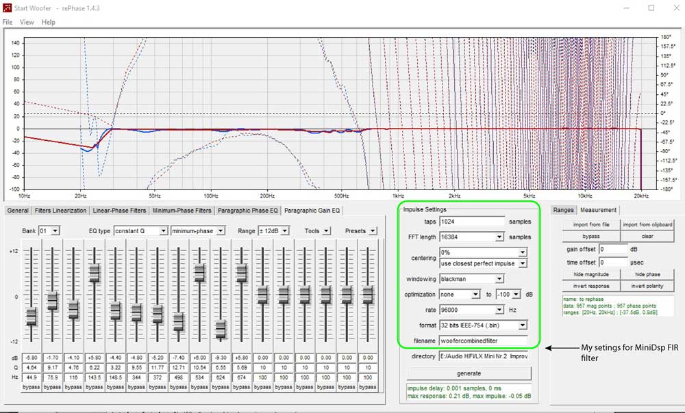

Yep, her (Re Phase) depends on your hardware/software settings. You just must take a looks what parameters your DSP needs to work with FIR filter.
Personally,I'm using MiniDsp 2x4 HD...And setting for it looks like this...
RePhase knows nothing about your specific hardware/software because it is not required to run on the same machine.
I am using 64 bit IEEE mono .wav format and 192KHz. 256K taps @ 192KHz is the same resolution of 128K taps @ 96KHz and 64K taps @ 48KHz. The text does not turn red for the latter two as it does for the former.
MiniDSP is limited in the number of taps it supports compared to other solutions.
The red coloring is to be seen as a caution sign rather than a real warning.
Memory and CPU usage rises quickly with the number of taps, so I wanted to avoid having unsuspecting users crank it all the way up without understanding the consequences.
Thanks for the explanation. I wanted to make sure the filters were constructing filters properly.
