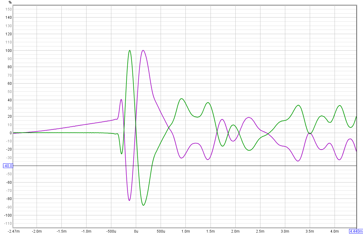

When designing filters for EQ APO with rePhase and REW I find something strange.
Measured summary of bass and mid band SPL line depends from which one filter is inverted in rePhase General/Output Settings/polarity.
On first image below red is when both filters are not inverted, obviously responses are out of phase on 215 Hz..
Green line is when mid filter is inverted, blueish is when bass filter is inverted in rePhase.
On impulse graph is visible that impulse is not only inverted but has also little different shape in range -2ms to 0.
What can cause this?
Can some filter Impulse settings influence this?
Bass filter had 100 000 taps, mid 10 000, delay is aligned in EQ APO.

That is strange indeed.
Can you try generating both bass and mid FIRs with the exact same number of taps and middle centering? I don't know how EQ APO does its convolution, but different FIR length can imply different buffering lengths.

I think EQ APO buffers are not problem here, otherwise there must be all phases wrong, and impulses delayed With needed delays defined in EQ APO I get different bands with different number of FIR taps aligned as they must be. This problem I have only in left channel, on right channel all is OK.That is strange indeed.
But I can test same taps FIRs tomorrow, currently I already using middle centering.

Automated corrections need to rely 100% on the measurements, which often implies a very specific measurement procedure that needs to be part of the whole process (think Diarc, Trinnov, etc.).
If you simply apply brute force phase inversion (or any other type of correction really) on an imported measurement you take the risk of correcting things that are just an artifact of the measurement itself (position-dependent issue, measurement post-processing, etc.).
Having some sort of "inverse measurement" (flat magnitude, flat phase, mini phase) on a given frequency range could probably be useful for some situations and to some users, but this would open the door to oh so many abuses and problems...
I already regret having added so much phase EQ points, with such a big amplitude, because I often see people using dozens of those to correct phase shifts, including phase shifts on top due to bad delay compensation, or sharp phase shifts due to comb filtering...
I also often see measurements with wrong polarity imported into rephase (with the well recognizable phase shape on top). That cannot be considered a valid base for any phase correction, let alone an automated one!
A properly measured loudspeaker (for a given frequency range) should produce a measurement that is easy to cleanup (gating and/or smoothing, preserving what is important, with correct polarity and delay compensation), the phase of which would in turn be easy to linearize using one or two "filter linearization" entries, and maybe a tad of phase EQ...
No need to automate that: this is as simple as it gets, and you can focus on the frequency range you know that particular measurement is valid in.
On the other hand what could (should?) be automatized are the level/delay/polarity settings when importing a measurement, with an optional "auto adjust" setting. That would need some work and could bring wrong results on weird measurements (but those are probably hopeless anyway), but that would potentially help to avoid some of the problems described above.
