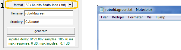

I apologize for not being more lucid. The file is associated to notebook as opposed to rephase. A sample would be like this.

But if I add TXT to the file as I save it I am getting this, which is not helpful with my preamp Najda.

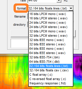

If you choose the text output option as Byrtt showed and press generate to save the file. Open that file in Notepad you will have all the coefficients as you want.
Perhaps you are looking at a Rephase settings file which is why it looks weird in notepad.

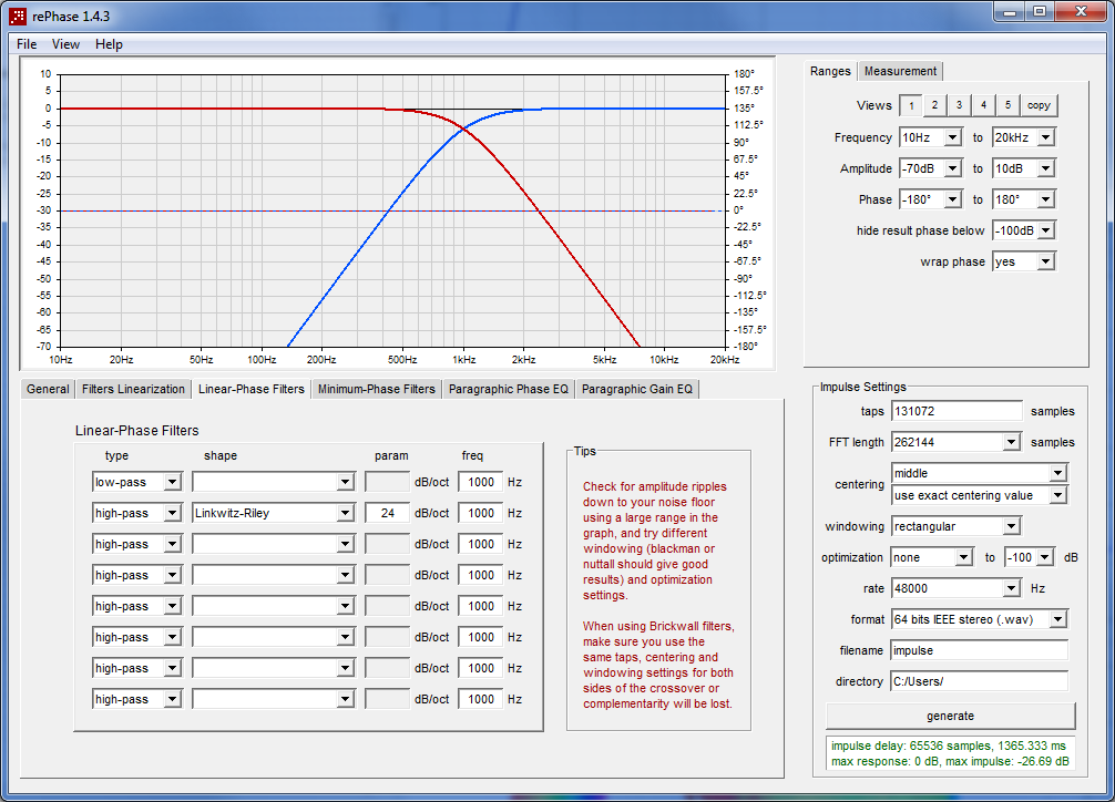

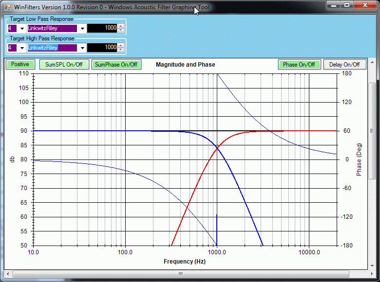

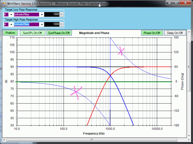

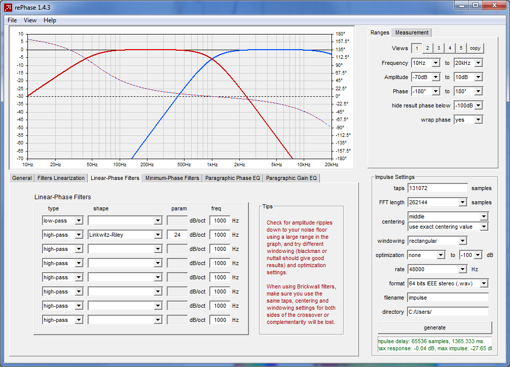

Yes it can on the "Linear-Phase Filters" tab as seen in first visual below, but dont do the same on the system stopbands in its not how sound is in nature so system stopbands need same phaseshift as their minimum phase roll off slope will dictate as in the second example. What you like to do looking your example is linearize the allpass phase behavour (phase distortion) of summing two normal bandpasses, in practical there is two ways to do that in Rephase, one method is import your bandpass measurement to Rephase then EQ its slope flat as a pancake using whatever minimum phase EQ filters and finally add your target slope on that "Linear-Phase Filters" tab, second method is import your bandpass measurement to Rephase then EQ its slope smooth to hit the target curve slope using whatever minimum phase EQ filters and finally linearize the slopes phase distortion on the "Filters Linearization" tab picking same slope as was your target curve, hope it helps and have fun.
