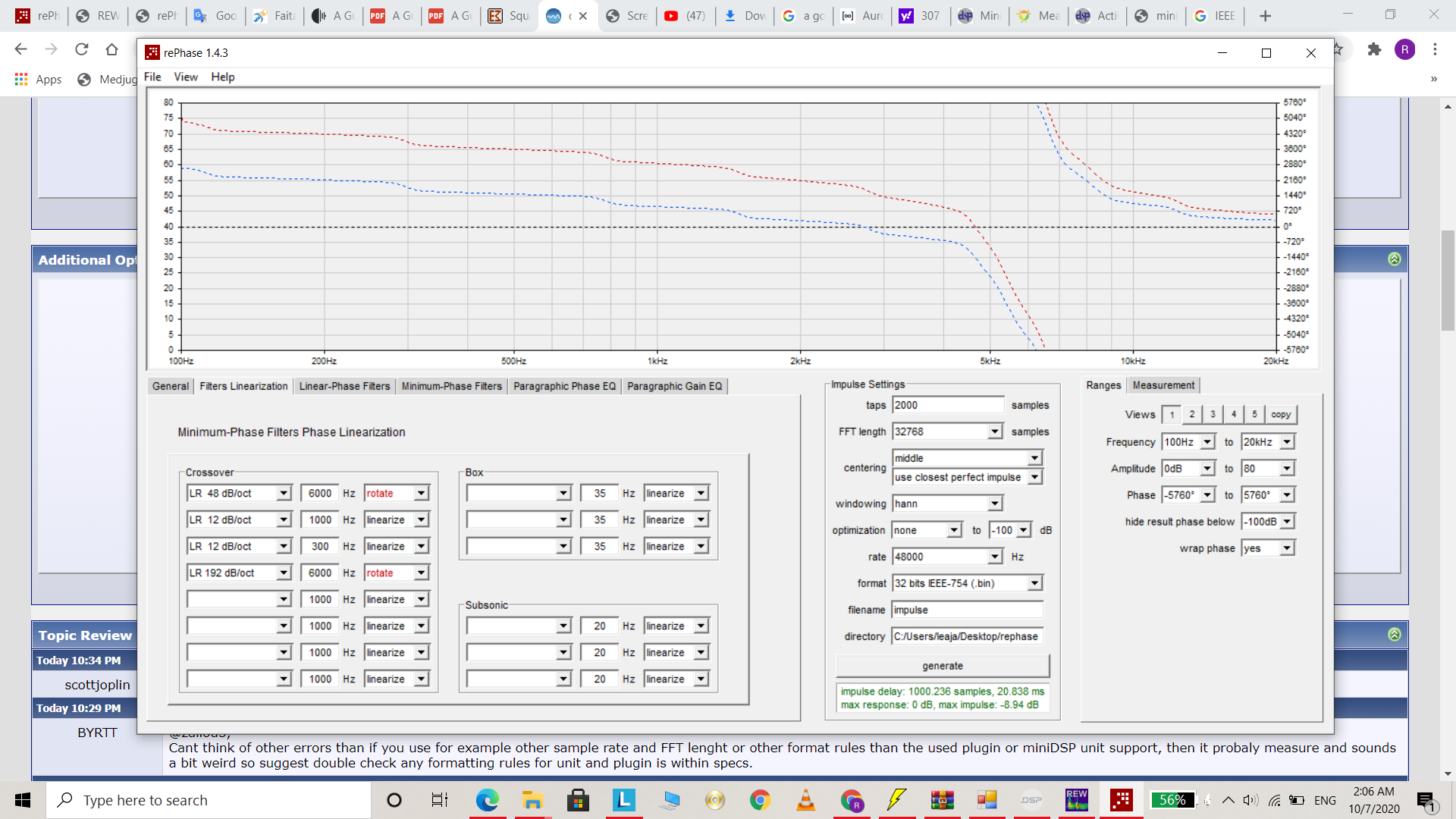

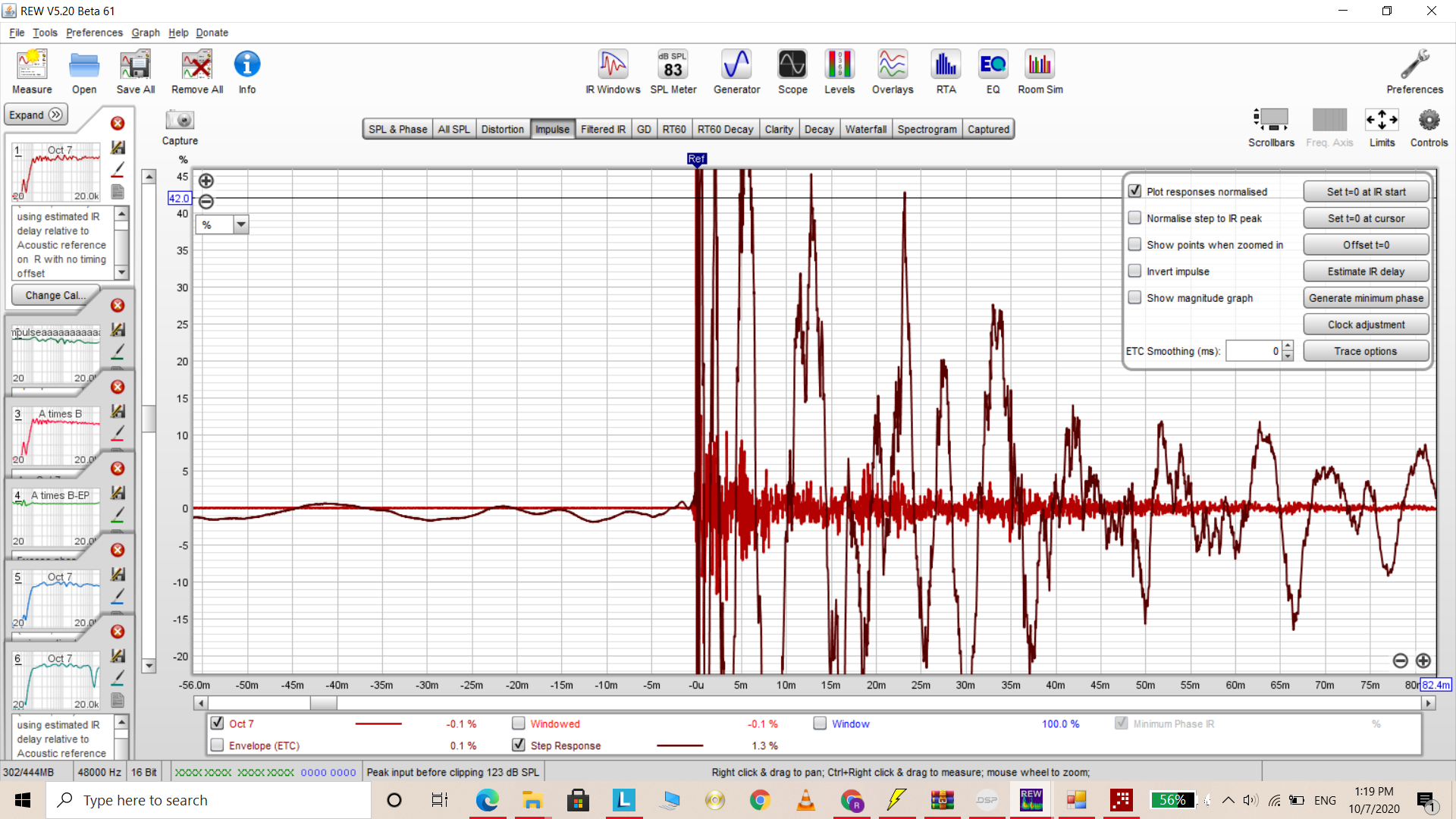

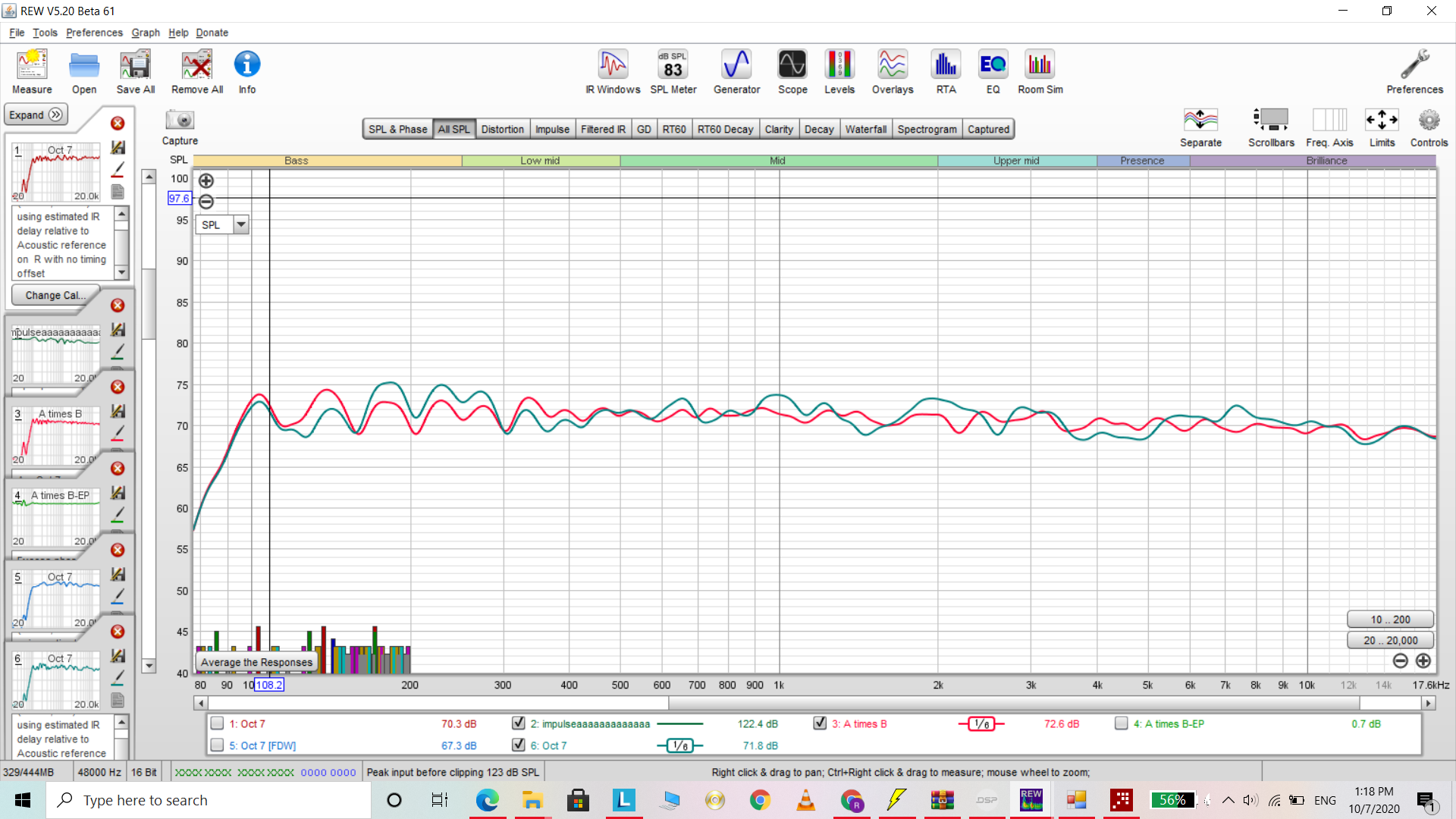

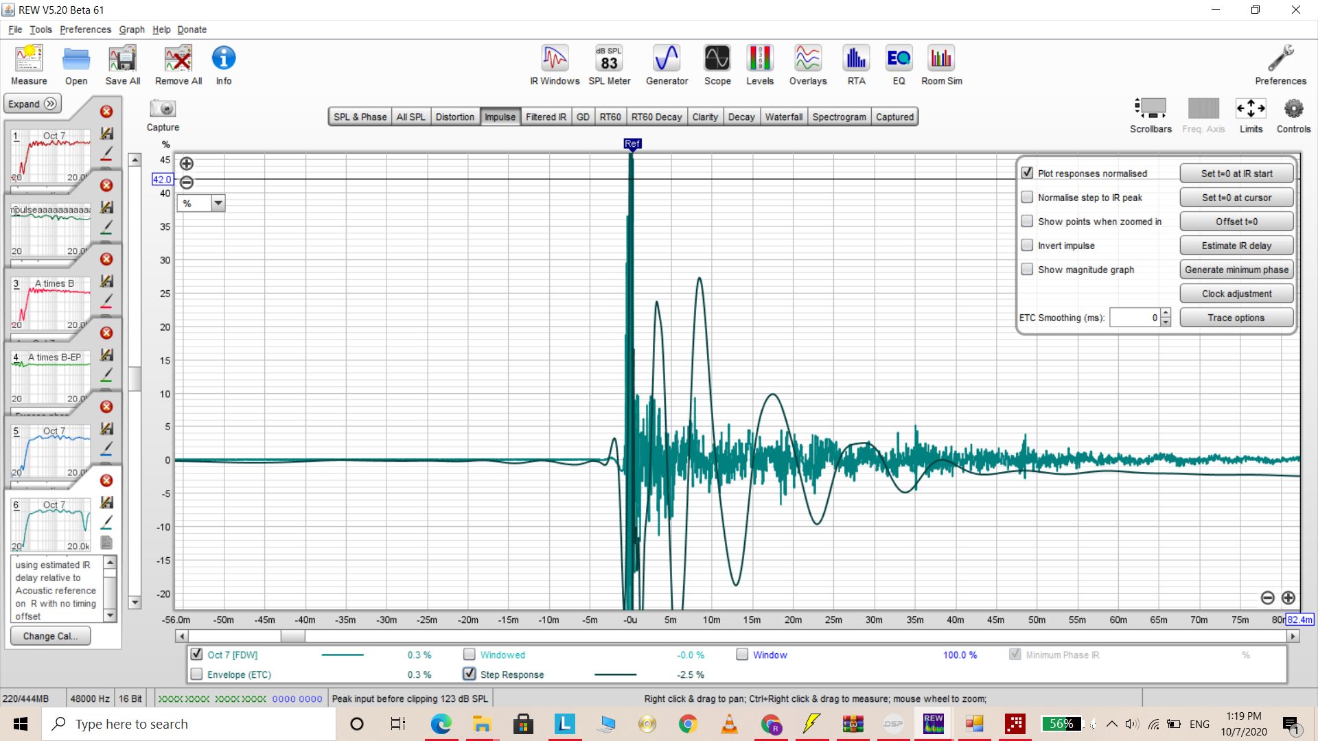

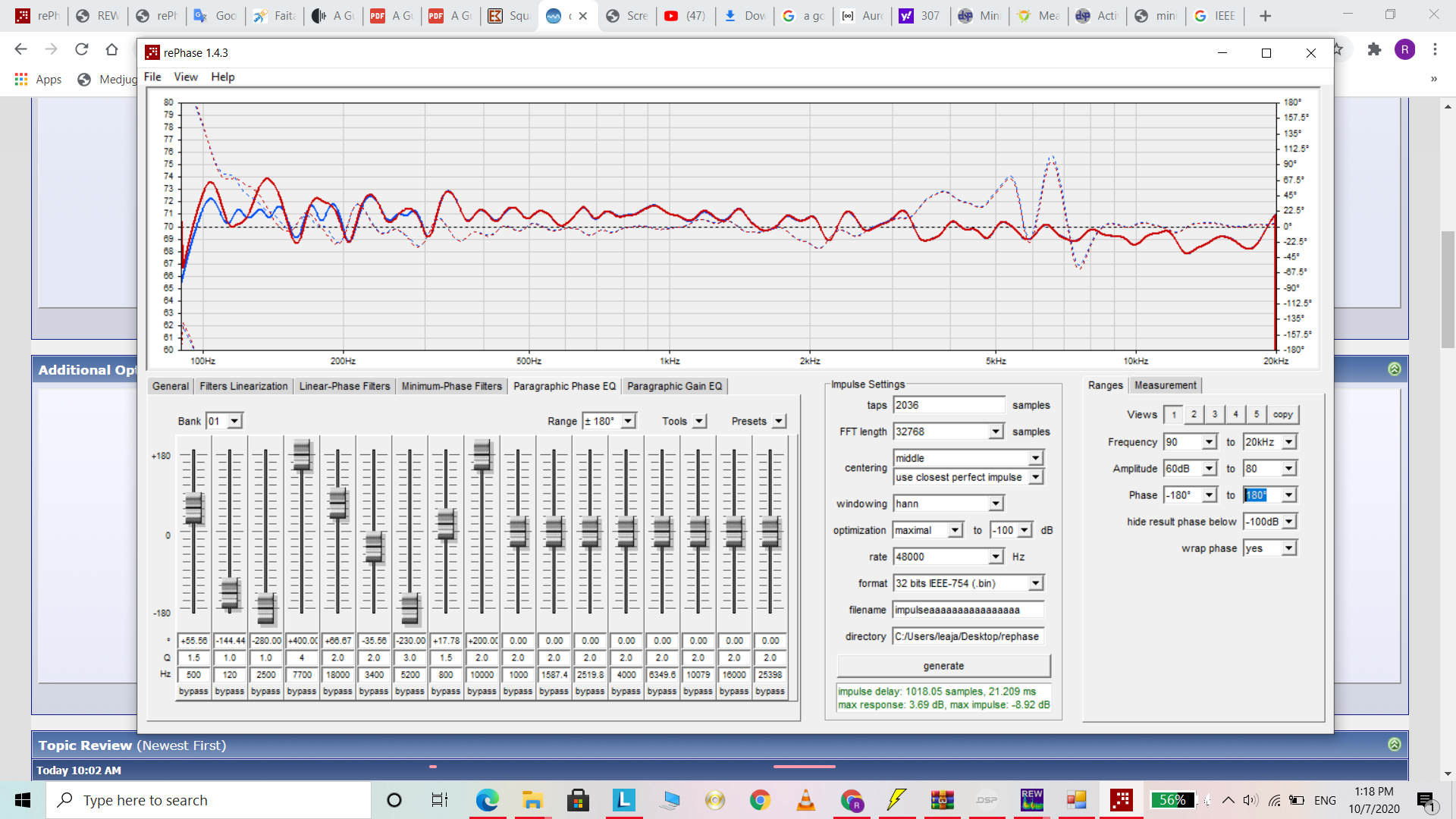

Hey guys, i'm really stuck here and need some help.
I bought a minidsp 2x4HD and a CSL calibrated UMIK-1, I recently discovered that Minidsp 2x4HD have FIR filters that i can use, searched for tutorials on how to use Rephase with REW to make the filters
-i start by taking 9 measurements for each speaker.
-i time allign them and vector average them.
-i EQ simulate the response and save the filters.
-i export the vectored response as a text and import it into rephase.
-i import the filters into rephase.
-I then generate lpcm 32 bit Mono impulse response and import it into REW
-using the trace arithmic i multiply the vector response to the impulse reponse(A*B), and generate an excess phase to the corrected response
-i export the excess phase as txt to rephase and fix the phase using filter linearization and paragrephic phase EQ till it s closest to 0 degree from 100 to 20 khz , i import the vectored response and apply the filters again.
-i generate the response to use in minidsp2x4 HD using the allowed 2048 tap and using the bin. format, makig sure that the response in rephase is still good due to the low number of taps.
-i upload the taps into the minidsp and try measuring again, the frequency response is way worse and the phase and impulse aswell.
i ve tried using the IIR filters in minidsp to flatten out the response and using the FIR filters to fix the phase, whatever i try to phase is still very bad after trying to fix it in rephase.
any tips of what i'm doing wrong is appreciated

@zallou3,
Cant think of other errors than if you use for example other sample rate and FFT lenght or other format rules than the used plugin or miniDSP unit support, then it probaly measure and sounds a bit weird so suggest double check any formatting rules for unit and plugin is within specs.
@zallou3,
made sure that everything is withing specs.. attaching a screenshot of the rephase settings i m using, ignore the phase graph please

Be aware myself havent any 2x4HD so had to look up the manual at miniDSP site and cant see any big mistake other than notice there is a total of 4096 taps awailable distributed over 4 output channels but no output channel must be set with a number lower than 6 tabs, and the number of taps shall be entered in the lower right corner dialog named "Tabs used:", so will ask have you entered the 2000 tabs number you use there in that lower right corner for one or 2 channels with that dot.bin-file and set the other two or three channels to a number not less than 6 🙂.. hope it can help else suggest try lookup some miniDSP user forum for unit.

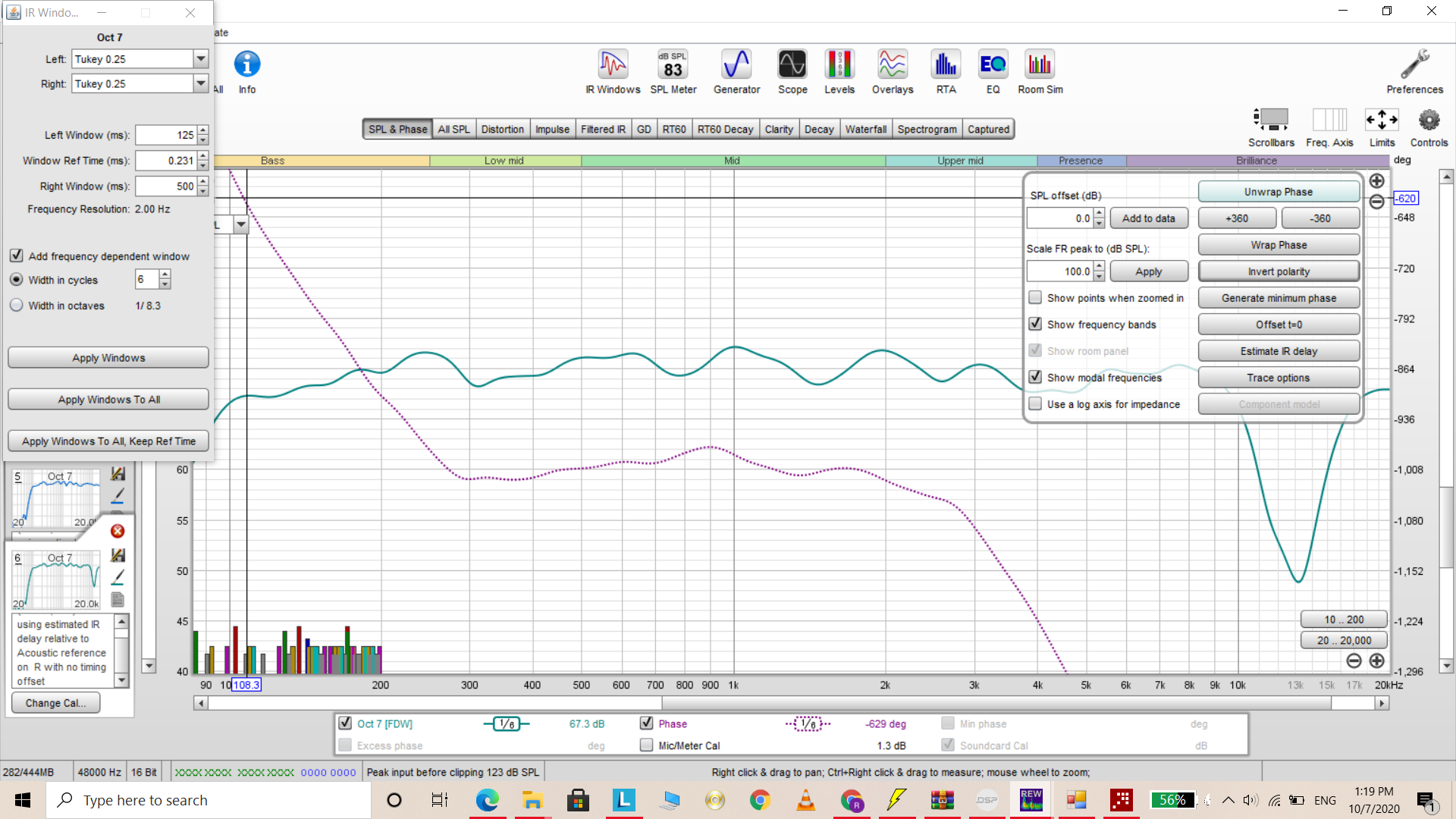

From my own experiments correcting phase from a vector average is less successful than doing it from a single position (main listening position).
To try and narrow down what is going wrong, start with just the PEQ. Measure that at your main listening position and see what you have. If it is very different from what REW showed then it could be that you have a big difference between the measurements in the average which will cause any EQ based on it to be less successful. An in room response EQ'd flat as shown in your screenshots will likely sound too bright. Some like it that way but most do not.
When you have the PEQ worked out then try the phase. Start off with a 5 or 6 cycle FDW in REW from the main listening position and use that to generate your excess phase from.

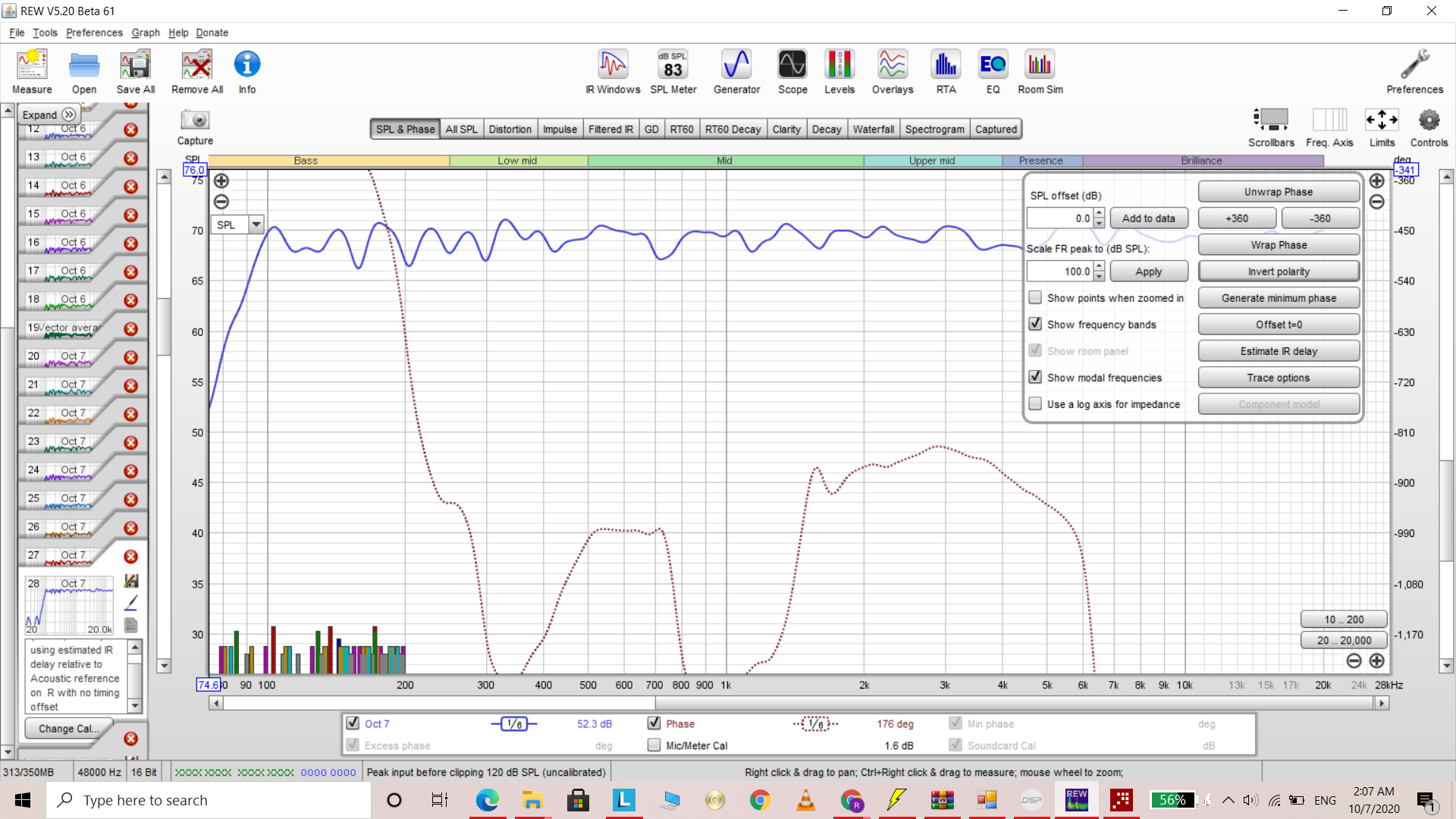

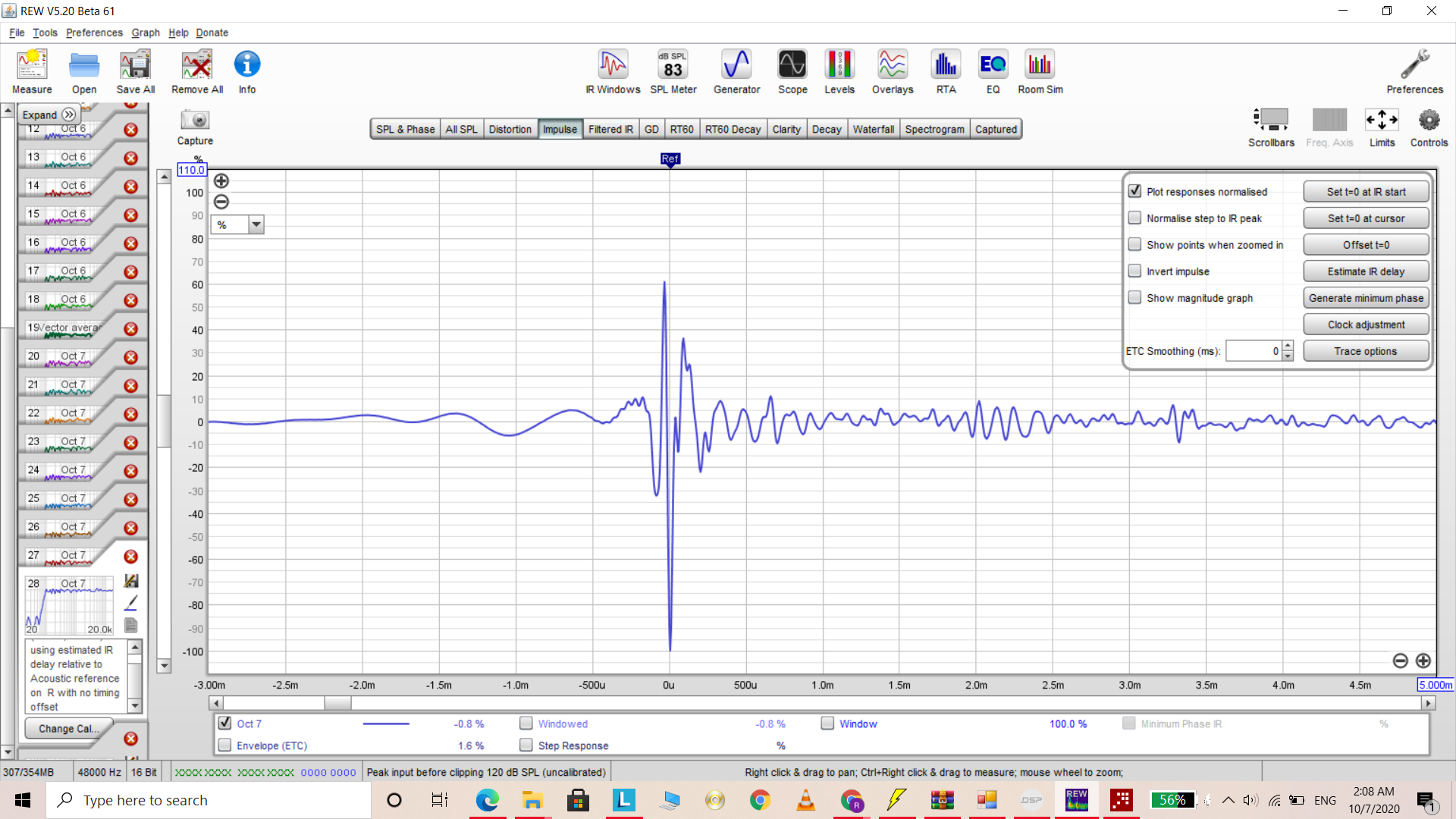

i placed the microphone at 1 position and left it there througout this whole experiment.
I left my IIR settings and added a rephase EQ setting that rolls off the upper end a few dbs, and generated that into FIR settings,the frequency response was almost accurate as the A*B generated(attaching pics)
then i generated the excess phase using 6 cycles FDW and 1/6 smoothing.
imported that into rephase and flattened out the phase, generated it into minidsp FIR and tried the same measurement again, phase is still quite off, i'll attach the pics and tell me what you think please.thank you.( red is IIR alone, cyan is after FIR )
