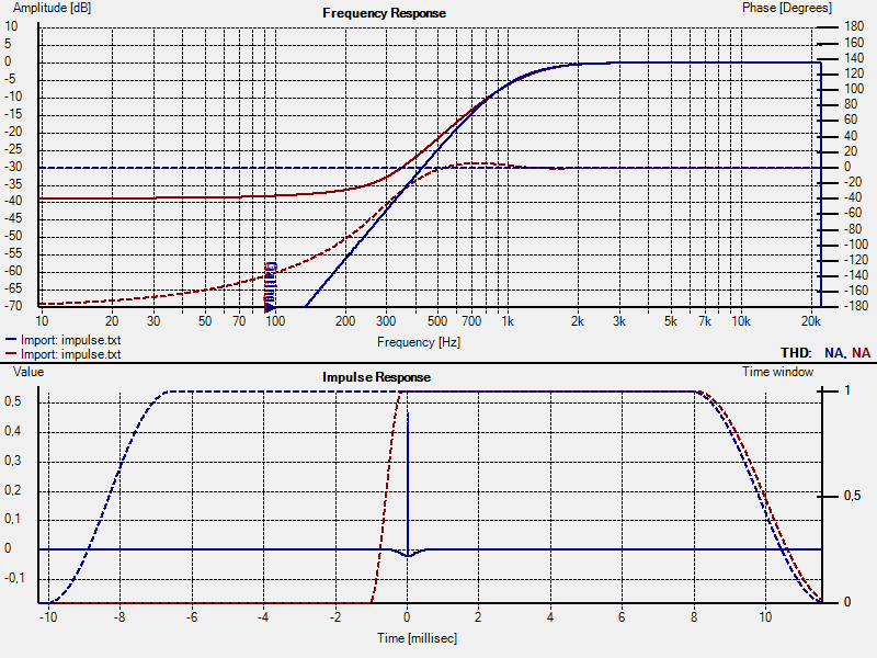

I'm trying to use Re-Phase to build a linear phase 2 way speaker. First time I've used it.
It seems to be working well, except that when I confirm the response with the linear phase high-pass it bottoms out at about -30dB.
Any tips on what is happening here? Re-phase simulation doesn't look like that.
I tried 2000 and 8000 taps. Same result. If I use minimum phase high pass it doesn't do this.
Exactly the same setup, just changed the coefficients table in the DSP. The minimum phase version was 2000 taps. I tried linear phase with 2000 and 8000 taps.

My guess is that ARTA is not considering the whole impulse when calculating the frequency response, and is cropping too much signal before the impulse peak, expecting a minimum-phase behavior.
Here is an example with HOLM, lower part showing the windows used:
attachment.php
See if you can change the measurement window in ARTA.

rePhase is only generating FIRs indeed, suitable for a convolution engine.
There is no such thing as IIR in real life after all: you can only measuring a FIR 😉
